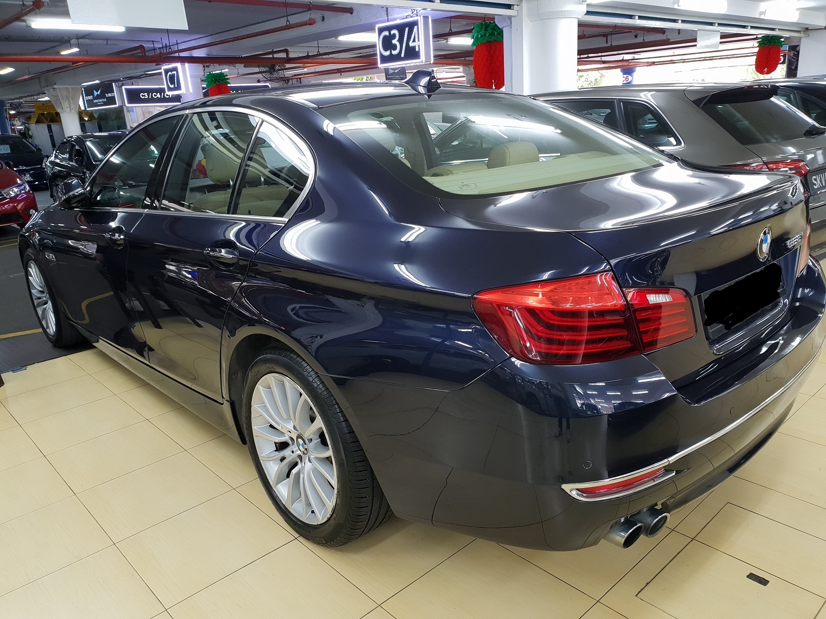

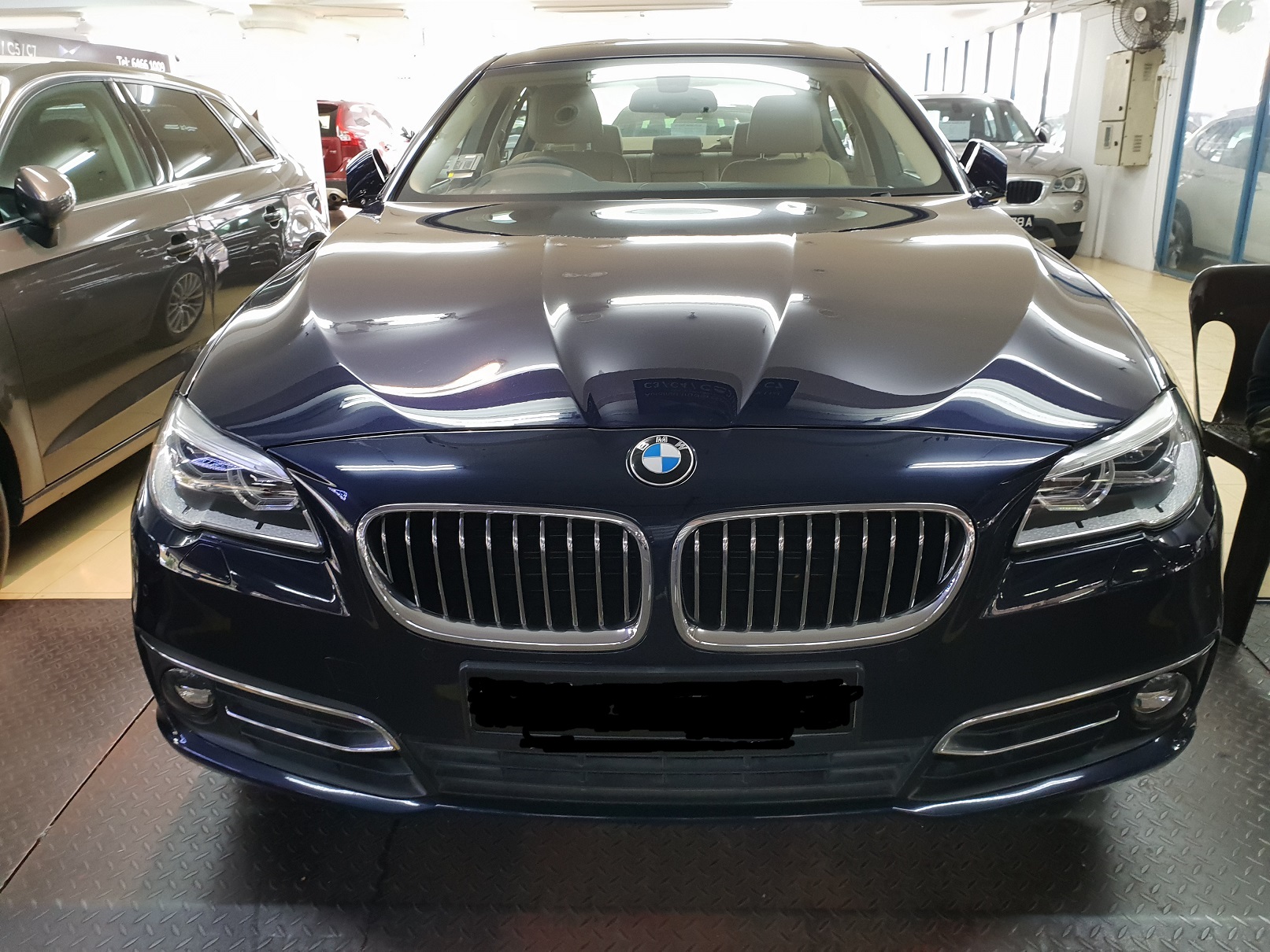

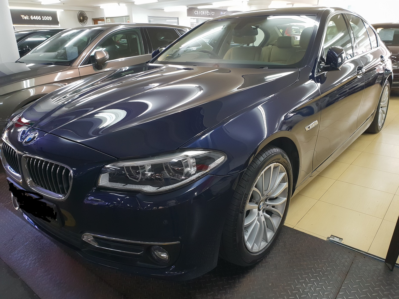

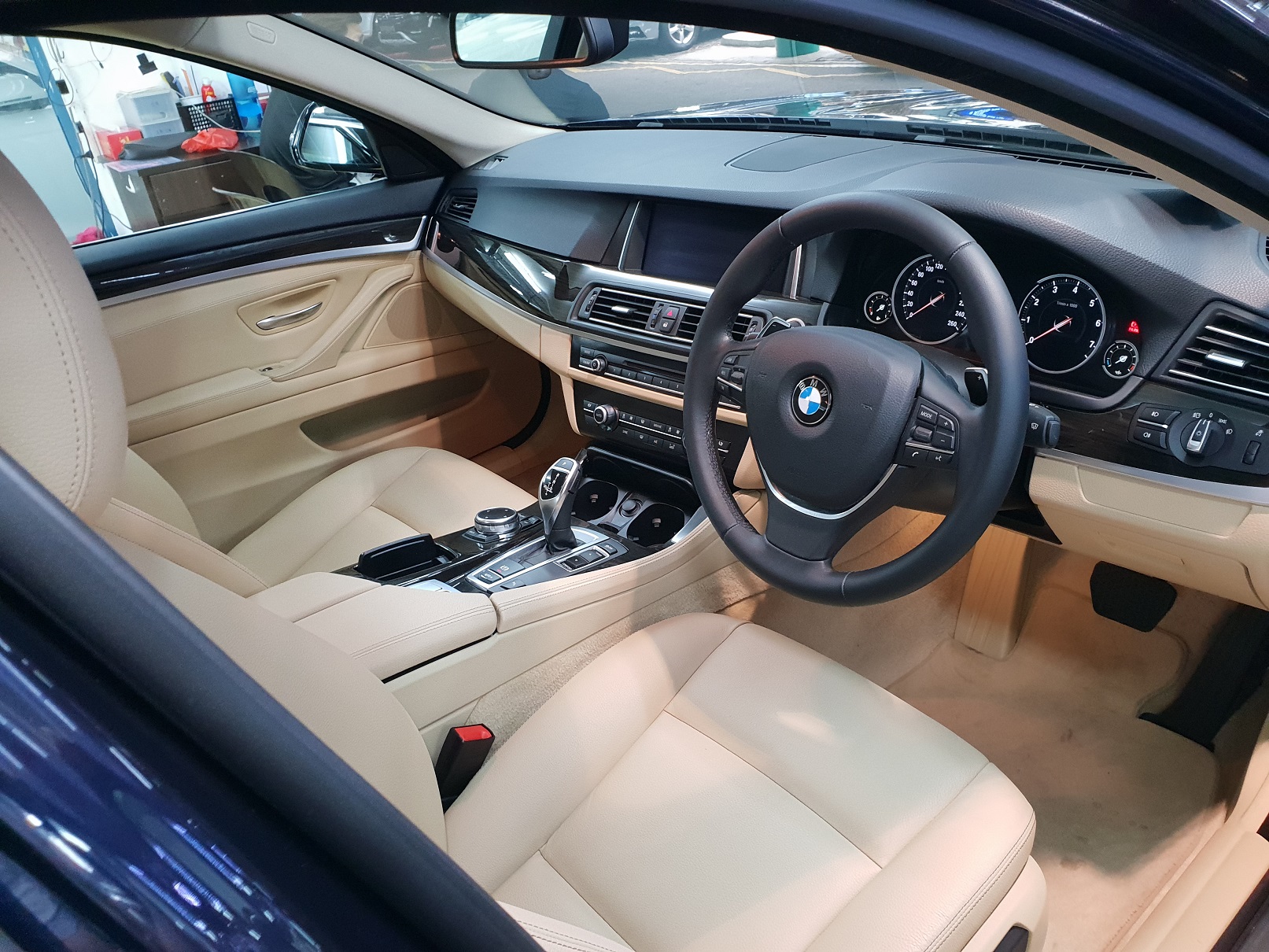

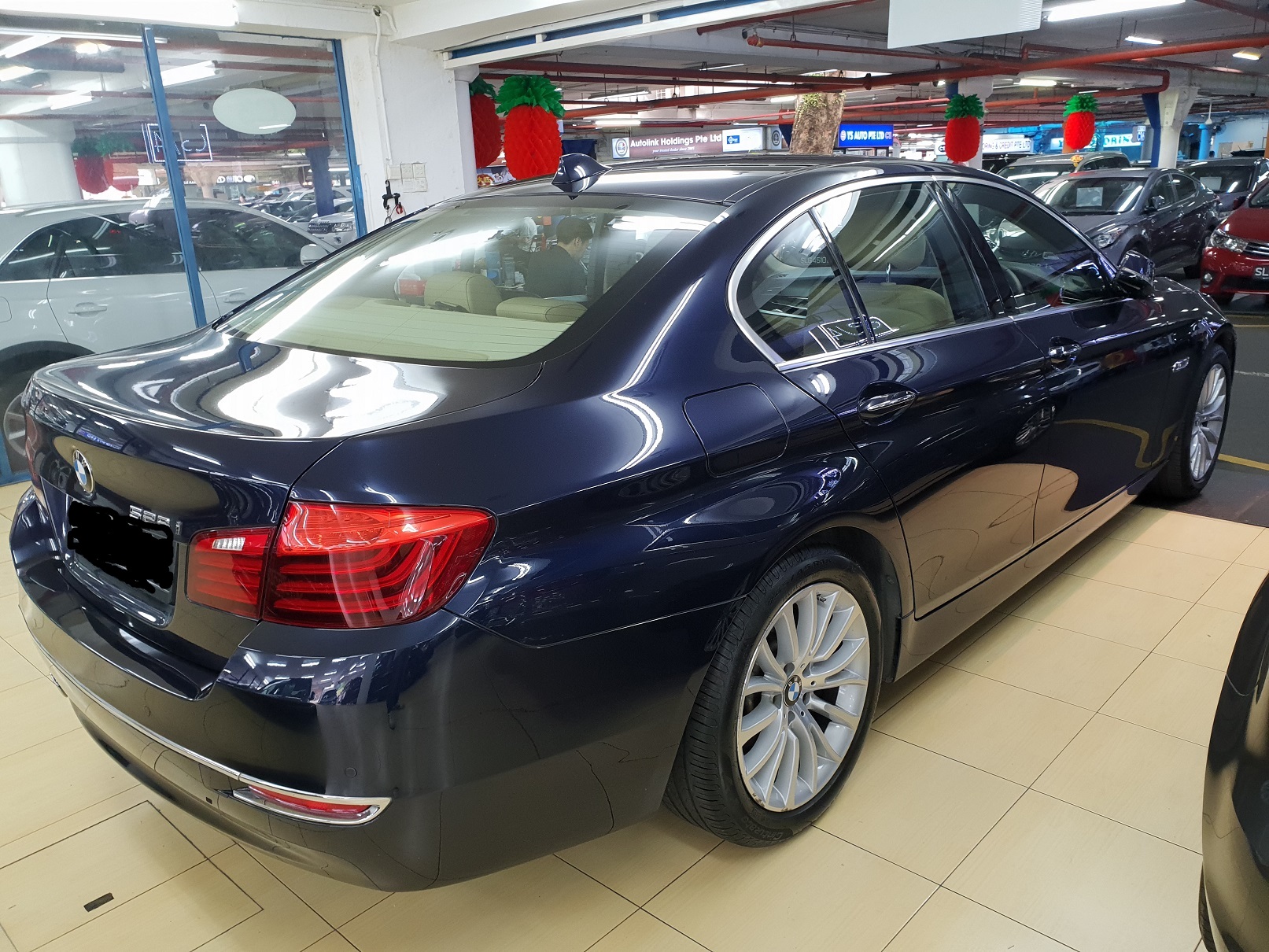

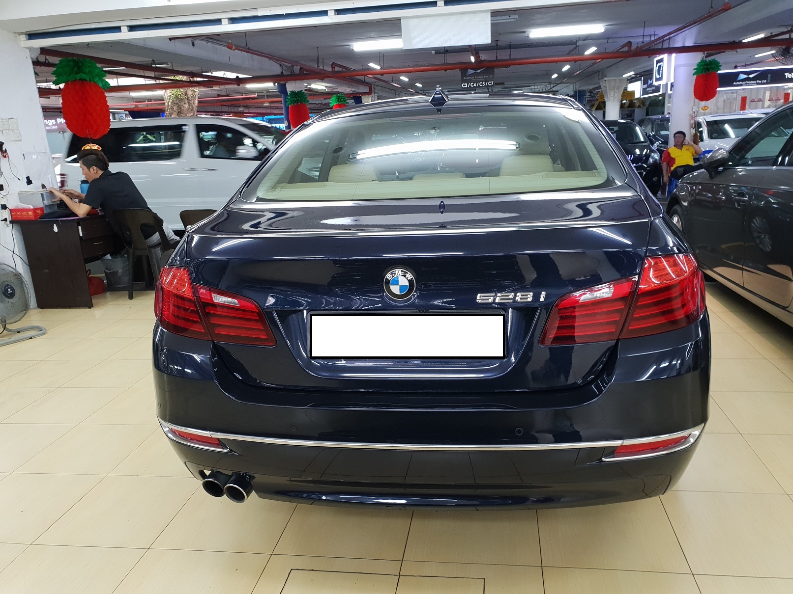

This is my F10 there are many like this but this is mine.
Felt like I over paid but at $15xxx dep a year for a 5 year 53000kms on the odo im prob paying for peace of mind.
Picked up from dealer as many others were avail but in poorer condition.
Specs
F10 528i LCi , sunroof , soft close , 18' rims with run flat tyres

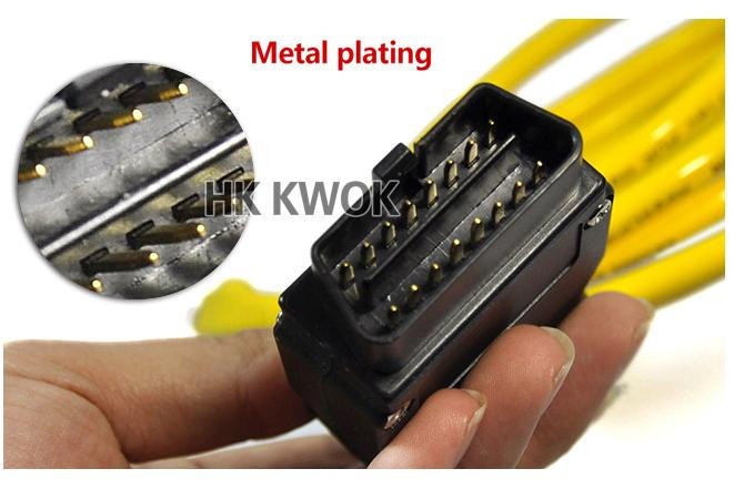

Yes you need a laptop and esys cable so off to aliexpress to get one !

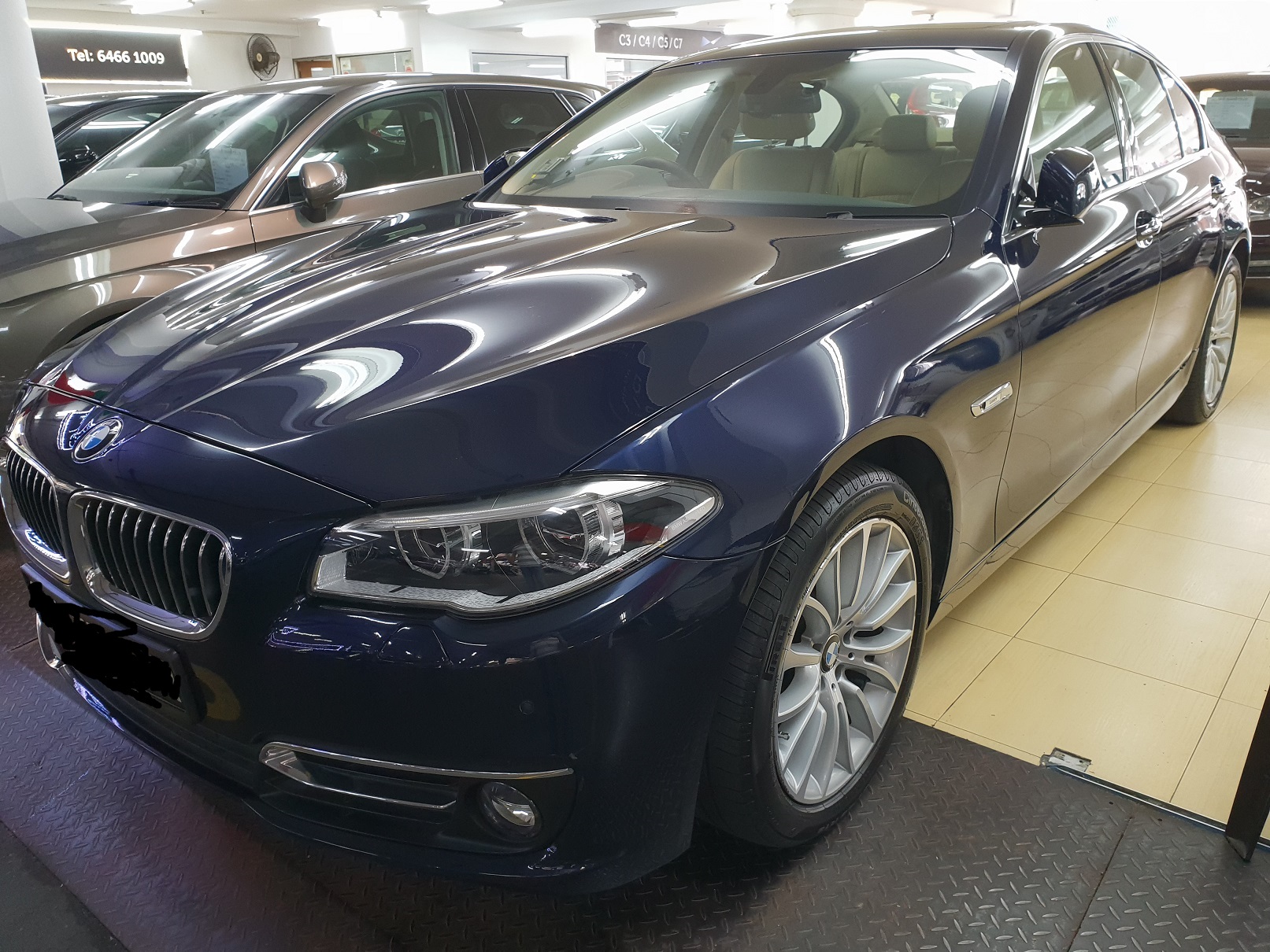

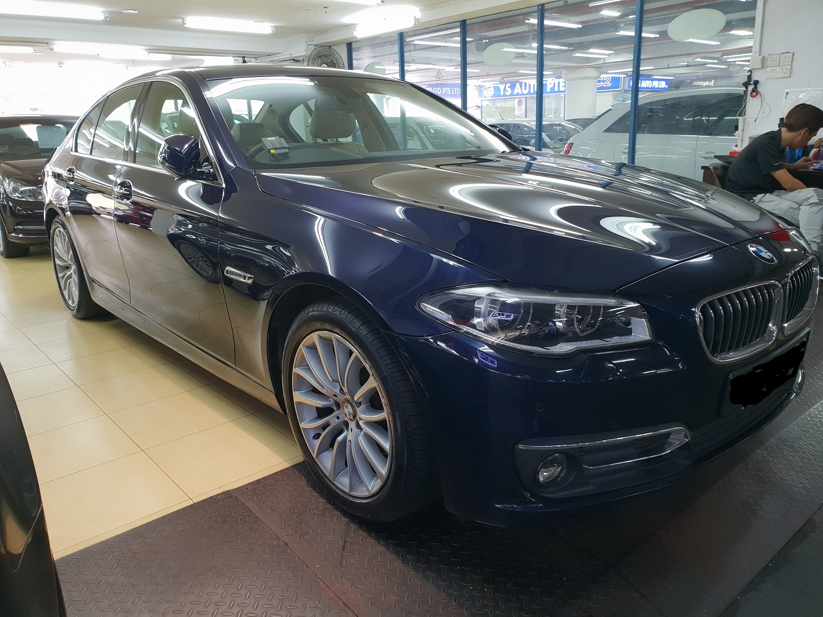

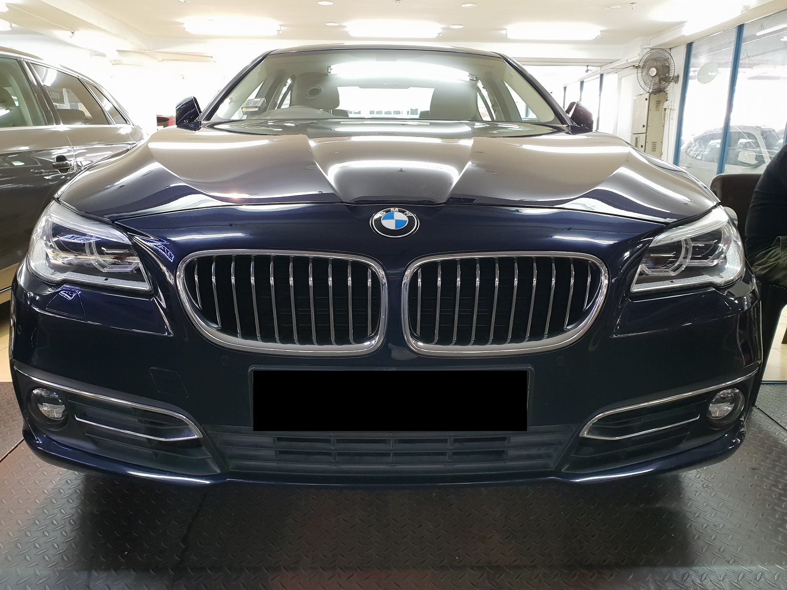

Specs
View attachment 69844View attachment 69845View attachment 69846View attachment 69847View attachment 69848View attachment 69849View attachment 69850View attachment 69851
