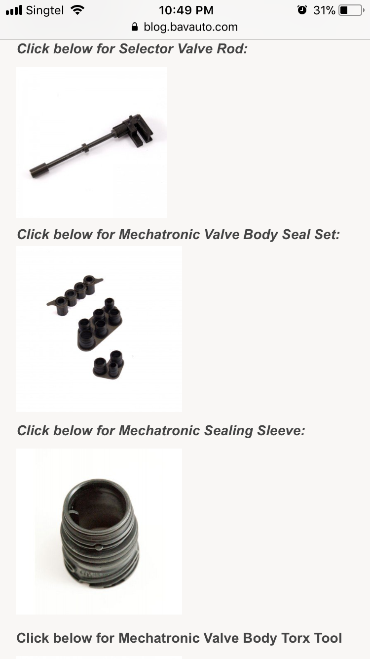

Transmission Fluid 8 or 9 liters (lifeguard6)
Mechatronic Sleeve
Valve Body Seal
Valve Body Solenoids
fill plug
You can do some online research at
go to thectsc.com for parts or to see what you need. The Solenoid are only available from them.... the parts you get drop shipped directly from ZF
