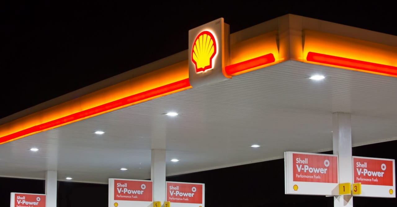

Hi bros, have a question and can't seem to find an accurate answer. Can 216D (2015) pump diesel in JB? Thinking about the long road trip, if can't then can't go liao.
Was reading the manual and it says "Attention" No Biodiesel.
Thanks
Got concerned cos the manual says no biodiesel and Malaysia’s pump are all biodiesel.
Need to find pump that says Euro 5 B0 or just plain Euro 5
Avoid those with B7, B10, B20 suffix. It means contains Biodiesel 7%, 10%, 20% respectively.
You can try a day trip and recon all the different brands whether have the non-biodiesel type. According to Shell MY website is have, but not all pump across the country will have the same grade of fuel available. Try a google/AI search or join malaysia forum and plan your route accordingly.
Learn to identify the colours of the pump handles
and/or
try using the link found at the bottom of the page I've inserted with the heading to plan your route
Find stations with Diesel Euro 5 & Diesel Euro 5 B7"​
play safe and search up other brands as well
