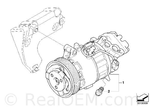

When ac still a little cold and often blow warm air, those are symptom of failing Refrigerant Control Valve or normally called preassure valve here.
can change the valve only ?
Re: air con not cold on hot sunny afternoon
That is a common problem that some may not aware. To change the valve normally need to take the compressor out and vacuming. Work is almost the same as changing compressor. For workshop is not so profitable as the part cost is low. To get better profit normally they ask to change the whole compressor, dryer etc etc
