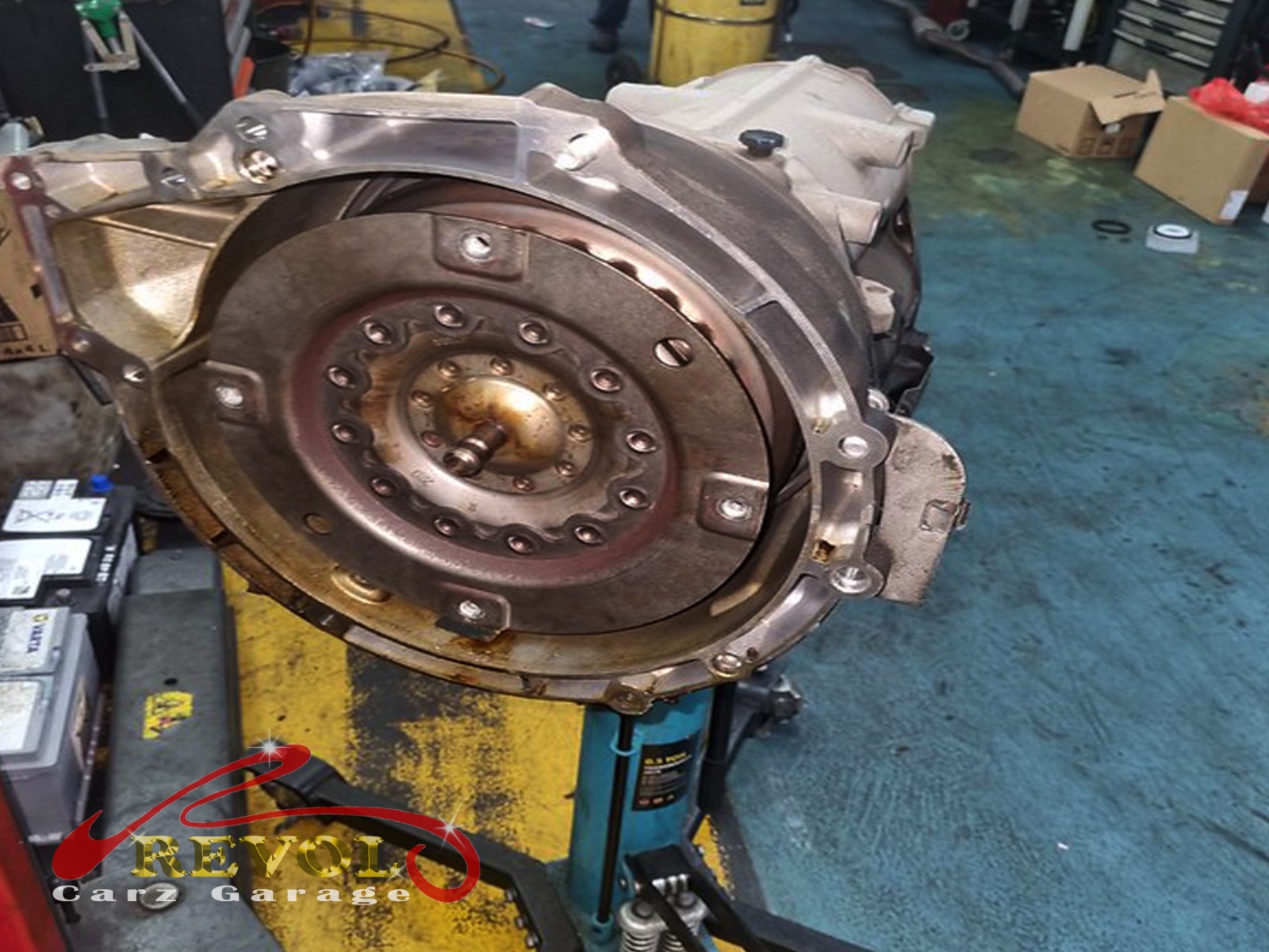

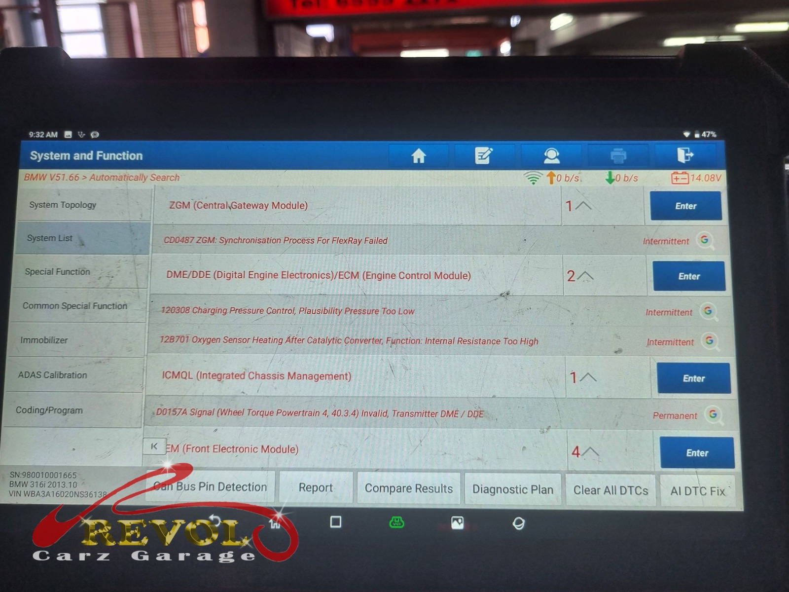

The Owner of a BMW 316i sought assistance at Revol Carz Garage after spotting oil leaks beneath the vehicle.
Our skilled BMW Technician elevated the car and conducted a comprehensive inspection to locate the leak.
Our detailed inspection confirmed that the worn Flywheel Oil Seal was responsible for the leaking oil.
Accessing and replacing the Flywheel Oil Seal requires removing the gearbox as the initial step.
Completing the replacement process involves removing, disassembling, inspecting, and cleaning the Gearbox.
Replacing the Flywheel Oil Seal helps stop oil leaks, protect vital transmission components, and maintain engine lubrication.

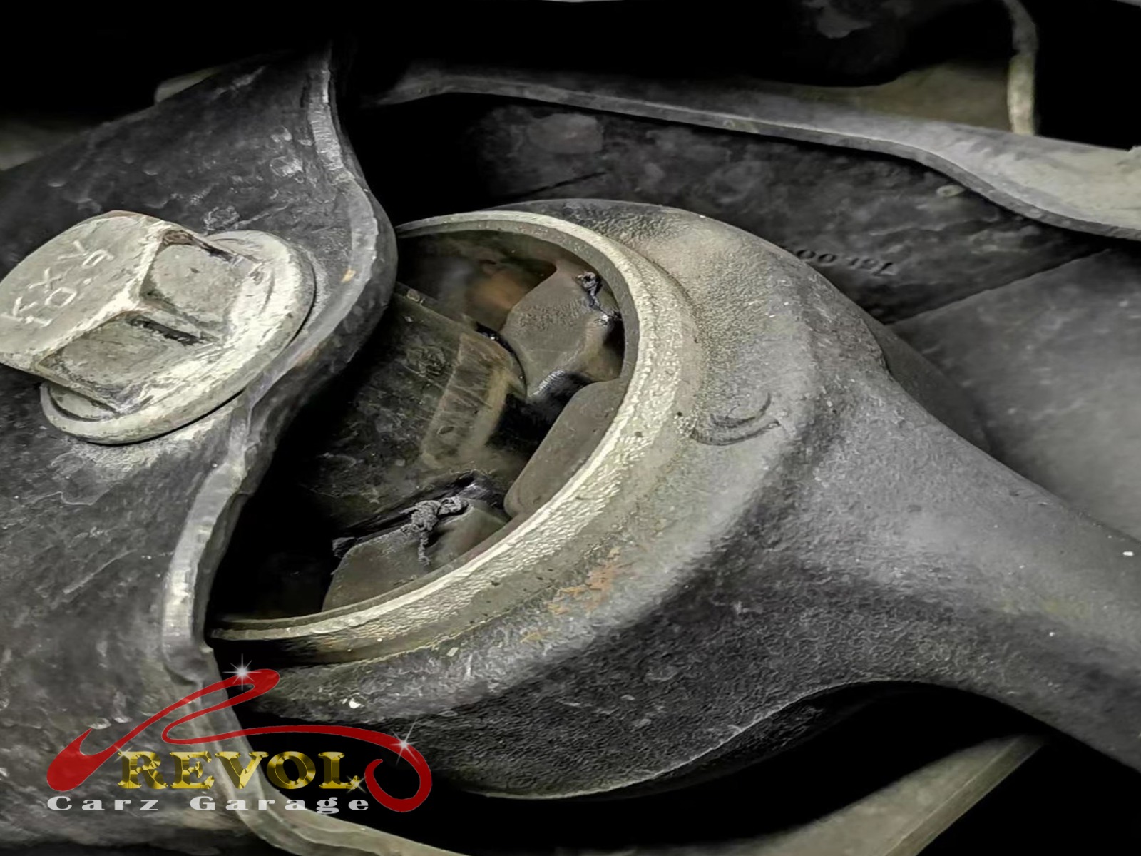

The Owner of a BMW 730Li visited Revol Carz Garage due to a humming noise from the front right wheel.
Our BMW Specialist confirmed a worn Wheel Bearing and hoisted the vehicle to begin the installation process. Relevant components were dismantled to allow access for installation.
Installed a new Front Right Wheel Bearing to resolve noise issues and ensure stable, reliable performance.

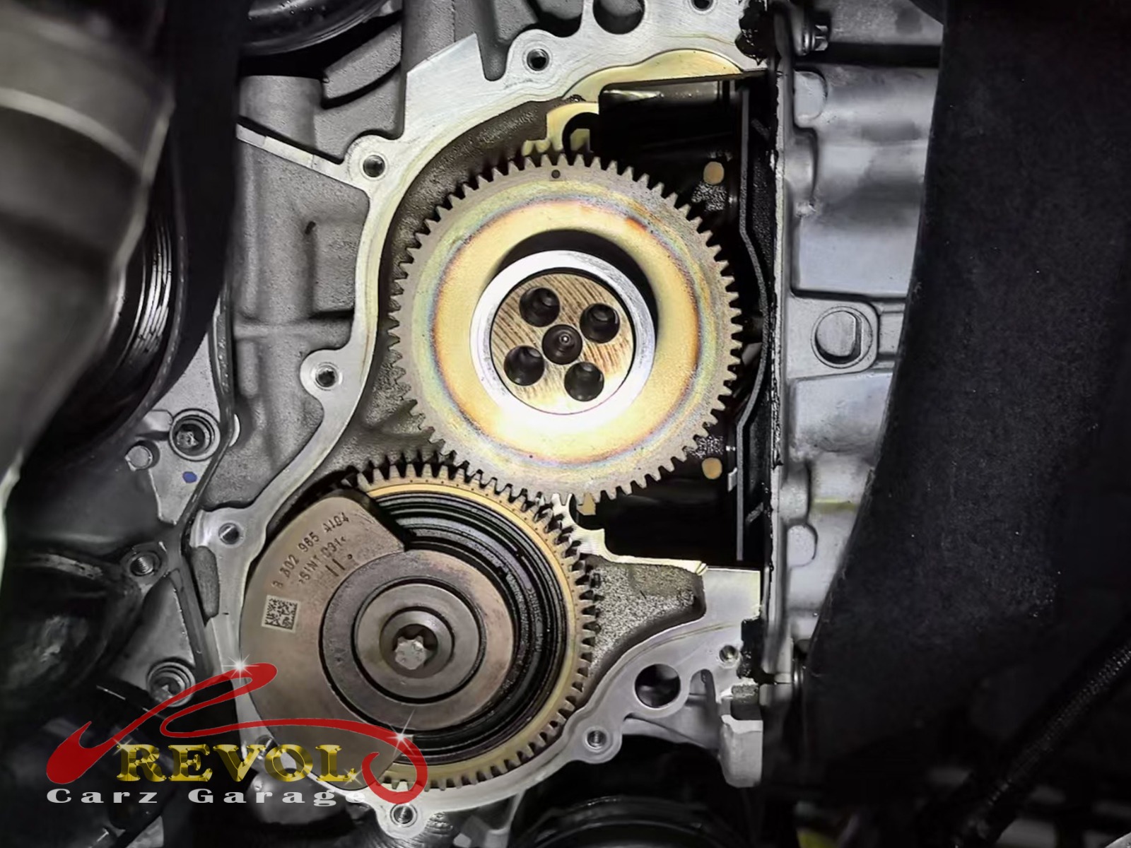

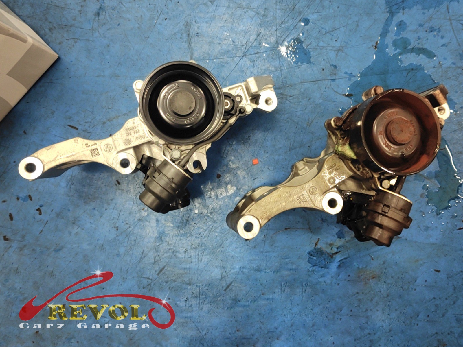

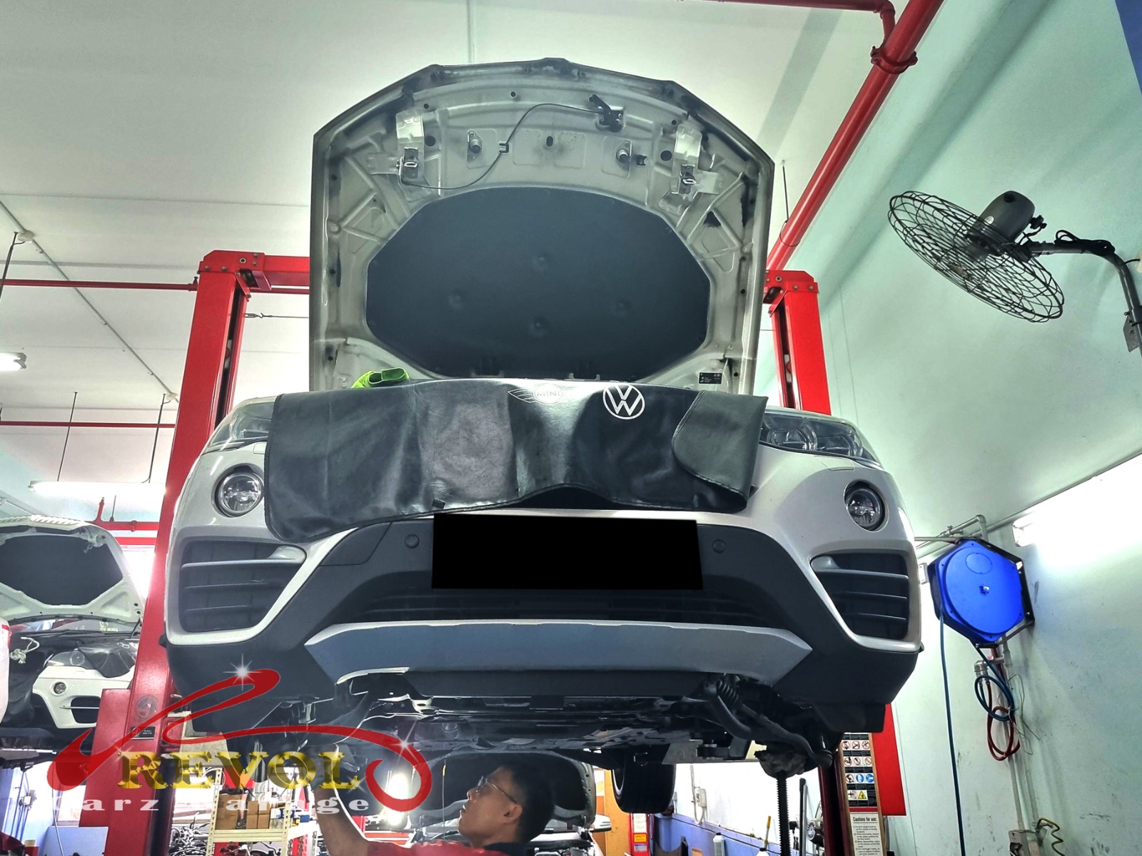

The Owner of a BMW 225XE visited Revol Carz Garage after noticing an oil leak beneath the vehicle.
Our skilled BMW Technicians hoisted the vehicle and conducted a thorough inspection to identify the source of the leak.
Determined that the Timing Cover was compromised, leading to the observed oil leak.
Removed and thoroughly cleaned to ensure proper installation of the new Timing Cover and associated seals.
Installed a new Timing Cover to ensure proper sealing, prevent oil leaks, and maintain optimal engine lubrication and performance.

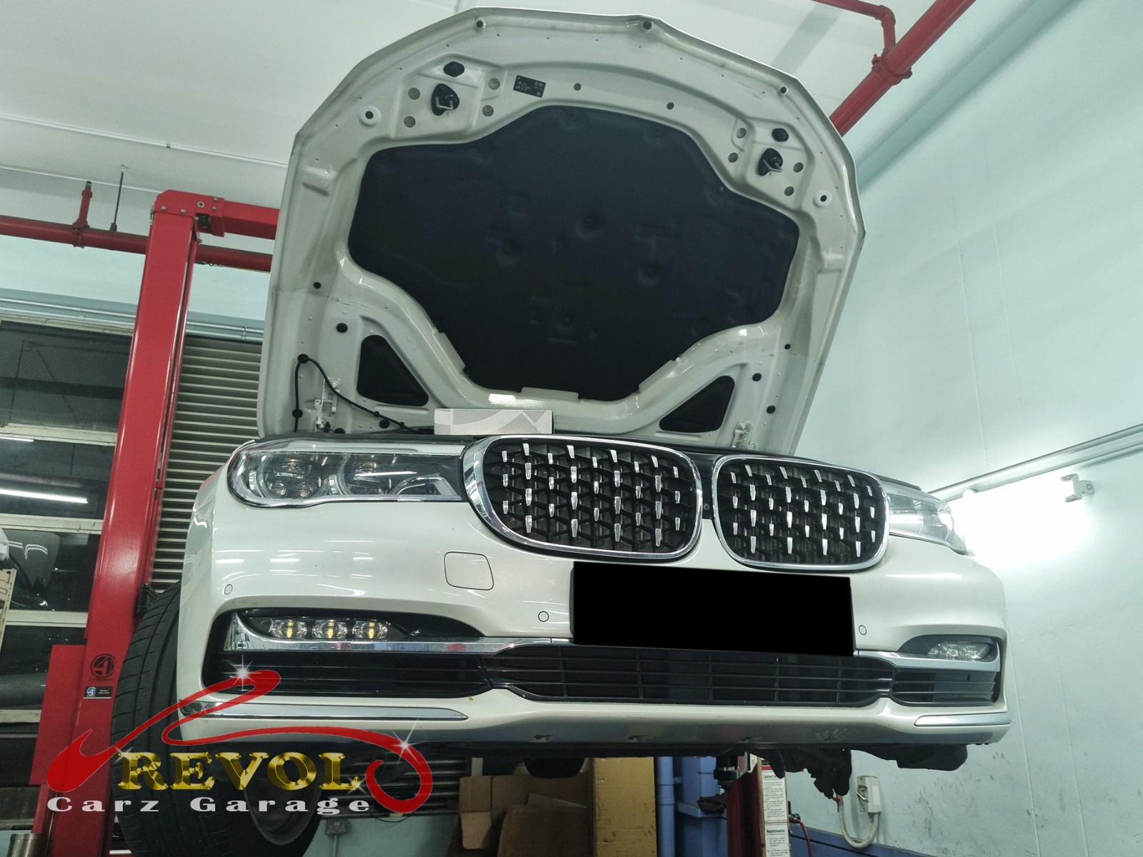

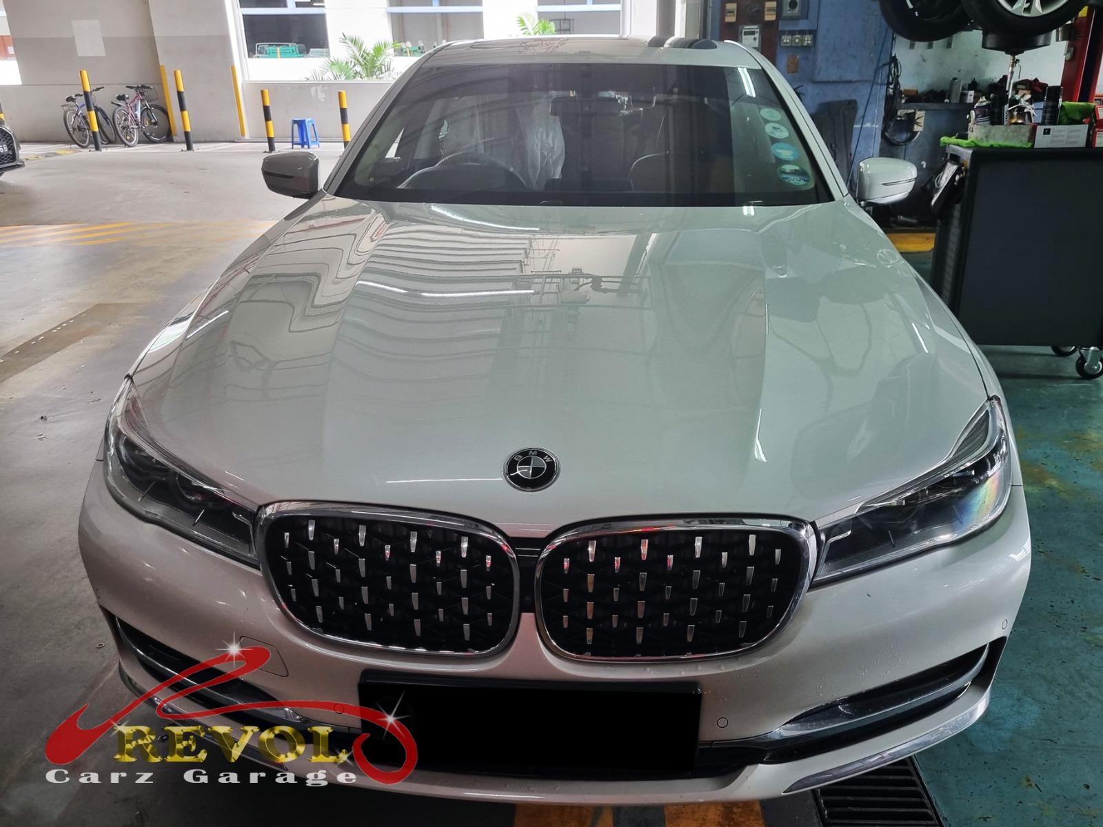

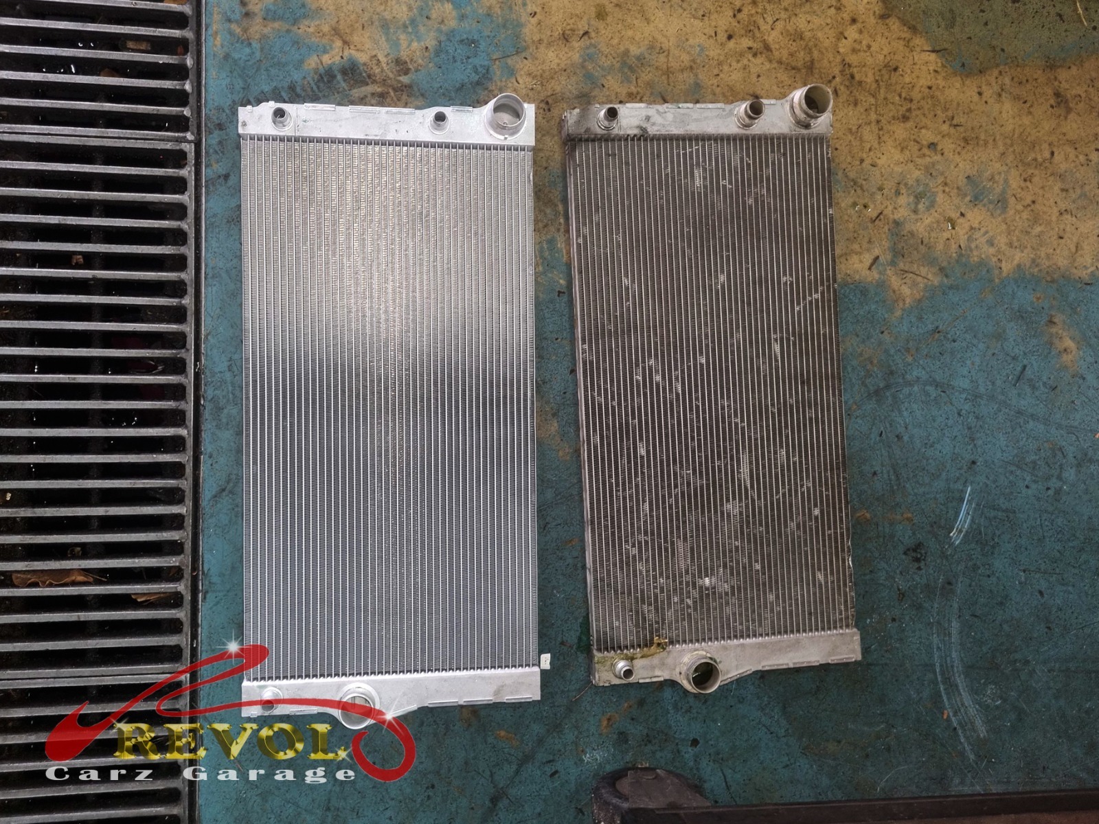

The Owner of a BMW 730Li visited Revol Carz Garage after noticing a coolant leak and rising engine temperatures.
Upon inspection, our BMW Specialists determined that the Radiator was the source of the coolant leak.
Installing a new Radiator improved cooling performance, stabilized engine temperature, and safeguarded against future overheating.

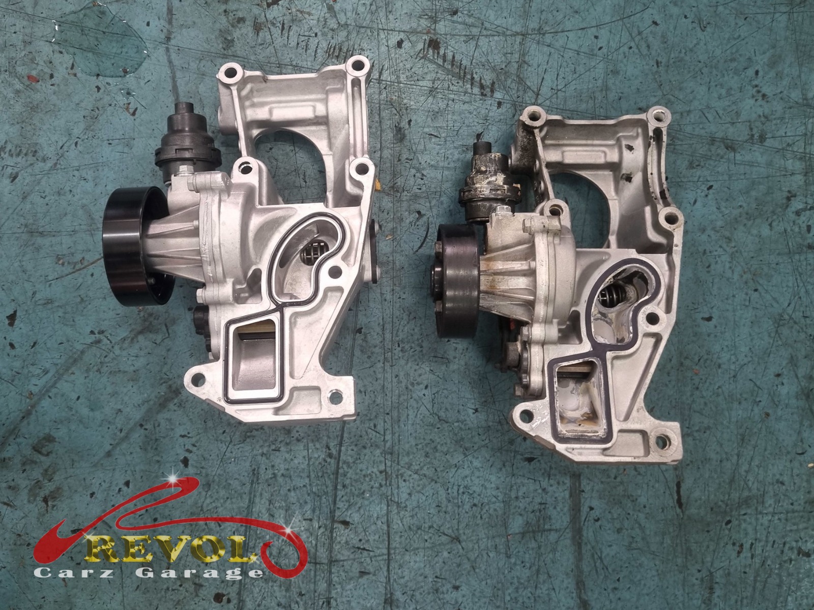

If you find yourself repeatedly adding coolant, spotting fluid beneath your vehicle, or dealing with engine overheating, it is important to have the system inspected without delay. These symptoms may indicate a leak from the Coolant Pump or other components within the cooling system.
At Revol Carz Garage, our Technicians perform detailed cooling system inspections to accurately identify the source of any leaks. Necessary repairs are then carried out to help prevent engine damage and ensure your vehicle continues to operate safely and reliably.
Do feel free to drop by Revol Carz Garage at 10, Ang Mo Kio Industrial Park 2A # 02-18 Ang Mo Kio Autopoint or contact us at 6555 1171 or whatsapp us at https://api.whatsapp.com/send?phone=6593222338.
You may also SMS / Whatsapp to Gavin at 9740 6855 for friendly and absolute no obligation consultation.
The Owner of a BMW 216D visited Revol Carz Garage due to the need for frequent coolant top-ups.
Our expert BMW Technician performed a full inspection by raising the vehicle and evaluating the cooling system in detail.
The Coolant Pump was found to be the origin of the coolant leak following inspection.
The installation of a new Coolant Pump resolved the leakage and restored proper cooling system function.

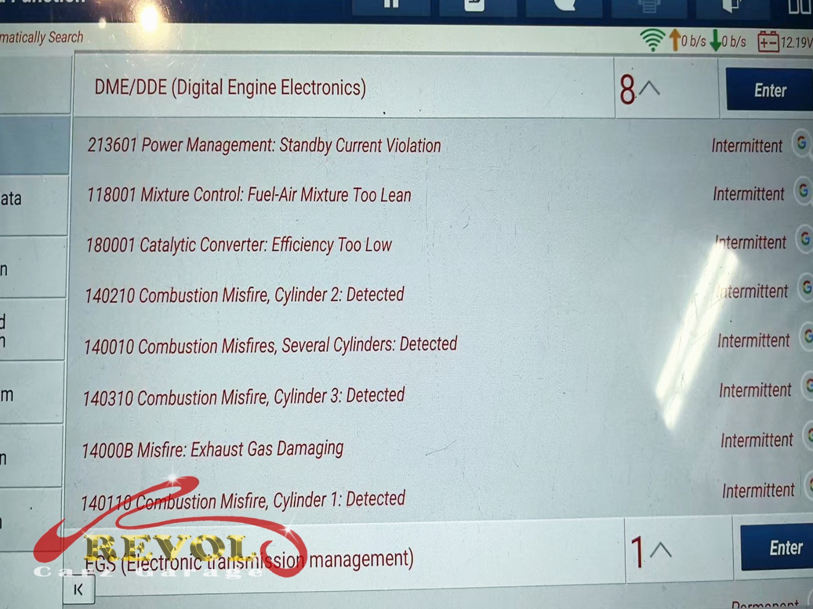

If you're experiencing rough idling, engine misfires, or reduced fuel efficiency in your BMW, it’s important to address these issues promptly to prevent further complications.
Worn Spark Plugs or faulty Ignition Coils could be the cause. Other warning signs include difficulty starting, reduced acceleration, an illuminated Check Engine Light, increased exhaust emissions, or even unexpected engine stalls.
For a thorough diagnosis and effective repair, bring your BMW to Revol Carz Garage. Our skilled Technicians use computerized diagnostics to pinpoint the issue and ensure your vehicle is restored to optimal performance efficiently and reliably.
Do feel free to drop by Revol Carz Garage at Blk 10 Ang Mo Kio Industrial Park 2A, Ang Mo Kio Autopoint # 02-18 S568047 or contact us at 6555 1171 or Whatsapp at 93222338.
The BMW 530i Owner sought assistance at Revol Carz Garage to address an engine check light and misfire issue.
Using advanced computerized diagnostics, our BMW Specialist identifies misfire issues quickly and efficiently.
Regularly replacing Spark Plugs every 60,000 km helps maintain engine efficiency and peak performance.
Replacing Ignition Coils after passing 120,000 kilometers improves engine efficiency and reduces the risk of damage.

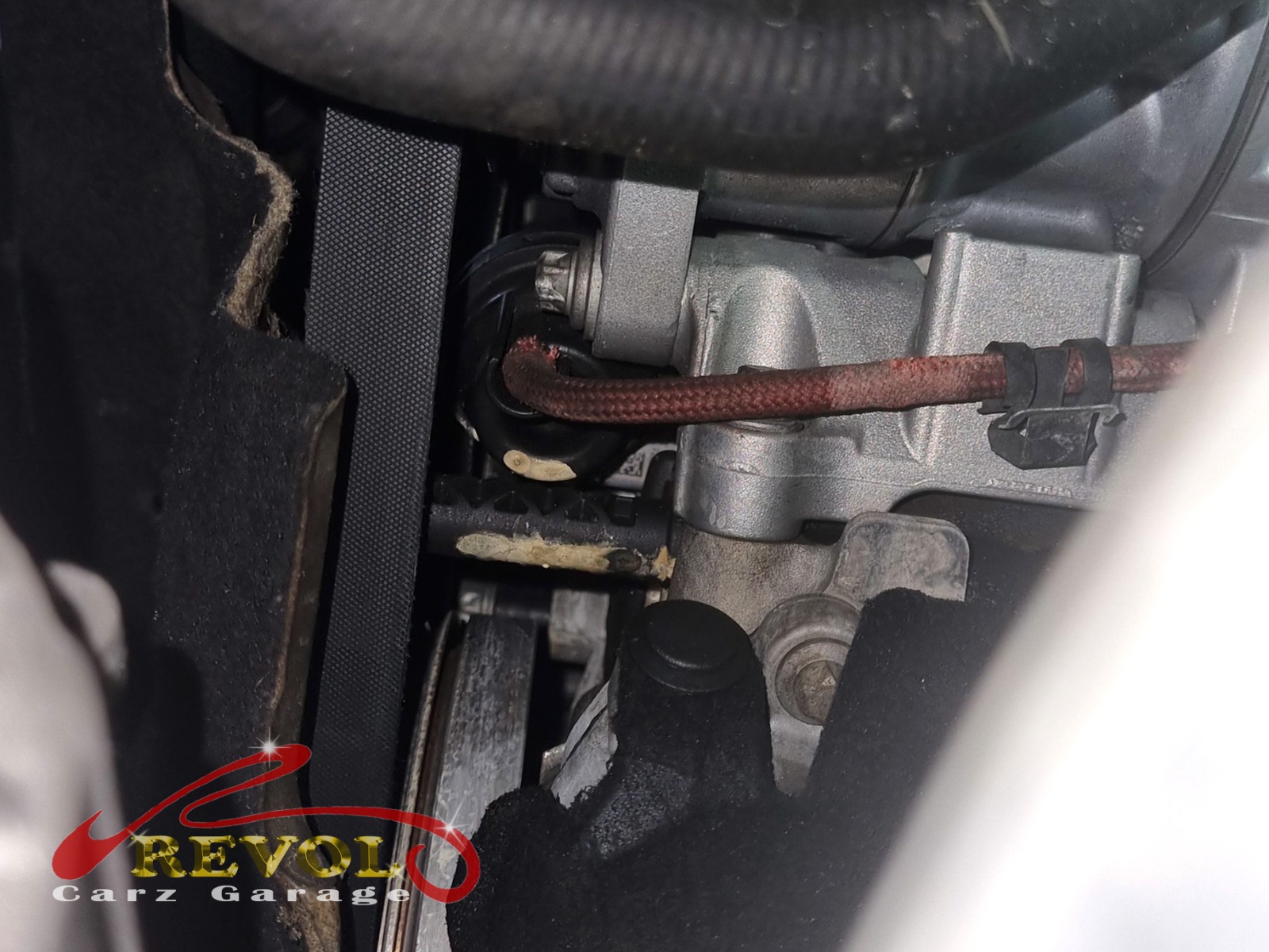

If you’re seeing the oil warning light stay on or noticing inaccurate oil level readings, your BMW may have a faulty Oil Level Sensor.
A faulty Sensor can give false warnings or fail to alert you to a real low-oil condition, potentially leading to engine wear or damage if the oil level is not maintained.
At Revol Carz Garage, our Technicians quickly diagnose and replace faulty sensors, ensuring accurate oil monitoring, protecting your engine, and keeping your BMW running reliably.

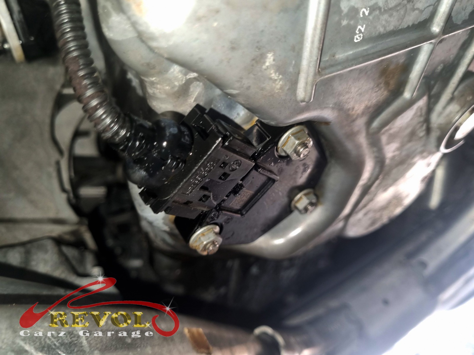

The Owner of a BMW 540i sought assistance at Revol Carz Garage after the low oil level warning light appeared.
Our specialist BMW Technician lifted the vehicle and conducted a thorough inspection to check for any leaks.
The inspection confirmed the Oil Level Sensor was malfunctioning, giving inaccurate alerts.
The faulty Oil Level Sensor was replaced with a new one, ensuring accurate oil monitoring and reliable engine protection.

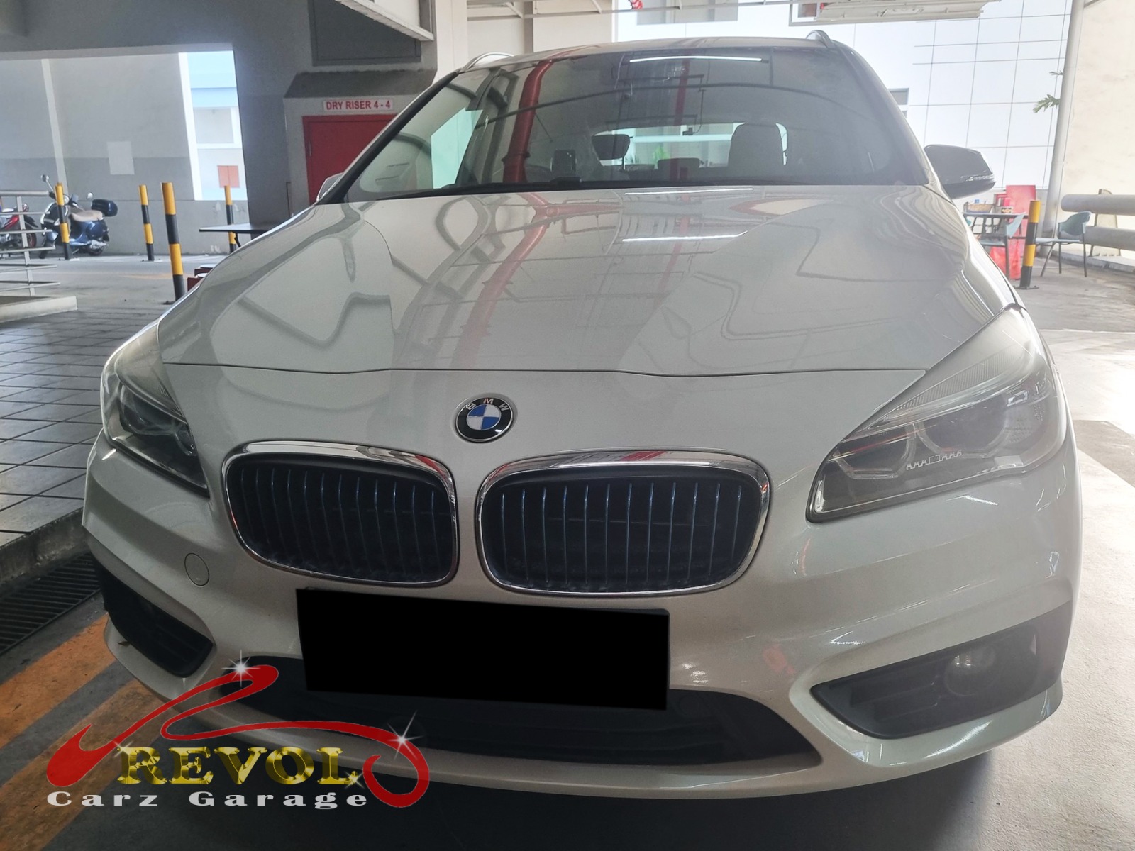

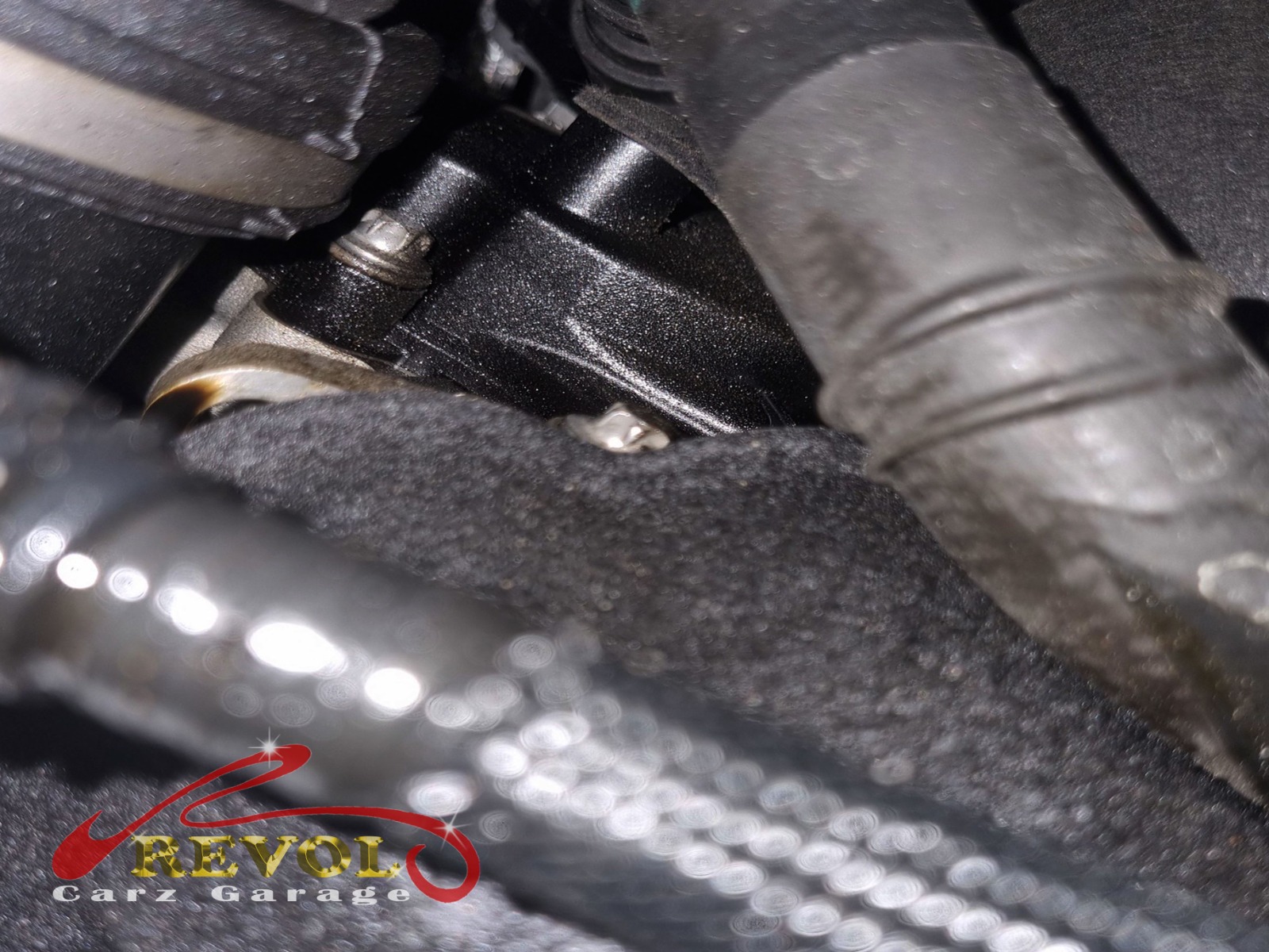

The Owner of a BMW 216i visited Revol Carz Garage after experiencing intermittent cranking issues.
Our BMW Specialist hoisted up the car for a comprehensive inspection of all critical components.
Our BMW Technician identified the issue as a worn Starter Motor requiring replacement.
The installation of a new Starter Motor ensures smooth and consistent engine startups, improving reliability and performance.

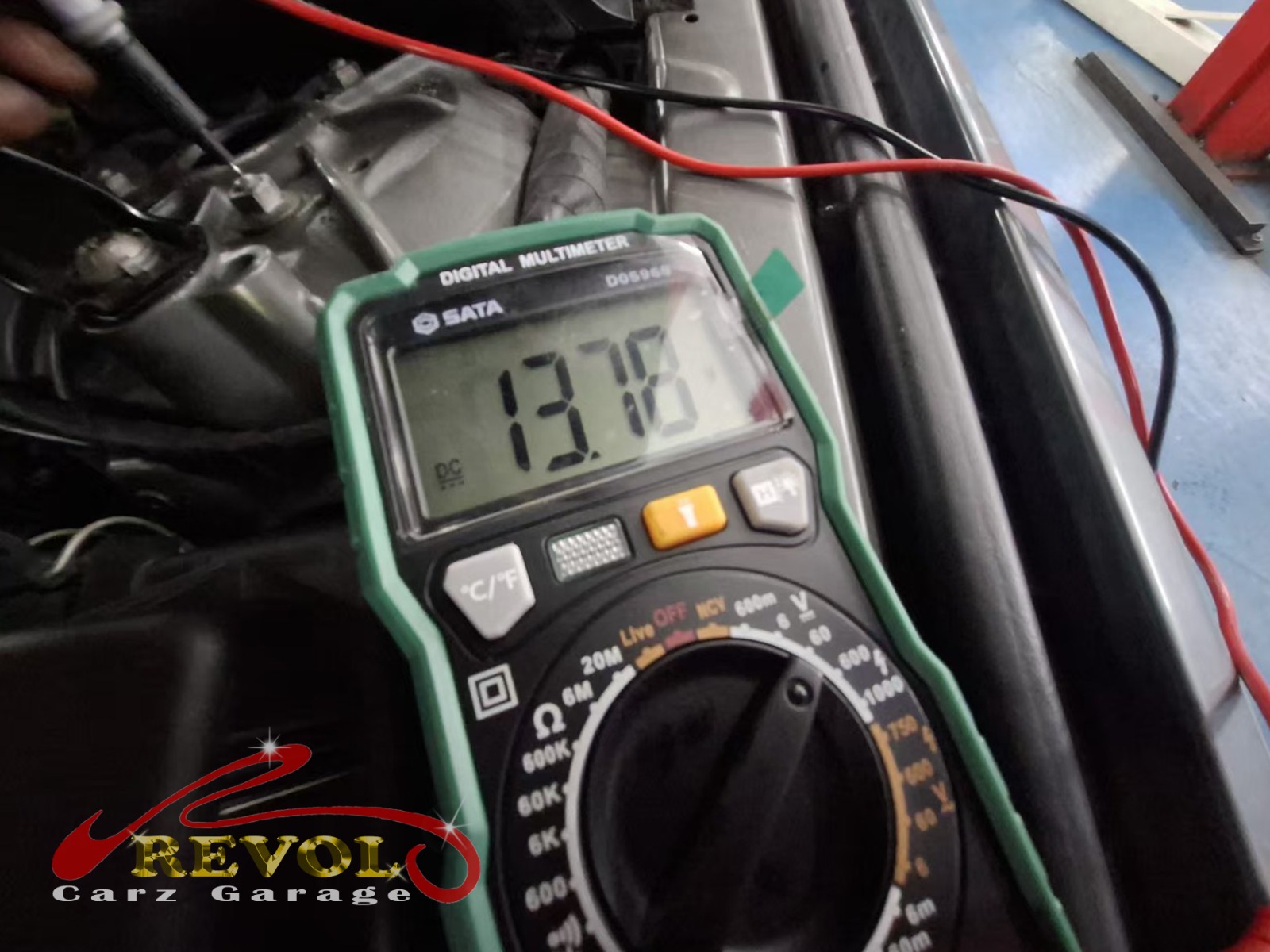

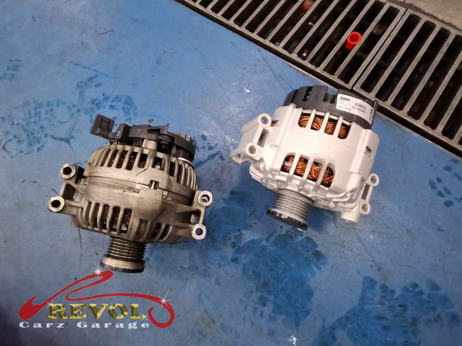

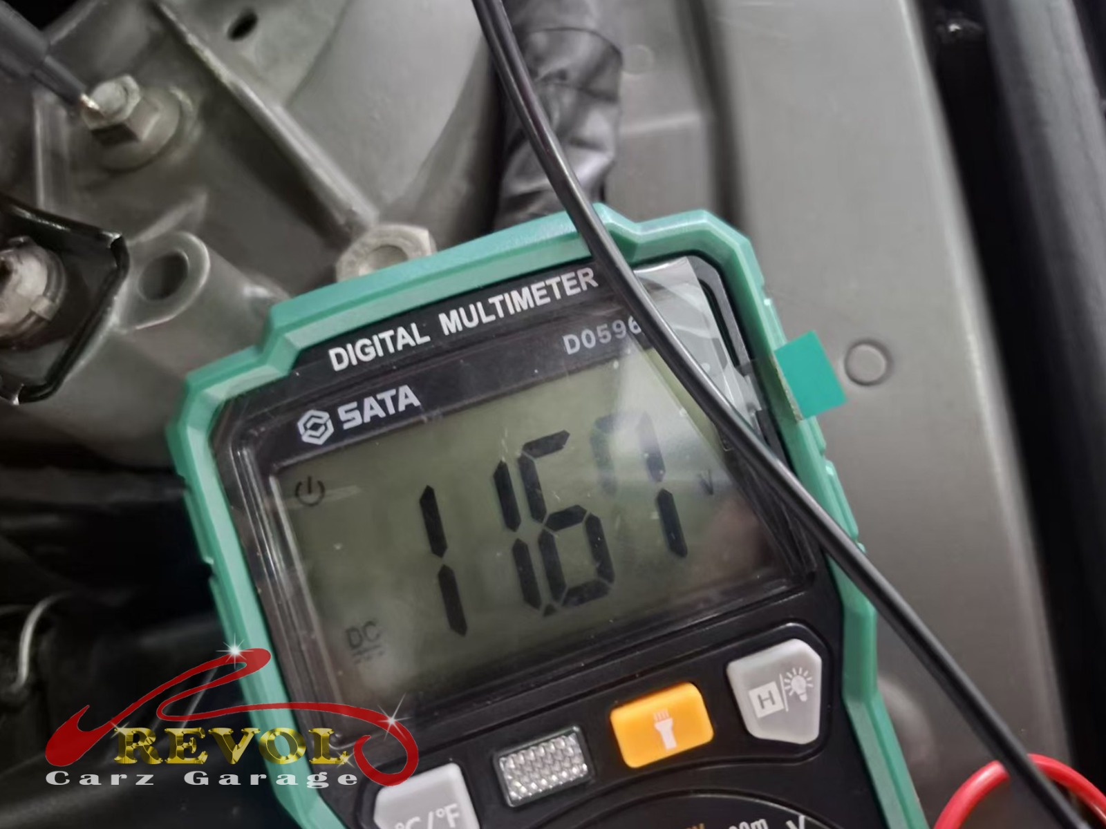

If you’re having trouble starting your car but the Battery seems fine, the issue could be a faulty Alternator.
A malfunctioning Alternator may fail to properly charge the Battery, leaving you with insufficient power to start the engine. Conversely, an alternator that overcharges can send too much voltage to the battery, potentially damaging it and other electrical components.
A healthy alternator typically generates 13.7 to 14.7 volts when the engine is running. If your readings fall outside this range, it’s a strong indication that your alternator needs attention.
At Revol Carz Garage, our experienced technicians specialize in diagnosing and fixing alternator issues. Whether it’s a worn alternator or an overcharging problem, we provide reliable, efficient service to restore your vehicle’s electrical system. Trust us to keep your car running smoothly—schedule your alternator checkup today!
The Owner of a BMW 520i sought assistance at Revol Carz Garage due to repeated difficulties starting the vehicle.
Our experienced BMW Technicians conducted a thorough test and found that the alternator was not charging sufficiently, resulting in abnormal voltage levels.
Replacing the Alternator with a new one ensures reliable performance, proper Battery charging, and prevents further starting issues.
After replacing the Alternator with a new one, testing showed that proper voltage regulation was restored, ensuring optimal performance.

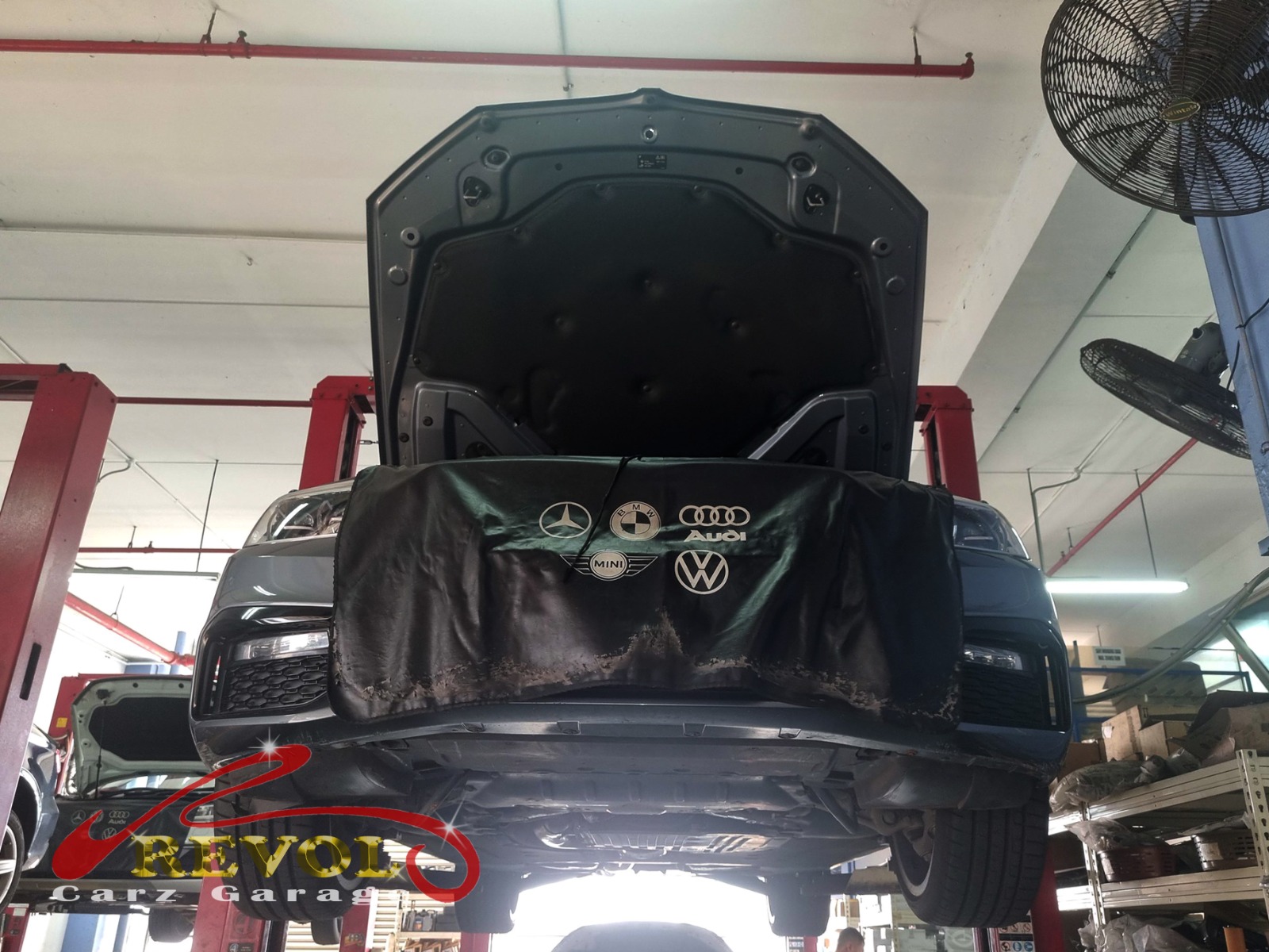

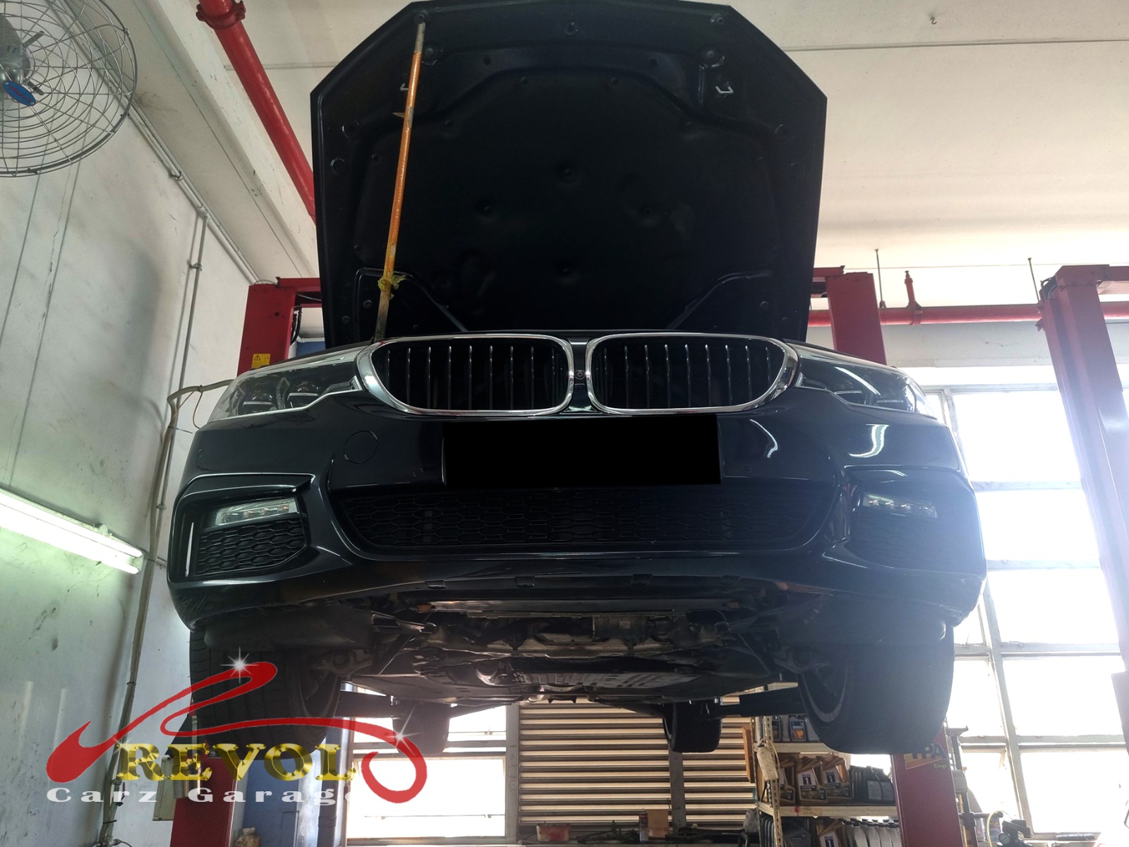

The Owner of a BMW 530i visited Revol Carz Garage after discovering coolant leaking beneath the car.
Our BMW specialist Technician lift the vehicle and carry out a meticulous inspection for any coolant leaks.
Inspection revealed coolant escaping from the Water Pump Housing.
Replacing the Water Pump Housing ensure proper coolant flow and prevent leaks.

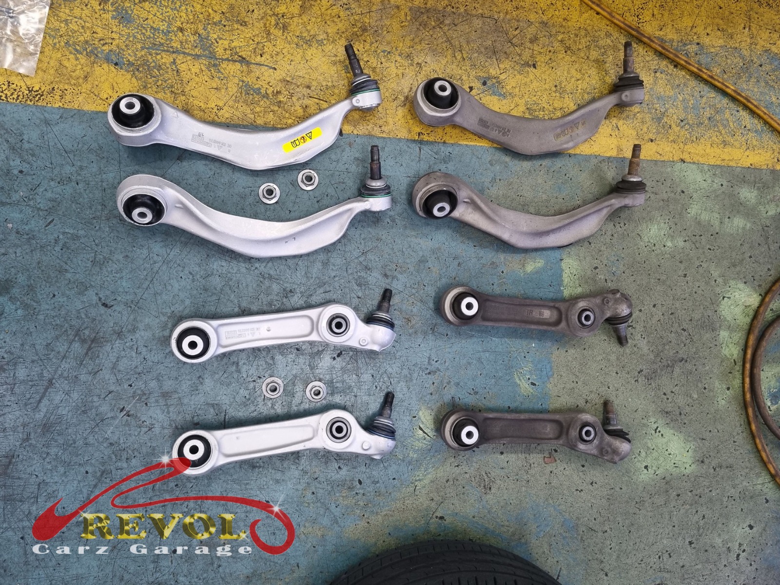

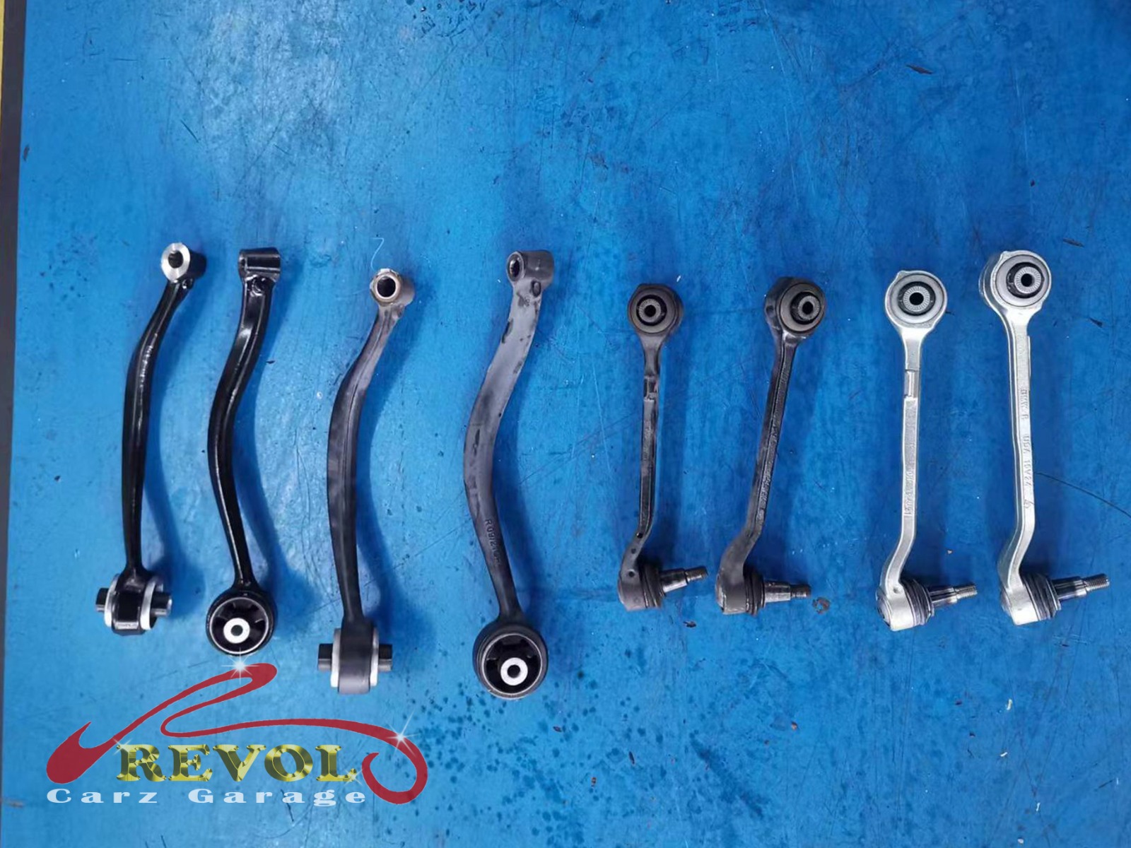

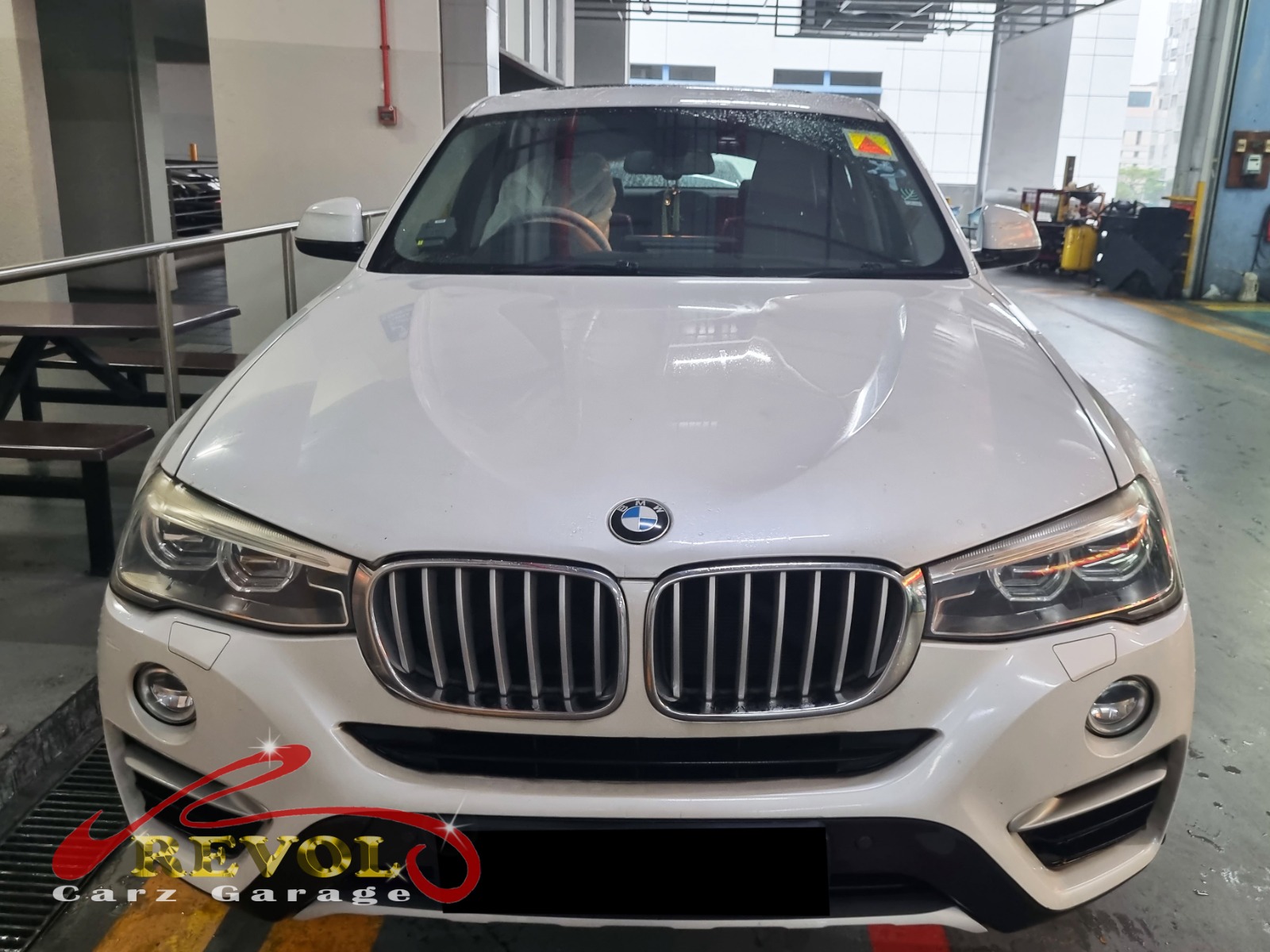

The BMW X4 Owner visited Revol Carz Garage after hearing unusual noises, particularly when driving over bumps.
Our BMW Specialists raised the vehicle and carried out a thorough inspection of the suspension components.
The inspection confirmed cracks in both the Lower Arms and Control Arms, which were responsible for the noise.
The Lower Arms and Control Arms were replaced with new units to improve handling, restore stability, and resolve the noise issue.

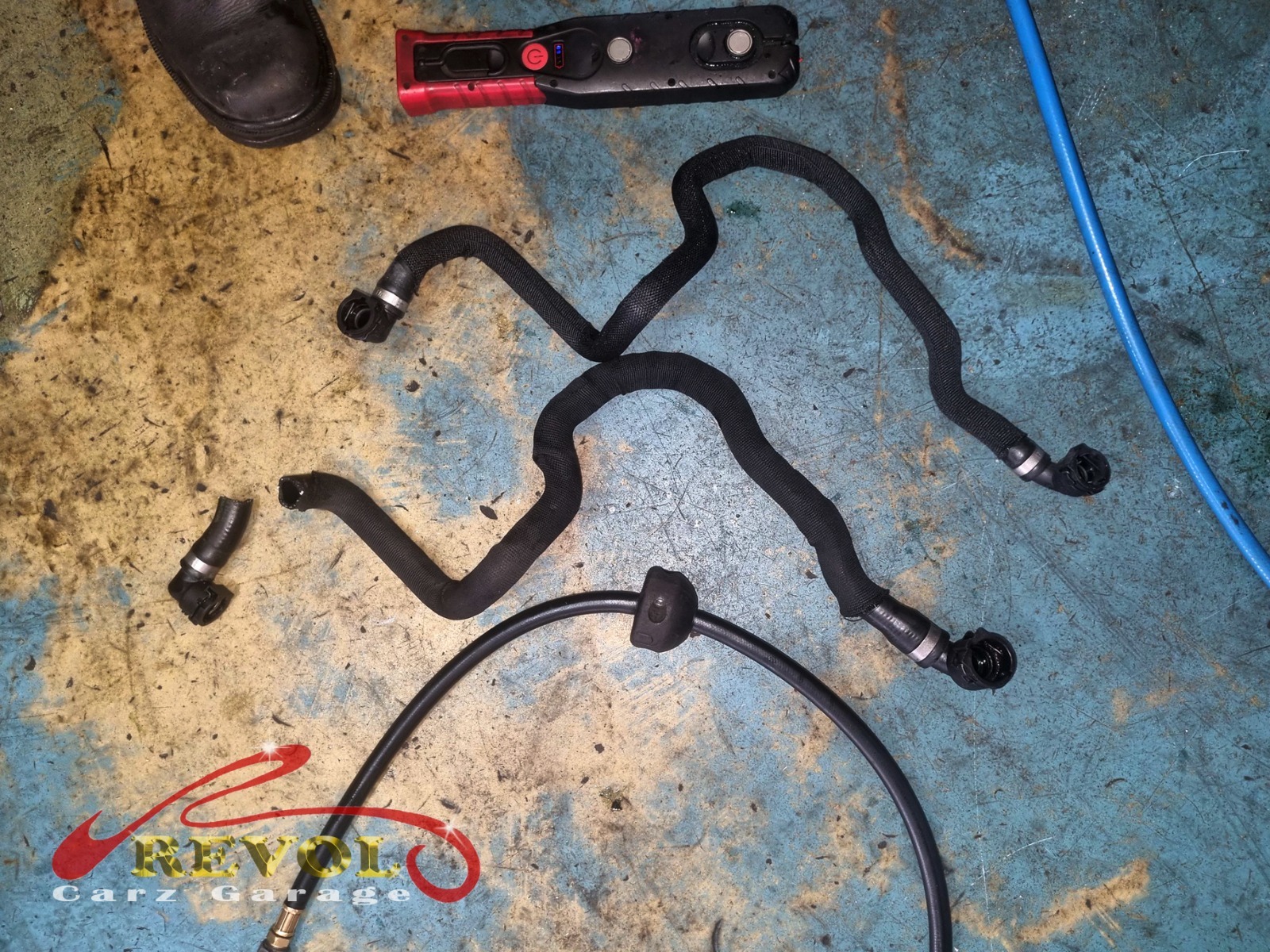

The Owner of the BMW 740Li sought expert assistance at Revol Carz Garage after noticing coolant level low warning sign.
Upon inspection, our BMW Technicians confirmed that the coolant leak was due to a deteriorated Radiator.
Replacing new Radiator restores proper cooling, protects the engine from overheating, and ensures stable and efficient performance.
Installing a new Hose guarantees proper coolant flow, prevents leaks, and keeps the engine running smoothly.

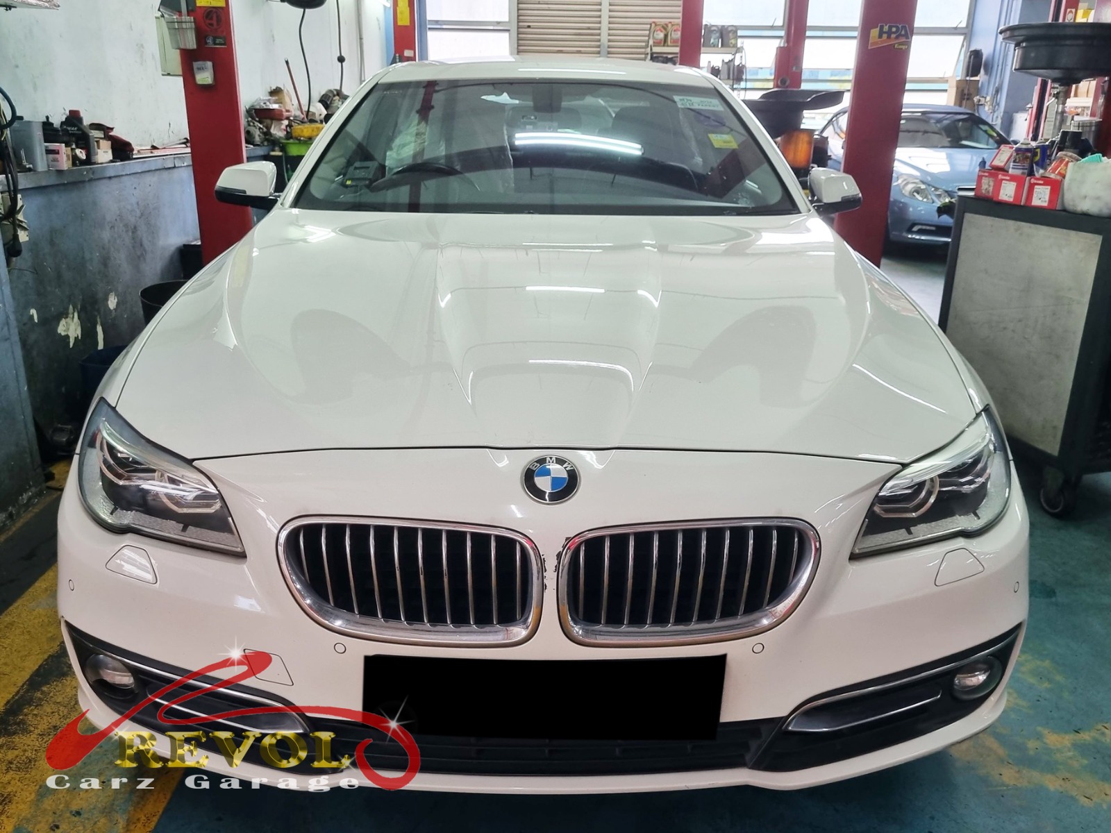

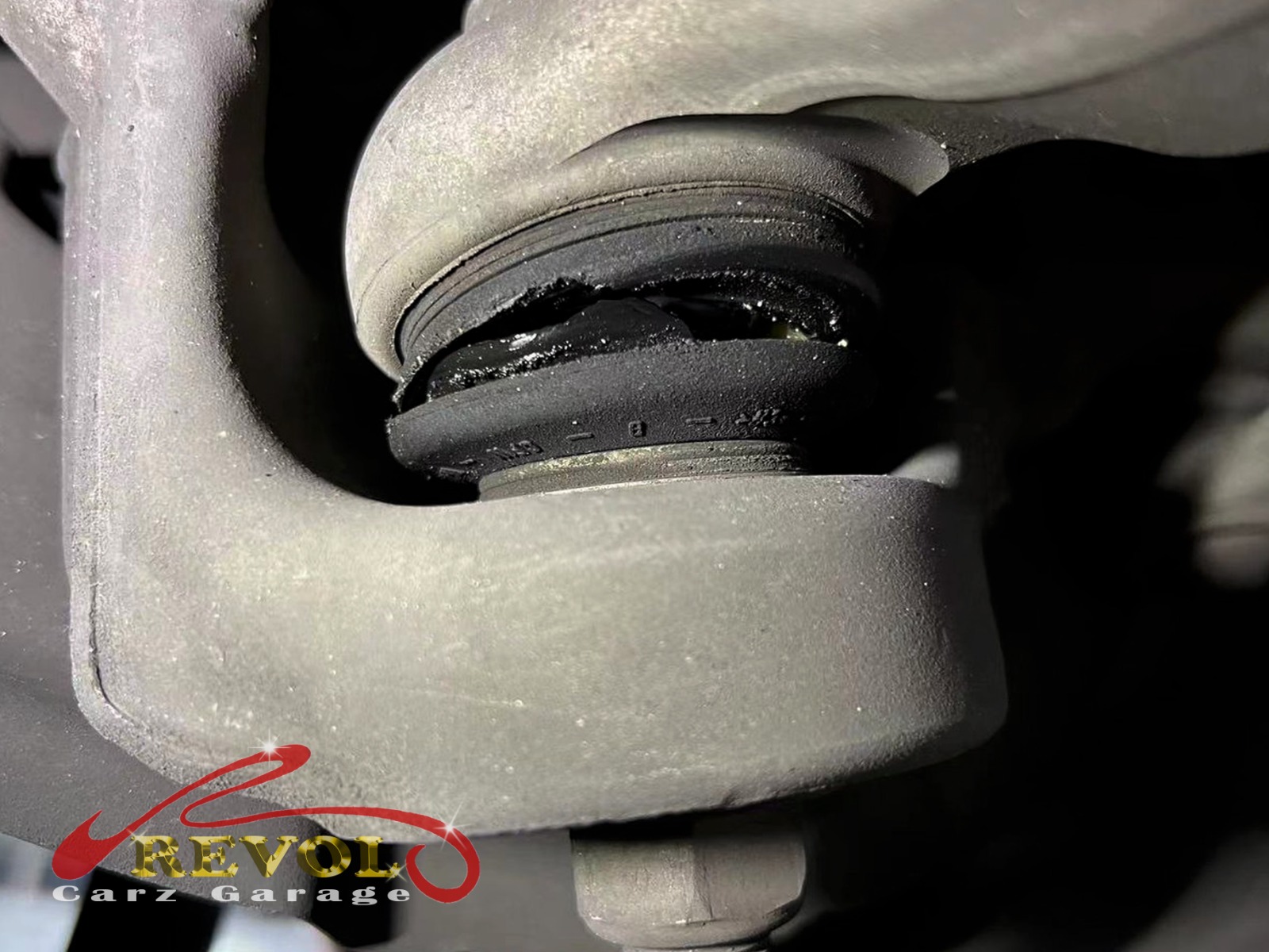

The BMW 520i Owner visited Revol Carz Garage after noticing a knocking noise when going over bumps.
Our BMW Specialist promptly hoisted the car and conducted a comprehensive inspection of the undercarriage suspension components.
Diagnosis revealed that damaged Ball Joints were responsible for the problem.
Replacing the worn components helped restore suspension stability and smooth driving performance.

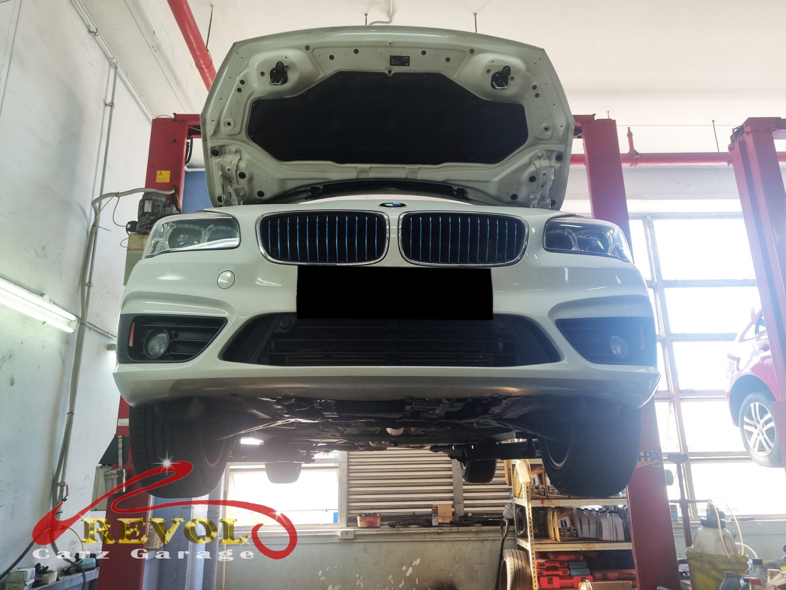

The BMW 316i Owner sought assistance at Revol Carz Garage after experiencing reduced engine power and an illuminated Check Engine Light.
The diagnostic scan by our BMW Specialist identified a faulty Turbo Shut off Valve as the source of the problem.
Installation of a new Turbo Shut off Valve helps ensure efficient turbo performance and smooth power delivery.
