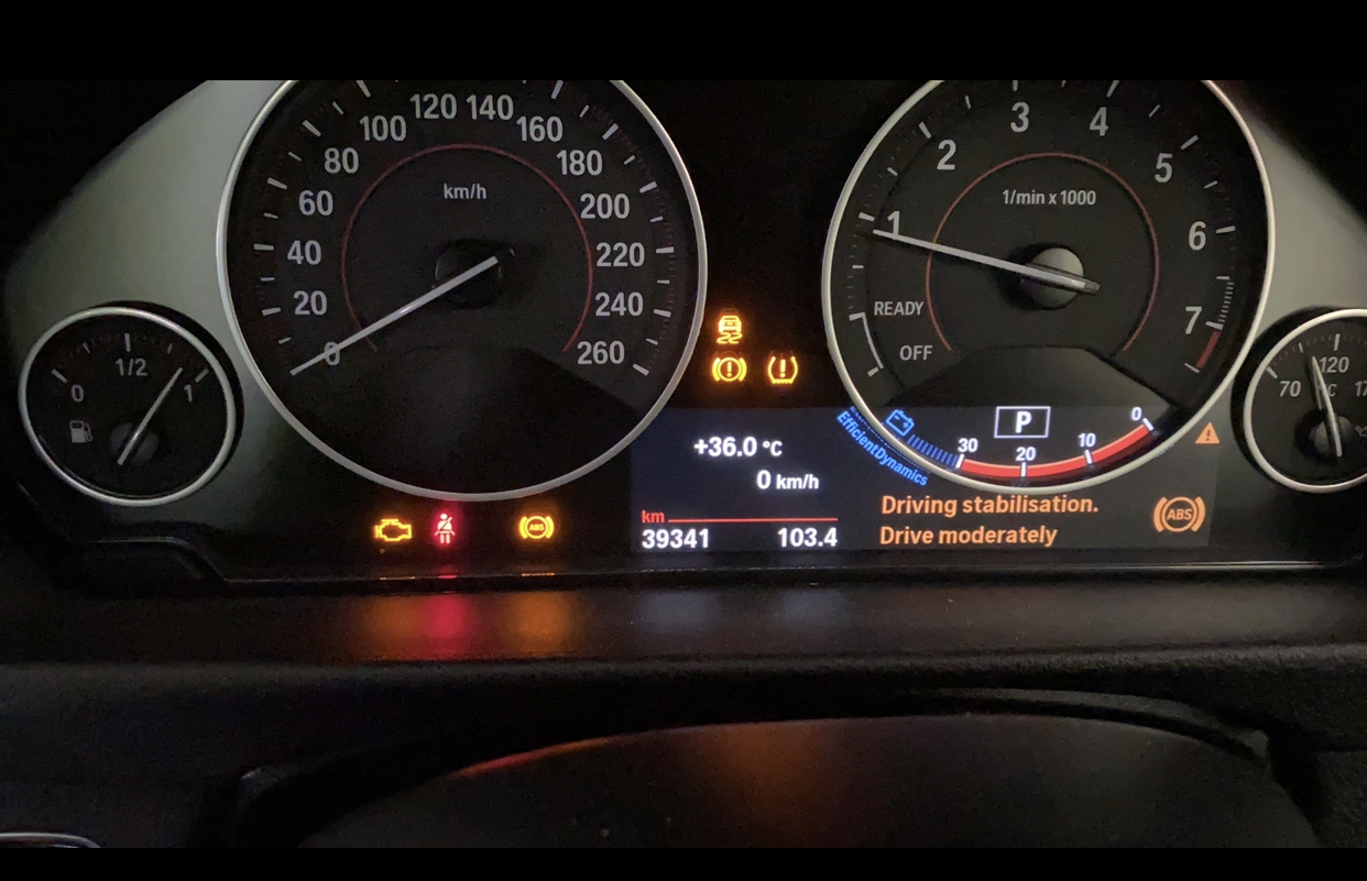

Hi ! Anyone facing ABS sensor failure issues on the 116d. I own an 2016 model year 116d. Lately I have experience error message indication stability issues requiring check by service center and asking to "drive moderately." Surprisingly my friend bought a similar unit at same time and took delivery 1 week before me also had the same problem 1 week ago. Hard to believe its a coincidence...

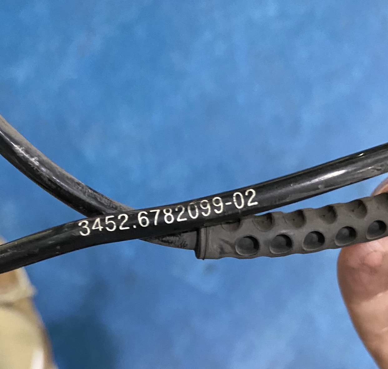

Most likely it’s the speed sensor cable that’s attached to every individual wheel. I had it replaced and all the error messages disappeared.
