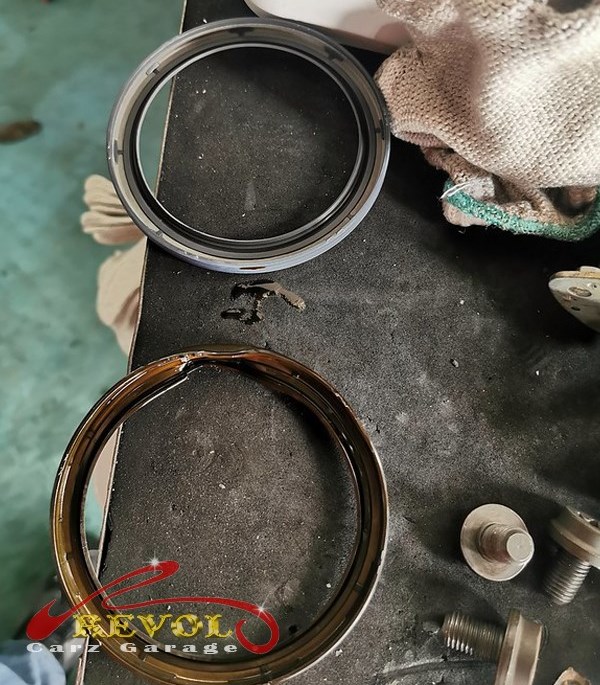

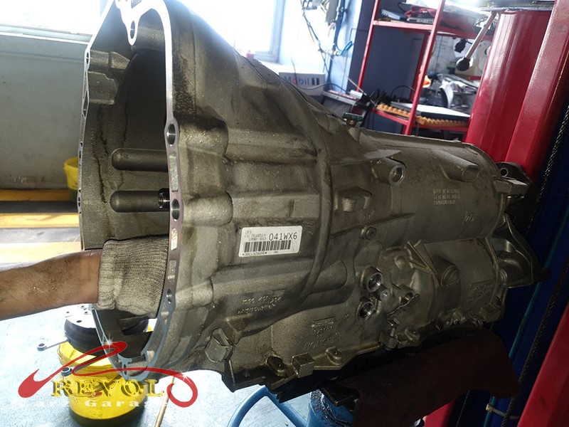

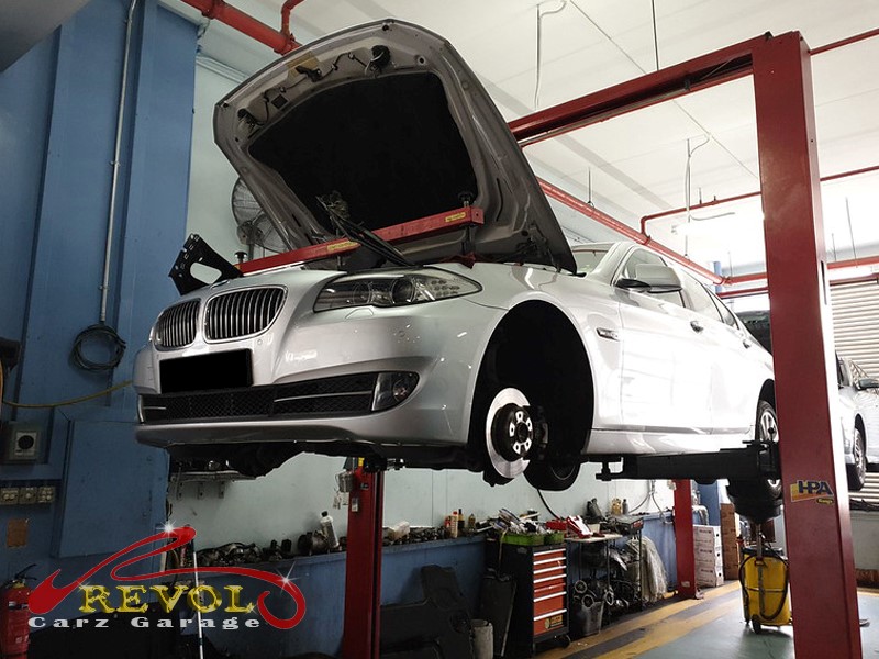

Vincent's BMW 523i is having some serious Engine oil leak and we are tasked to resolve his issue.
Vincent sends in his BMW 523i for Engine oil leak.
Car is swiftly hoisted up to allow our BMW specialist to trace the engine oil leak source.

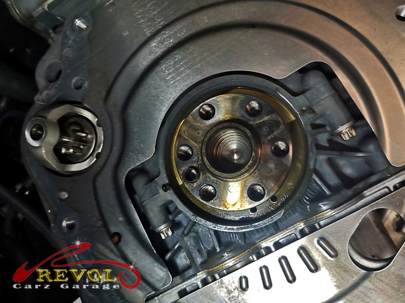

The volume of Engine oil leak is pretty big from the Flywheel oil seal.
In order to replace the Flywheel oil seal, the Gearbox have to be dismantled from the car.
The Flywheel oil seal location.
We replaced badly worn Flywheel oil seal to resolve the leak.
All done within a day with a complimentary car wash and vacuum.

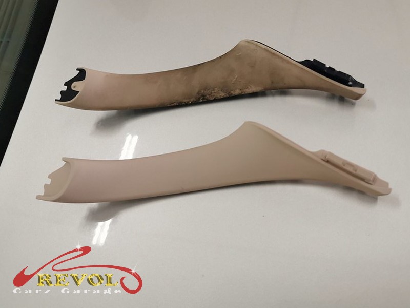

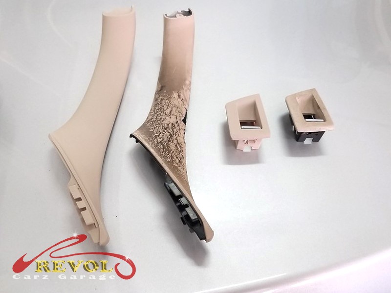

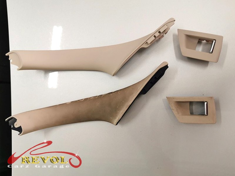

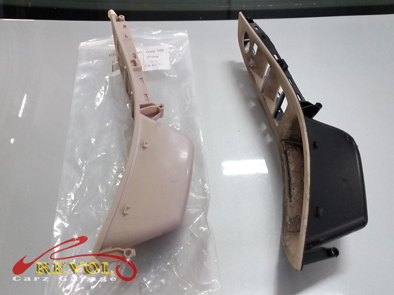

Yucky sticky door handles! That’s the comment of Miss June with her BMW 520i.
Miss June sends in her BMW 520i complaining on the sticky door handles.
And we are tasked to get it all replaced.
Including the Rear Driver door handle.
The new and used Rear door handle.
And the Passenger door handle.
We happy to return this BMW 520i to Miss June with no more sticky door handle.

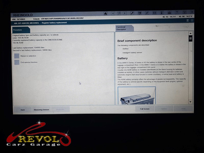

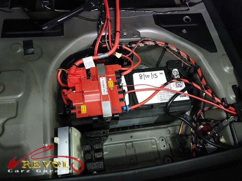

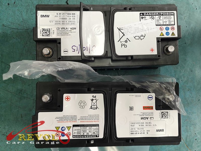

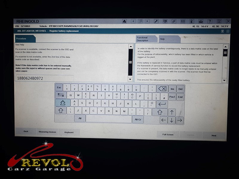

We always hear BMW Battery IBS coding, So how does it look like?
Desmond's BMW 640i came in for car servicing and needed a battery replacement.
Desmond arrives with his BMW 640i for car servicing and battery replacement.
The BMW Battery is located at the rear of the car boot.
The new battery awaiting replacement.
A proper registration will need to key in the original battery into the system.
And a proper registration will show the mileage registered with the battery size.
All car servicing will come with complimentary car wash and vacuum.

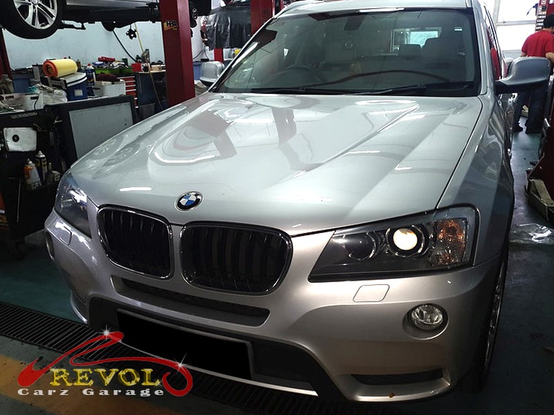

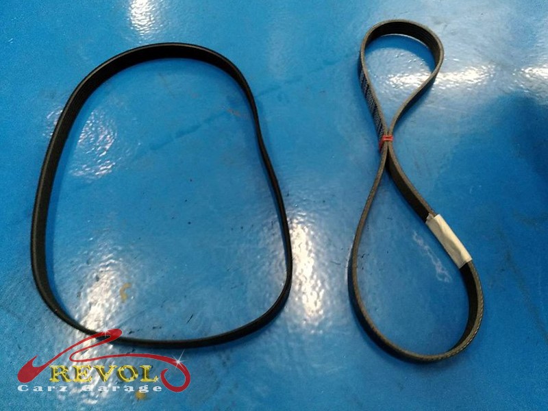

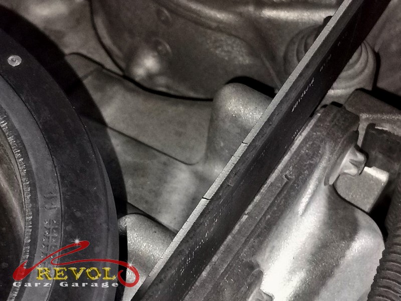

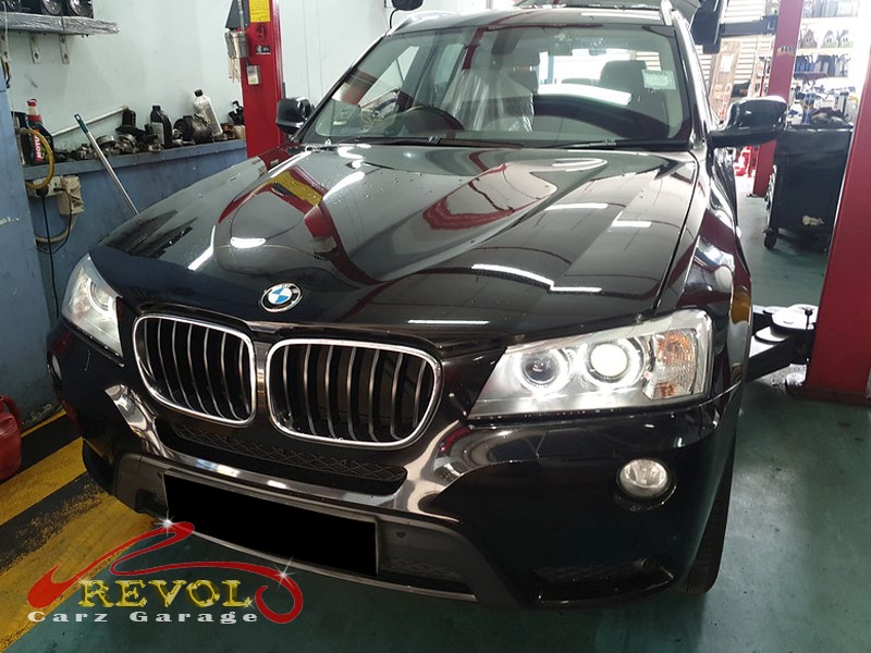

Having squeaky sound in the morning? It could be the first sign.
Mr. Richard's BMW X3 is in for a normal servicing routine and mentioned to us there is a squeaky sound normally in the morning in the engine bay.
Mr. Richard's BMW X3 sends in for normal servicing with a squeaky sound in the Engine bay.
Our Experienced BWW Specialist spotted the issue after checking , a cracked worn out Fan belt.
Once a certain mileage is met, it is always recommended to replace the Tensioner together with the Fan belt.
The new Fan belt is also replaced.
All car servicing with repairs comes with a complimentary car wash and vacuum.

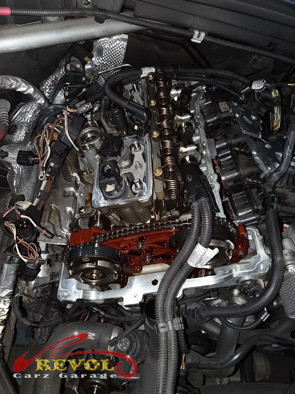

JiaZheng's BMW X3 is having some burning smell on the front and decided to visit us for a check.
JiaZheng sends in his BMW X3 with burning smell on the front.
With higher millage clocked it is normal for gasket to worn out due to the high temperature.
This Is how the F25 Engine looks like after the valve cover is removed.
Original BMW valve cover gasket awaiting replacement.
We are glad to return JiaZheng Car with no more burning smell with a complimentary car wash and vacuum.

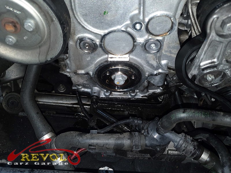

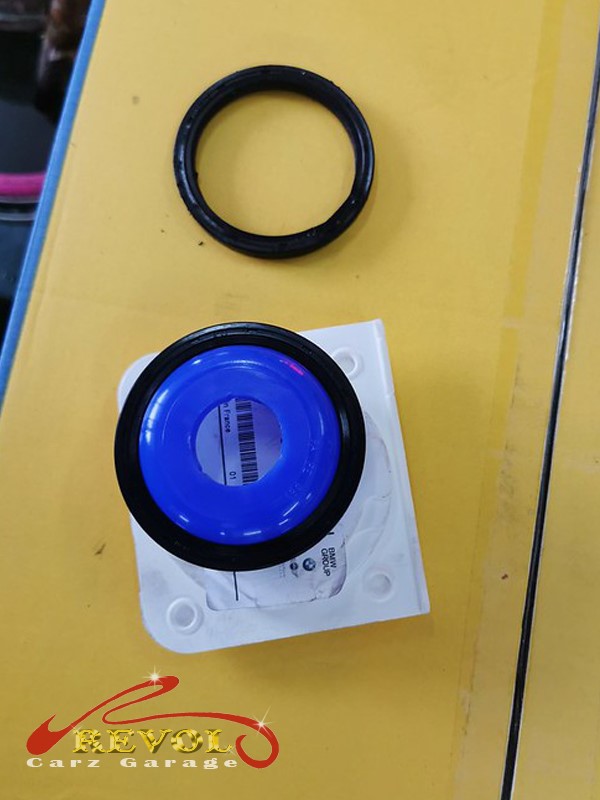

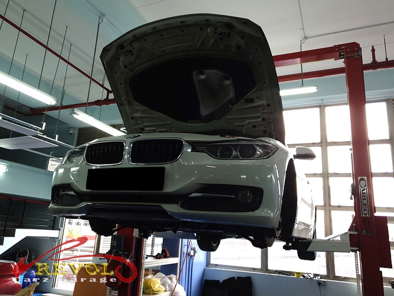

Charles BMW 320i is having some engine oil low issue and we are tasked to resolve the issue.
Charles sends in his BMW 320i because of engine oil low issue.
The car is hoisted up quickly for a check.
Our BMW specialist swiftly spotted the engine oil leak location.
Out goes the worn Timing Pulley Oil Seal.
Timing Oil Seal is ready for replacement.
We are glad to return Charles his car with a complimentary car wash and vacuum with no more engine oil leak.

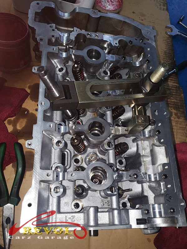

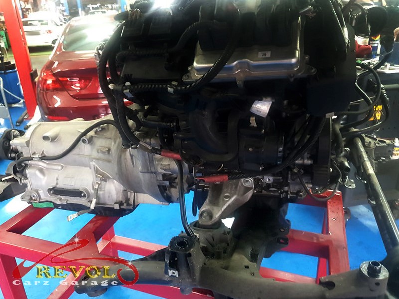

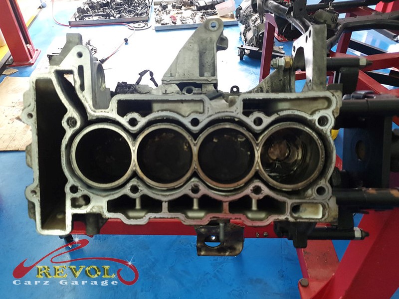

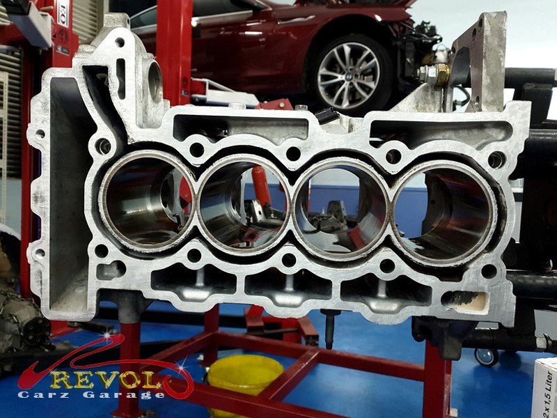

Expertise with min down time for BMW engine overhaul.
Mrs. Hoe's BMW 316i is having serious Engine issue where constant engine check light and after a complete inspection and check, our team of BMW engine confirmed the issue lies with the internal engine piston.
Mrs. Hoe drives in her BMW 316i with serious Engine issue.
The car is swiftly hoisted up to carry out the Engine Overhaul repair.
The front part is the BMW N13 Engine and the rear is the Gearbox.
The Engine is preparing to be disassembled.
All Engine parts after disassemble are placed carefully.
The Engine is further stripped to complete the Engine Overhaul
That’s the cue when you know all Engine parts have been fully stripped.

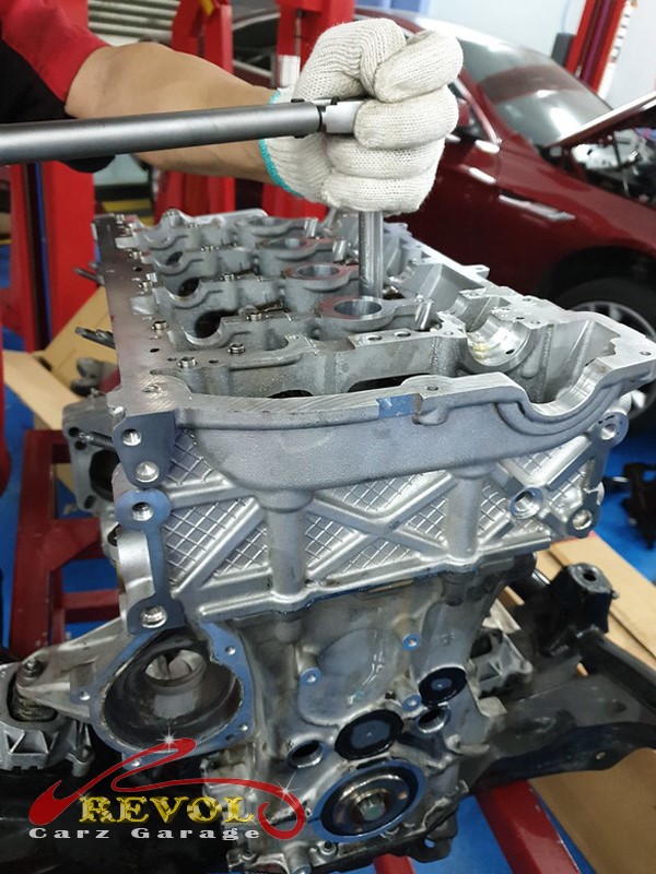

BMW special tools are required to install back some of the Engine parts.
Torque wrenches are important to ensure a balanced rotation without over tightening.
We are glad to return the car back to Mrs. Hoe with no more engine check light and a nice cleared car too.

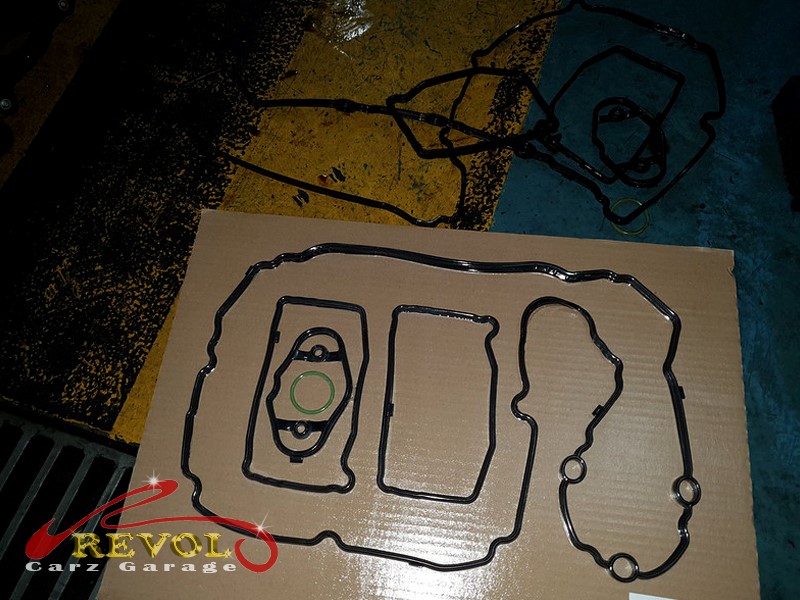

A disturbing burnt odor lingered into the cabin from the front of JiaZheng’s BMW X3 and raised an alarmed urgency to have Revol Carz Garage investigate.
JiaZheng's sends in his BMW X3 due to disturbing burnt odor smell.
Our BMW Guru followed the nose to the bad gaskets. With prolonged exposure to high engine temperature over time, the gaskets tend to become bristle and cause oil to leak. Urgent replacement of the gaskets is recommended on the earliest sign of wear.
With the Valve Cover removed, peek at the inside of the F25 engine.
A new set of original BMW Valve Cover Gaskets awaiting replacement.
Putting a soul-satisfied smile on the customer’s face always motivate us. JiaZheng was delighted that the burnt smell is gone and a welcoming fragrance lingers the freshly cleaned interior.

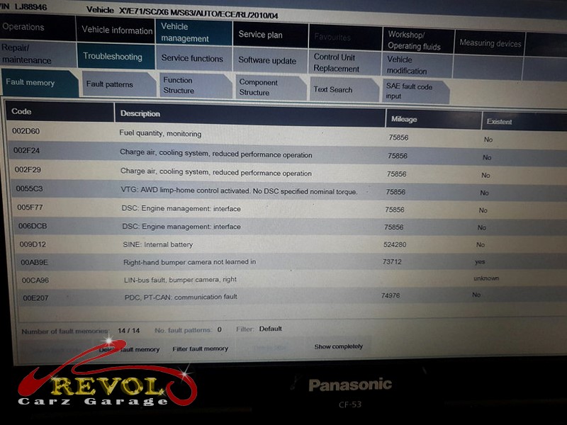

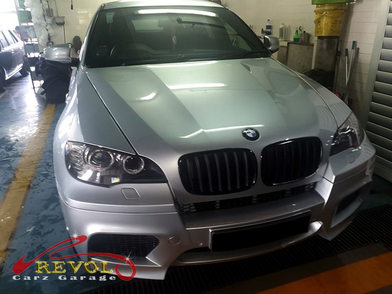

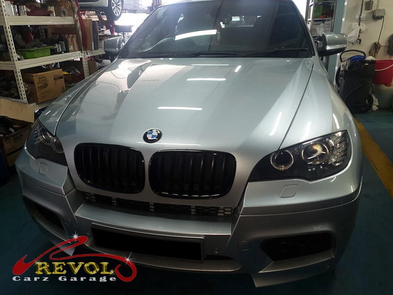

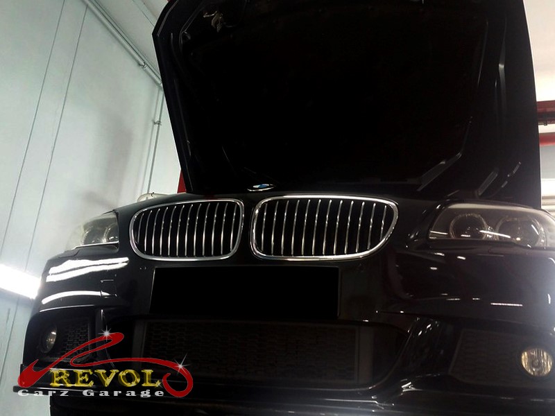

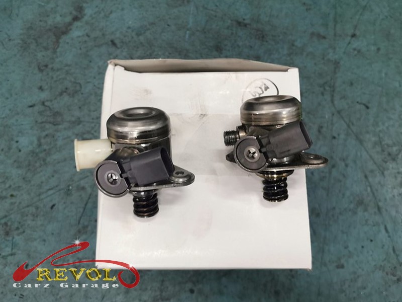

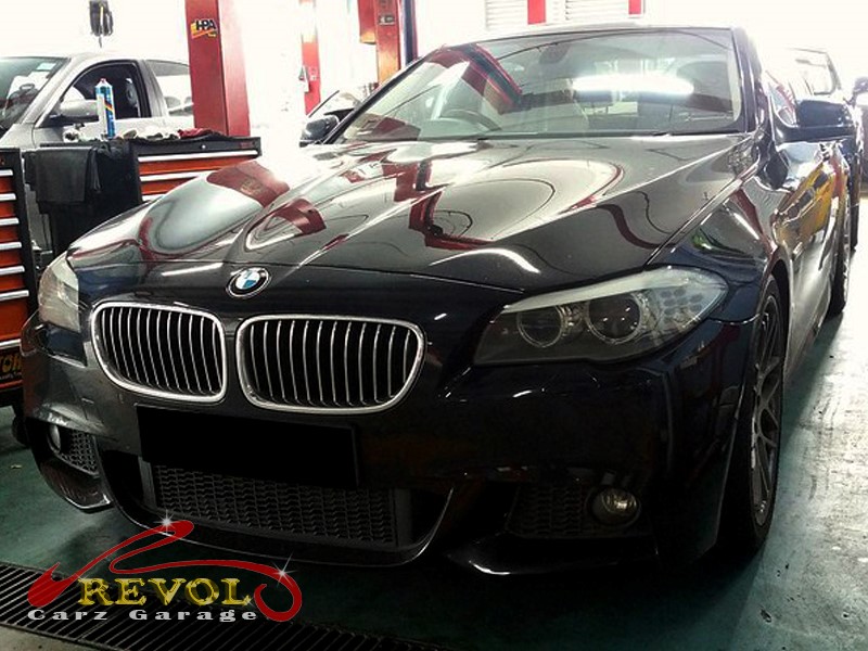

Misfirings might not be always about Ignition Coil issue.
Mr. Lim is complaining that his BMW X6 is having some misfiring issue.
Mr. Lim arrives Revol Carz Garage and would like to fix the misfiring issue on his BMW X6.
With BMW original handset it allow you to troubleshoot the clause more accurately.
In Mr. Lim's case the High Pressure Fuel Pump is giving way and we got it replaced.
Professional accurate car repair is what we deliver with a complimentary car wash on the house.

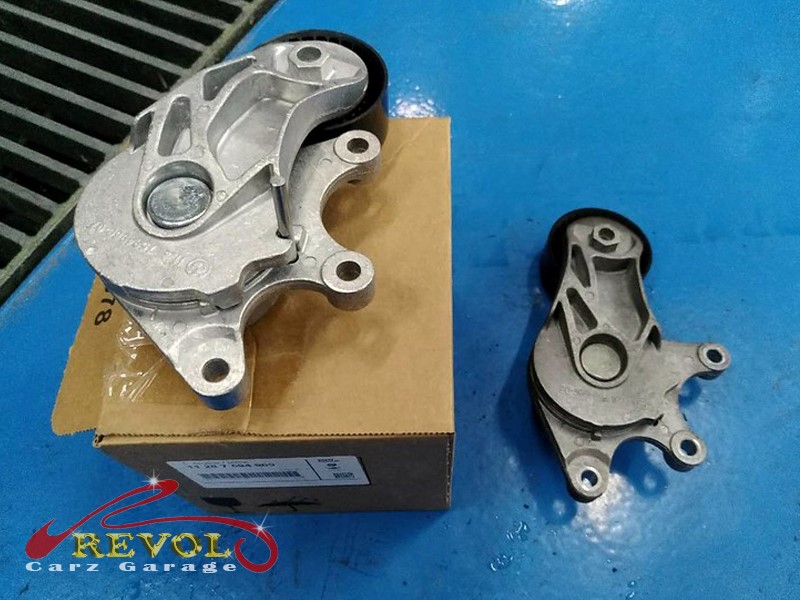

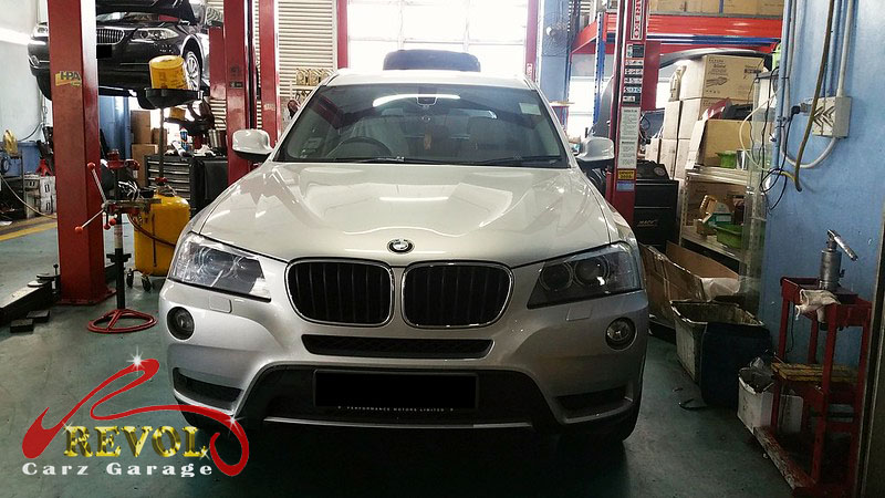

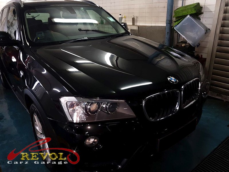

The persistent squeak from the engine compartment drove Richard up the wall. It occurs in the morning when he starts his car. Got to check in the car our workshop for a solution as well as doing a car servicing.
Richard arrives at Revol Carz Garage saying there is a squeaking noise in the engine compartment.
Our team of BWW specialists knows where to spot the issue. We didn’t find a noisy rodent but caught the badly worn Fan Belt which was the mysterious squeaky little culprit.
The Belt Tension-assembly plays an important role in efficient performance. Subjected to wear-and-tear, it should be replaced simultaneously with the Fan Belt at recommended intervals specified in the car manufacturer’s manual.
A fresh new Fan Belt is ready for the replacement.
Richard is happy that his BMW X3 is now whisper-quiet and runs smoothly after the car-servicing and the replacement of original Belt and tension-assembly. Car wash and vacuum is on the house.

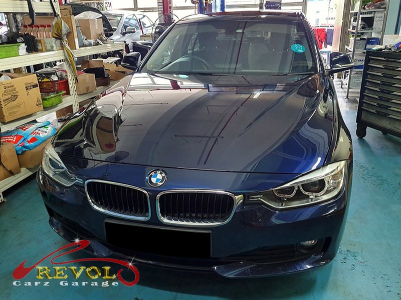

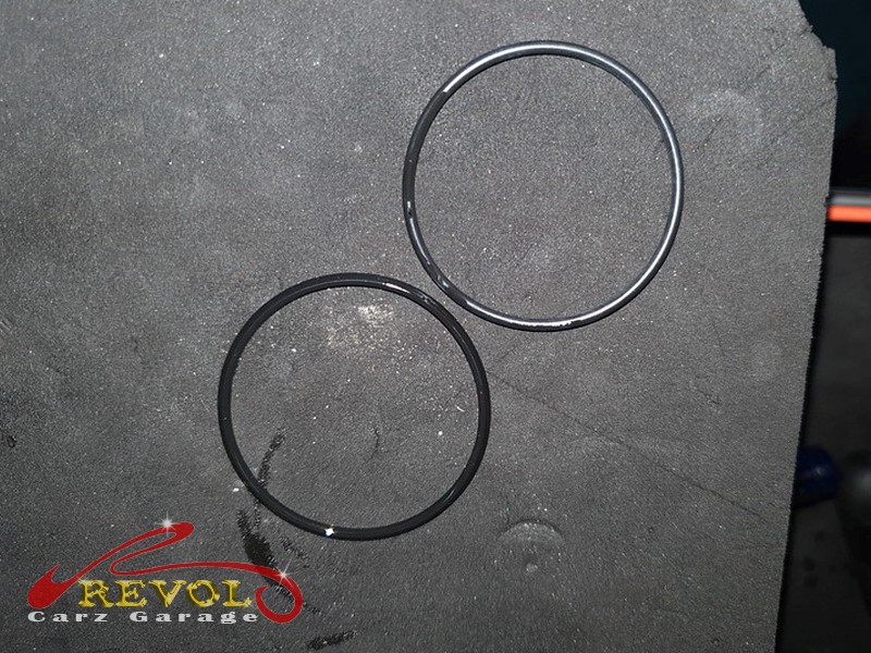

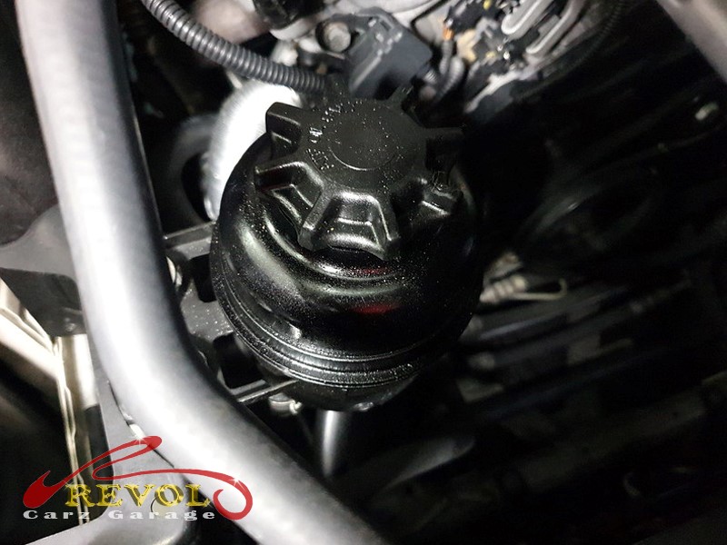

Sometimes all it takes is just an o Ring to resolve the issue.
Jill arrives with her BMW 320i for normal servicing, however our specialist found a leaking Power Steering Tank.
Jill's BMW 320i is in for a normal servicing routine.
The car is hoisted up for a 360 degree check.
The only issue she have for her car is a leaking Power Steering Tank.
All it take is just an O-ring to resolve the leakage with the interest of you.
All car servicing comes with a complimentary car wash and vacuum.

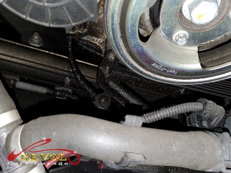

Revol is about delivering professional repair standards.

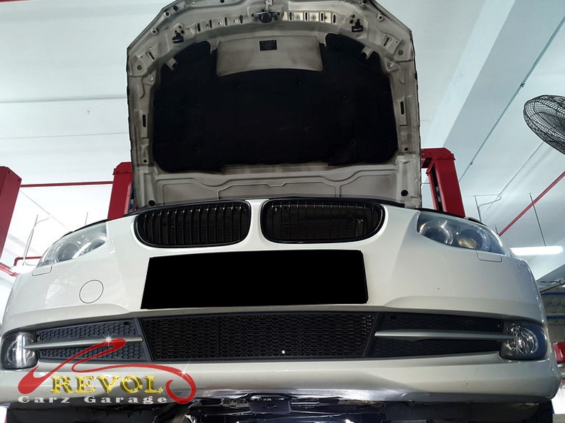

We are tasked to resolve “Engine Low Oil” issue on Charles’ BMW 320i.
Charles arrives with his BMW 320i having Engine Low Oil issue.
The car is lifted for a thorough visual inspection.
The wet undercarriage is an obvious indication of engine oil leakage.
The source of the leak pointed to the bad Pulley Oil Seal.
Out goes the bad seal and in comes the new original replacement.
Another job professionally completed. Charles got his car delivered in breathtaking clean condition; washed and vacuum with compliment of Revol Carz Garage.

You don’t always point your finger at the Ignition Coils for engine misfiring.
With the BMW specified diagnostic scan handset, we are able to accurately pinpoint the cause of the misfiring issue.
Mr. Lim’s BMW X6 encounters engine misfiring issue.
The diagnosis indicated that the High Pressure Fuel Pump was faulty and needs to be replaced.
Experience and skillful diagnosis lead to delivering accurate repair thus saving precious time and money. As a token of appreciation, complimentary car wash and interior vacuuming is on the courtesy of the house.

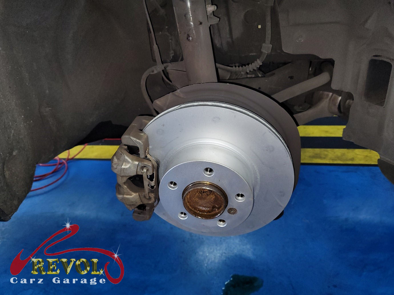

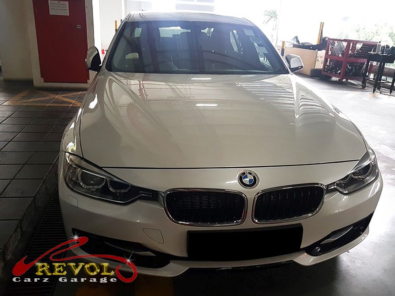

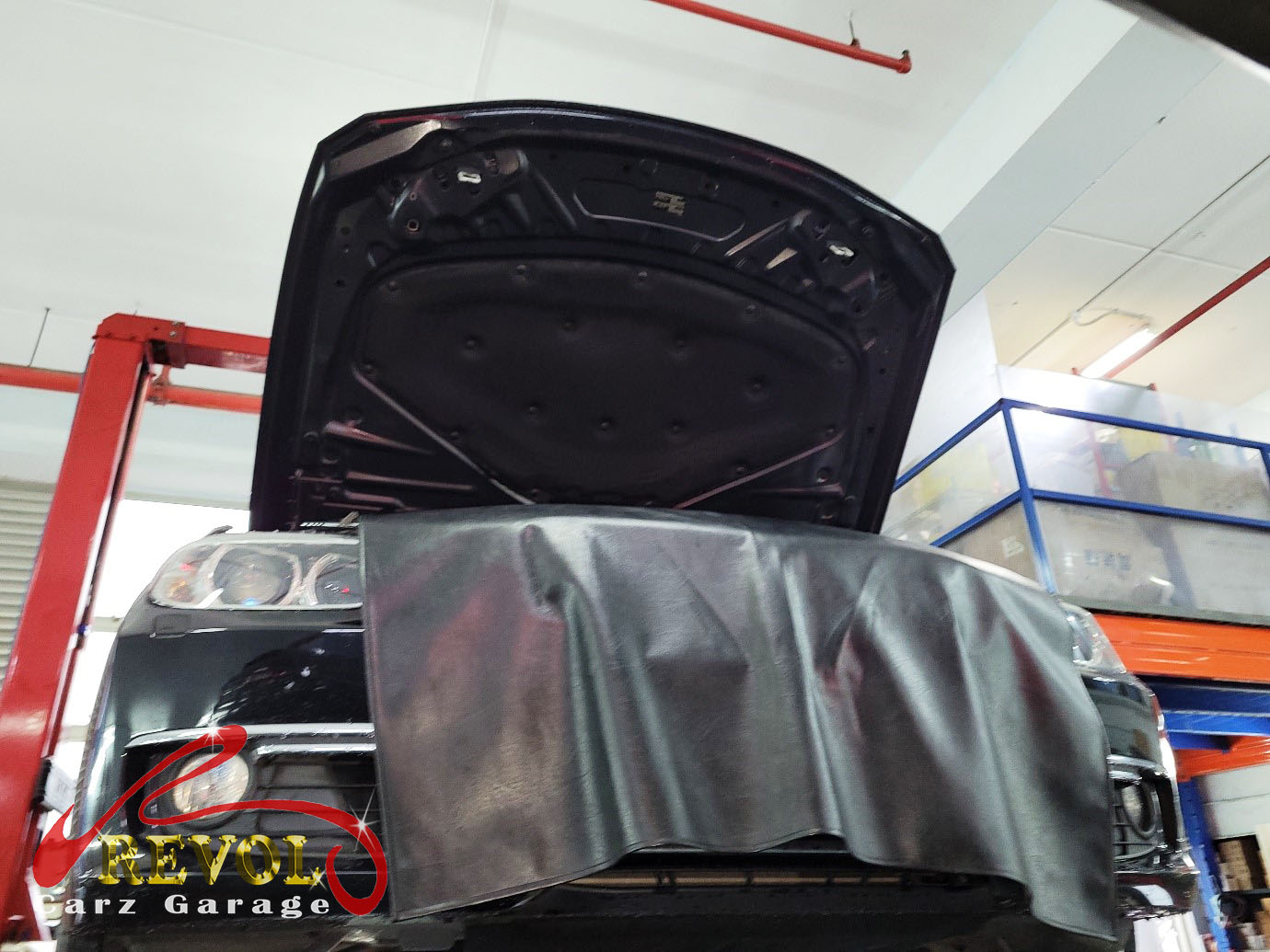

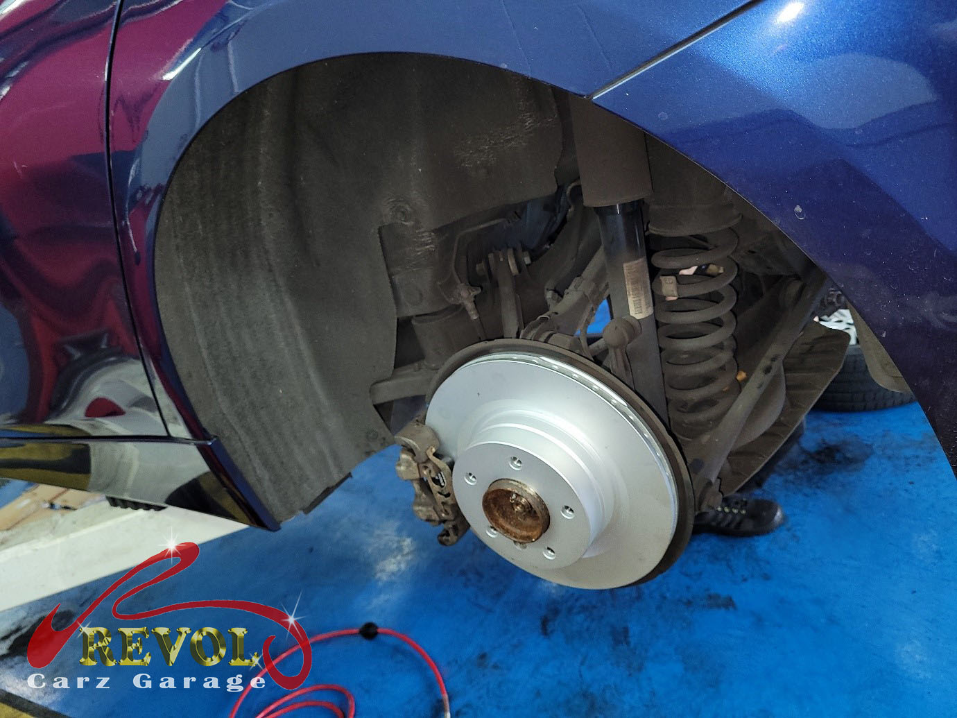

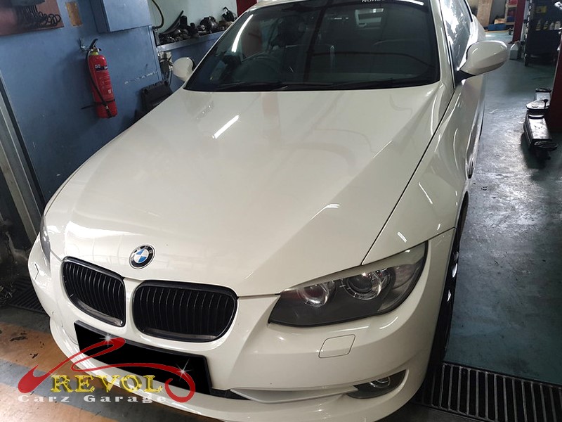

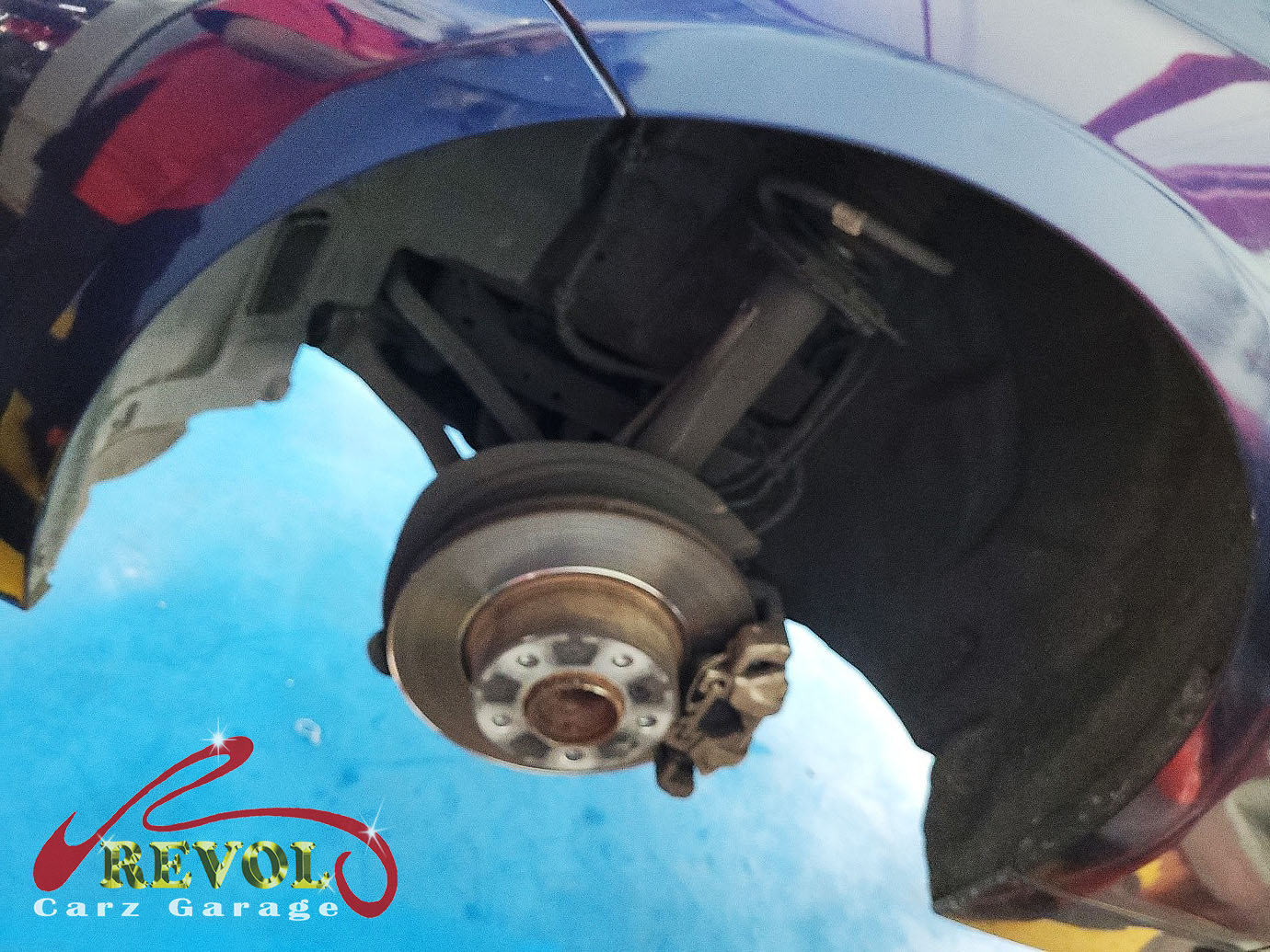

The BMW 318i diverted to Revol Carz Garage when the dashboard flashed a warning light reminding that the Front Brakes were worn below the minimum depth.
Brake Light coming on is another indicator of worn Brake Pads and Rotors.
Mr. Kelvin drives down to Revol Carz Garage when the dashboard flashed a Brake warning light.
The worn down Brake Pads and rotor before dismantling.
Heavily worn-down Rotor and Brake Shoes.
New replacement factory Rotors and Brake Shoes are installed.
Now both Front Brakes are installed with original Rotors and Brake Shoes. The Brake Wear Sensor is also replaced and reset.
The BMW 318i was subjected to stringent QC checking all the boxes before heading to the washing bay for a complimentary foam wash and interior cleaning.

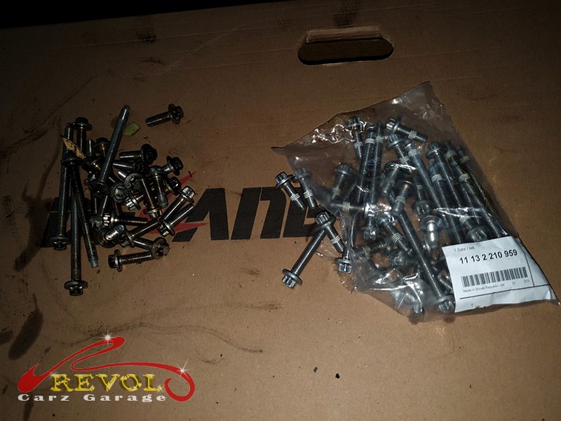

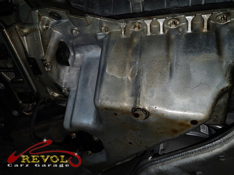

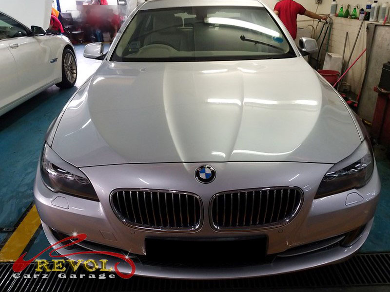

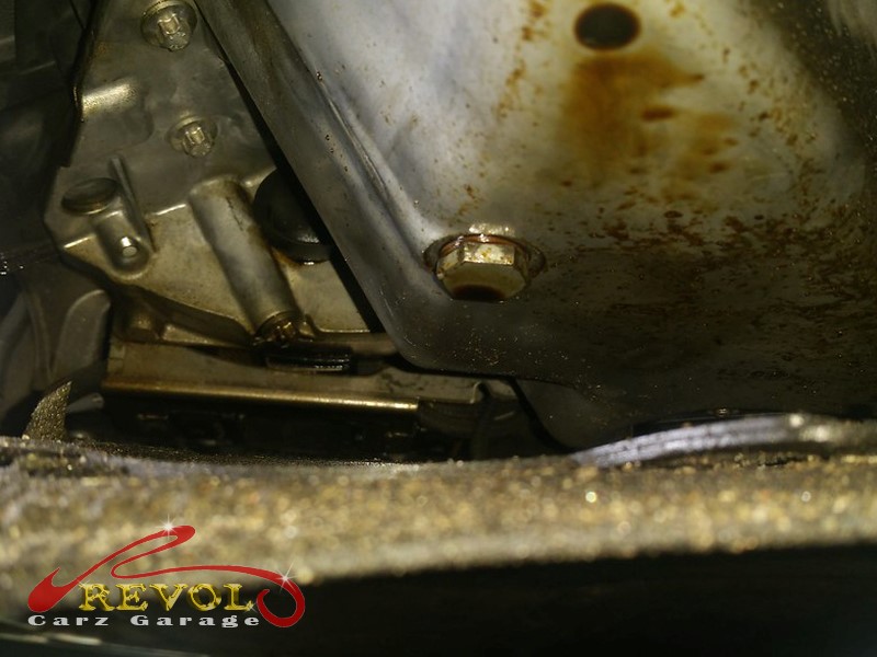

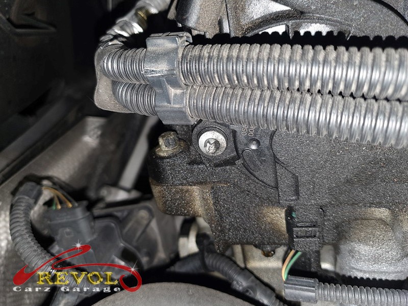

Some Bolts are not Meant to be saved.
Mr. Tan car is referred by our customer and visited us to resolve his troubling Engine Oil leak issue.
Mr. Tan came to Revol Carz Garage as he was referred by one of our customer due to his troubling Engine Oil leak issue.
Despite being replaced of the Oil Sump Gasket the oil leak remains, what could be the issue?
The car is hoisted up with the engine hooked.
This is how it looks like after the Engine Oil Sump have been removed.
At Revol Carz Garage, out strict protocol is to ensure the Oil Sump is to be washed clean before placed back.
Never save on these bolts during Oil Sump Gasket replacement as it allow you to spend double money and effort!

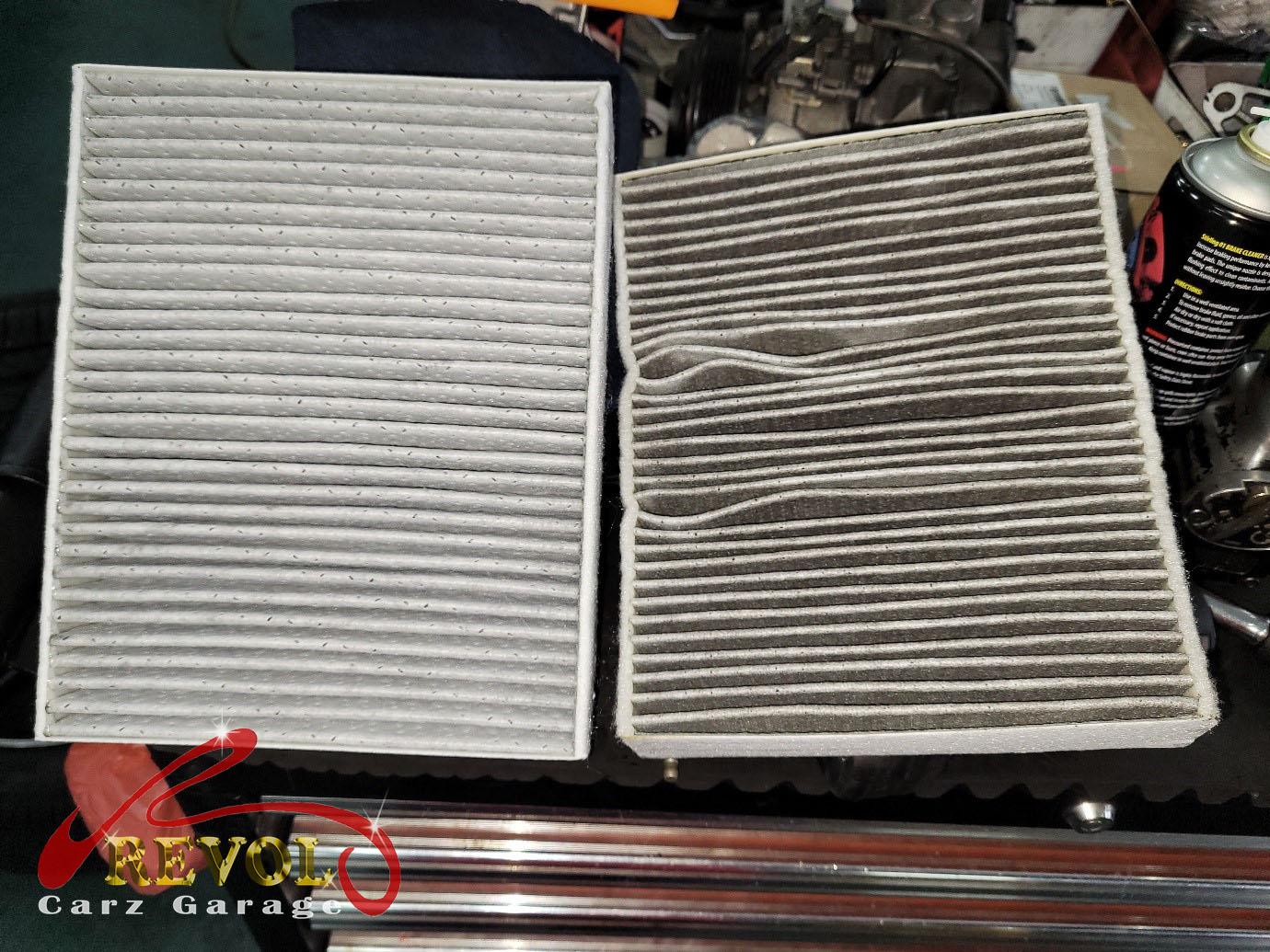

Fresh Air Filter keeps the air circulation in your vehicle clean and helps protect your lungs.
Generally, your Engine Air con Filter should be replaced at every 30000 km depending on your driving conditions. When the Air con Filter gets dirty, it clogs and restricts air flow.
