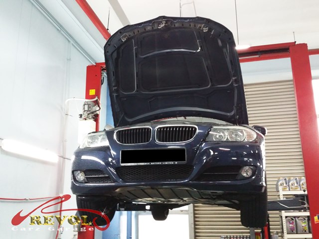

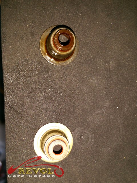

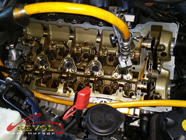

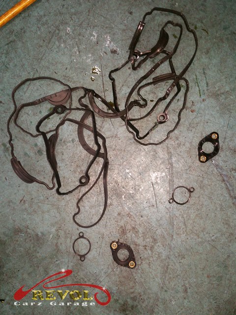

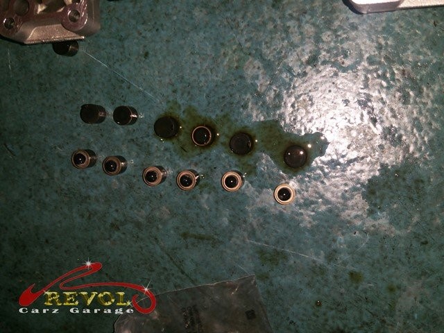

A BMW 318i had the blue smoke emission problem and had the valve seals replaced by Revol
The BMW is lifted for repair works followed by routine safety inspection and maintenance of the undercarriage.

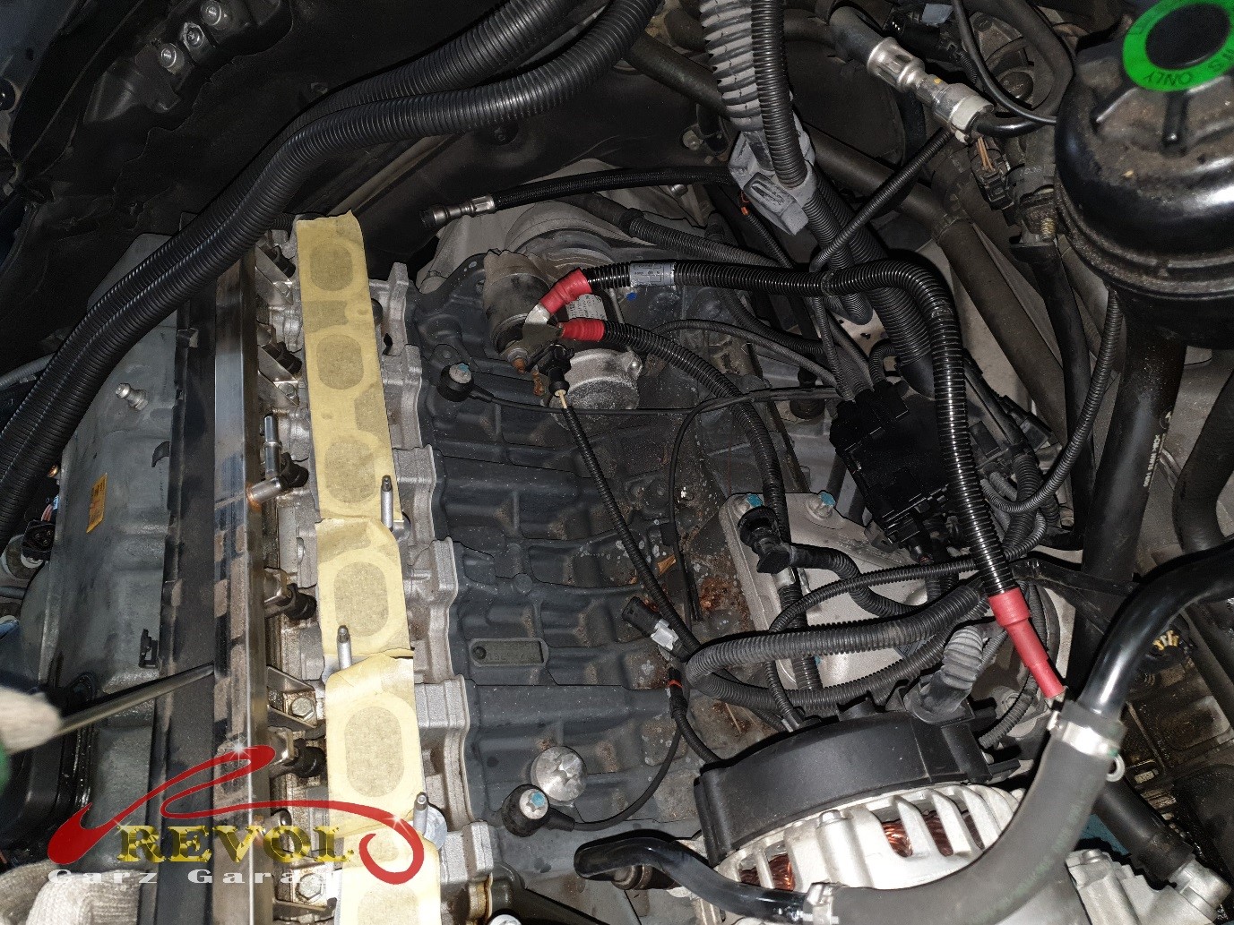

Valve seals replacement in progress.
Valve cover gasket replacement work is in progress.
New valve cover gasket awaiting replacement
New valve seals ready for replacement.

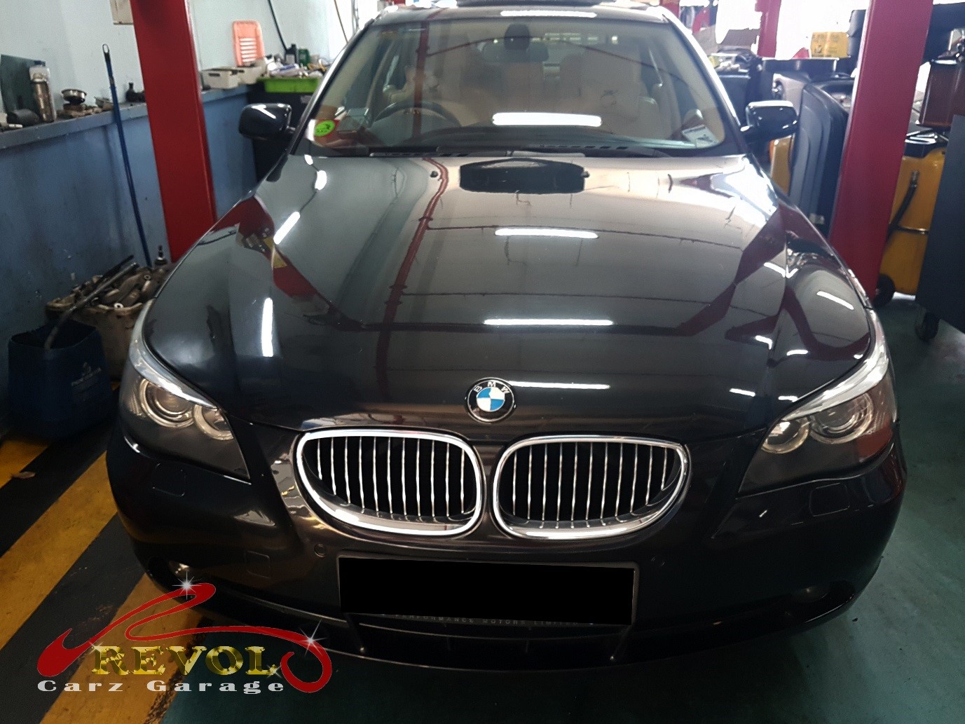

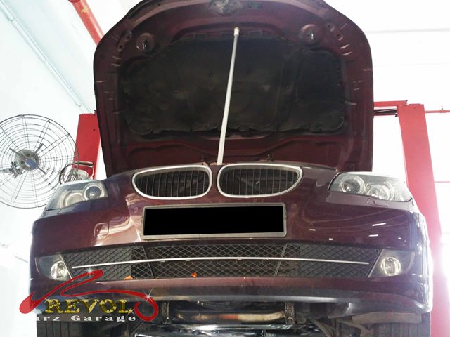

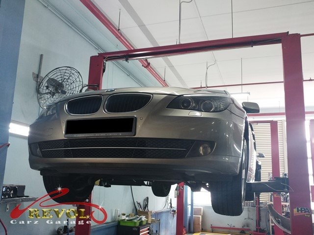

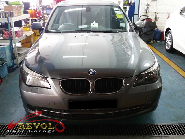

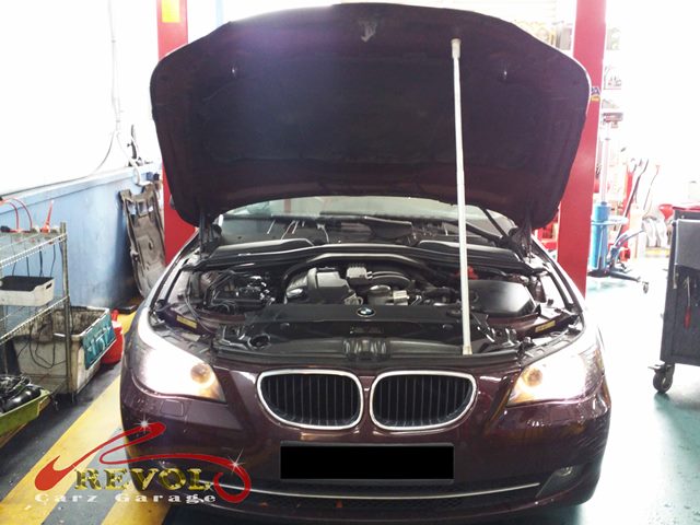

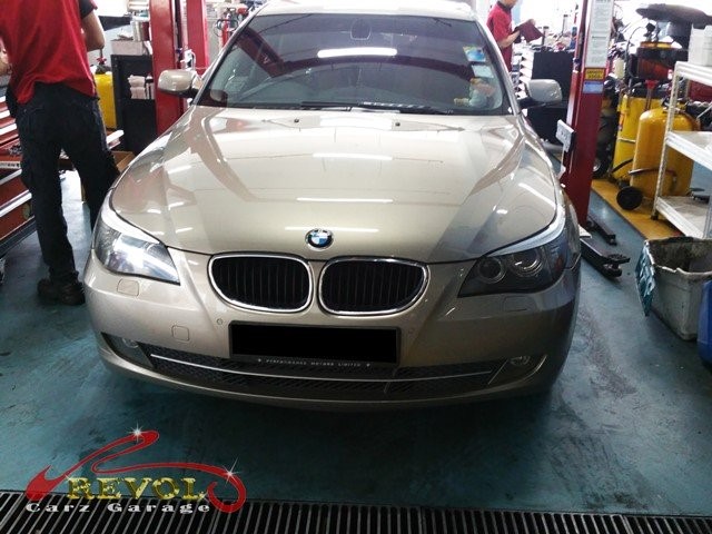

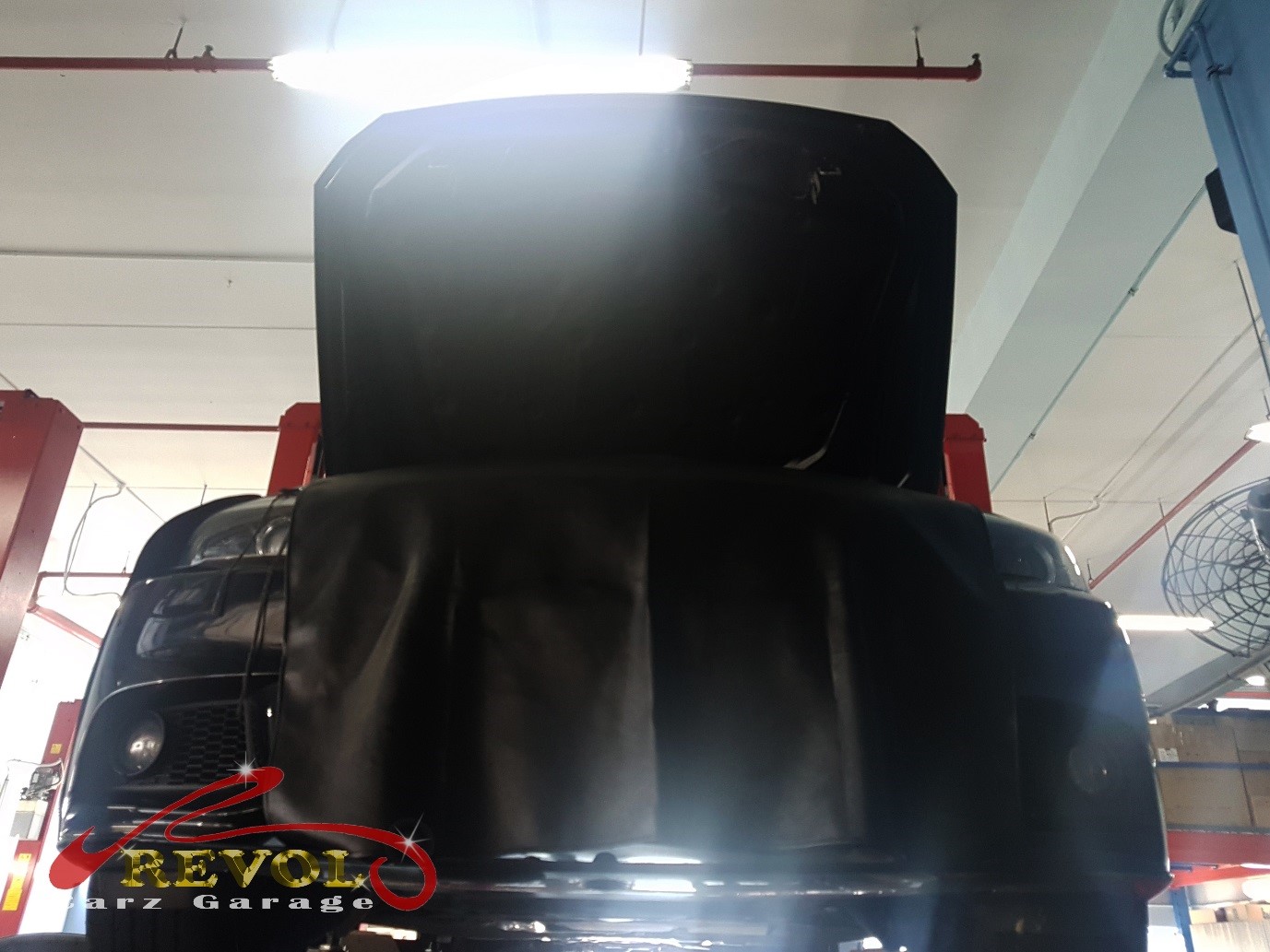

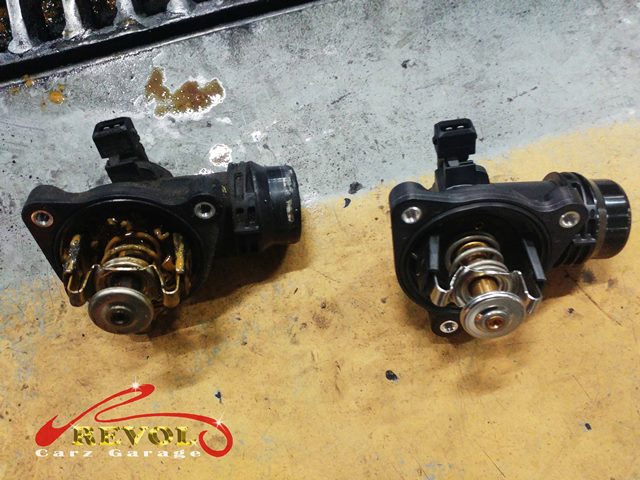

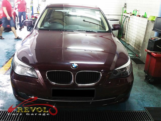

A BMW 520I E60 arrived at Revol Carz Garage for a thermostat replacement
The 520i is lifted for thermostat replacement works and general safety inspection.
New thermostat awaiting replacement.

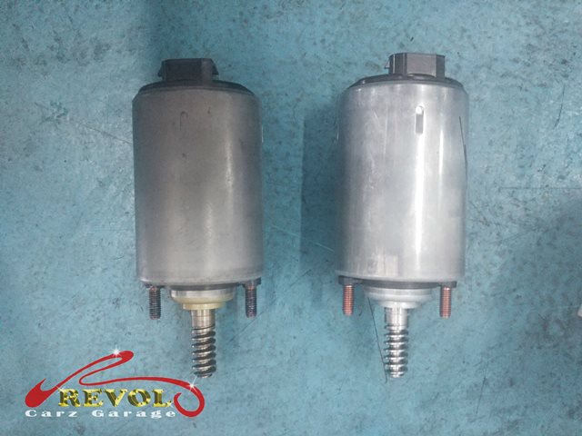

The Servo-motor is used on BMW models with normally-aspirated engine. It is responsible for actuating an eccentric shaft that adjusts intake valve lift.
Symptoms of failing Valvetronic (Servo) motor:
Brake, ABS, and 4X4 lights all lit. Clicking / juddering sound from transfer case “4X4 inactive” message.
The Cause:
Attached to the transfer case is an actuator motor with nylon plastic gear within which turned by a metal worm gear. Over time the nylon gear wears out and leads to the gear slipping. This can result in the symptoms describe above.
The Solution:
Replace the Servo or Valvetronic motor at Revol Carz Garage.

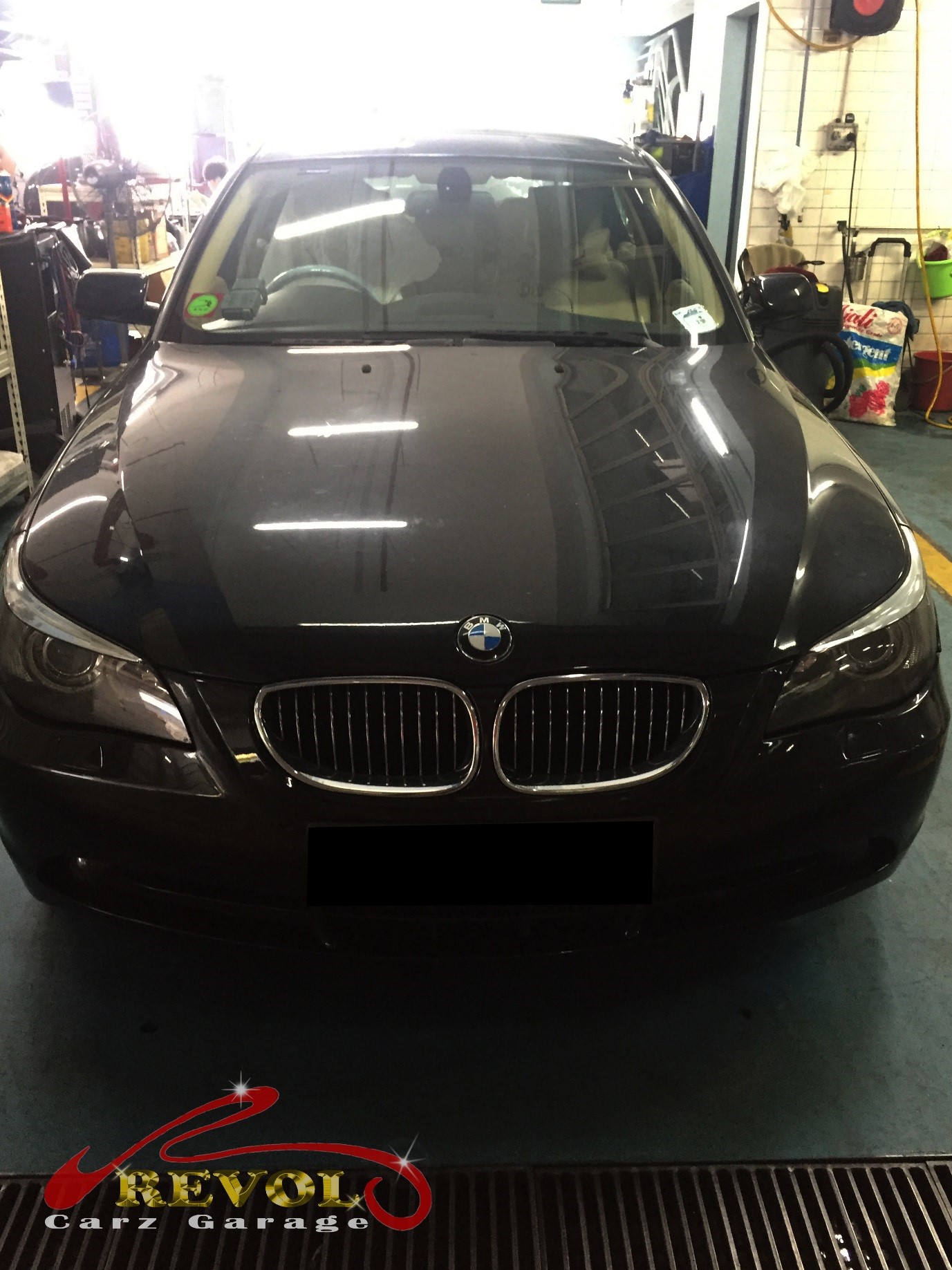

A BMW 520I has its servomotor replaced at Revol Carz Garage.
New original Servo motor is ready for replacement.
The new servomotor has been successfully installed

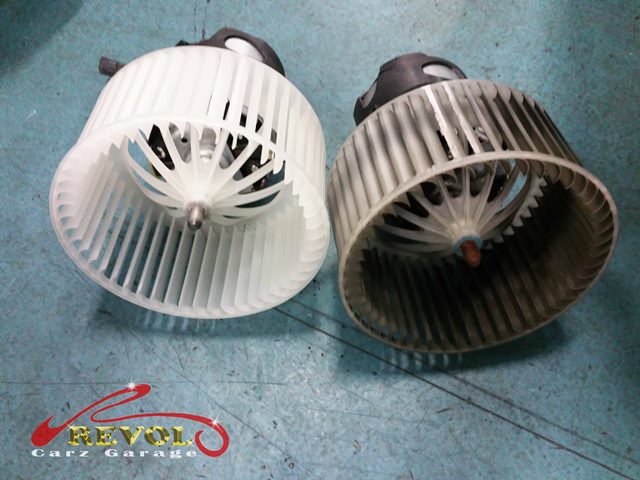

Car air conditioner blower motor generates forced cool air through the ventilations. The fan speed and temperature can be controlled through switches and dials on the car dashboard.
Faulty motors can cause poor air circulation, noisy operation or no cold air blows through the ventilations.
Diagnosing these complaints often begin with checking the electrical systems connecting the blower motor.
In extreme cases, we discovered rodents trapped in the fan chamber.
When all the diagnoses confirm the motor has indeed broken down, we recommend replacement of the blower motor.
Please feel free to drop by our Revol Carz Garage at Blk 10, Ang Mo Kio Industrial park 2a # 02-18 Ang Mo Kio Autopoint or contact us at 6555 1171.
You may also text us by SMS / Whatsapp to Gavin at 9740 6855 for friendly and absolute no obligation consultation.
All cars serviced and repaired at Revol Carz Garage receive complimentary car wash and vacuuming of the interior

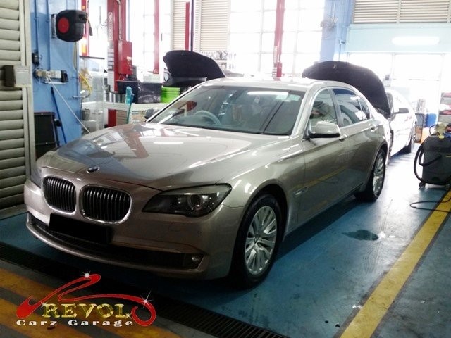

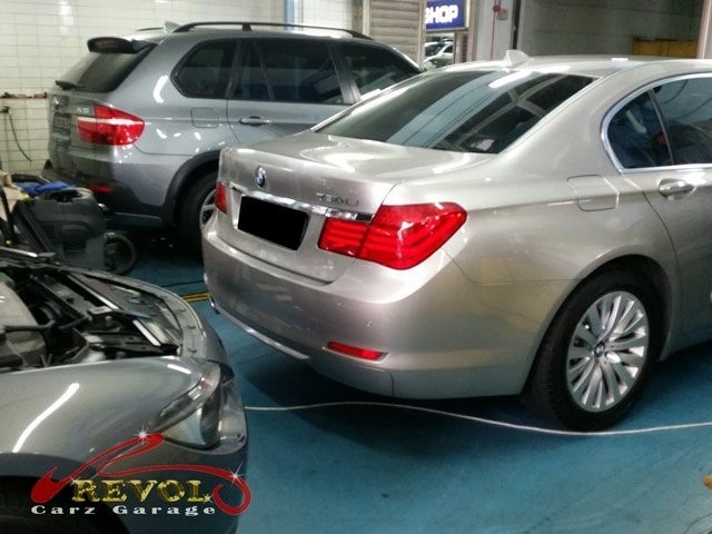

Here is a BMW 730LI patronizing Revol Carz Garage for the air condition blower motor replacement
Brand new blower motor awaiting replacement

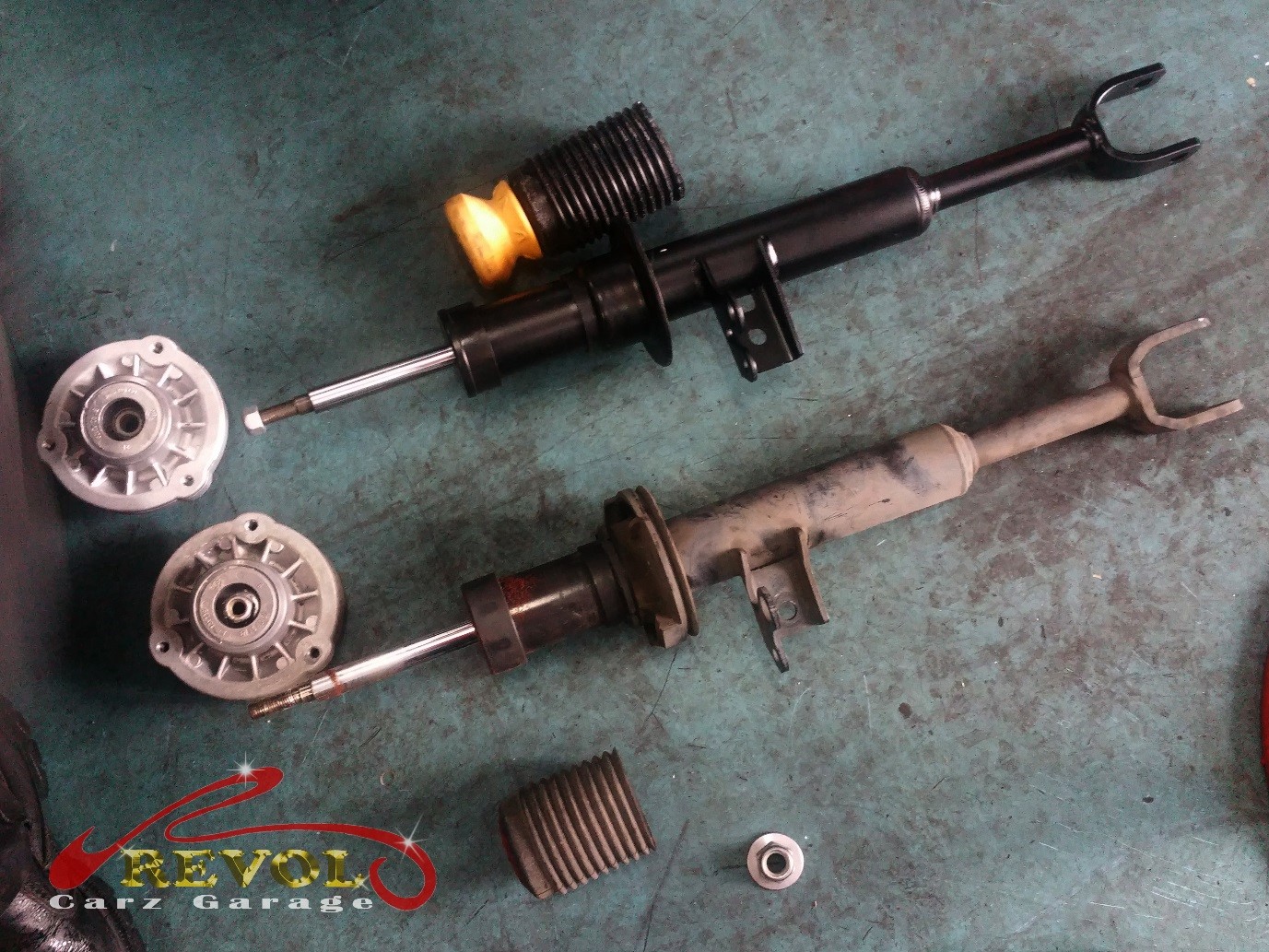

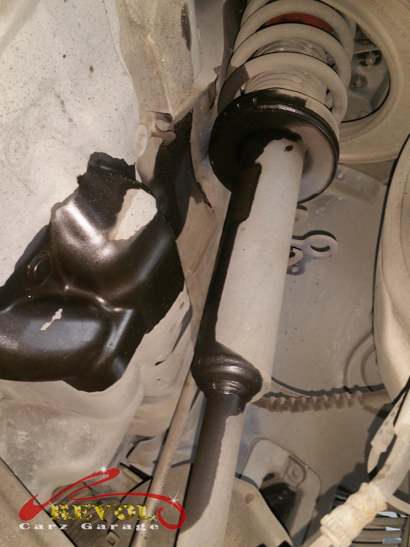

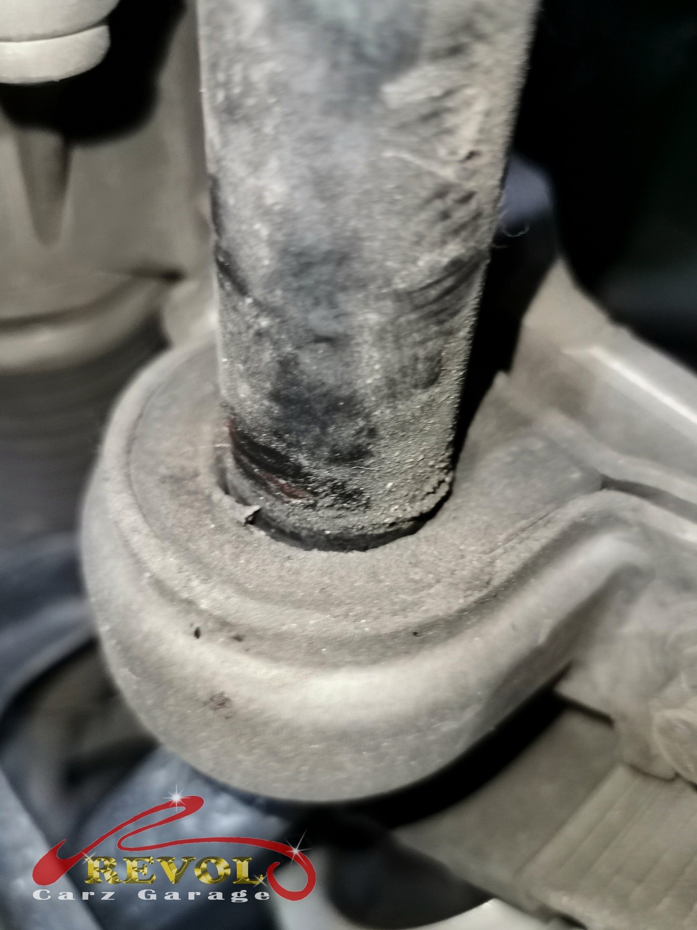

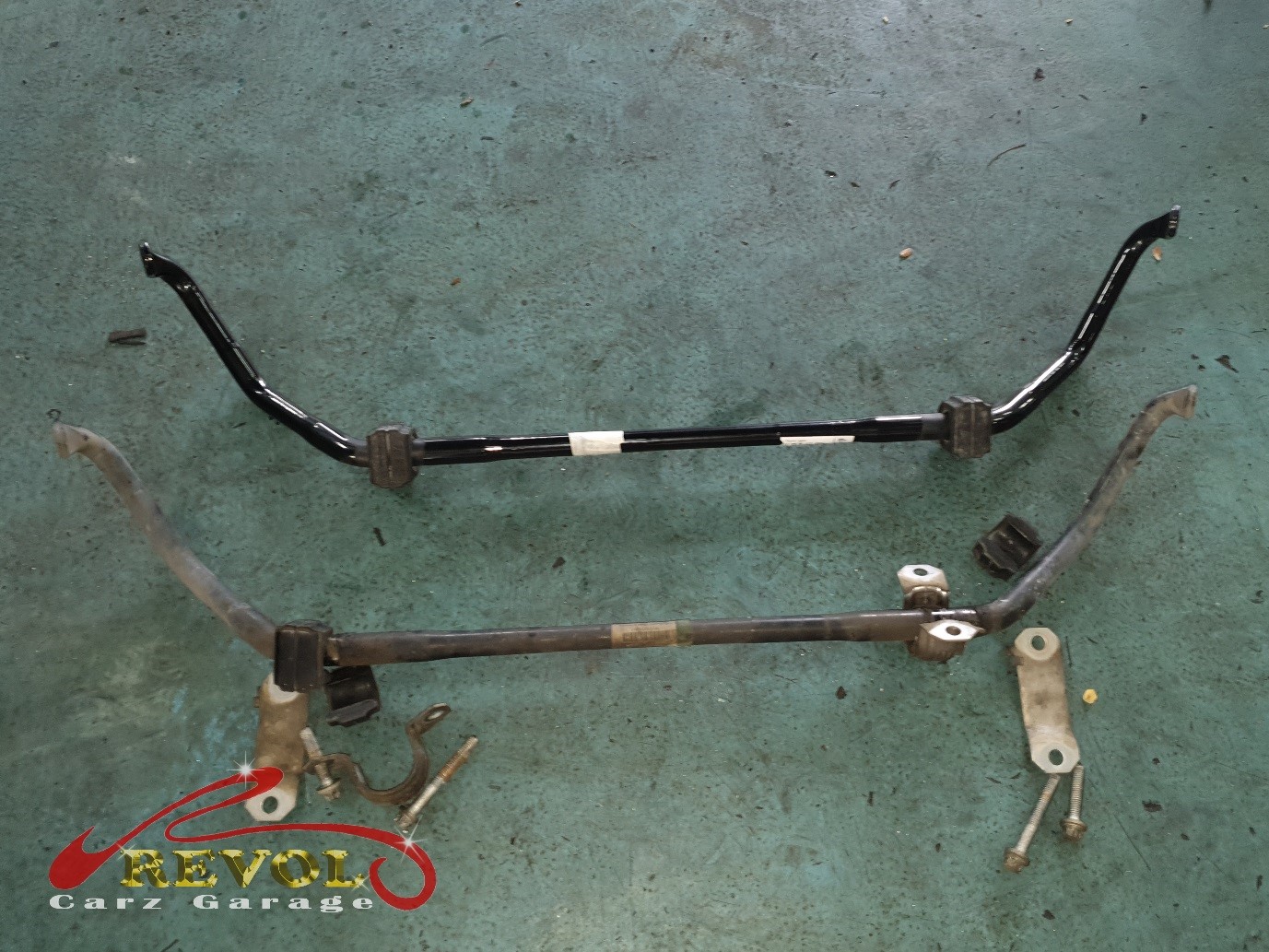

Jackson's car came to our workshop with unusual sound coming in the front due to Front Absorber was losing pressure from the oil leakage.
Jackson's car came to our workshop with an unusual sound coming in the front.
We detected Front absorber was losing pressure from the oil leakage
And after a careful inspection due to the prolong uneven drive the anti-roll bar also need to be replaced in order to ensure no more sound in the front.
The new and used front absorber set
New and used anti roll bar replacement
Car was returned to Jackson all fixed up and ready to go.

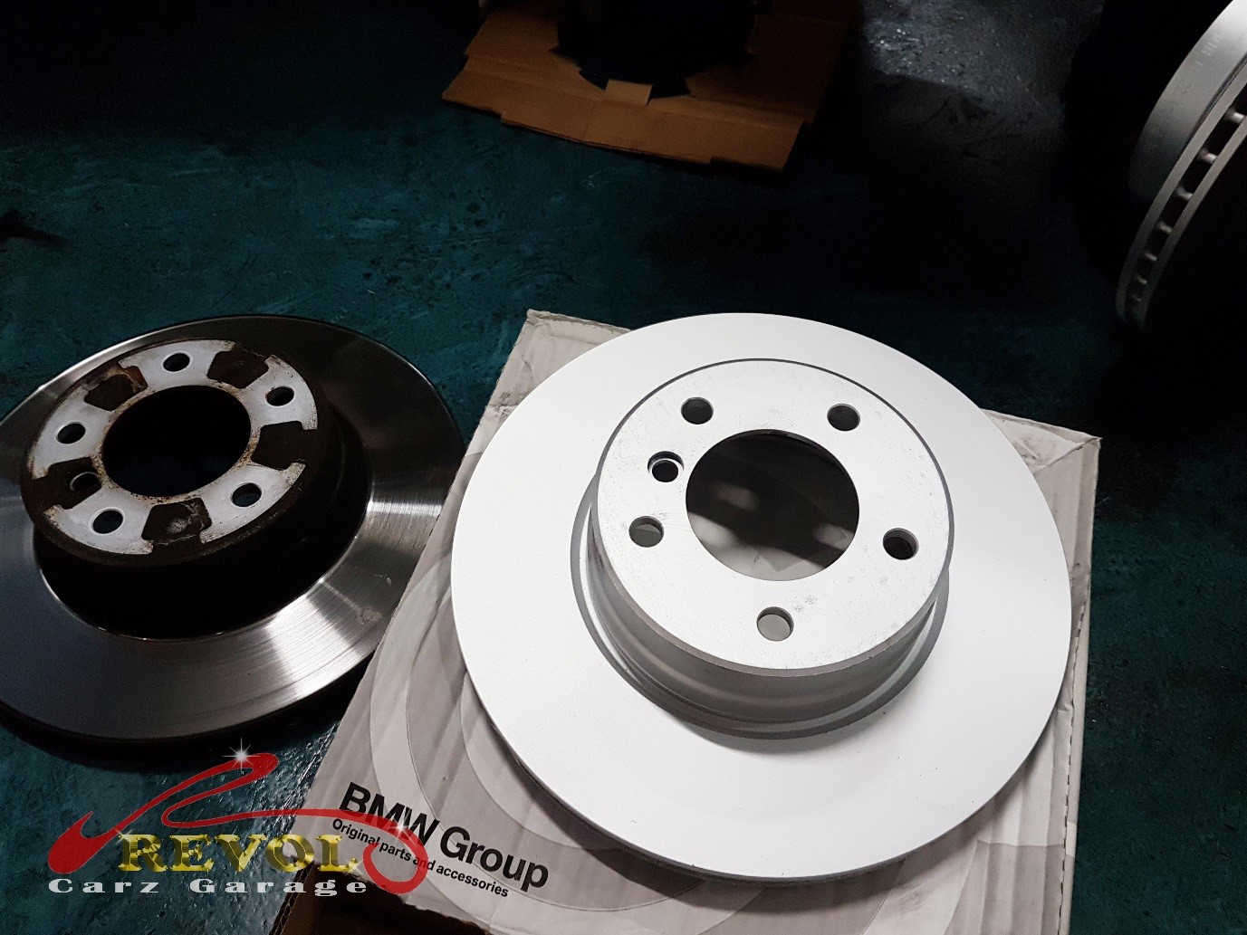

Mr. Su visited us for car servicing and informed that there are lots of white smoke appearing in the exhausts.
Mr. Su mentioned see lots of white smoke appearing in the rear
With years of experience we narrow down and checked the oil separator which indeed is the culprit.
The new oil separator replacement

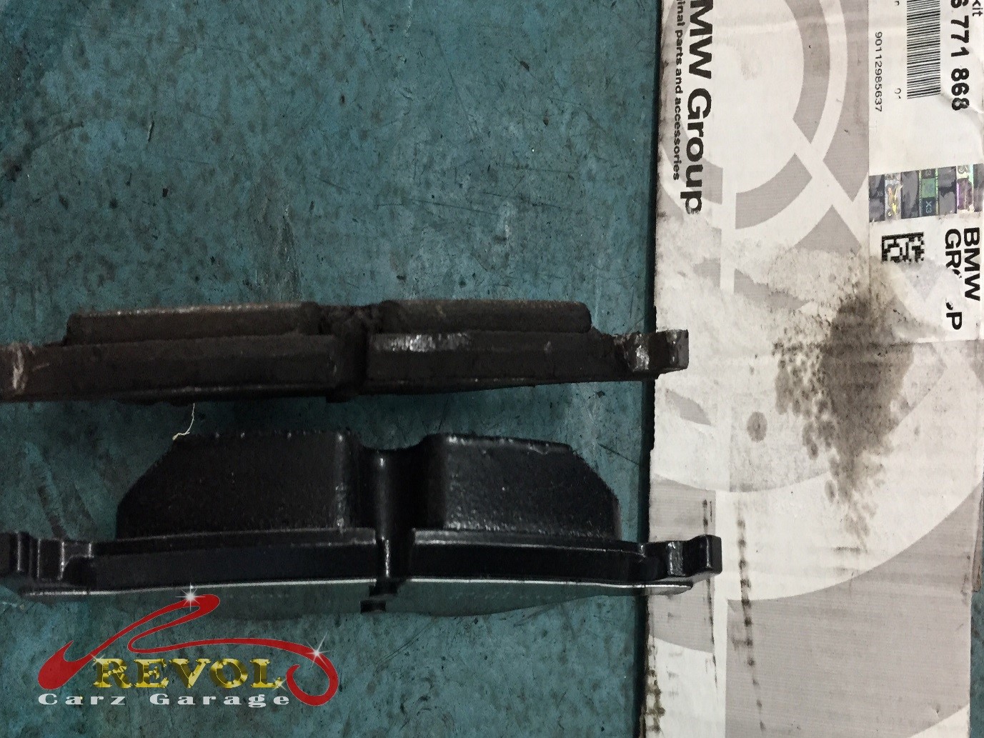

Rear brake disc replacement is needed too
With Rear brake pad replacement too
Car returned to Mr. Su with a Complimentary car wash and vacuum done

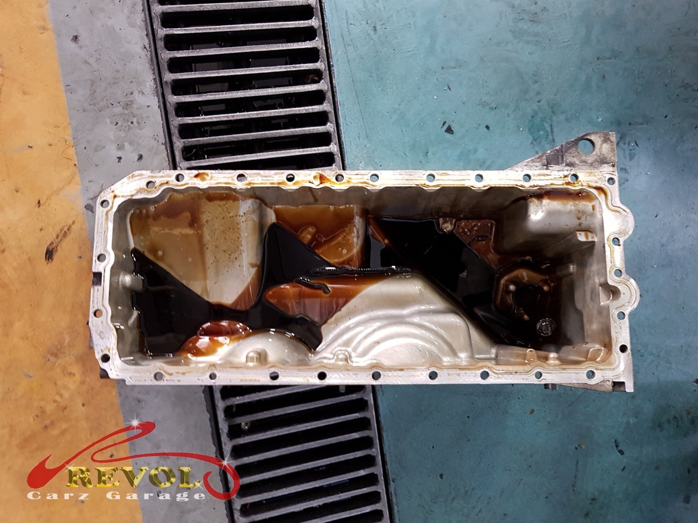

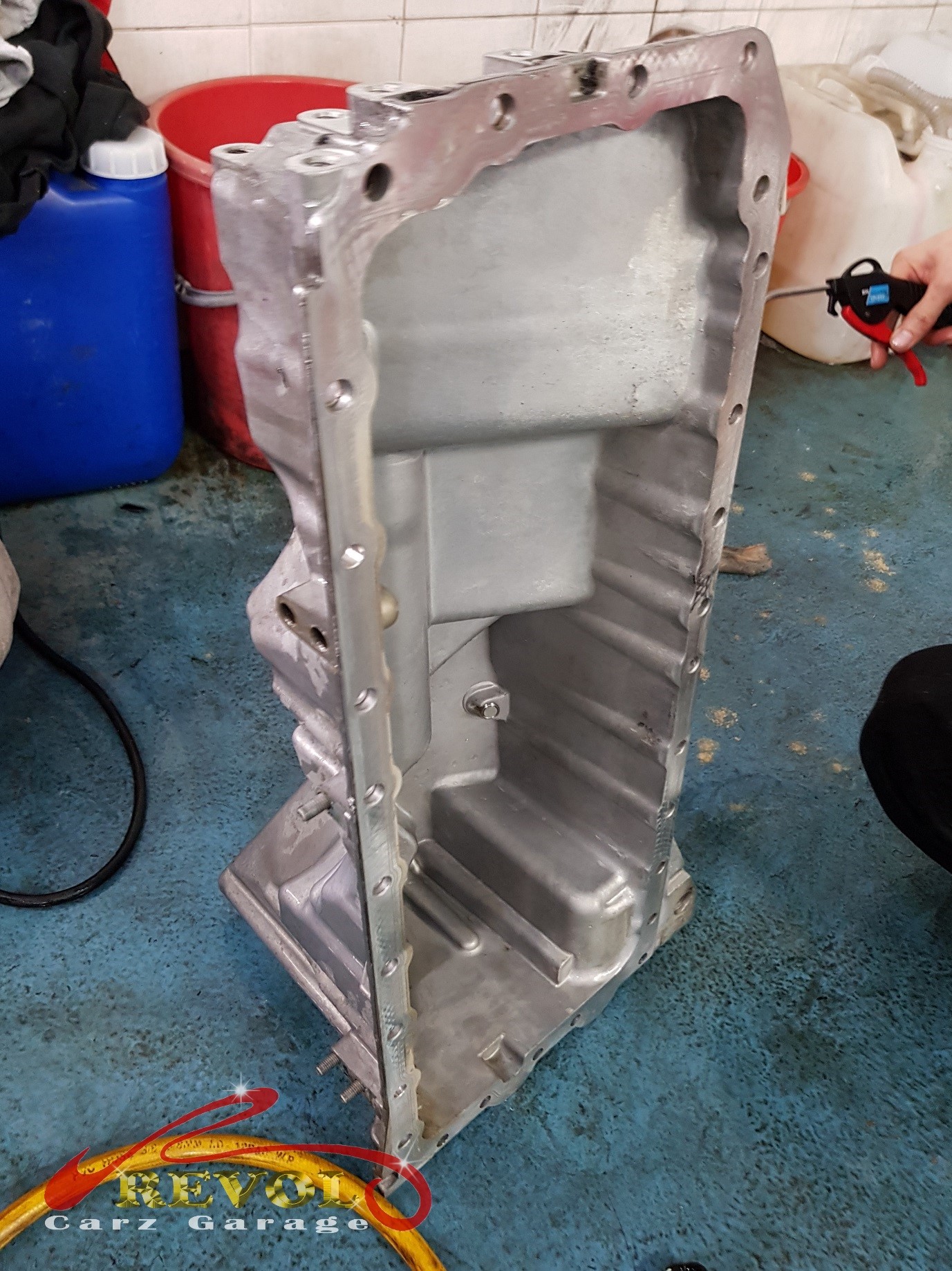

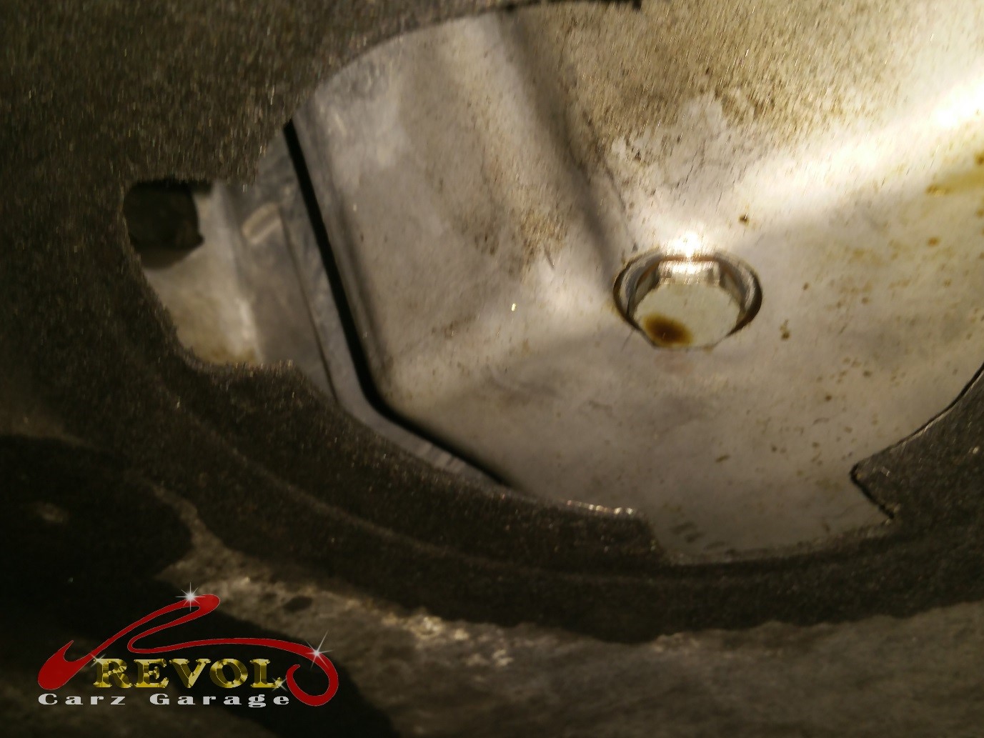

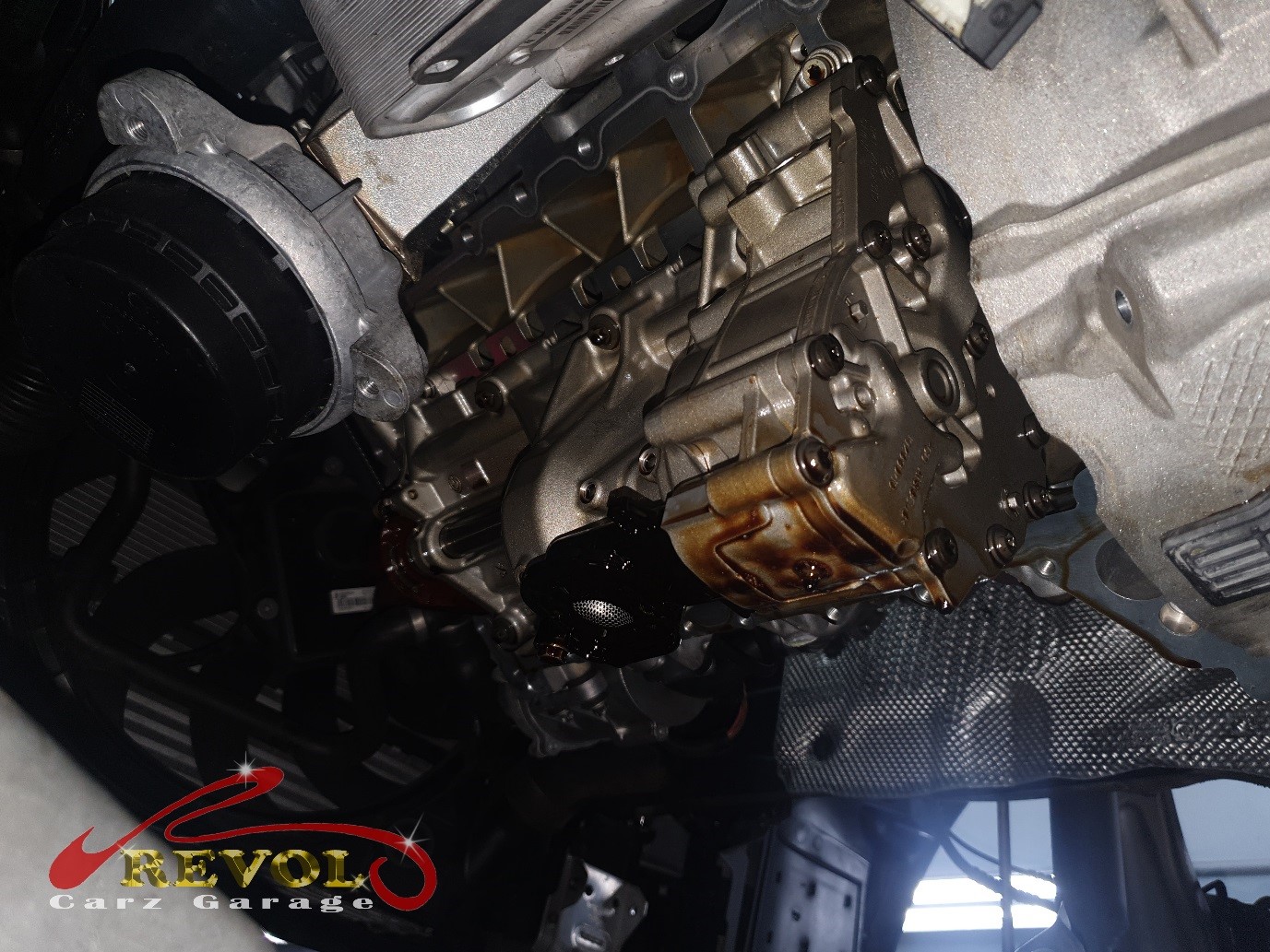

Mr. Kelvin BMW 535i visited our workshop for engine oil leakages issue
BMW 535i arrived with engine oil leakages issue
We hoisted up the car and discover the engine oil sump is leaking
The engine oil sump leaking traces
The metal oil sump have to be removed before we can replace the oil sump gasket
This is how the BMW 535i oil sump look like after the cover is begin removed
Our company protocol is to wash every oil sump cover after it have been removed.

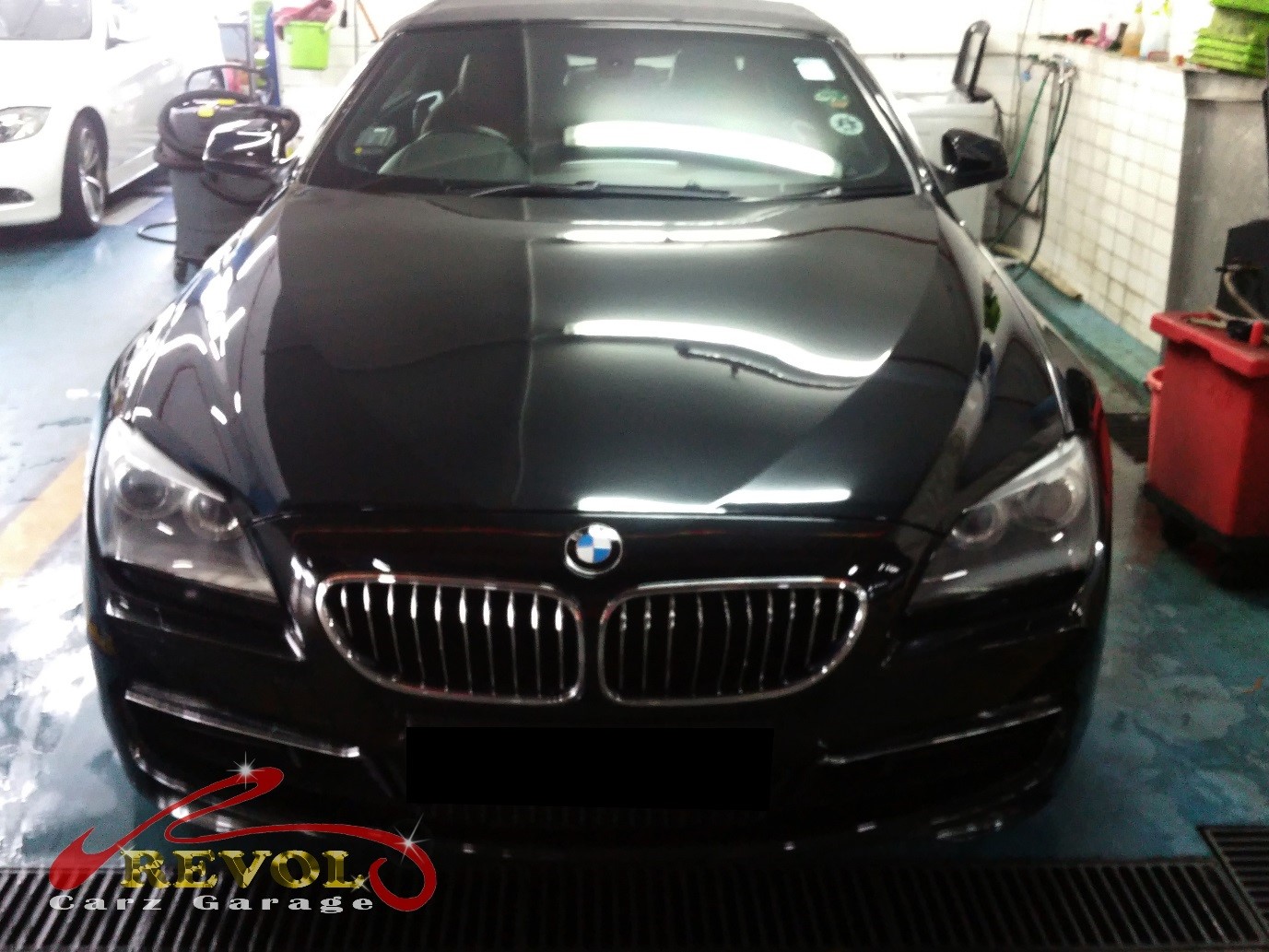

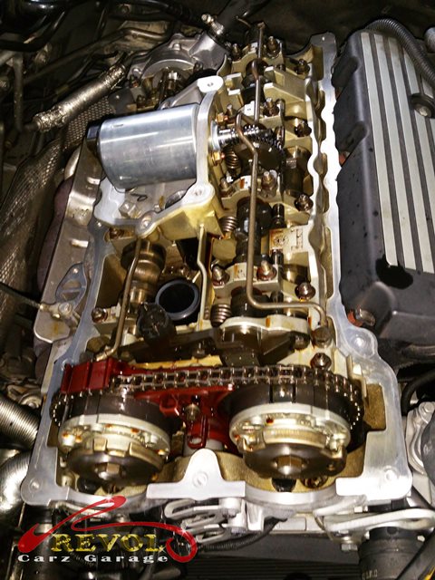

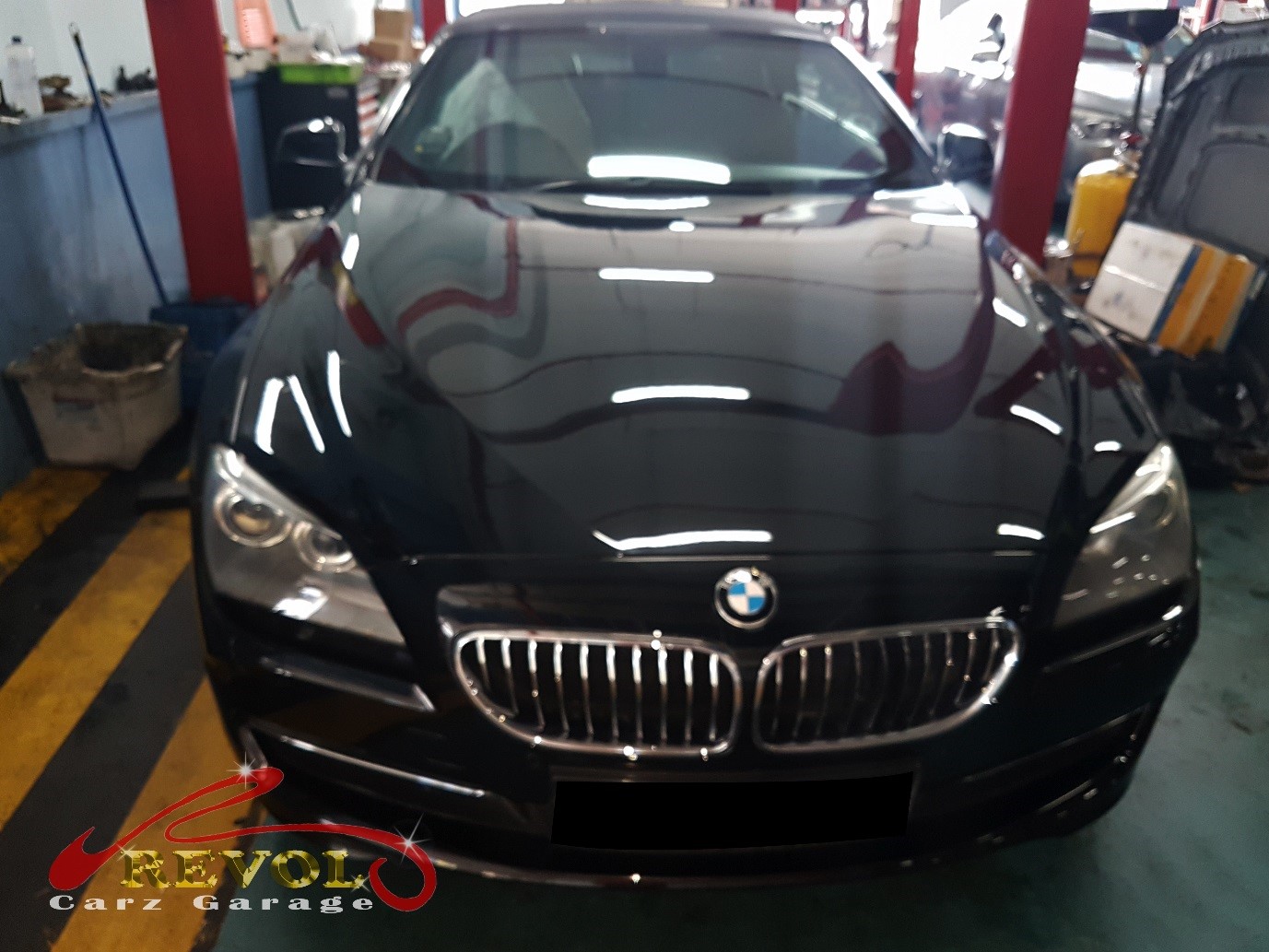

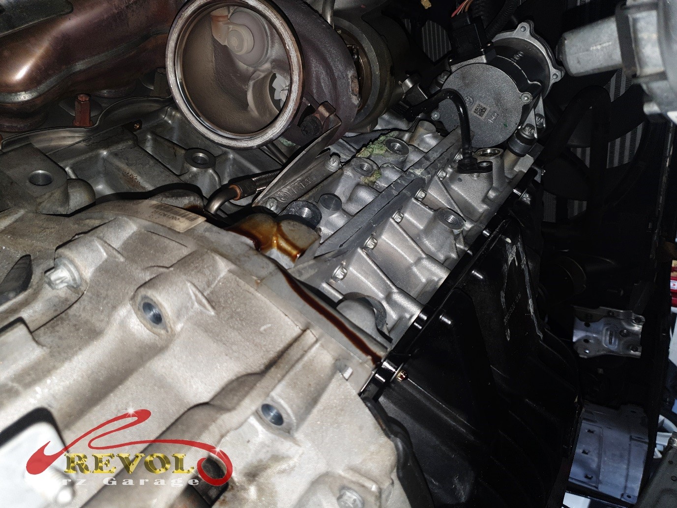

Mr. Alan's BMW 640i is having a misfiring and visited our workshop
This BMW 640i arrived our workshop for misfiring

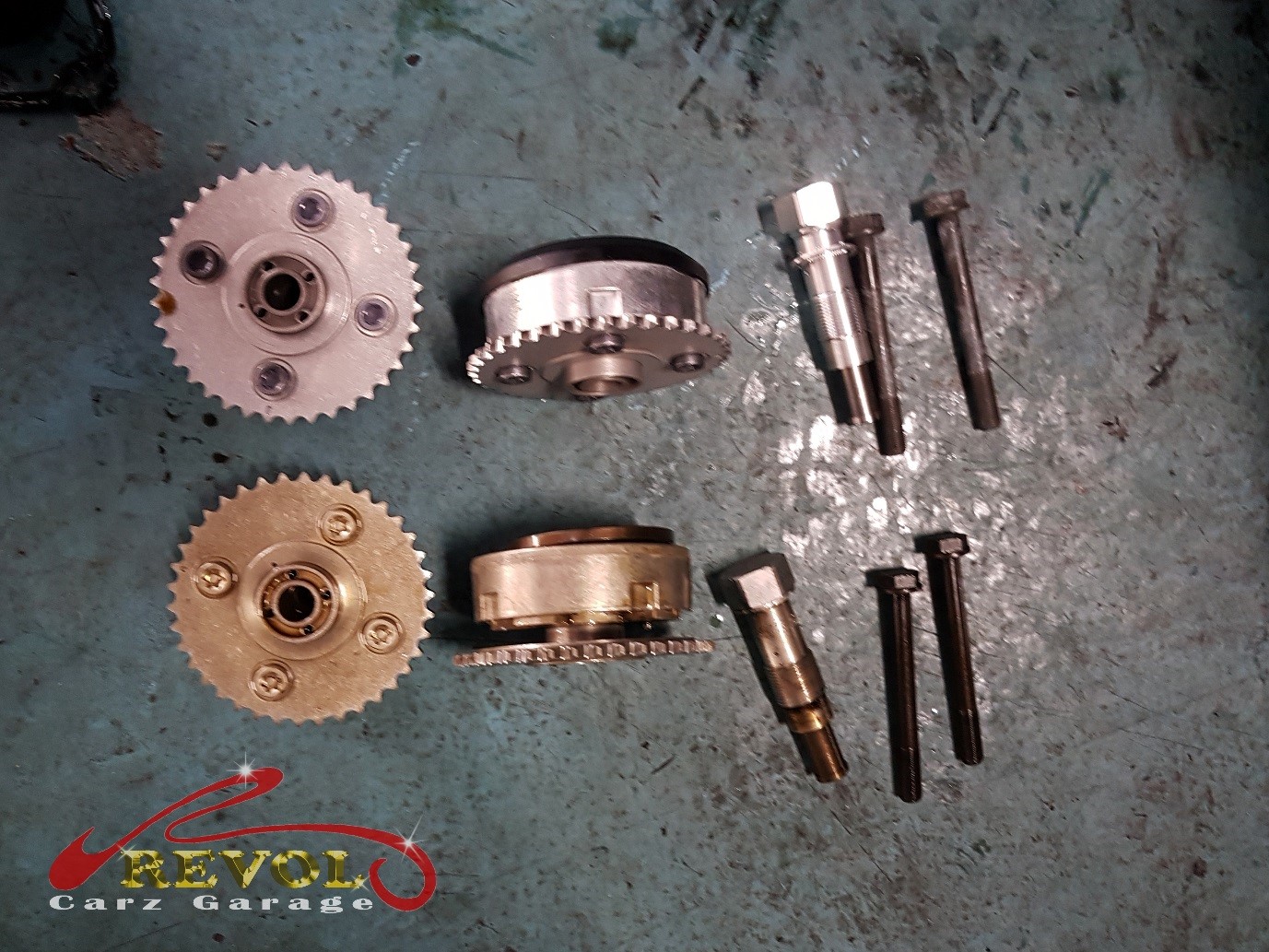

After checking, our experience BMW specialist confirmed the timing gear screw is having issue and work begin swiftly
As expected the aluminum screw from the timing gear have broken and hence explain the misfiring due to irregular engine timing
The new version however have recognized the problem and have been changed to metal screw which will not break so easily.
BMW Special tools is needed to reset back the engine timing variation.

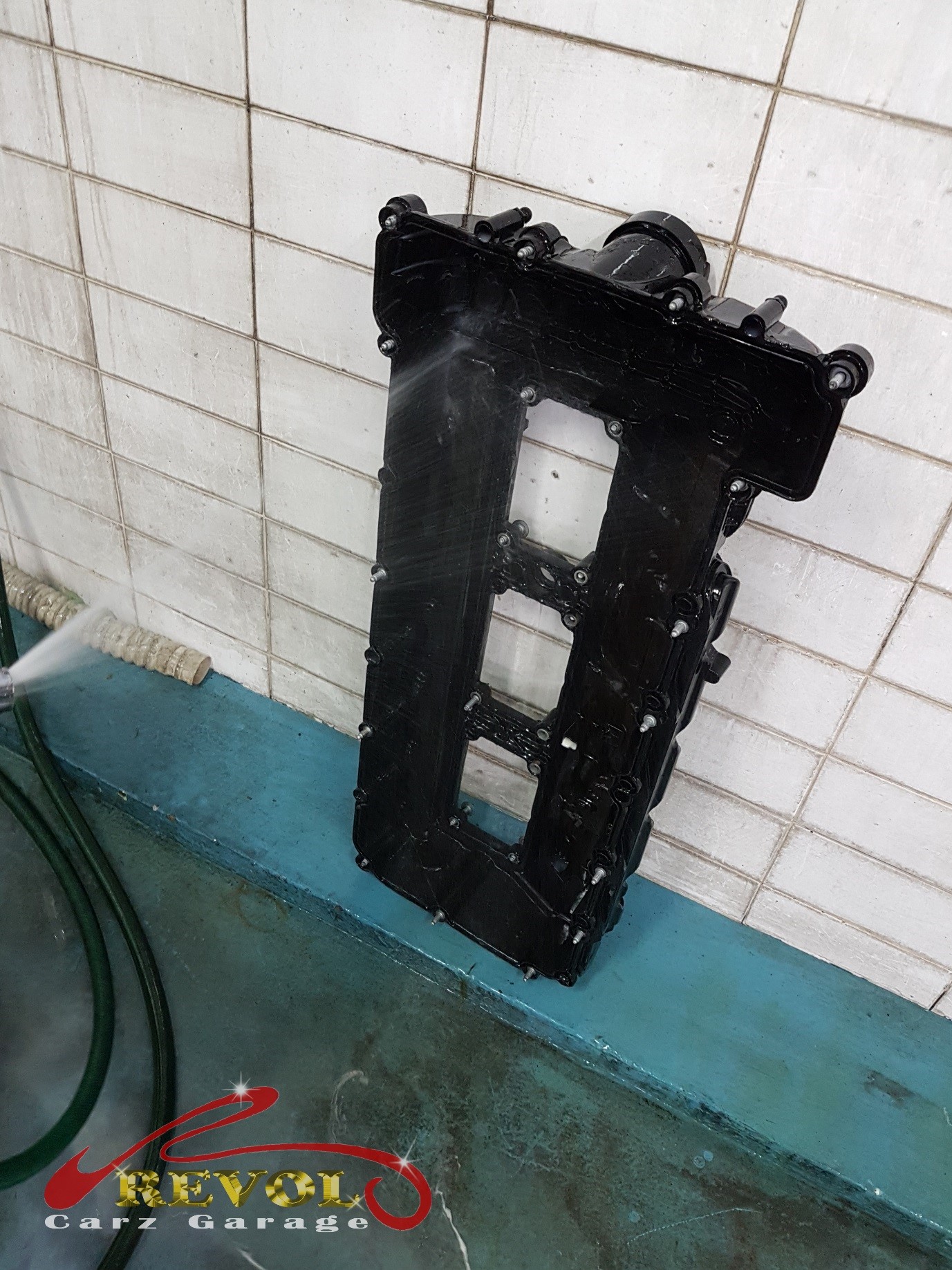

As usual of our company protocol, we will wash clean the valve cover after removing it.
BMW 640i all fixed and is ready to be returned to Mr. Alan.

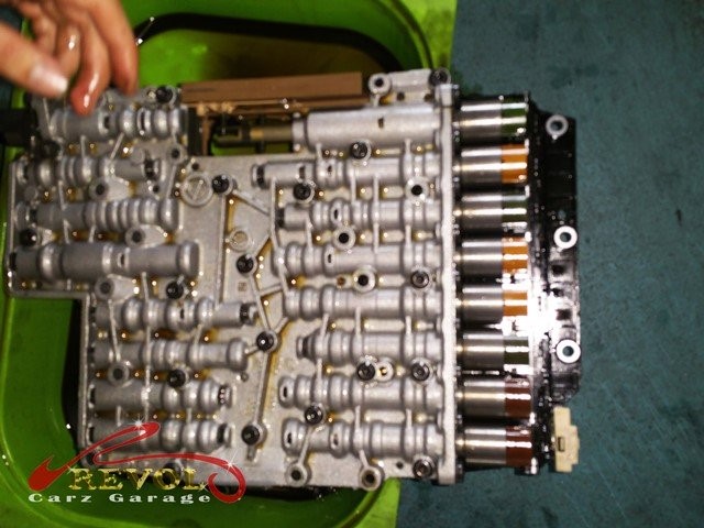

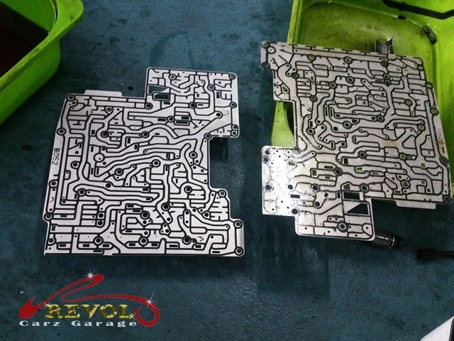

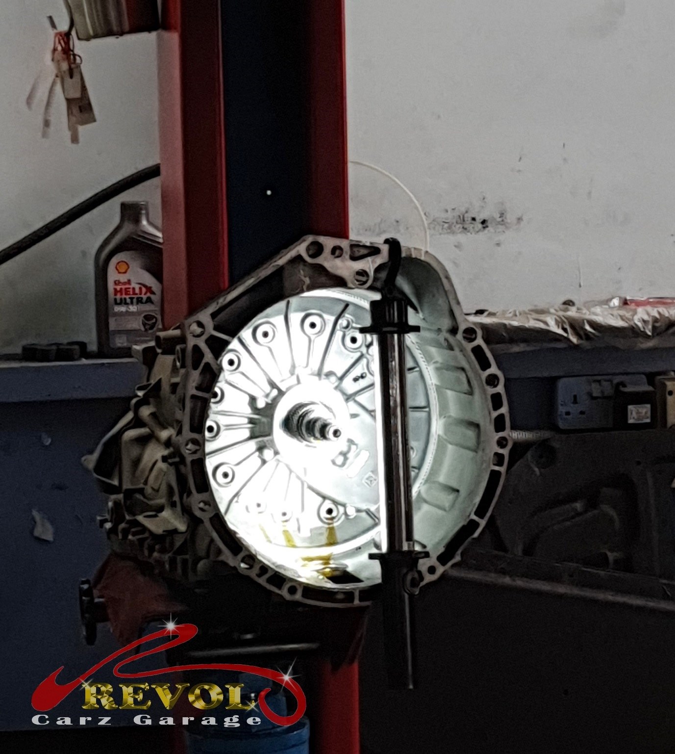

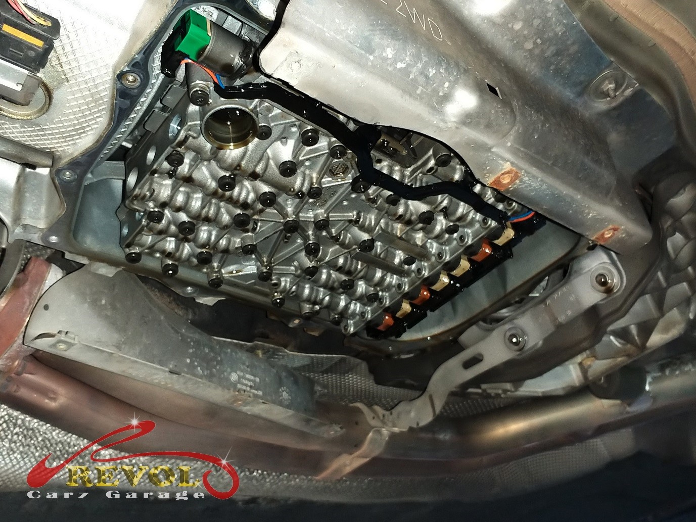

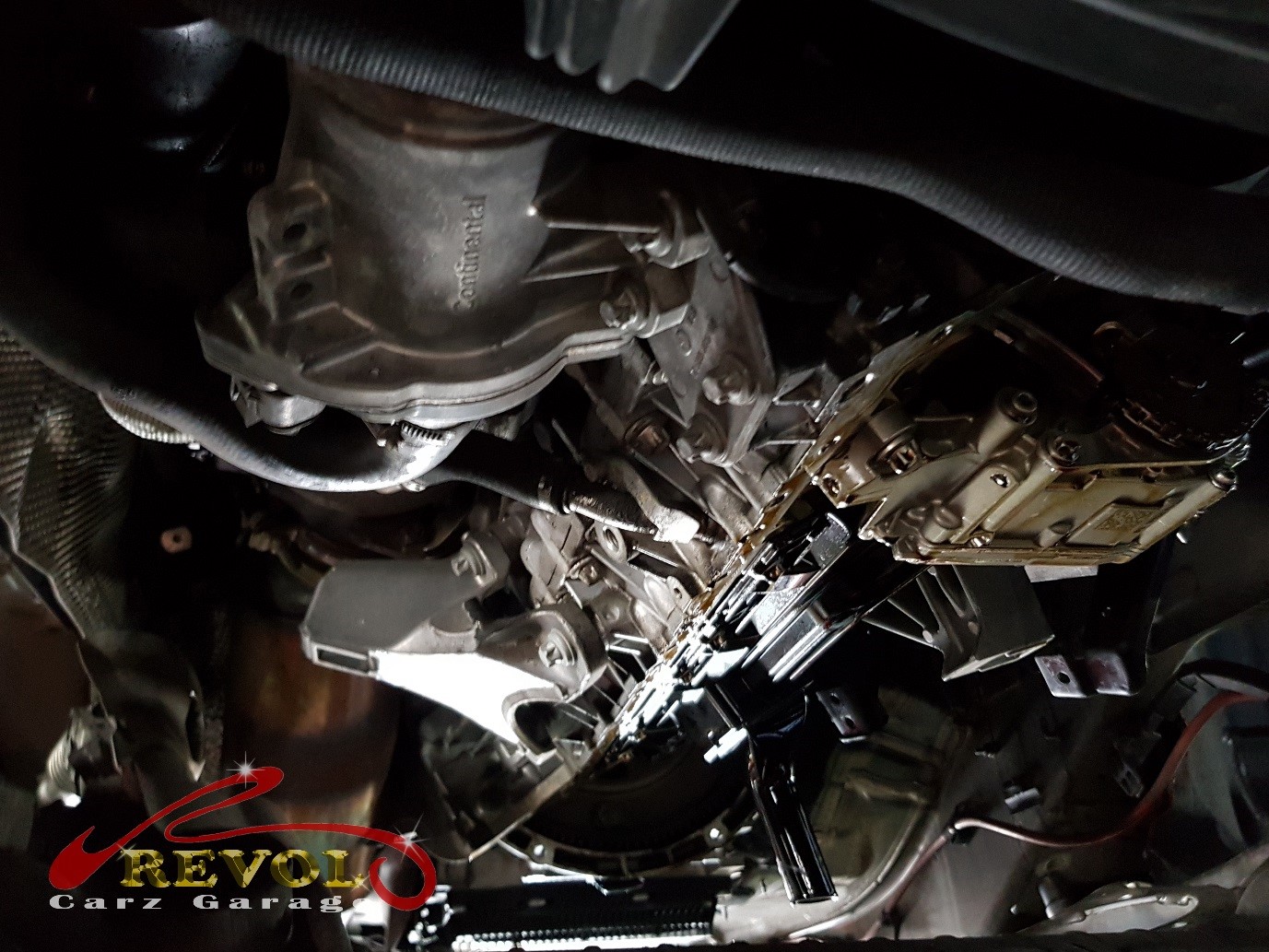

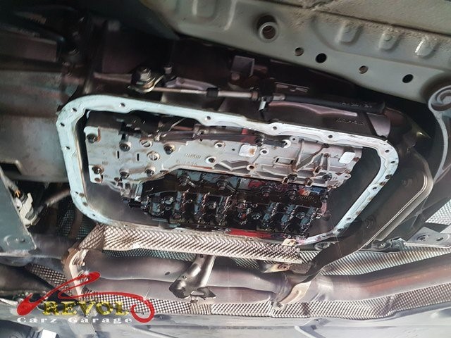

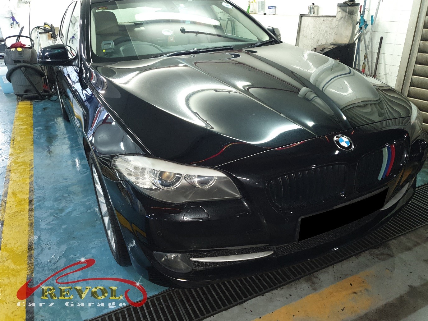

BMW 520i for Mechatronics Overhaul
A BMW 520i arrives at Revol Carz Garage with mechatronics failures.
The car is lifted to access the mechatronics in the transmission box.
As the car left not many months to go we are confident to replace the just the mechatronic instead together of the valve body.
Mechatronics overhauling works in progress
Old and new mechatronics plates lying side by side.
Valve body pistons awaiting replacement.
Mechatronics overhaul is successfully completed.

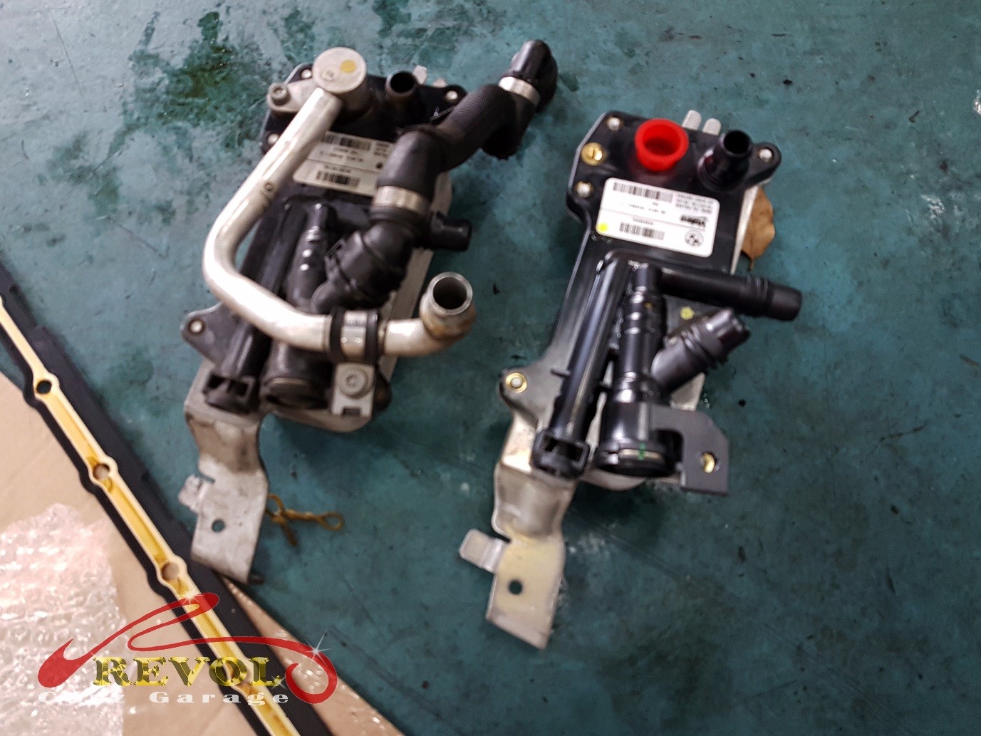

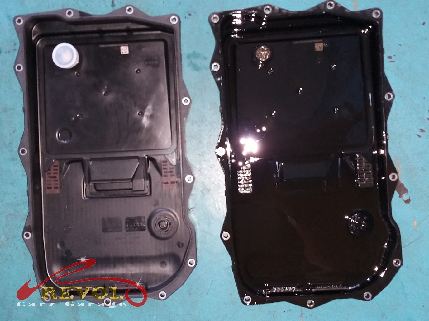

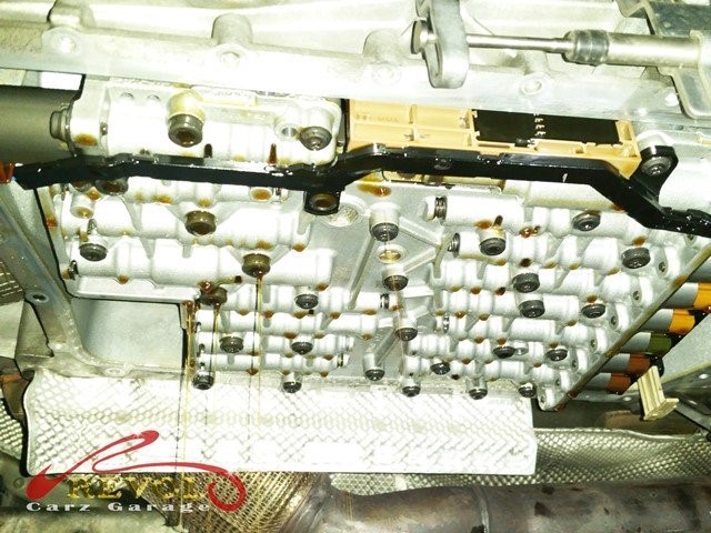

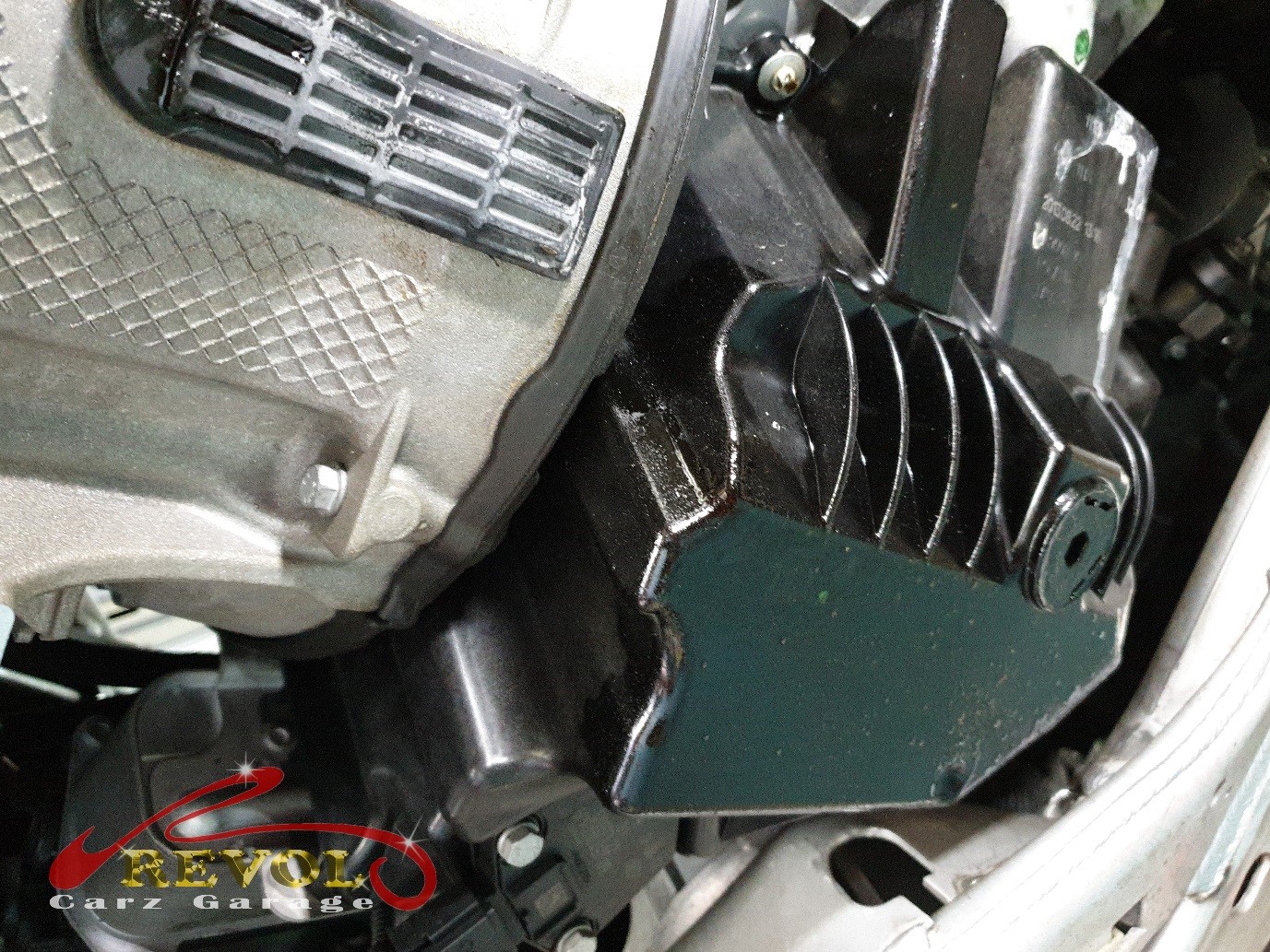

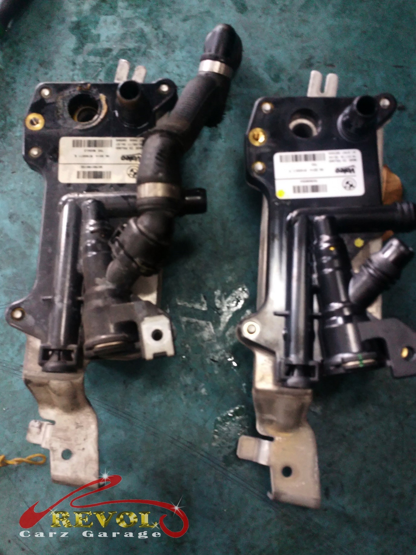

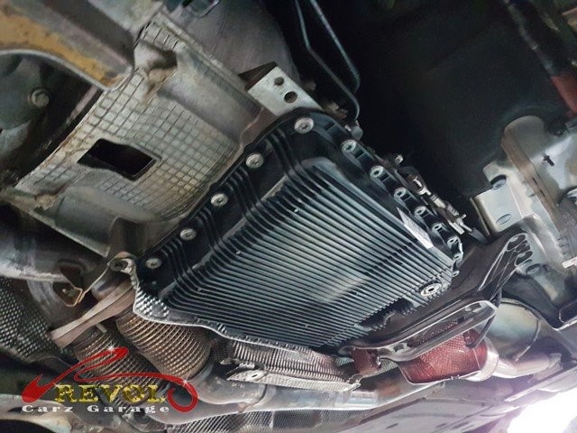

BMW 520i Auto Transmission Fluid replacement
Mr. Boo send his BMW 520i to our workshop for Auto transmission fluid replacement.
When reaches a higher mileage it is not a bad idea to replace the Engine Oil Cooler as a preventive measure
It is the mechatronic aka BMW gear control unit if you have not seen it before
The auto transmission oil pan is being replaced as well
Auto transmission Oil cooler is recommended to replace during the 2nd round of auto transmission fluid

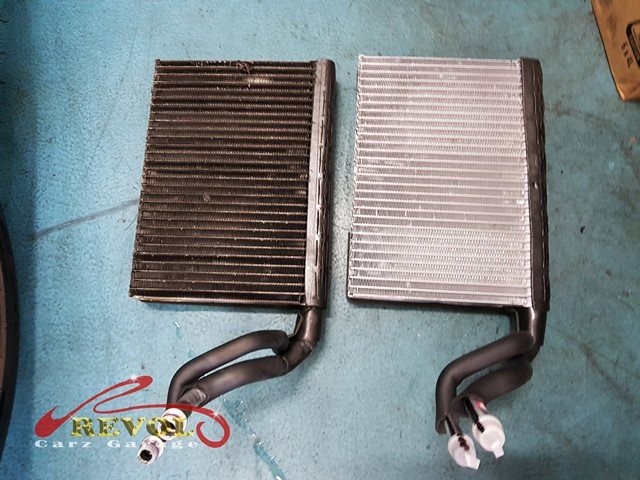

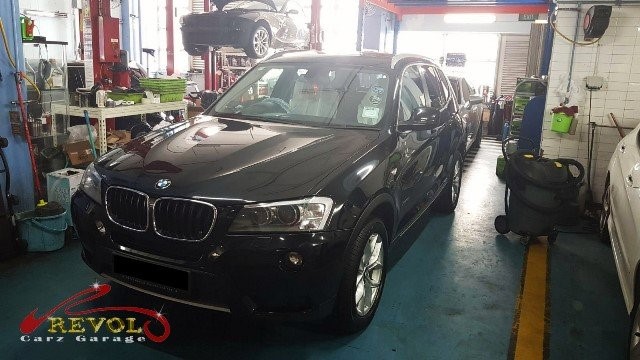

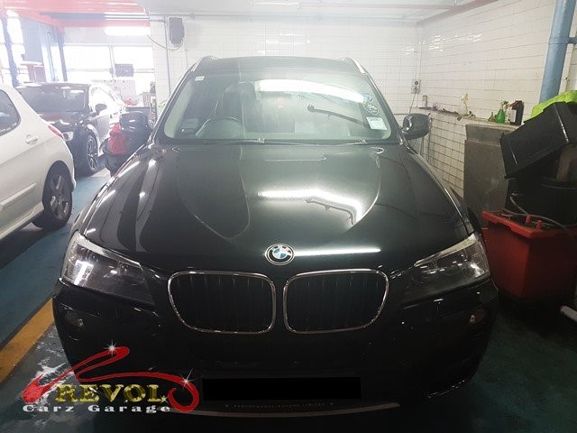

A BMW X3 came to our workshop with air conditioning problems. A faulty car air conditioner can be difficult to diagnose and repair.
We lifted the BMW X3 to carry out a routine undercarriage safety inspection and preventive maintenance also.
Minor leaks of refrigerant in the air conditioning system are normal. However if the leak increases over time, you should consult your mechanic promptly.
Many of the modern models have external filters to keep the dust particles from reaching inside the car. But with time, these filters can get clogged and reduce the air flow. Good maintenance is making sure the filters are cleaned or replaced at regular intervals, especially if we live in a dusty place.

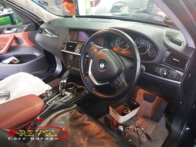

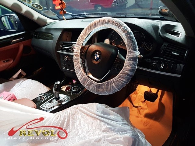

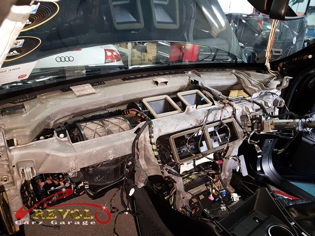

In the case of this BMW X3, we had to dismantle the dash board and steering wheel to replace the damaged parts.
The car air-conditioner gets a lot of usage but we may not think much about the compressor working overtime to bring us cool comfort. The compressor does exactly what the name implies. It compresses refrigerant and sends it to your car’s air condenser.
A new original cooling coil at the right is ready for replacement. We don’t compromise on the quality of replacement parts.
All the parts are sensibly assembled back to its original positions with precision. It is also important that having a profession to fix back the parts carefully to prevent any unwanted loose noise.
After all the repair works are completed, this BMW X3 is now ready to be collected by the owner.

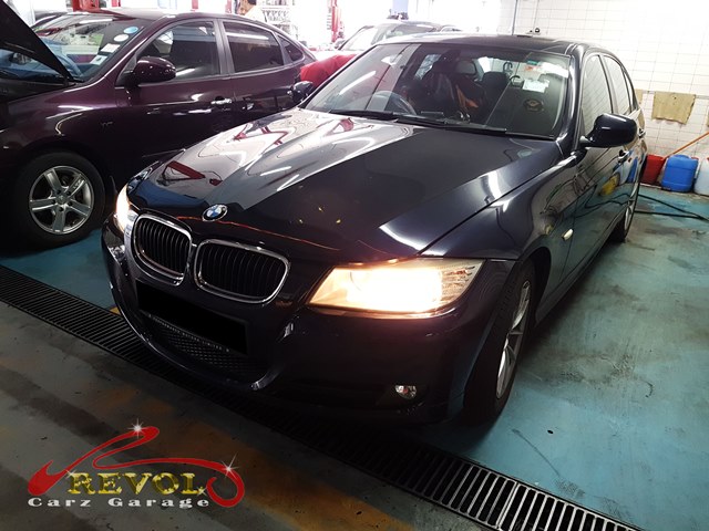

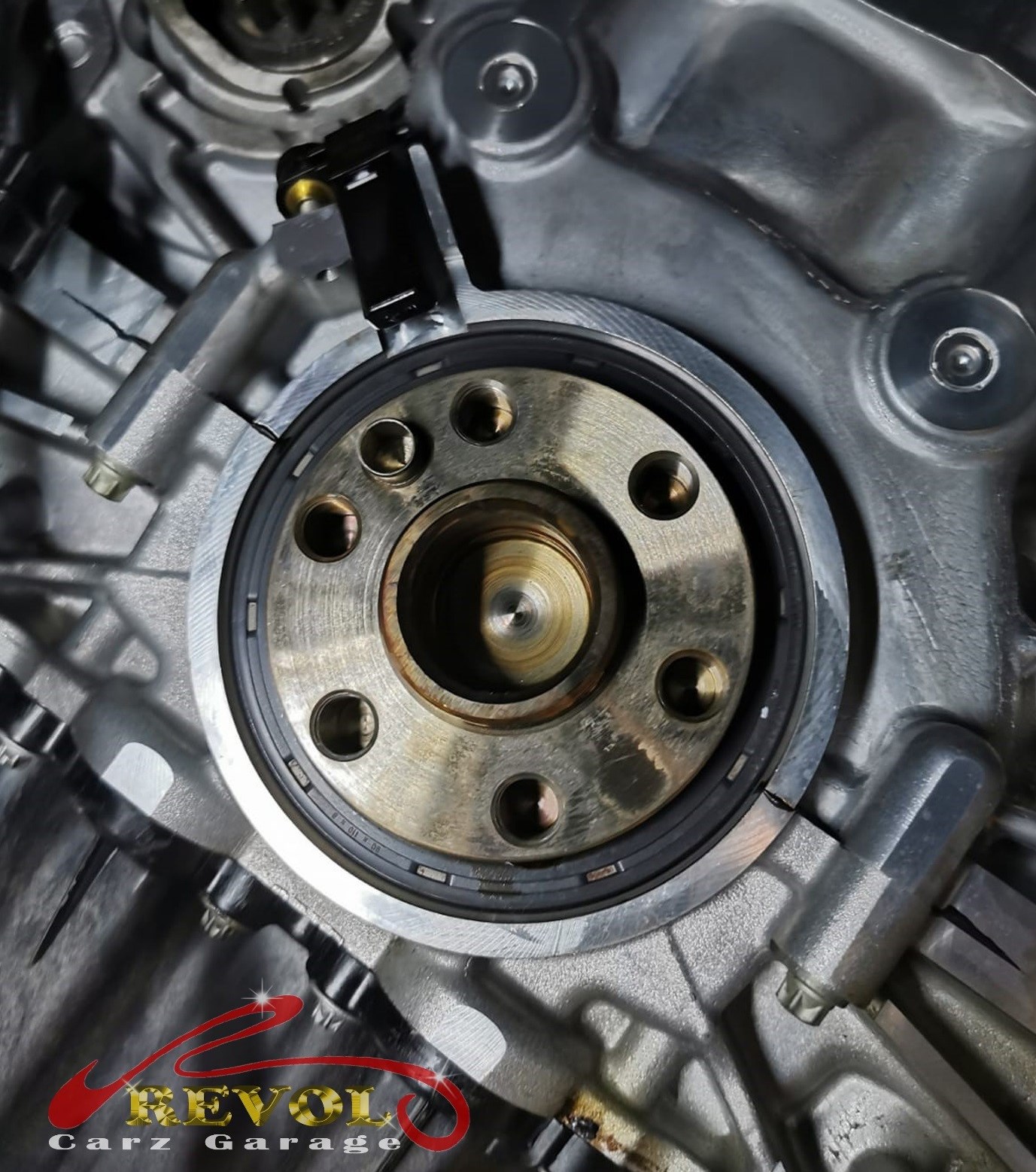

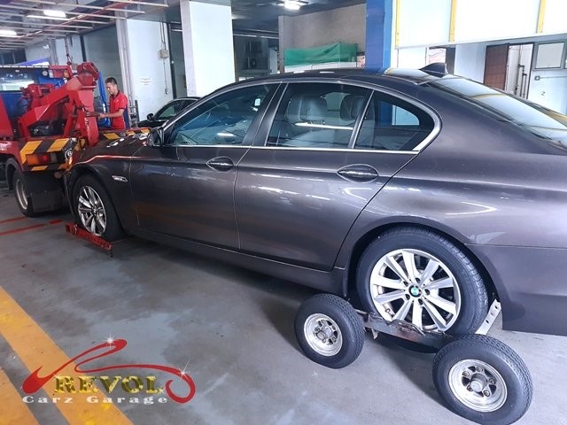

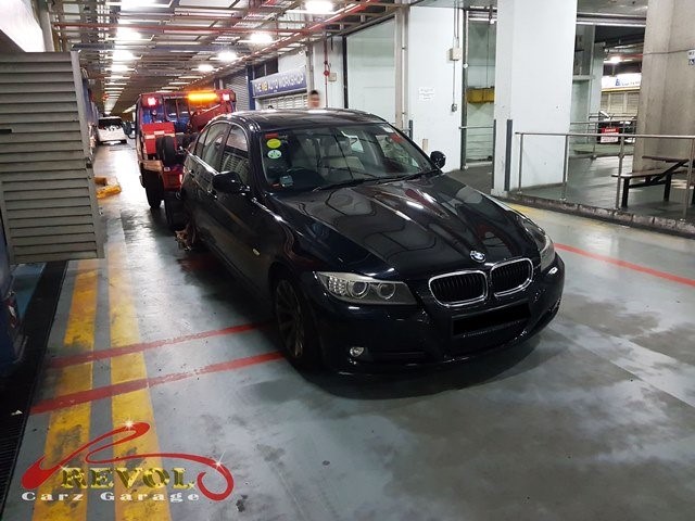

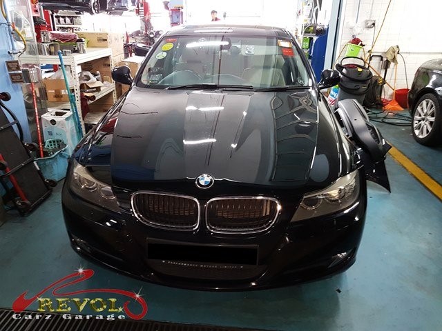

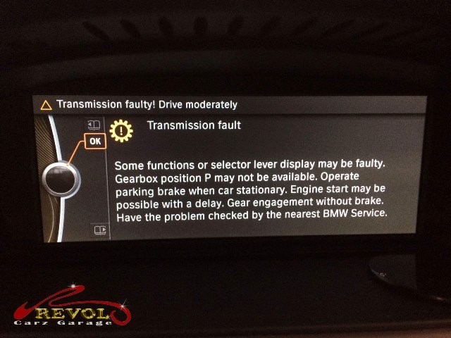

BMW 320i towed in our worshop with Gearbox issue as its automatic gears were failed to engage.
The BMW had to be towed to our workshop as its automatic gears were failed to engage.
The transmission fault code is displayed.
Replacement of the auto transmission sensor includes replacing the auto transmission fluid and filter.

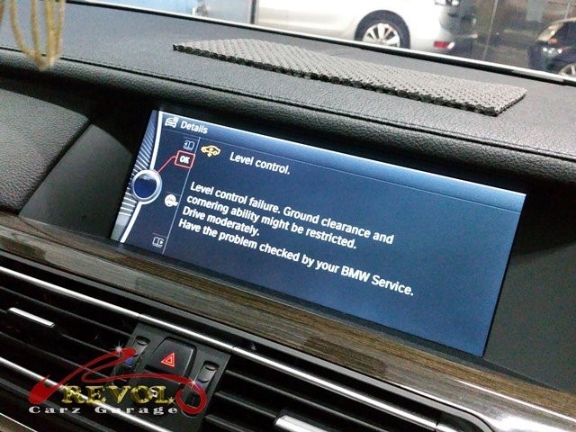

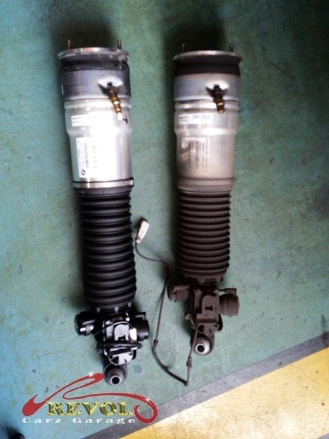

Another Customer’s BMW 7 Series visit our workshop for the replacement of Self-Levelling Air Suspension.
This feature ensures the vehicle offers a consistent height and maximum comfort ride.
Air suspensions however, are subjected to wear and tear over the years.
Some car owners may experience tilting or uneven level when the car is parked.
Some totally worn out air suspension will have error message displaying.
Can you see the difference between the new and used air suspension?
After replacement of the air suspension, we are glad the beautiful 7 series had revived its original comfort driving.
Car is now ready for collection.

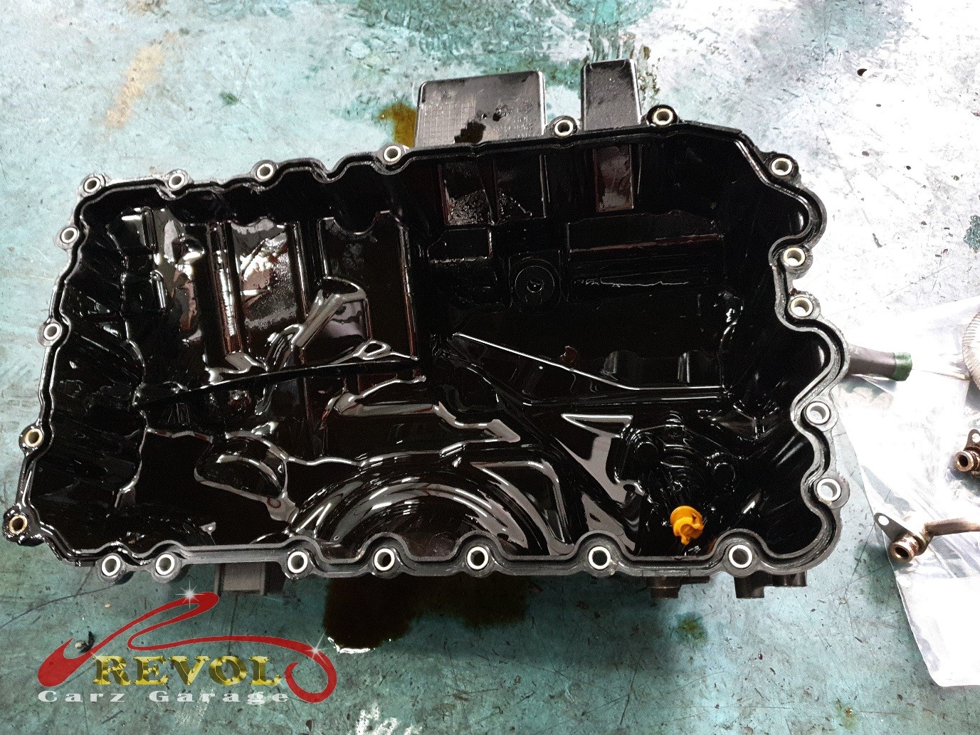

Mr. Kenneth came to us for car servicing after his warranty ended from PML with some engine oil leakage rectification.
Oil Sump Leak
Flywheel and torque convertor oil seal leak
Oil sump cover needs to be removed before the replacement of the oil sump gasket
That is how a BMW 520i oil sump looked like if you have not seen it before

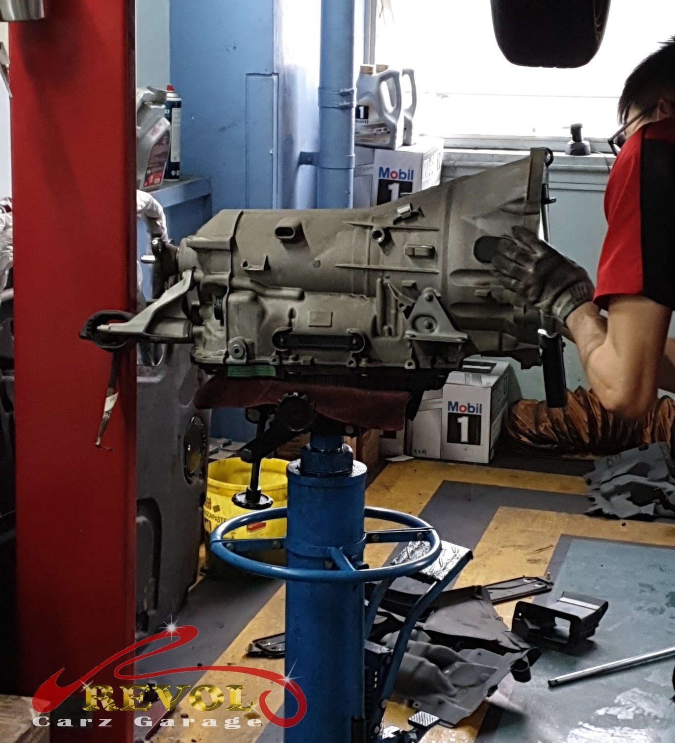

The gearbox must be dropped down in order to replace the flywheel oil seal and torque convertor oil seal
Torque convertor oil seal replacement
New flywheel oil seal fitted
And we got good review for the works done here

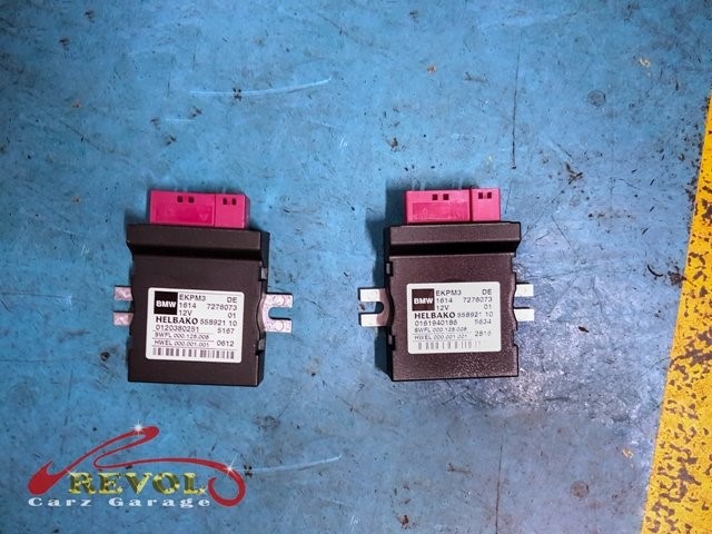

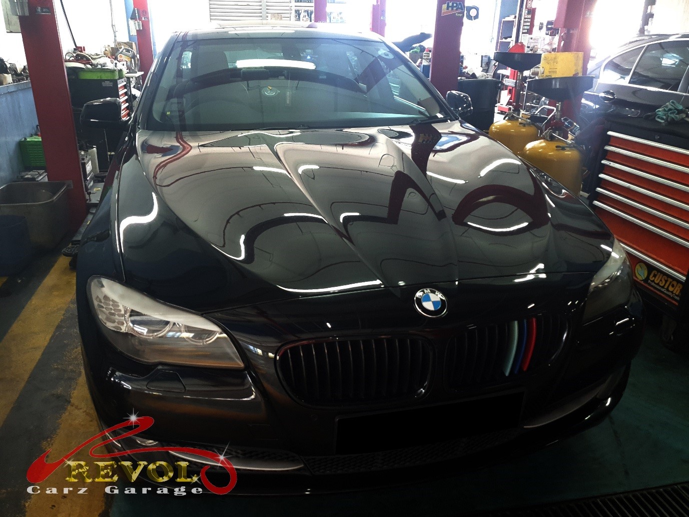

A BMW 520i showed up being towed to Revol Carz Garage for not able to start.
We take holistic diagnosis of the issue and confirm it is the EKPM (Fuel Control Pump Module) failure. The valve cover gasket is being checked for leaks. Some leakage occurred on the valve cover gasket. The new set of valve cover gasket (ready in the package) whilst the worn gasket set had been removed.
BMW 520i was towed in our workshop as car cannot start.
Which one is the new EKPM module?
Answer: Yes the one at the right is original and brand new. The old and new fuel pumps are ready for exchange too. With after all the failed components are professionally replaced and reprogrammed, the engine is cleaned and awaits our QC endorsement.
The BMW 520i is now ready for collection at Revol Carz Garage. The repair is completed in the fastest turnaround time and the BMW goes home with an after-repair guarantee.
