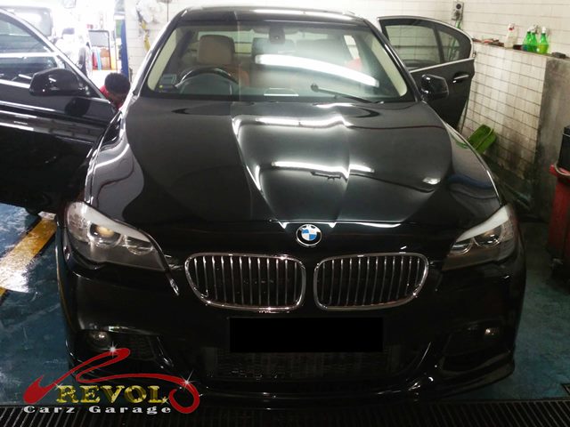

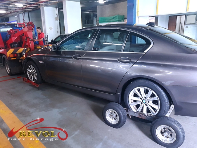

Early this morning, a beautiful looking BMW 520i showed up discharging from a tow truck as we rolled up our garage shutters for the new day.
The car had a fuel pump control module failure after we carefully diagnosed the fault with special equipment.

A BMW 520i showed up being towed to Revol Carz Garage for a EKPM (Fuel Control Pump Module) failure.
We take holistic diagnosis of the issue.

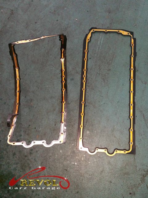

The valve cover gasket is being checked for leaks.
Some leakage occurred on the valve cover gasket.
The new set of valve cover gasket (ready in the package) whilst the worn gasket set had been removed.

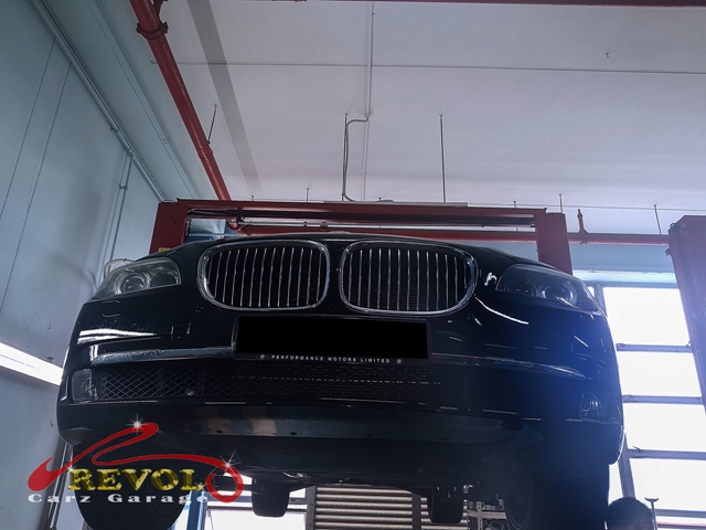

A BMW740Li arrives at Revol Carz Garage with problems of water-corrosion in the mechatronic module and battery tray.
The BMW is lifted for undercarriage safety inspection/maintenance before replacement of the mechatronics module work and battery tray commences.

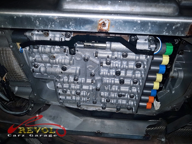

The water-damaged mechatronics module at the left whilst the replacement component from BMW (right) awaits replacement.

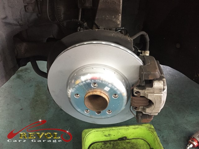

Your mechanics should check your brake rotors at every major servicing performed on your BMW.
Generally the lifespan of a BMW rotor is 1.5 times that of the brake pads.
Although it is not necessary to replace them together, it is prudent to do so because the rotors don't last long enough to completely "skip" a car-servicing cycle.
Inspect your brake rotors for cracks, scoring or pulsation when braking. Visually, the brake rotor may look good but still be worn out.
A good sign that the brake rotors are worn out is finding ridges around the edges.

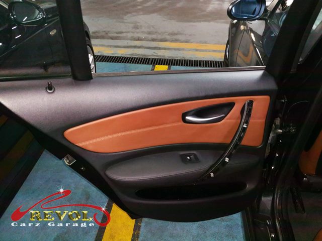

A BMW 118iI arrives at Revol Carz Garage for a window regulator replacement.
Window regulator replacement in progress.
New window regulator awaiting replacement

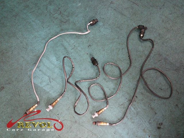

A BMW 525i A arrived at Revol Carz Garage for oxygen sensor replacement
New oxygen sensor waiting for replacement

A BMW 525i arrived at Revol Carz Garage for oil sump gasket replacement
The BMW is lifted for parts replacement work and important safety inspection of the undercarriage.
Leaking oil sump gasket waiting for replacement
New oil sump gasket awaiting replacement
Oil sump gasket replacement in progress
