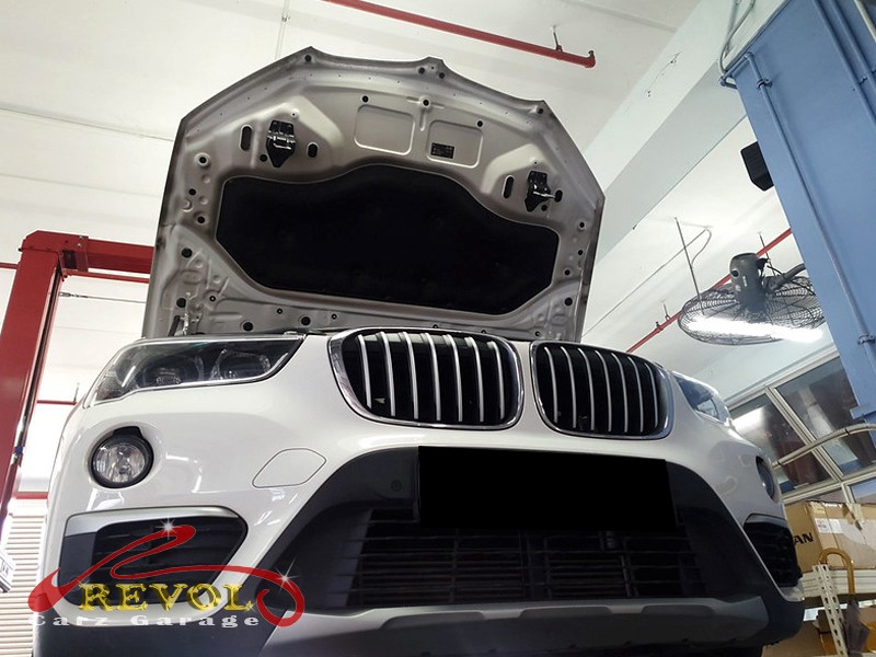

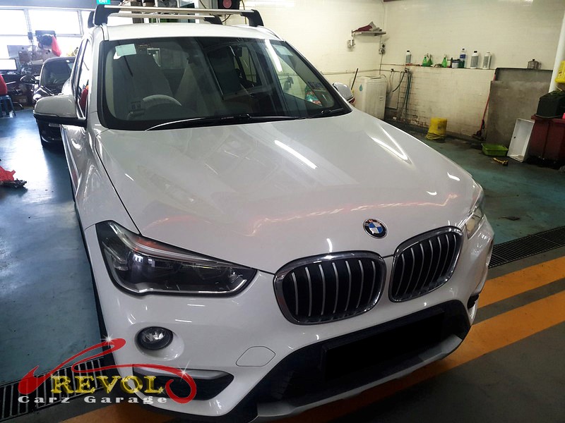

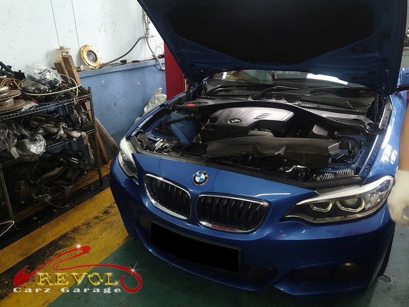

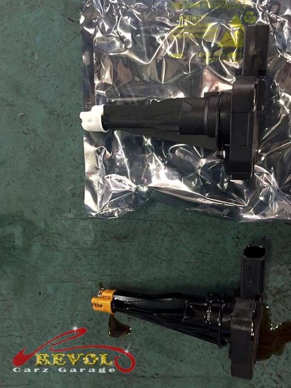

Mr. Poh BMW X1 was sent in our workshop as he is having an engine low issue error fault code.
Oil Level Sensor will be done by our BMW specialist team.
Mr. Poh's BMW X1 send in our workshop.
A comprehensive check is performed and no external leakages and engine oil is in normal level with no fault code
In this cases where no fault code is revealed, our BMW Specialist team decided with their many year of experience to replace the oil level sensor
We are happy to resolve Mr. Poh's car issue and is now ready to be collected by the owner.

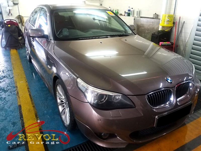

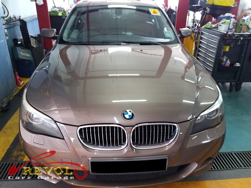

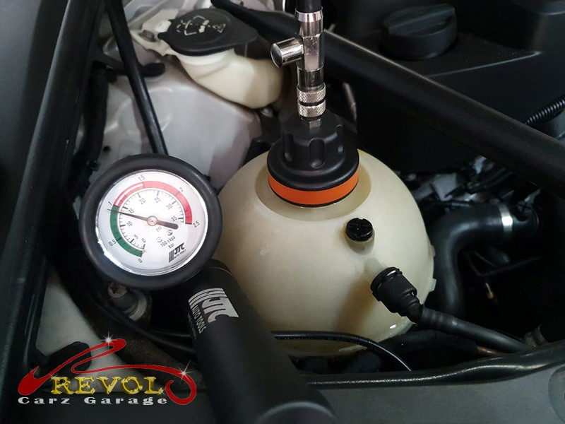

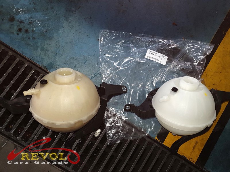

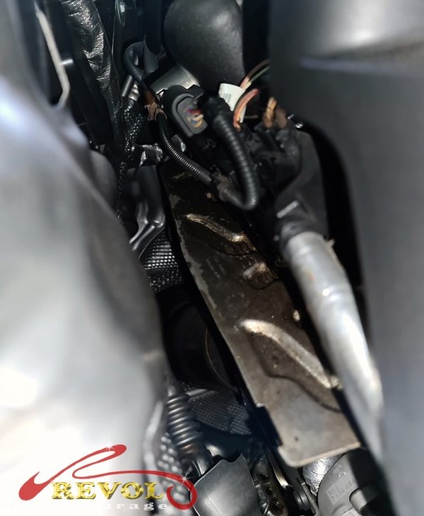

When Specialist's tool come in place where leak cannot be seen by naked eyes. Mr. Raja's BMW 520i is having a coolant leakage and not able to be detected so he decided to visit us for a check.
Mr. Raja's BMW 520i arrived our workshop to check his coolant leakage
After checking, Our BMW Specialist decided to use specialist tools to reveal the culprit
And the culprit is finally found
And we swiftly replaced the spare tank to resolve Mr. Raja coolant leakages issue

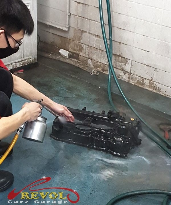

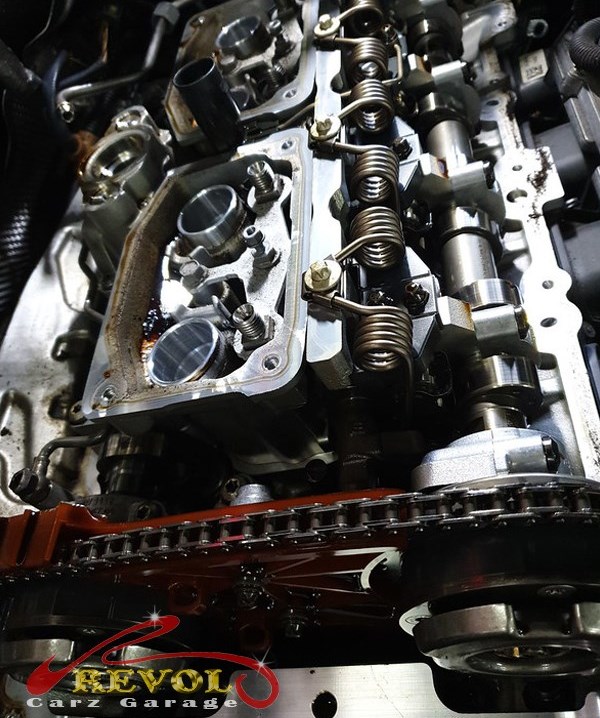

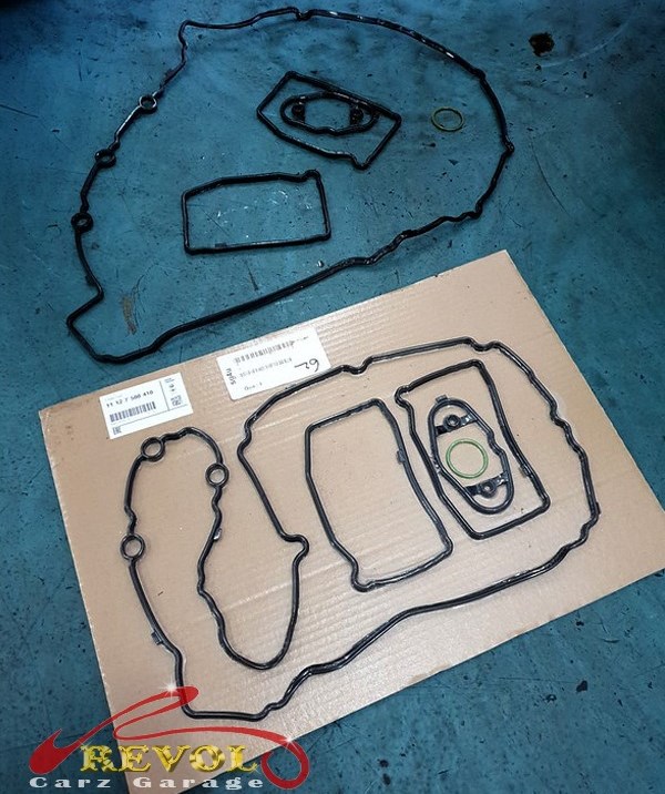

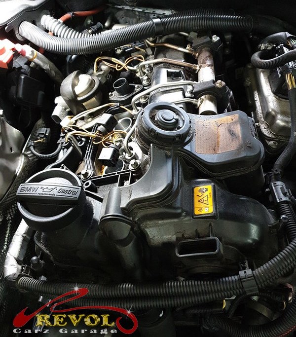

Mr. Lim's BMW 520i was sent in our workshop for having some engine losses.
During the 10 years marks of owning BMW, you will eventually meet this valve cover gasket friend!
Mr. Lim's BMW 520i was sent in our workshop for checking
Our BMW specialist swiftly narrow down to a worn valve cover gasket
Do you know BMW engine compare to other make have a higher engine temperature of 110 degrees in average?
This is how it looks like after the valve cover is removed if you have not seen it before
Our company strict protocol is a much to wash clean the valve cover before placing it back
Replacing with the original BMW valve cover gasket
No more engine oil missing and car is returned to Mr. Lim.

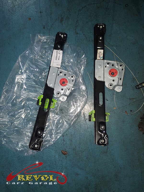

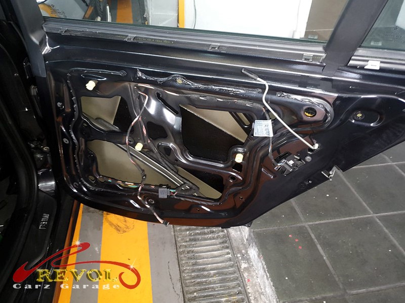

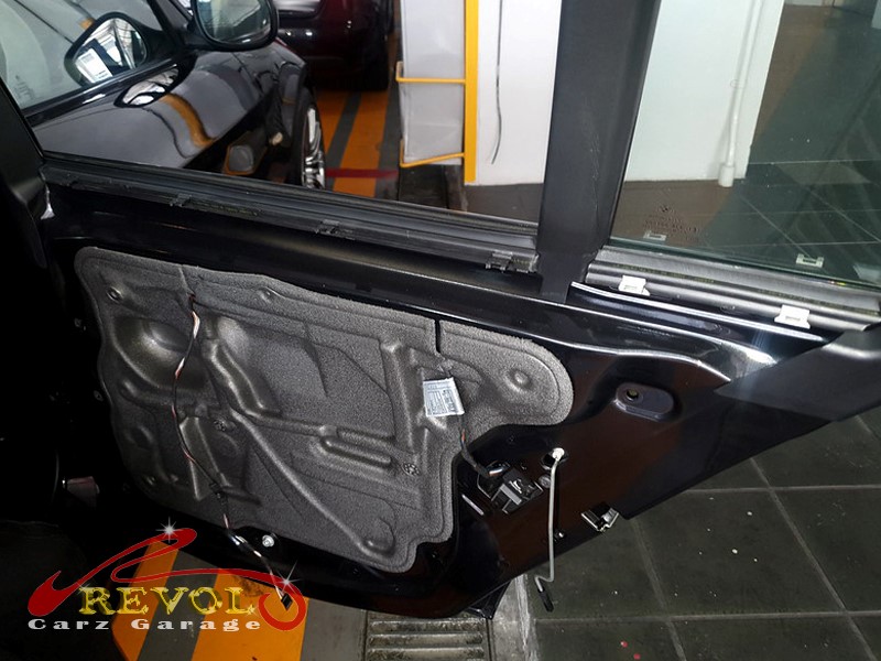

Mr. Bala BMW 318i is having issue with his rear driver door window.
What could be the reason why your window after winding down cannot wind up again?
Mr. Bala send in his car in our workshop with Rear Driver Door Window issue.
Although our many year of BMW specialist already know the answer
It is still better to dismantle and perform a check to confirm the issue
And the window regulator is the main culprit
We are glad to resolved Mr. Bala Car window issue

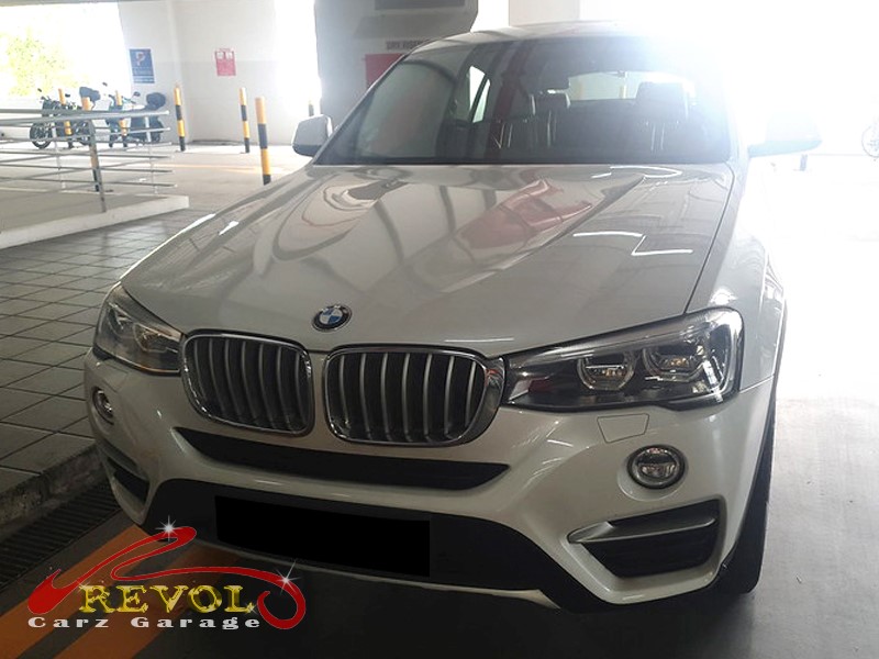

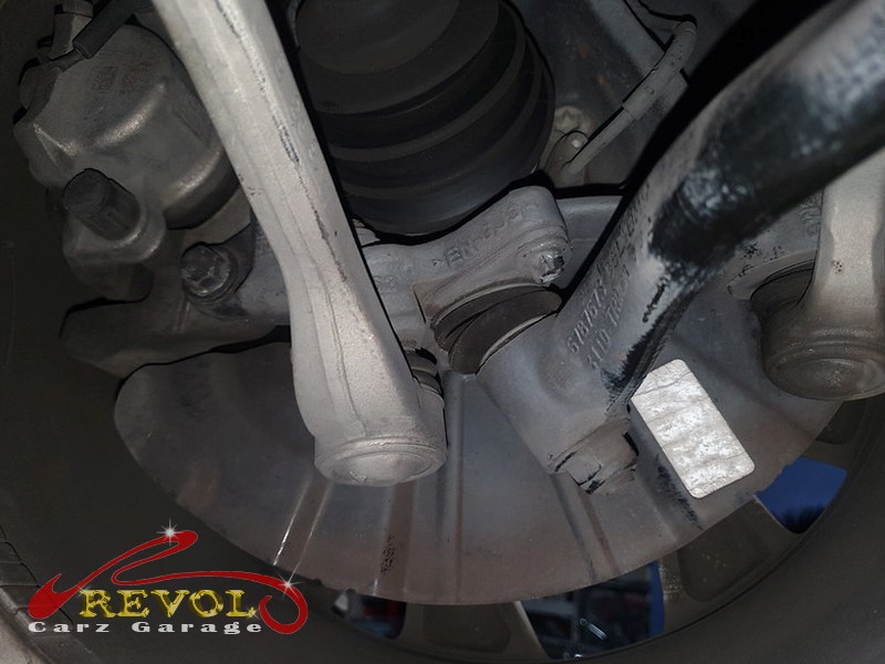

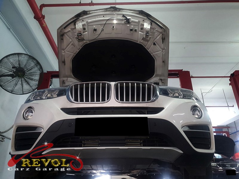

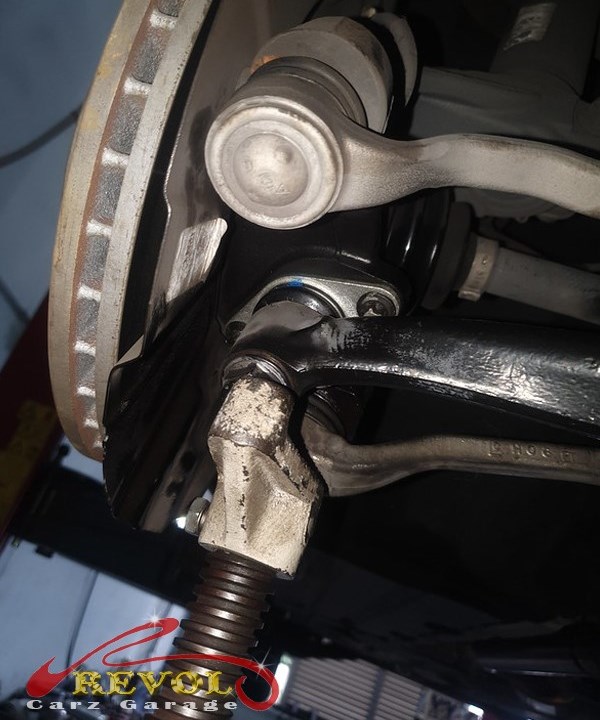

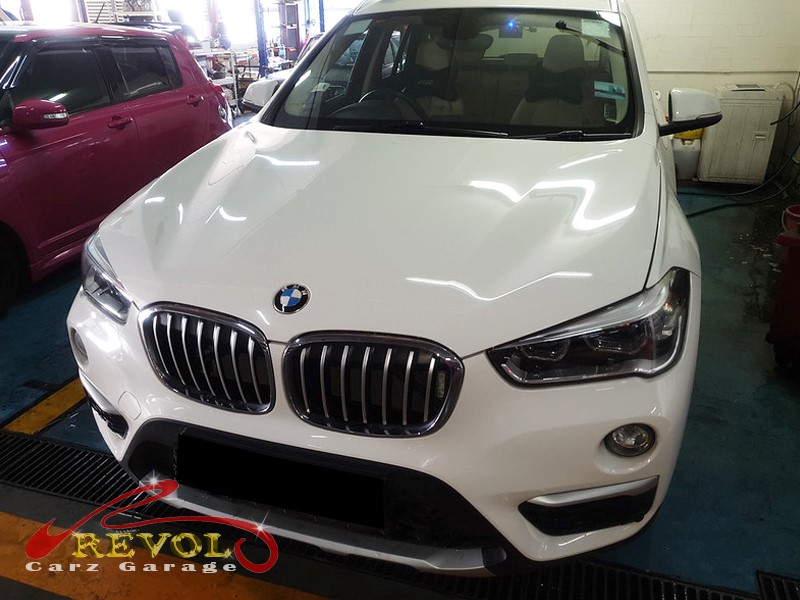

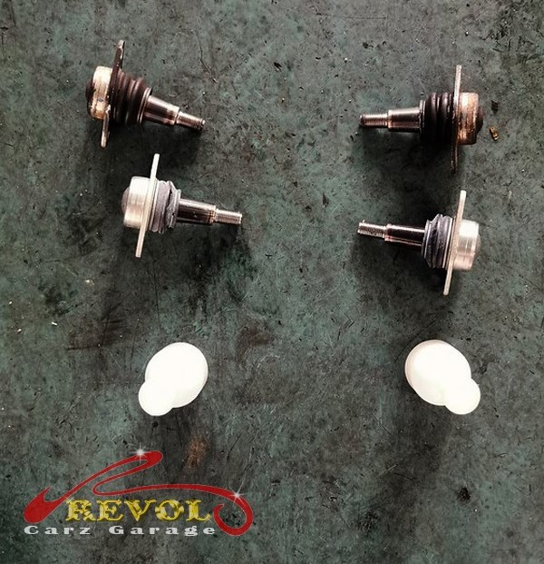

Mr. Foong BMW X4 is having some knocking sound on the front and we are tasked to check on the sound issue.
What we do when BMW expertise come in place for sound troubleshooting.
Mr. Foong arrived with his BMW X4 to check some knocking sound on the front.
The X4 is immediately hoisted up for a check
Our experience team discovered the front ball joint is worn
The new control arm ball joint awaiting replacement
Fitted professionally by our BMW specialist team
This BMW X4 is now ready to be collected by the rightful owner.

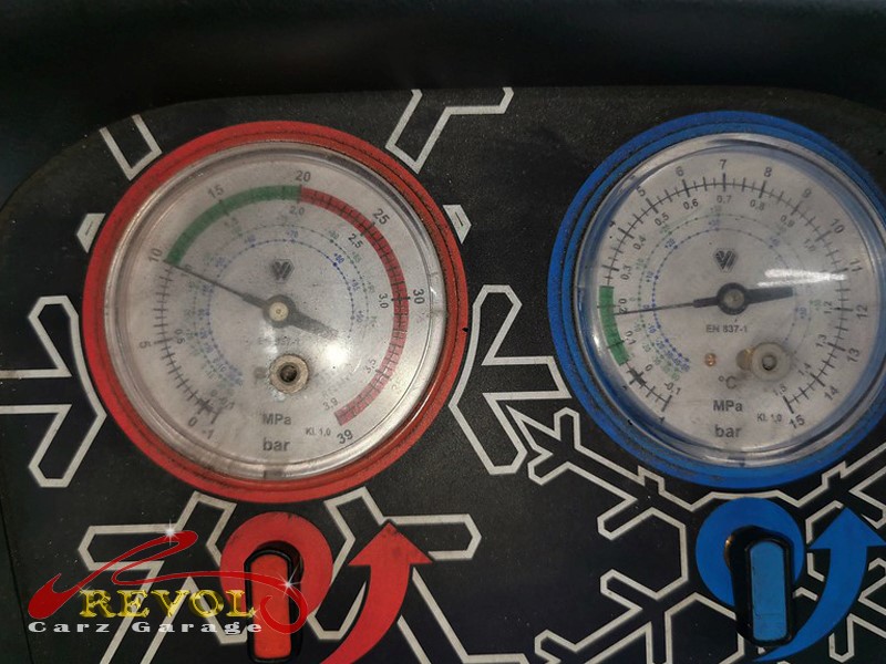

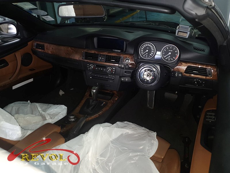

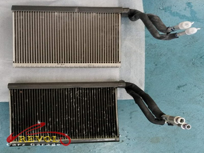

Why my air con is not cold despite my air con compressor is working?
Mr. Sani BMW 335i is experiencing air con not cold and decided to engage us to resolve his air con issue.
Mr. Sani send in his BMW 335i for aircon issue.
We tested using a specialize air con machine to test the pressure and the air con compressor seems fine.
Our experience BMW specialist confirmed the issue after the testing and proceeds with the repair swiftly.
And the dashboard is being removed professionally.
The main culprit the air con cooling coil is hidden with the dashboard which is a tedious process to remove the dashboard
We are glad to resolve Mr. Sani BMW 335i air con issue with min downtime.

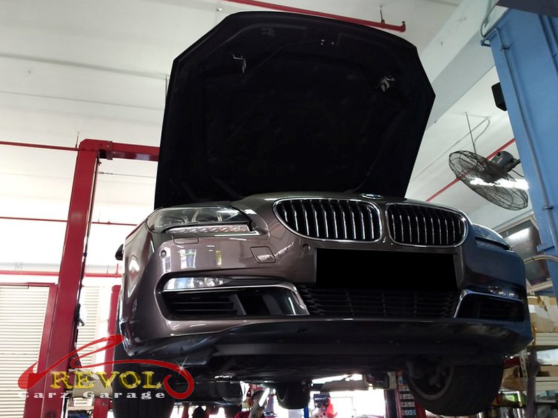

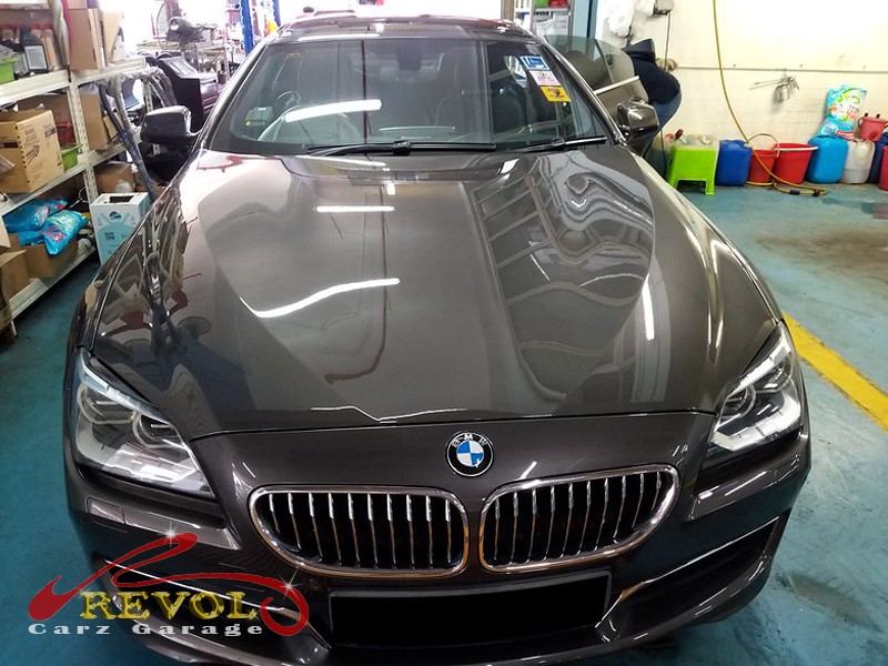

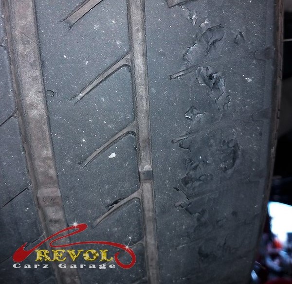

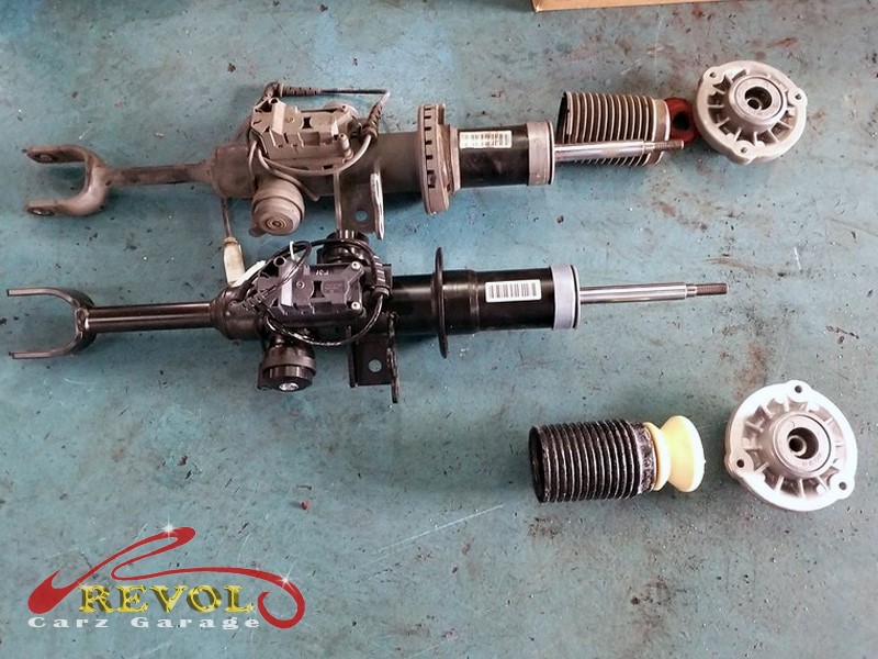

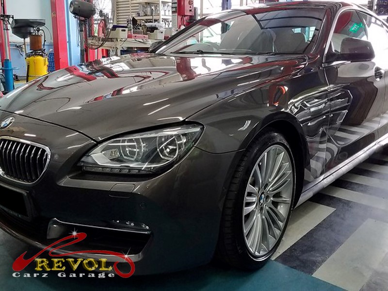

Having a loud knocking sound every time you pass through the hump?
Desmond's BMW 640i was in for a regular servicing routine and mention there is a loud knocking sound every time he passed through a road hump.
Desmond send in his BMW 640i for regular servicing with a loud knocking sound.
Our team swiftly hoisted up the car for a check.
Our BMW specialist confirmed the issue lies with a worn absorber and replaced it.
The new absorber awaiting replacement.
Do you know having a worn absorber could also wear out your tyre unevenly and prematurely?
We are glad to return Desmond's car within a day on Saturday!

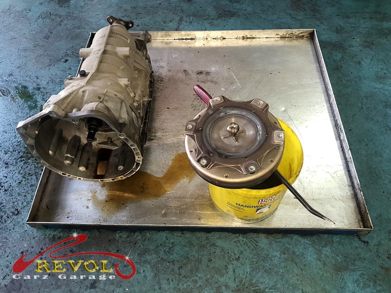

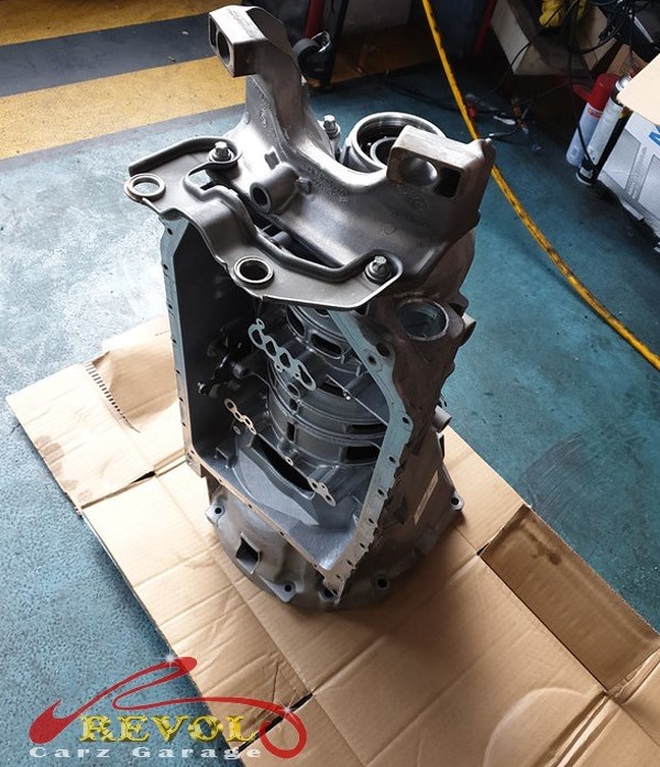

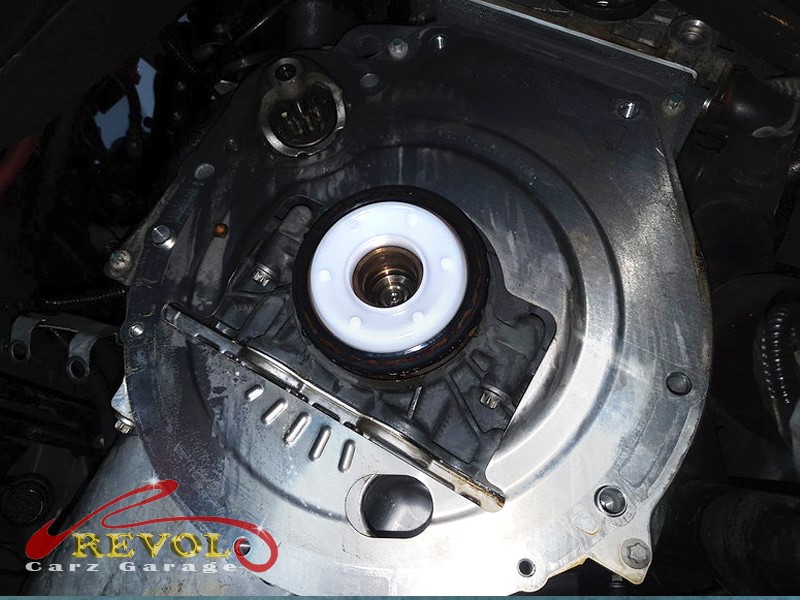

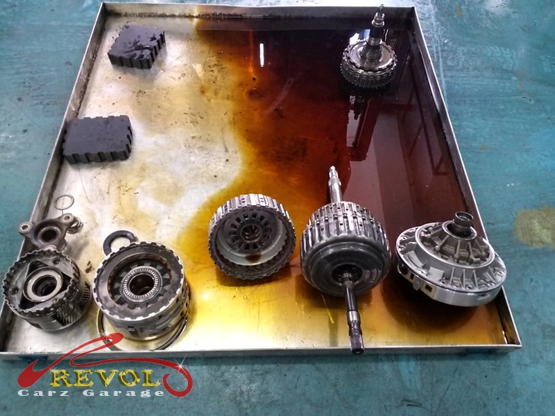

We are BMW gearbox specialist too!
Mr. Henry's BMW 520i is entering a 13 year mark and is facing some Gearbox issue.
Mr. Henry sends in his BMW 520i for Gearbox issue.
The auto transmission is having jerking and delay in changing gear and BMW handset reveal Gearbox Clutches ratio issue fault.
Repair work begin swiftly.
The gearbox was brought down professionally.
And replacing the gearbox Clutches begins.

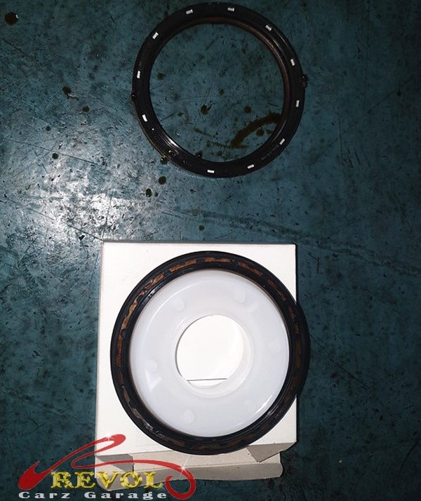

Our company strict protocol insist the gearbox to be totally cleaned before reassemble back.

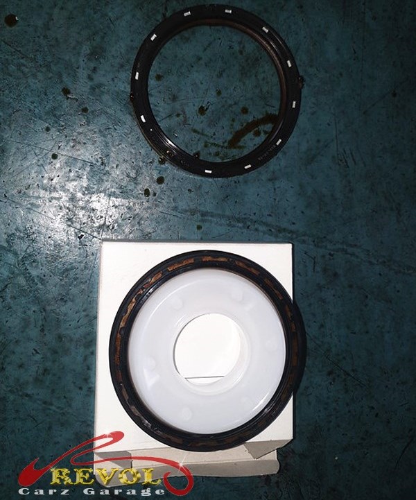

Replace your flywheel oil seal when the gearbox is being brought down to save on the labour charges.
New flywheel oil seal fitted.
We are glad to be able to resolve Mr. Henry's BMW 520i auto transmission issue.

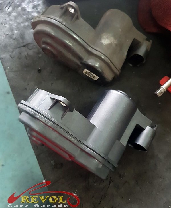

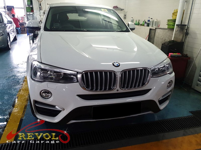

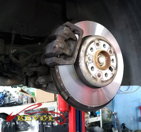

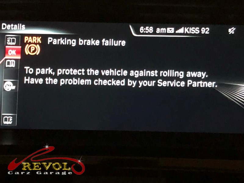

Why my car dun move despite me stepping on the pedal?
Jolene's BMW x4 is having a parking brake issue and we are tasked to resolve it.
Jolene sent in her BMW X4 with parking brake issue.
Any car owner whom have seen this understand how it feel like when the car refused to move.
The car was swiftly hoisted up to carry out the repair
The brake actuator plays a very important part to ensure the car do not move when the car engine is off even at slope.
Jolene can now drive safely her BMW X4.

Mr. Henry's BMW 520i is entering a 13 year mark and is facing some Gearbox issue. The Auto transmission is having jerking and delay in changing gear and BMW handset reveal Gearbox Clutches ratio issue fault.
Mr. Henry's BMW 520i arrives for some Gearbox issue.
And replacing the Gearbox Clutches begins.
Our company strict protocol insist the Gearbox to be totally cleaned before reassemble back.
Replace your Flywheel oil seal when the Gearbox is being brought down to save on the labour charges.
New Flywheel oil seal fitted.
We are glad to be able to resolve MR. Henry's BMW 520i auto transmission issue.

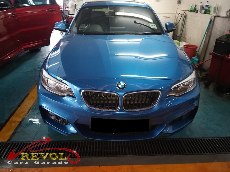

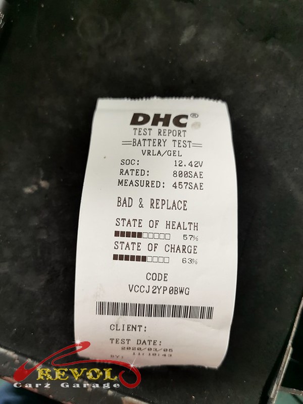

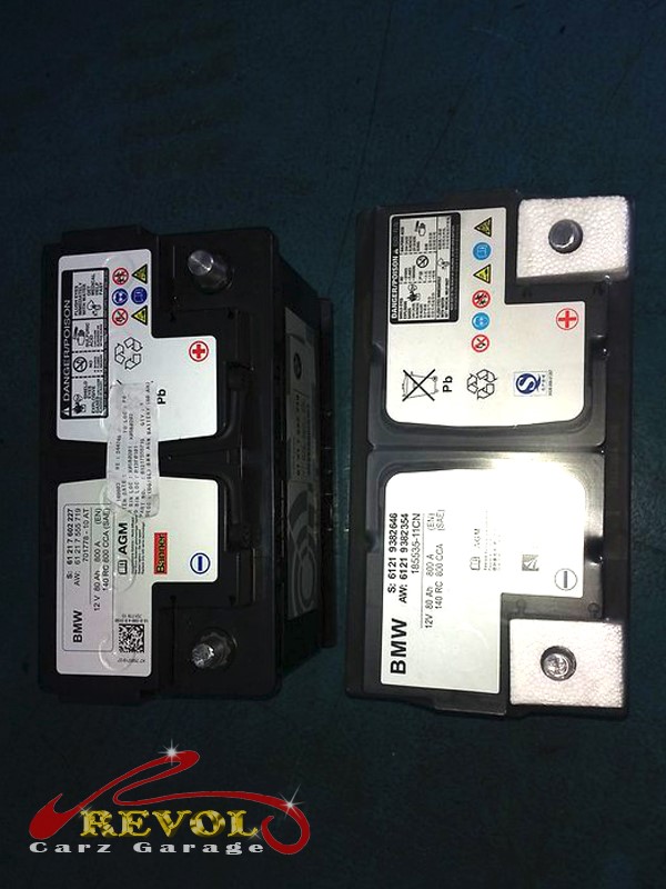

Replacing BMW Car Battery is never the same at Revol Carz Garage!
Mr. Joseph sends in his BMW 220i for normal servicing routine and was detected to have a worn Battery.
Mr. Joseph BMW 220i is having a normal servicing routine.
And our BMW specialist team detected a worn battery.
At Revol Carz Garage, we used original BMW battery and preform coding in the IBS system for every battery replacement.
Not forgetting a complimentary car wash and vacuum too.

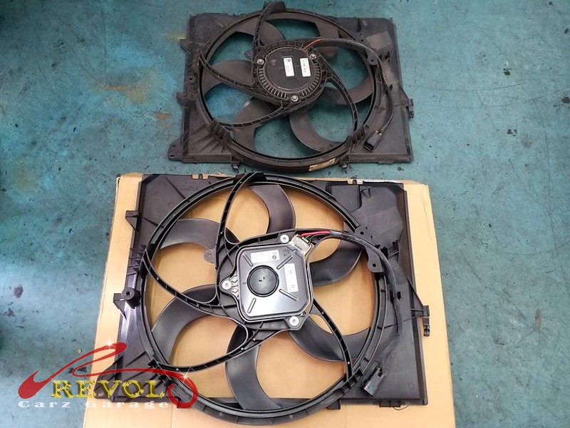

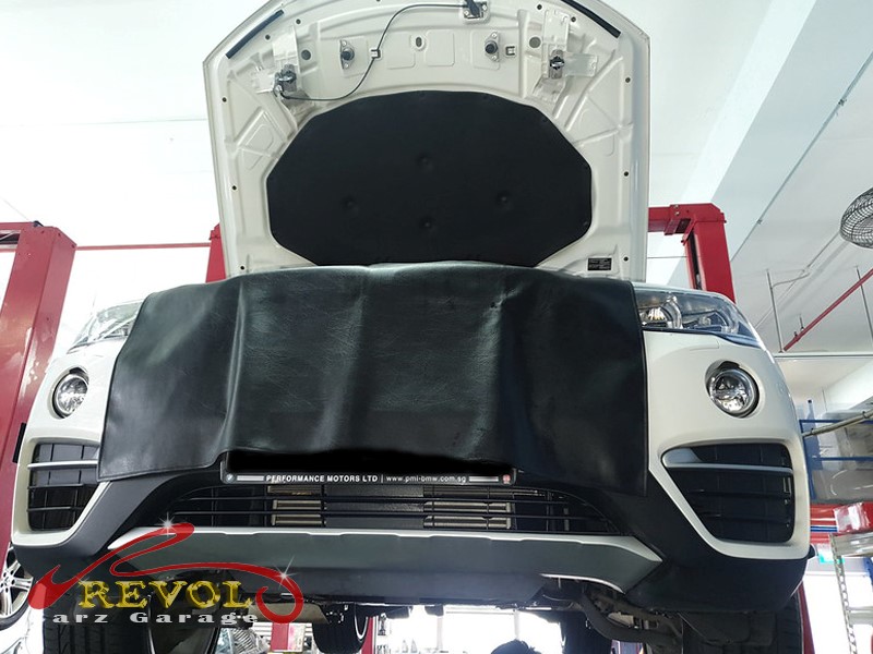

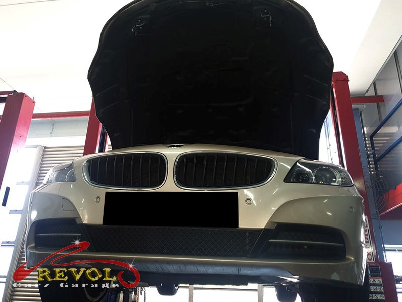

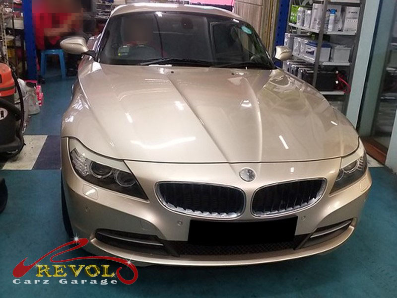

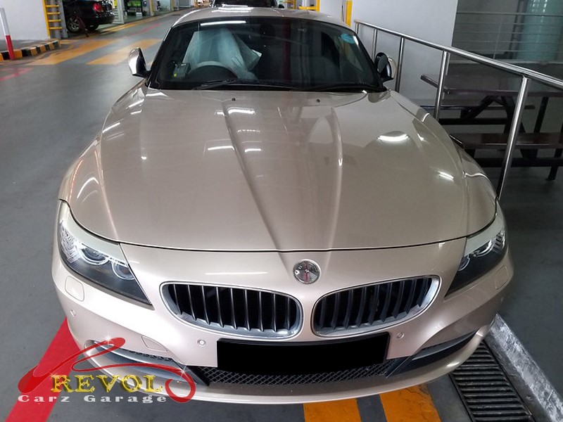

Does High engine Temperature always directed to coolant system issue?
Mr. Robin's BMW Z4 is experiencing high engine temperature and visited us for a check.
This BMW Z4 was sent in by Mr. Robin for us to check for high engine temperature.
We hoisted up the car to ensure there is no coolant leakages.
And as usual using Original BMW handset to do a scan and realized the fan motor have a fault code.
Our BMW specialist swiftly replace the Fan motor.
The BMW Z4 returned back to Mr. Robin with min down time.

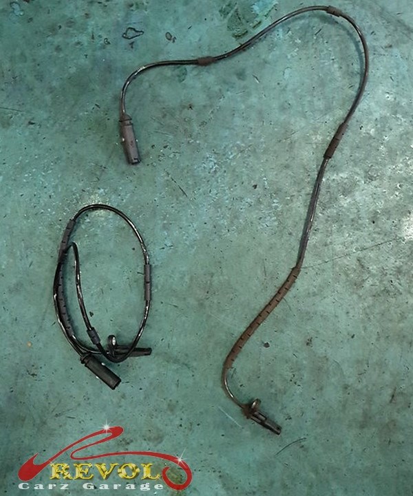

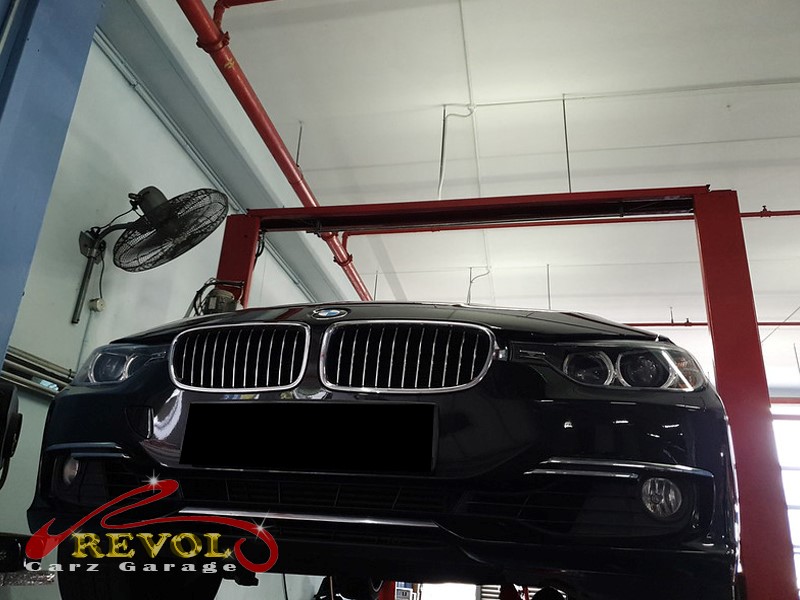

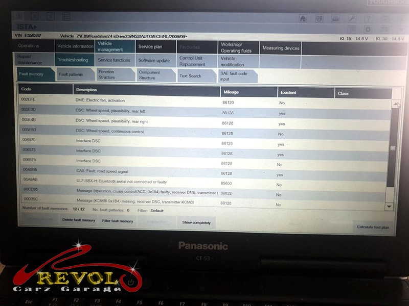

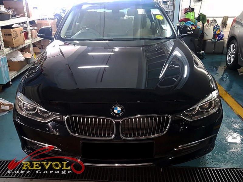

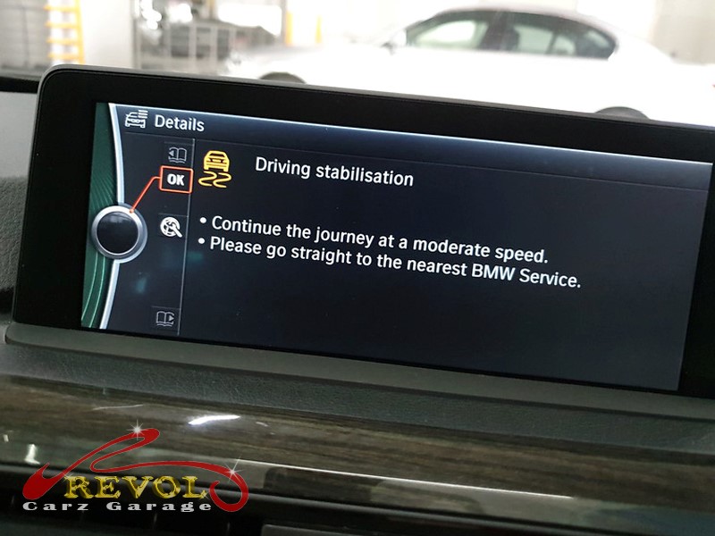

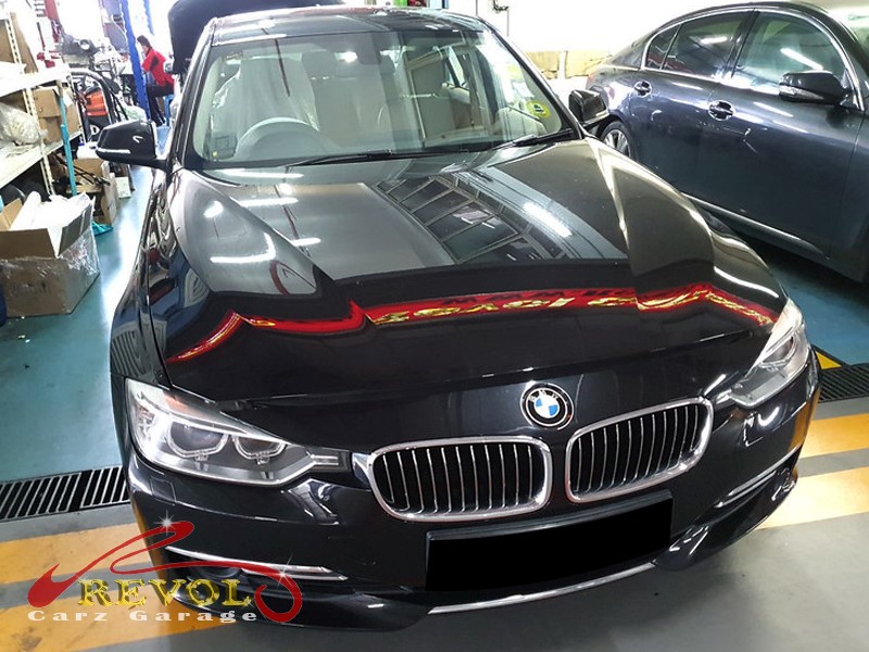

What could be the cause of driving stabilization issue?
Eric's BMW 328i is having some fault code display on his screen and visited us for a check.
Eric send in his BMW 328i showing some fault code on his screen.
Eric's BMW 328i fault display.
Car was swiftly hoisted to carry out the repair.
Our BMW specialist replaced the Abs sensor.
Car was returned to Eric with no more fault error.

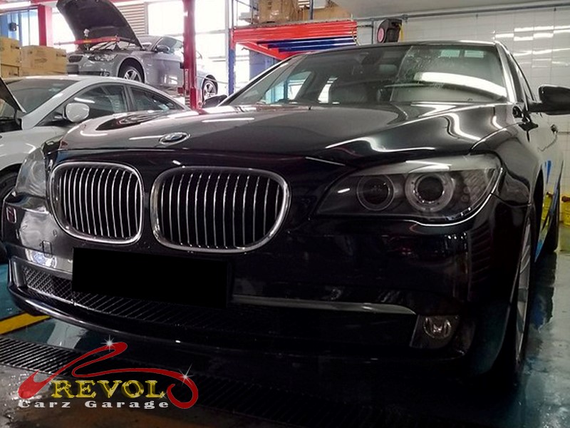

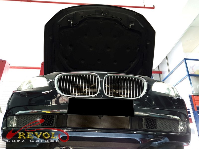

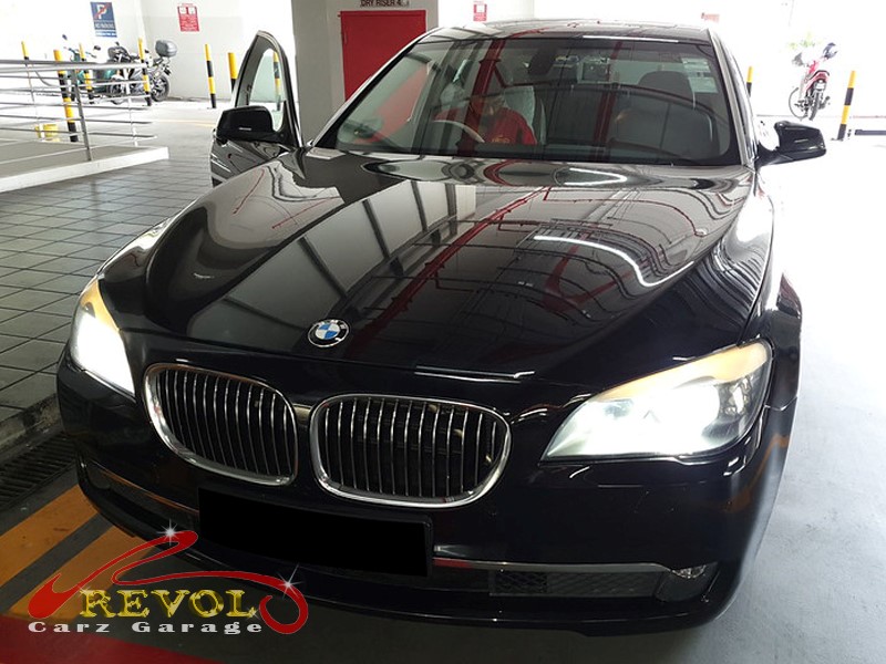

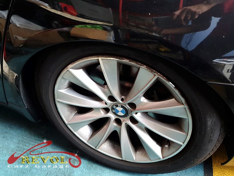

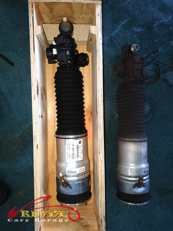

Is your BMW 7 series slanted one side?
Peter's BMW 730i is having issue with his car rear as it is slanted one side.
Peter sends in his BMW 730i with a slanted one side at the rear area.
We discover one of his air suspension is having issue.
Once our BMW specialist confirmed the issue, the car is hoisted up swiftly.
The new air matic suspension awaiting replacement.
We are glad to resolve Peter's Air matic issue.
