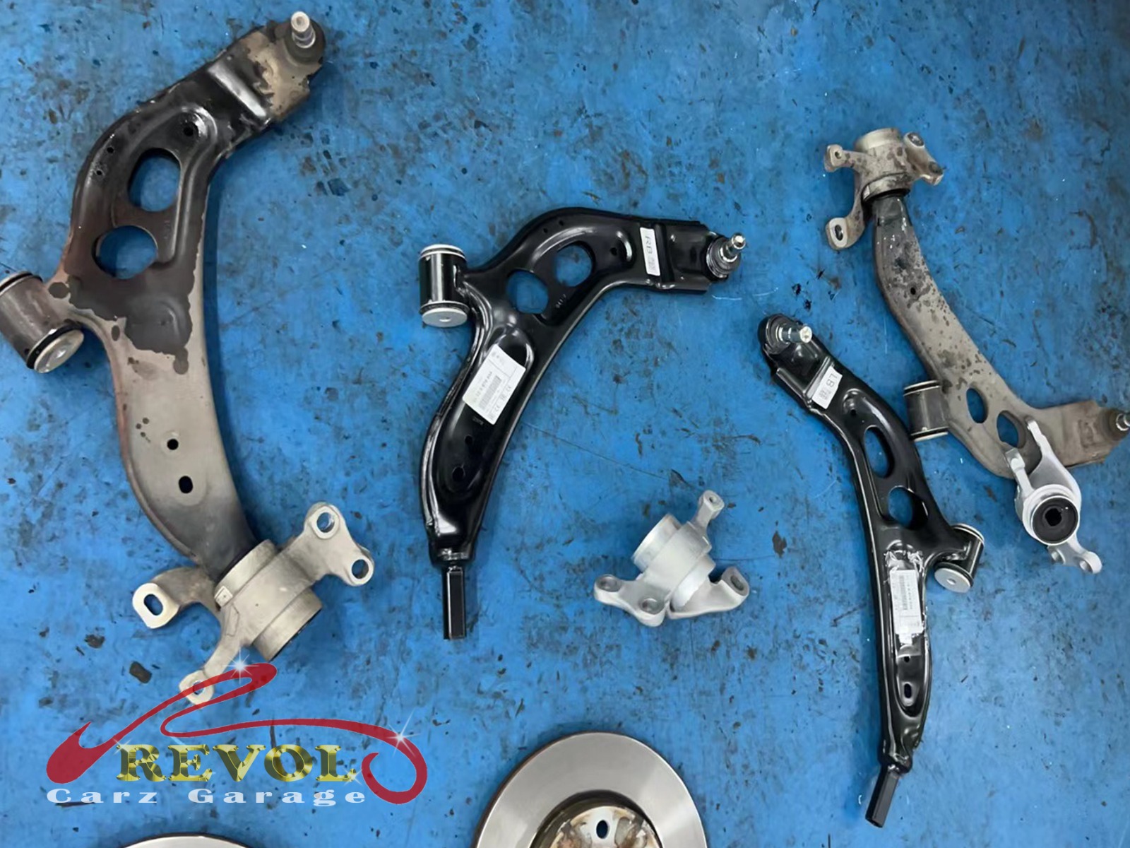

The BMW 318i Owner visited Revol Carz Garage due to a clunking noise encountered while turning the wheel.
Our BMW Expert Technician swiftly lifted the car and performed a detailed inspection of the Suspension components.
The Control Arms were found to be worn and had visible cracks, contributing to the clunking noise.
Before installing new Front Suspension components, we are dismantling the worn parts for replacement.
To eliminate the clunking noises and restore optimal suspension performance, we replaced all worn components, including the Control Arms and Lower Arms, as a complete set.

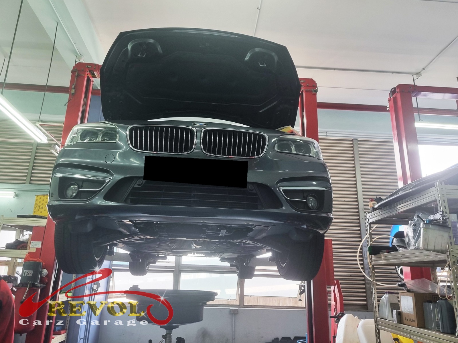

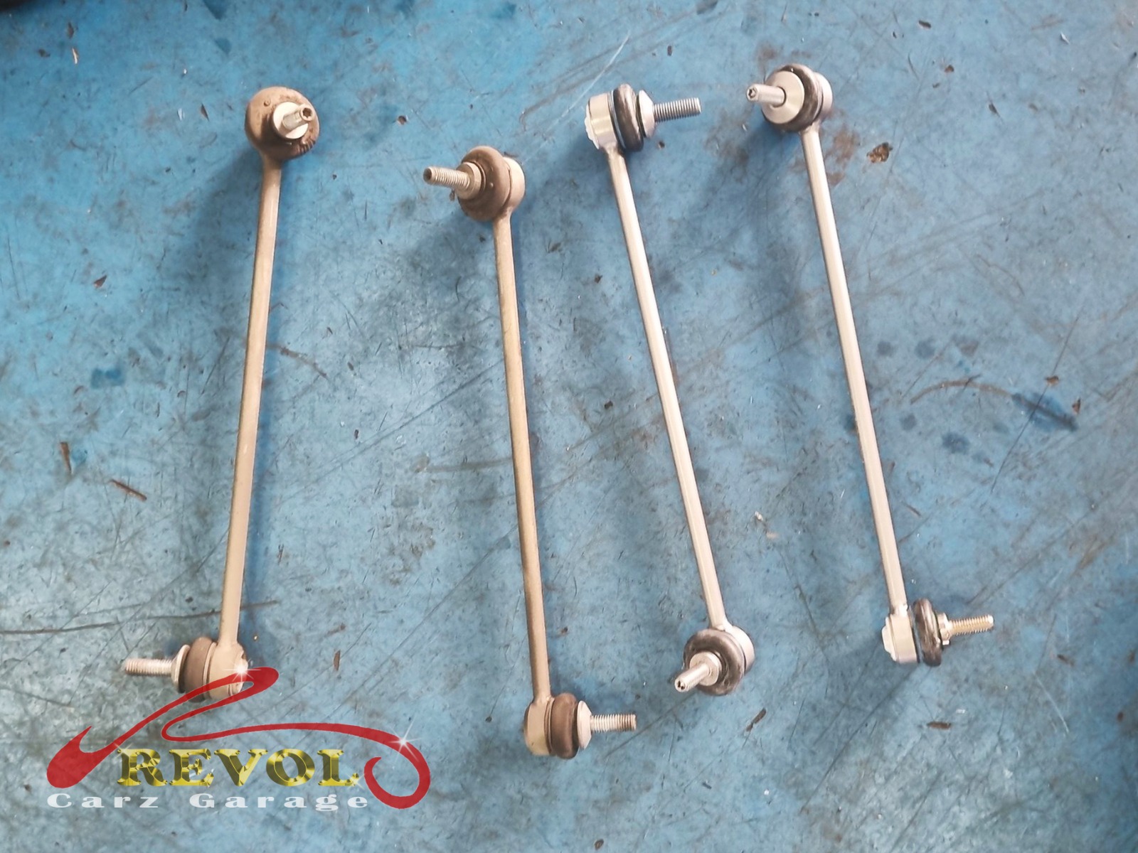

The BMW 216i Owner sought assistance at Revol Carz Garage after hearing rattling noises from the undercarriage when making turns.
Our BMW Expert Technicians hoisted the vehicle and thoroughly inspected the undercarriage components, which revealed the cause of the rattling noise.
The main culprit was identified as a worn Front Shock Absorber Linkage.
By replacing the Front Shock Absorber Linkage, the odd noise was eliminated, handling was improved, and ride comfort was restored, preventing potential future suspension system problems.

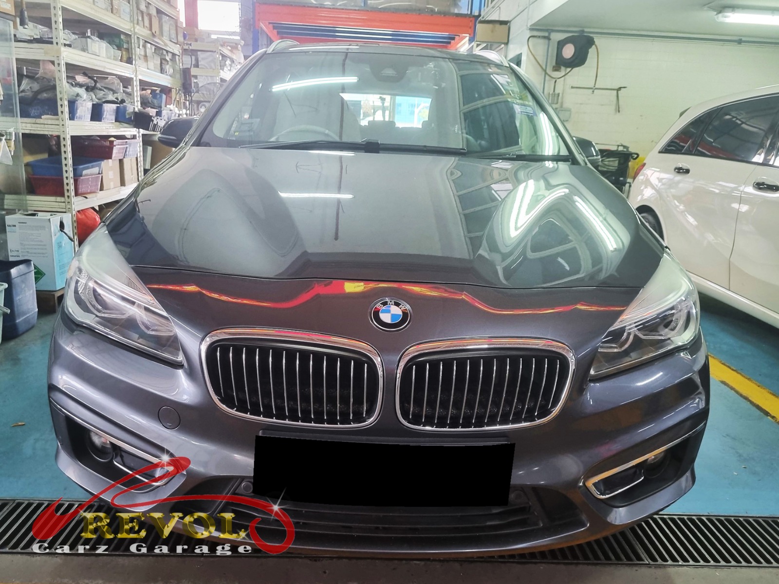

The BMW 216D Owner sought assistance at Revol Carz Garage after hearing clunking sounds when turning.
Our BMW Specialist lifted the vehicle for a detailed inspection to identify any underlying issues.
The Front Lower Control Arms were found to have cracks and a fluid leak, requiring immediate replacement for optimal safety and performance.
Replaced with new Front Lower Control Arms to ensure improved handling, stability, and overall vehicle performance.

If you’re hearing clunking or knocking sounds when driving over bumps, or if the ride feels rougher than usual, it could be a sign that the Front Absorber Linkages are worn or damaged.
These Linkages connect the Shock Absorbers to the Suspension System, and if they fail, it can lead to poor handling, increased body roll, and misalignment, which may result in uneven tire wear.
At Revol Carz Garage, our experts will carefully inspect the Suspension System, identify any worn components, and replace them with high-quality parts to restore your vehicle’s performance and ensure a smoother, safer drive.
Do feel free to drop by Revol Carz Garage at 10, Ang Mo Kio Industrial Park 2A # 02-18 Ang Mo Kio Autopoint or contact us at 6555 1171 or whatsapp us at https://api.whatsapp.com/send?phone=6593222338.
You may also SMS / Whatsapp to Gavin at 9740 6855 for friendly and absolute no obligation consultation.

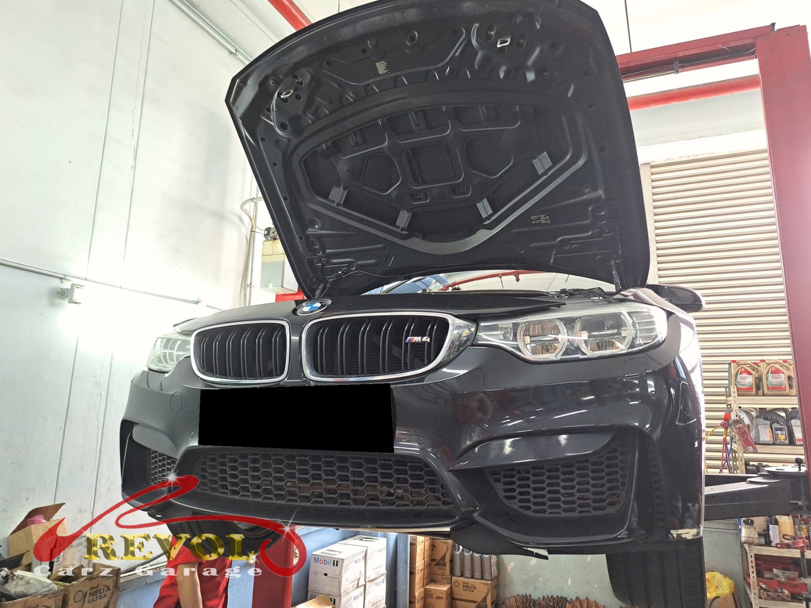

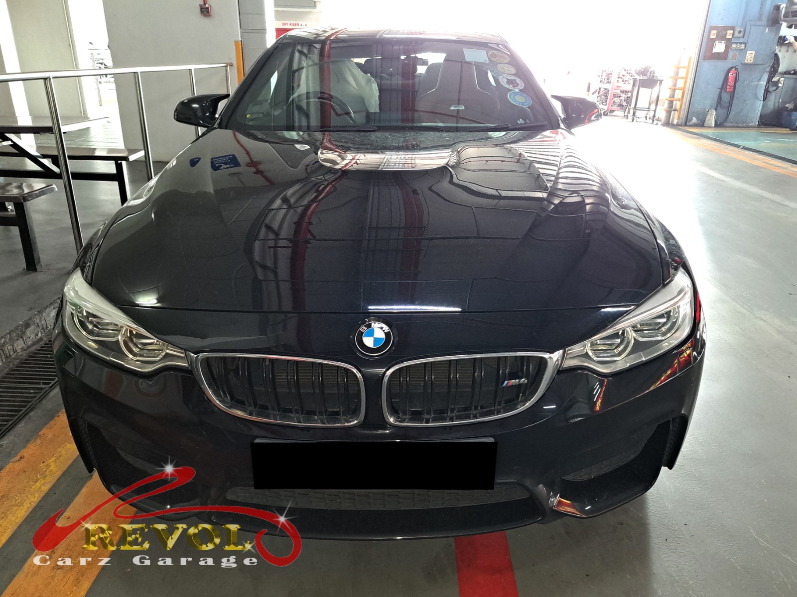

The Owner of a BMW M4 visited Revol Carz Garage due to increased body sway during turns and a rougher ride feel.
Our BMW Expert Technicians lifted the vehicle and conducted a thorough inspection of the undercarriage components.
The worn Front Absorber Linkage was the main culprit behind of the issues.
Replaced the worn Linkages restored the vehicle’s suspension system for a smoother and more stable driving experience.
