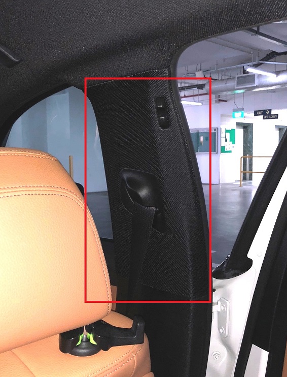

Another issue will be our B pillar ...any driver realize that's a smell from both side of the B pillar for 530i M sport package

No smell noticed on my 530i M-sport since Apr 2017
@Sarthkg lucky you .... i'm going to replace the B pillar soon. Will find out why the B pillar material deteriorate and create a smell
Please let us know your findings, will be interesting to know the reason. I personally never came across such issues.
