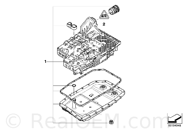

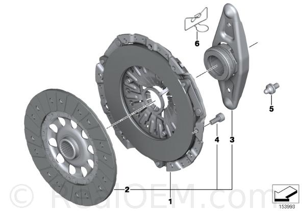

we have 3 main components in the gear box as far as i know,
please correct me if i am wrong.
1. valve body / Mechatronics
2. soleniods
3.clutch
based on what u described, i suspect it's the clutch plates, u need to do an over haul.
on 2nd thoughts, maybe just the mechatronic
