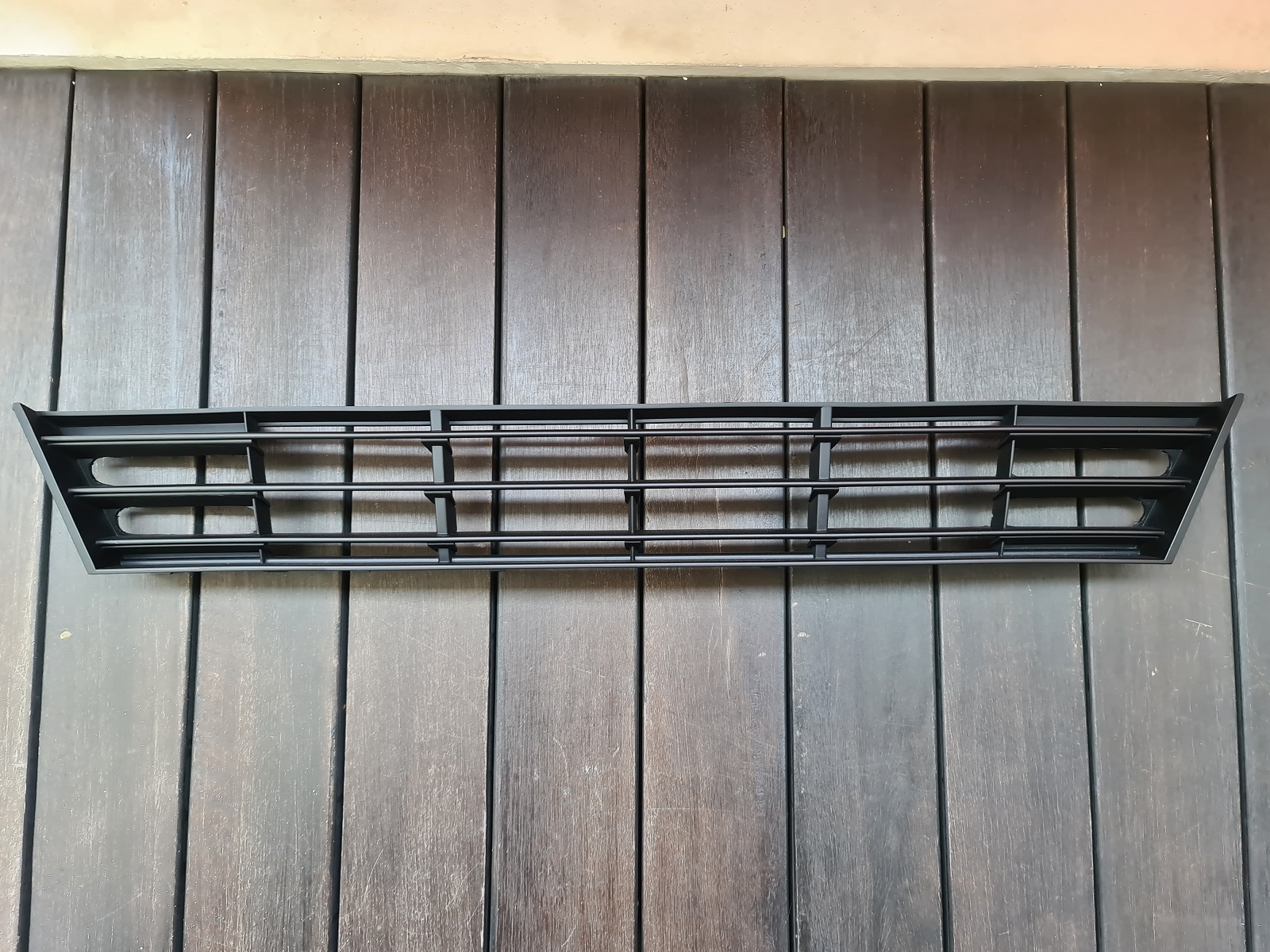

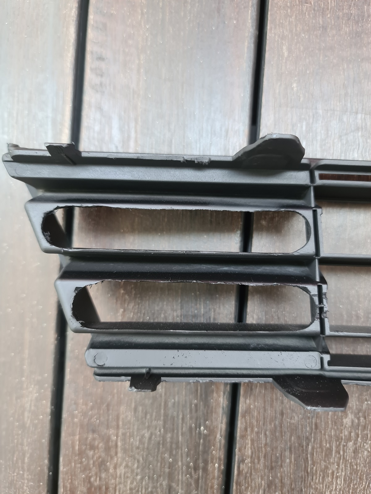

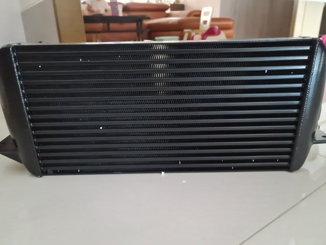

Damn virus getting bored and decided to improve ventilation to the radiator and intercooler and have the lower grills repainted matt black as they were turning whitish from all the car shampoo residue and sun.
Pulling the lower grills off was easy, its all just clips and pulls straight out no need special tools. Dremel time and I hacked out the side of the middle grill opening it up by another 1/4 i suppose. Just need a bit more smoothing out and its done.
Took it all down to a local spray shop guy who's really nice and friendly and doesn't charge me a arm n leg for a simple matt black repsray at $70 for all 3 pieces. Most places wanted in excess of $200 for 3 small pieces so no thanks.
Found out they could have done it for me actually but wanted to try my hand out at doing it myself.

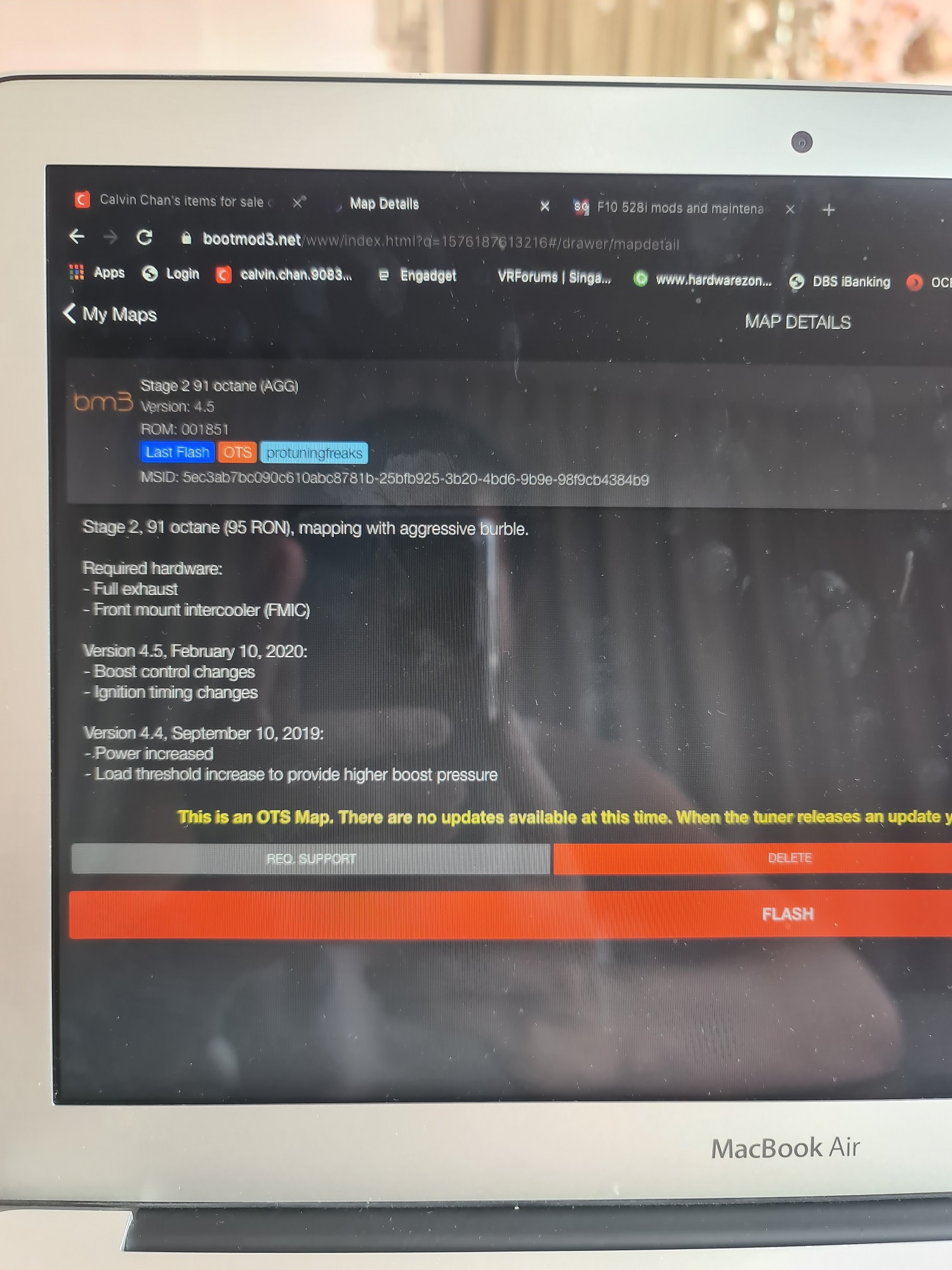

For your bootmod3 stage 1 did you also get your charge pipe changed? It was highly recommended across forums n workshops.
Yup FTP boost and charge pipes as these are under high pressure. Think I documented it in the 1st page

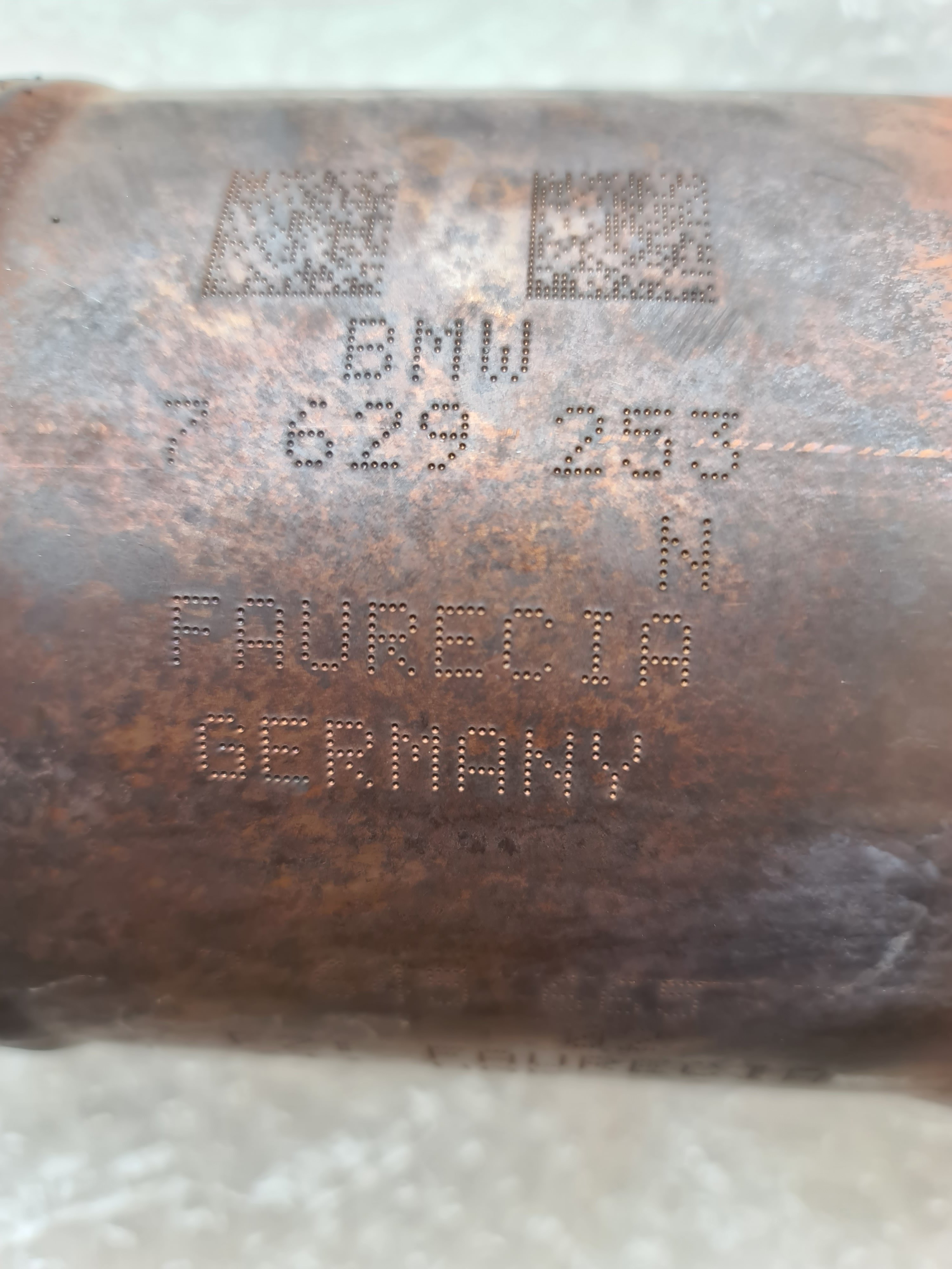

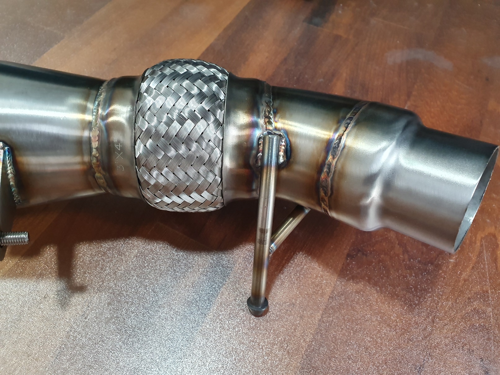

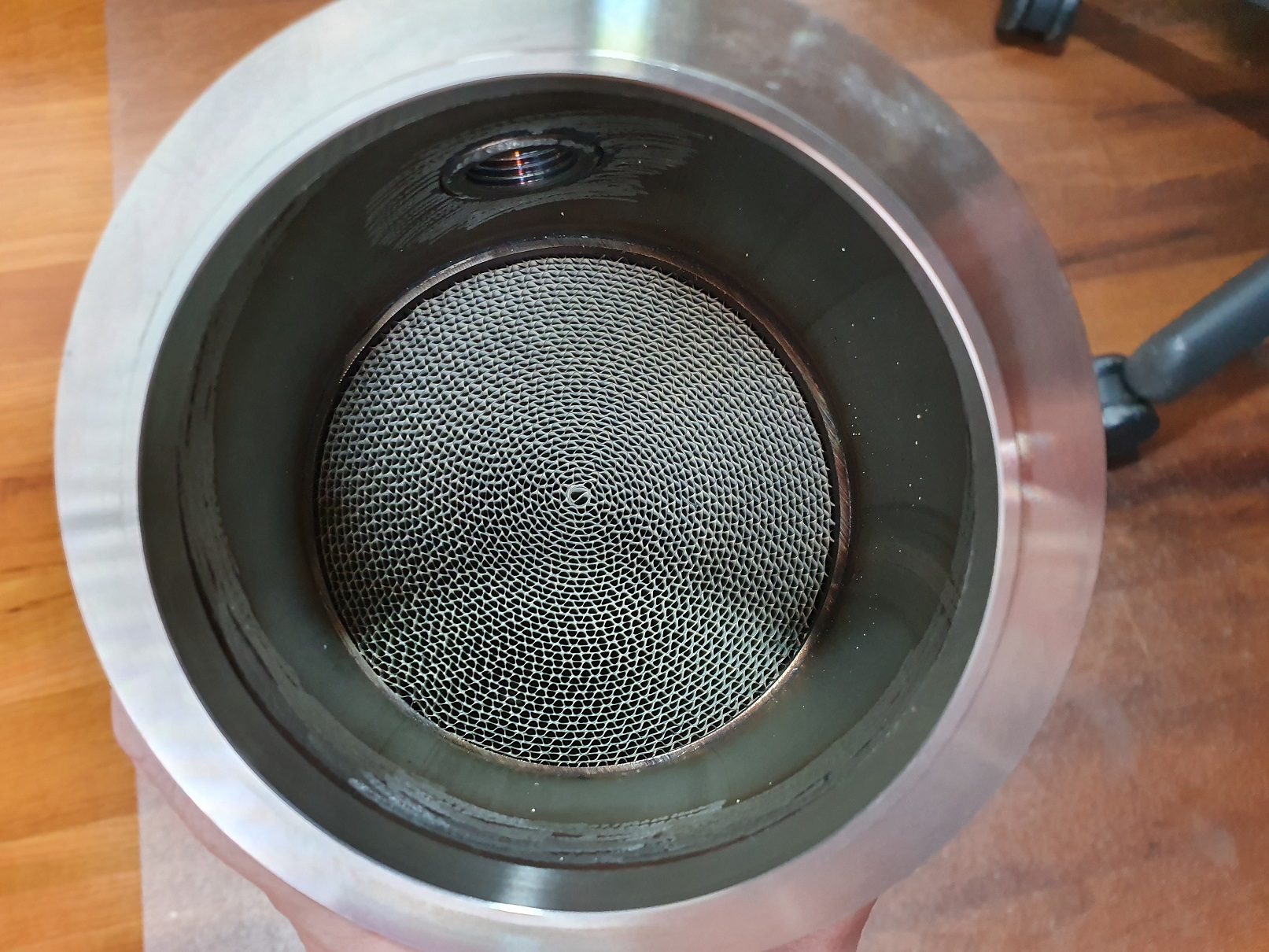

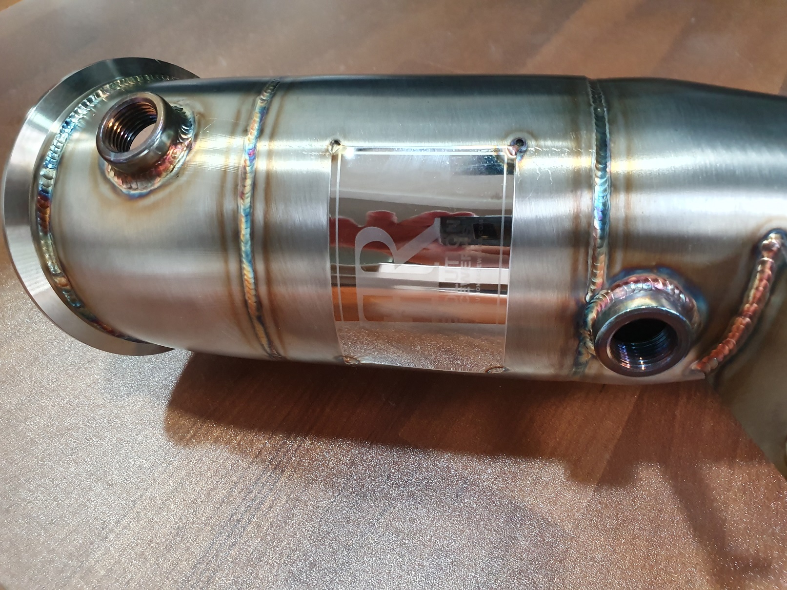

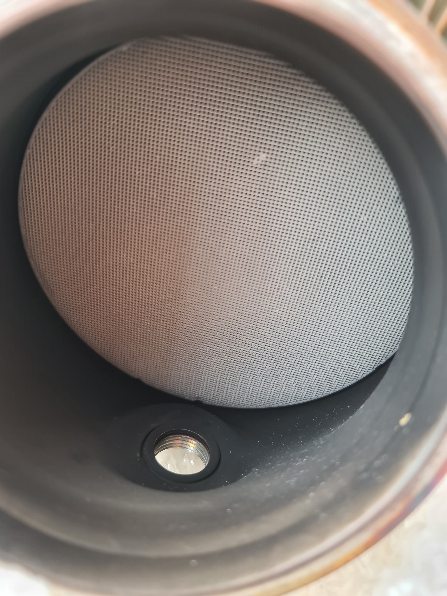

Out with the old and in with the new downpipe ! Stage 2 ($50 USD) on the way with BM3 ! Installed new ER downpipe with META Mechanics $80
ER Downpipe with 200 cell racing cat ! No Smell no check engine light and feels much better. And yes there is a slight increase in growl under acceleration. Additional benefit is its lighter then the stock downpipe

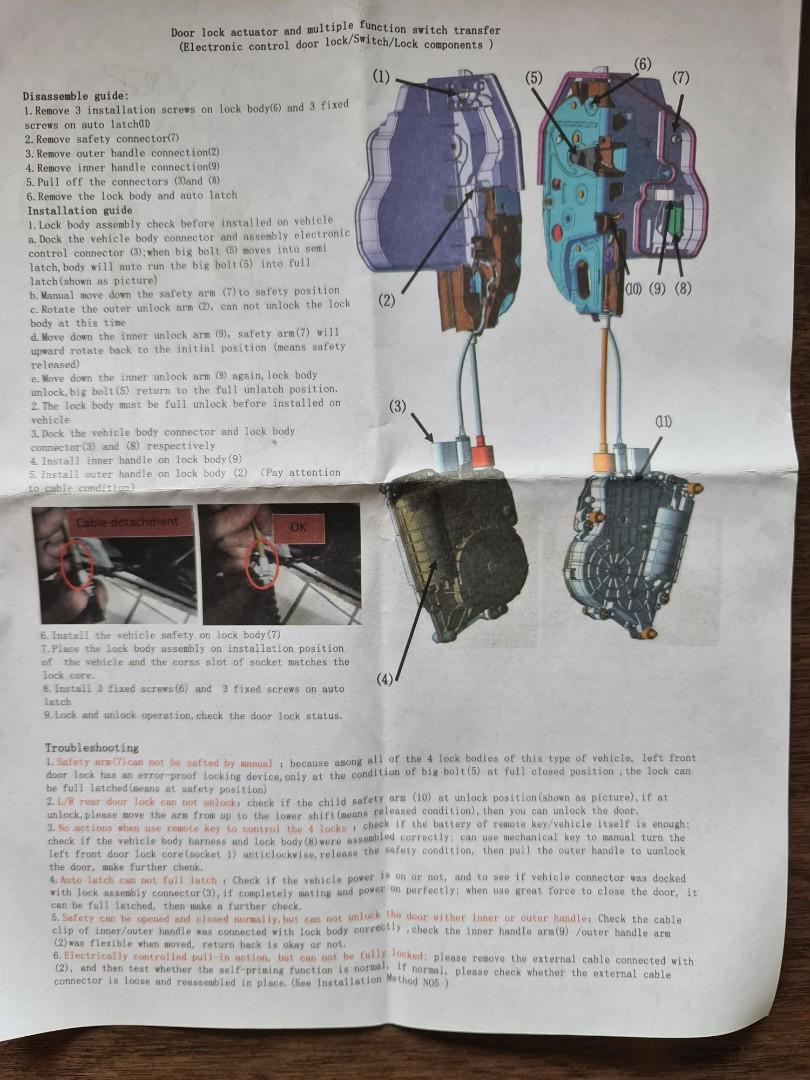

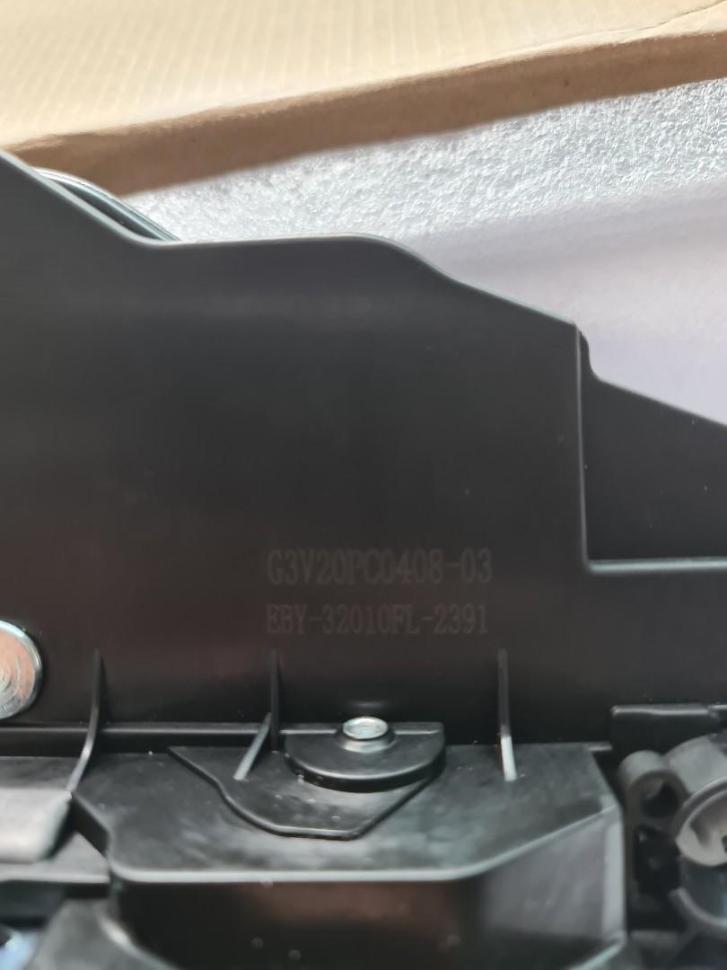

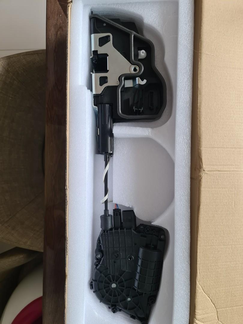

About 3 weeks ago while washing the car the front passenger lock actuator died. Unable to electronically lock or unlock the car but everything else still works sigh price of owning an aging bmw. Parts from Eng Soon and other stockist seem to hover around the $620++ mark as there doesn't seem to be any OEM parts locally available.
Managed to find the parts WAYYY cheaper and it took all of 7 days to reach, looked up the DiY as this is perfectly doable with basic tools. This came complete with installation instructions and the soft close motor.
Free Repair Manual
https://www.newtis.info/tisv2/a/en/...21-door-locks-handles-fittings-front/1KyXQ0Xb
Total time taken was about an hour and a bit fiddly but good as a rainy morning project to keep the boredom away. Most shops would charge about $80 for the install.
A good hint would be to connect everything up make sure the lock works before putting everything back together.
