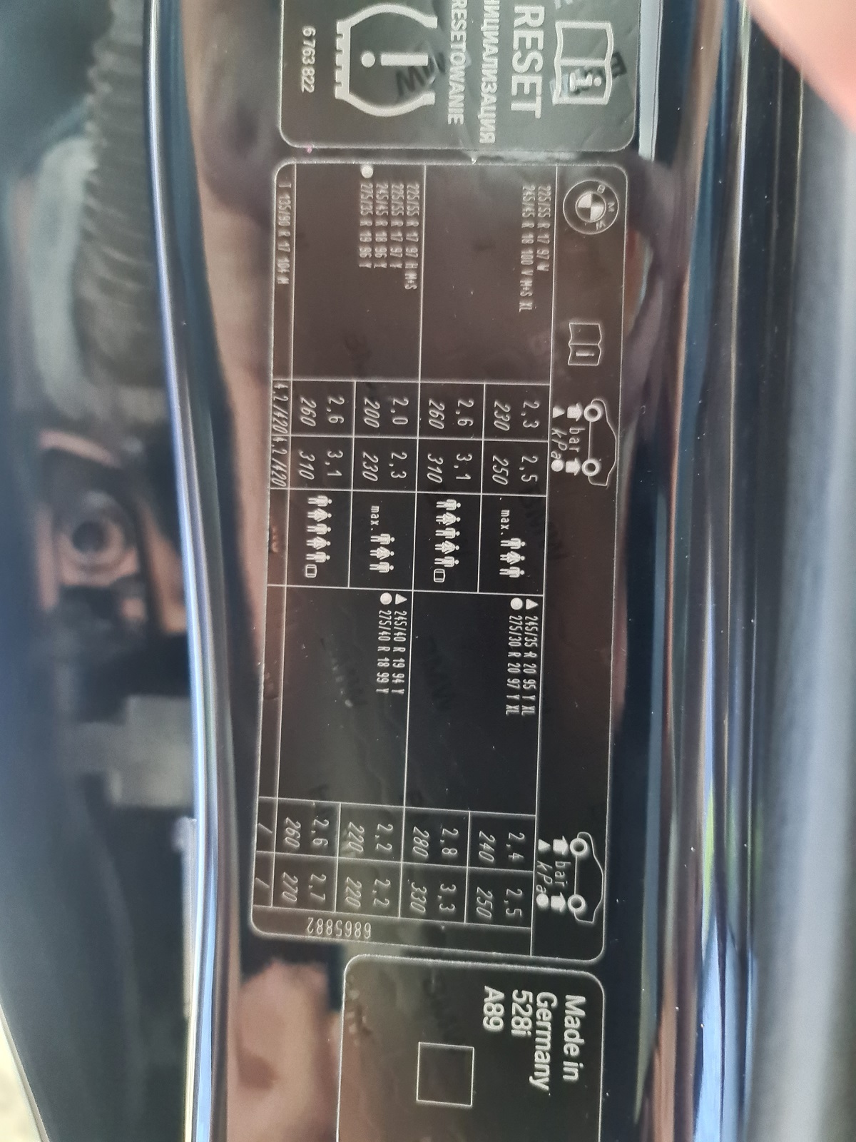

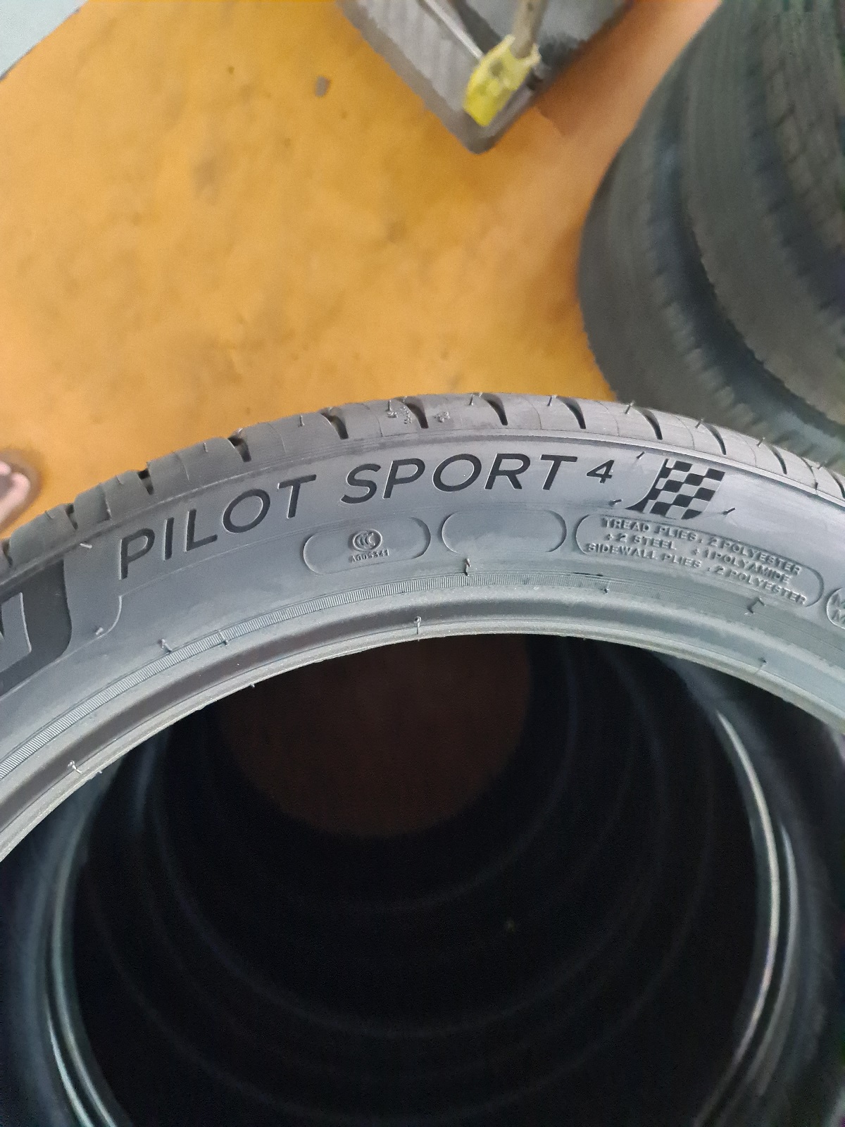

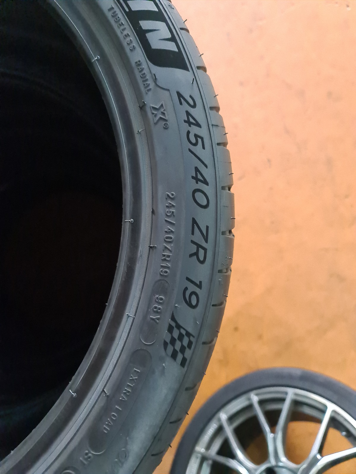

Time for new rubber ! PS4 245/40/19 $250/tyre , for those asking what PSi its dependent on tyre size and number of passengers in the car.
Picked up at 4 Defu Lane 1 , Singapore 539479

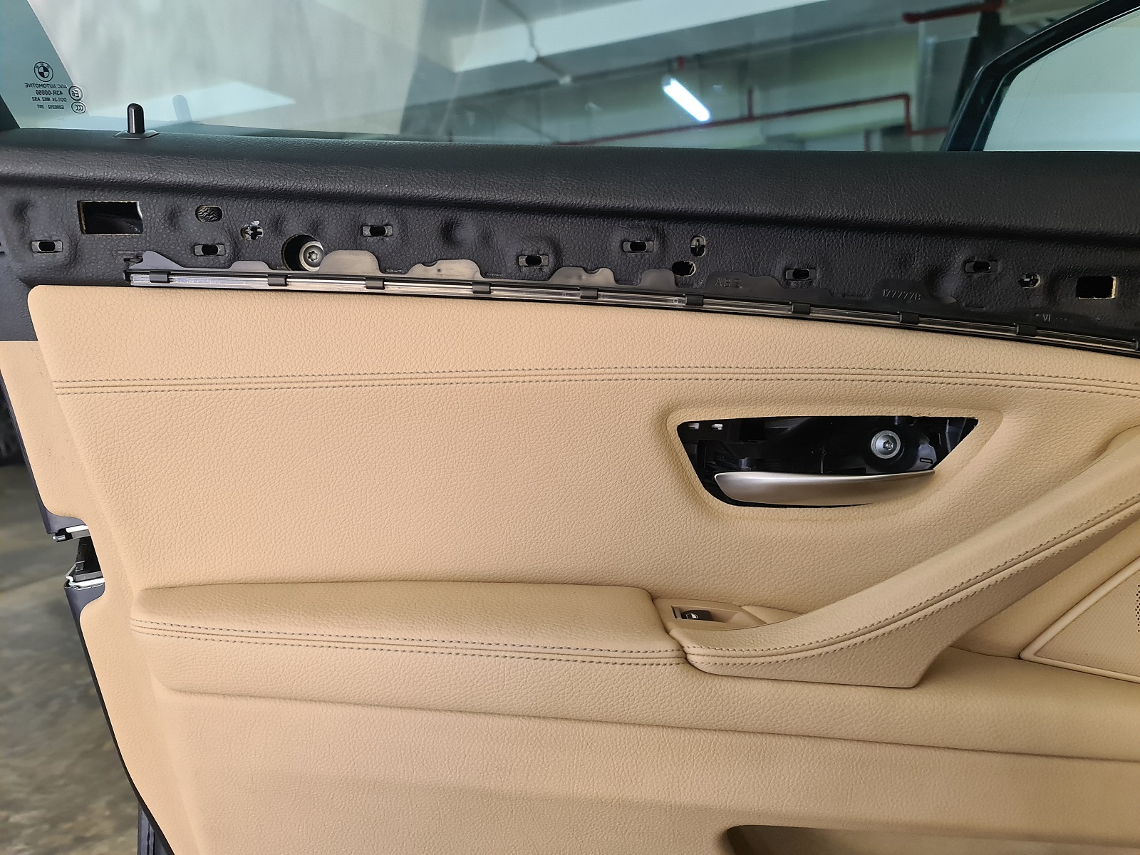

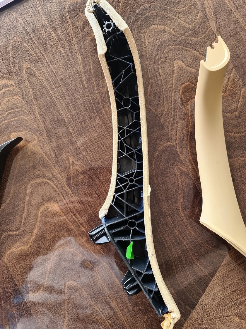

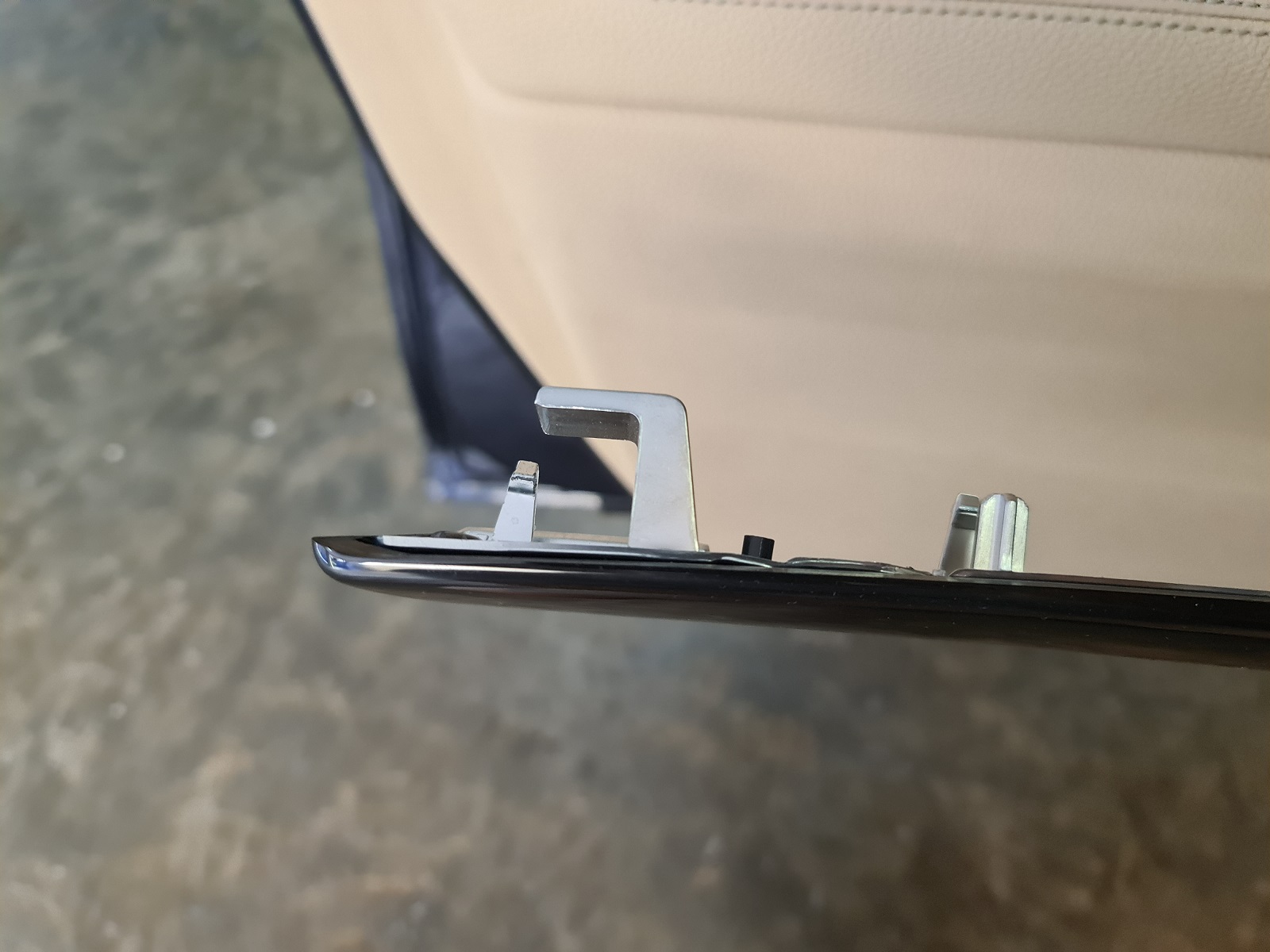

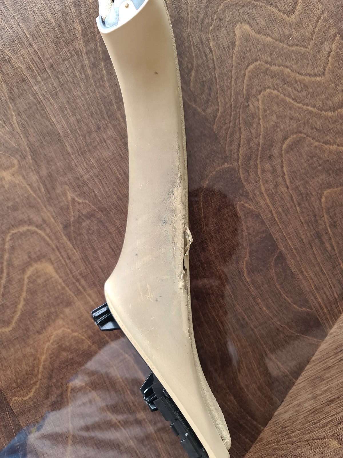

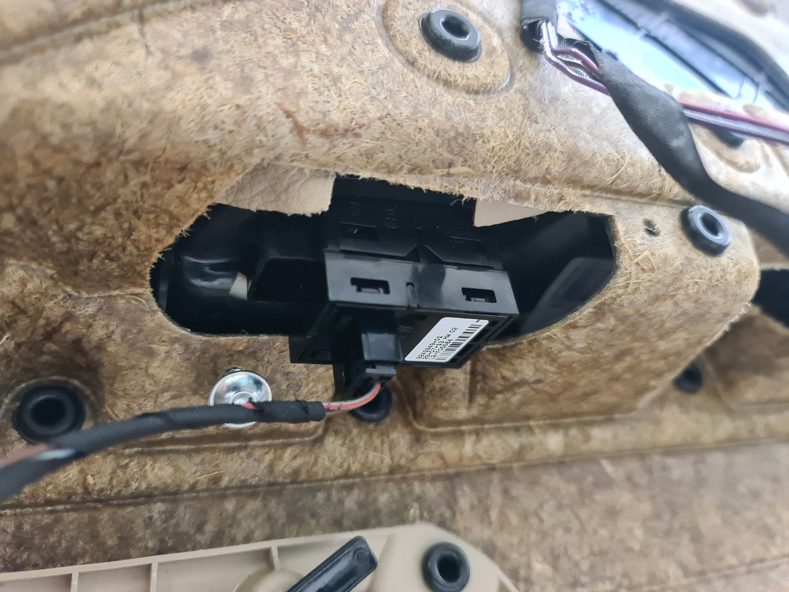

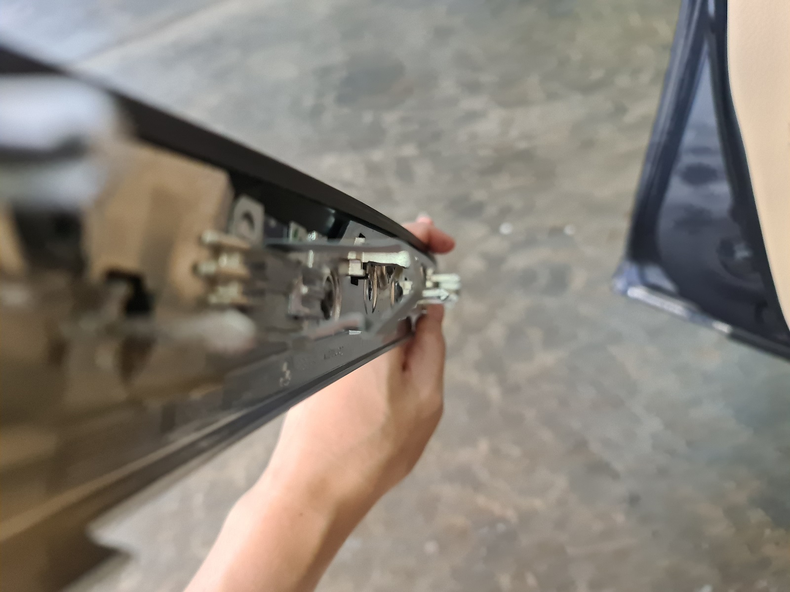

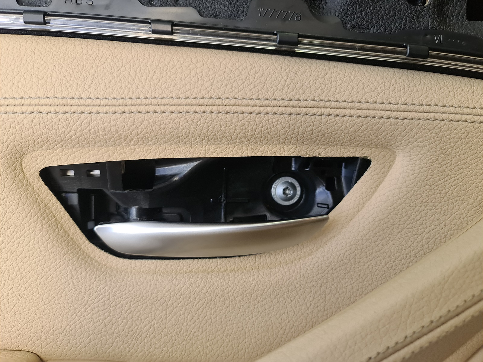

1 sticky handle left decided to finish it up instead of letting it slide. You can do it with the door card connected to the rest of the electrical connections.
4 screws to remove to release the handle from the door card.
2 X Torx 20
2 X Torx 30
Squeeze the sides of the window switch from the back to remove the handles as per the video.
Credits to this Korean guy for showing me the way.
Simple tools required total time approx 30 mins +

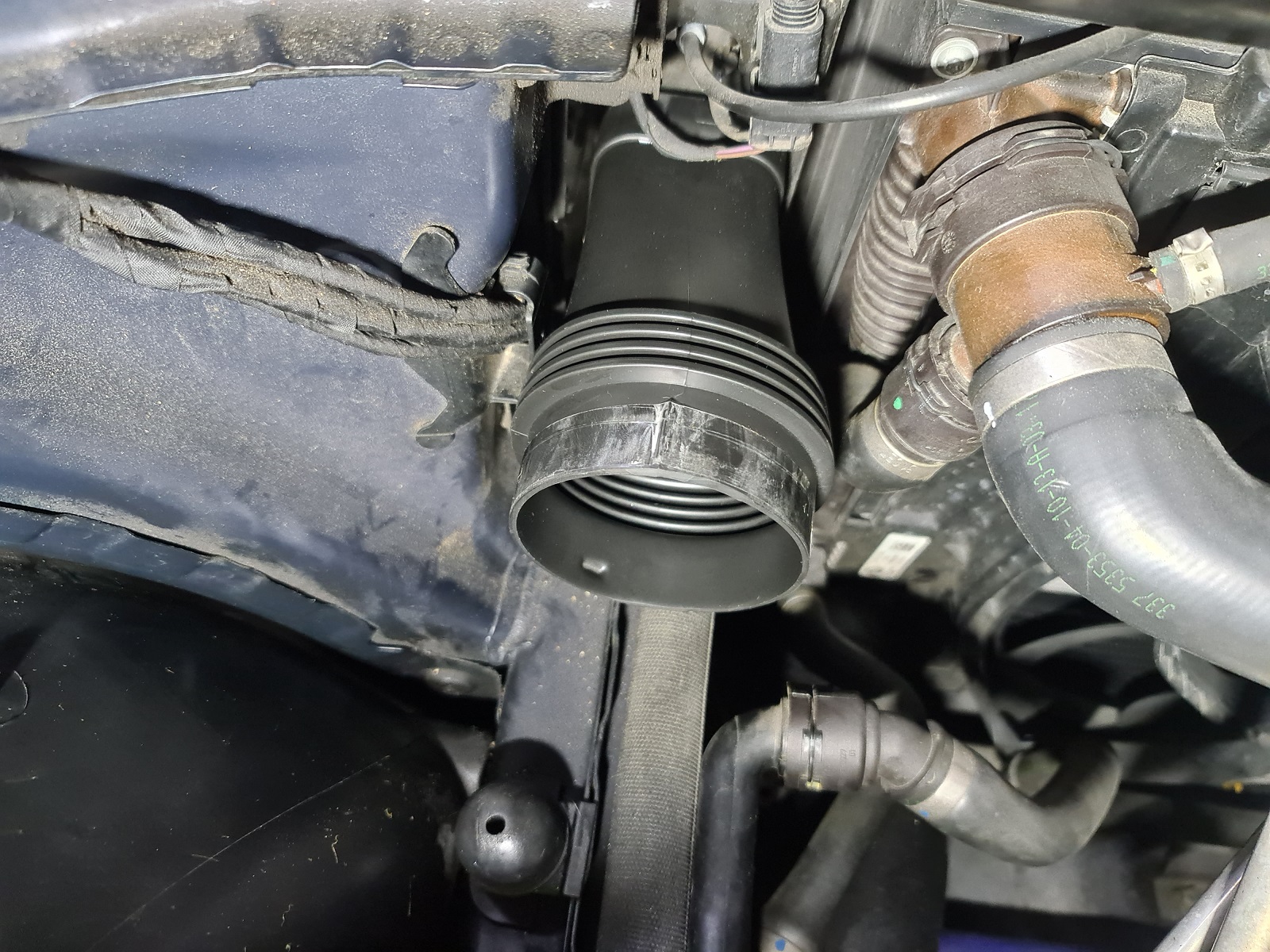

Decided to order my intake pipe. To replace the plastic piece, was tempted by MST intake but at nearly $350 sgd and no stock locally I went with FTP as I already have the charge and boost pipe. Also the MST is only partly metal with a good lot actually being cheaper silicon.
Link for MST:
https://mst-performance.asia/product/mst-bmw-n20-26-2-0t-turbo-inlet-pipe-bw-n2002/
Link for FTP
https://sg.carousell.com/dpmotorsports/
Super nice guy took about a week to come in, highly recommended seller ! His prices are pretty much what you see on the FTP webpage and that's with shipping to Singapore and delivery to his recommended workshop for installation.
He has quite a few workshops that will do the install but for east side CK Motors was the only one.
$240 (Intake) + $50 (Install) = $290 to replace the craptastic piece of pipe that BMW chose to put into a turbo charged engine.
Much hype about better airflow etc etc throttle response and power gains (all of which I'm oblivious to and can't feel). The only thing I do notice now is a soft but audible blow off sound when I let off throttle when building boost that I've never heard before.
All said and done, no check engine lights, car still pulling like a bull on stage 2 BM3 and happy with the experience can't say more then that.

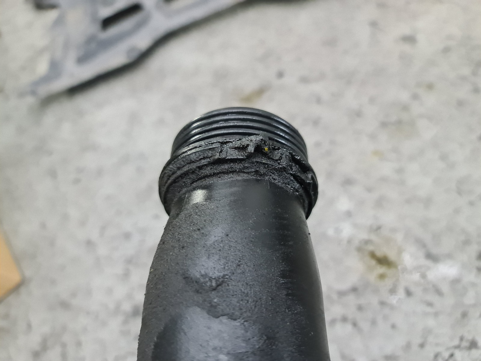

And just to prove a point. Tada ! Best use of plastic award goes to my all time fav manufacturer ! Yes mounting point already broken.
Workshop says failure along the connecting points is super common leading to boost leak and loss of power many error and check engine lights.

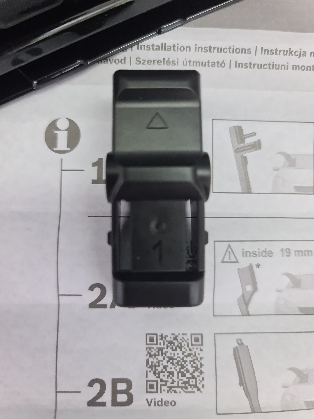

Rainy rainy days are here decided to change wipers as it was getting streaky and making some noise as it goes across the windscreen. Most places seem to want upwards of $60 for a set of wipers but I managed to get mine about $30 for the PAIR.
F10 requires
1x18"
1x26"
Buy it here
https://shopee.sg/product/173483312/5715720342

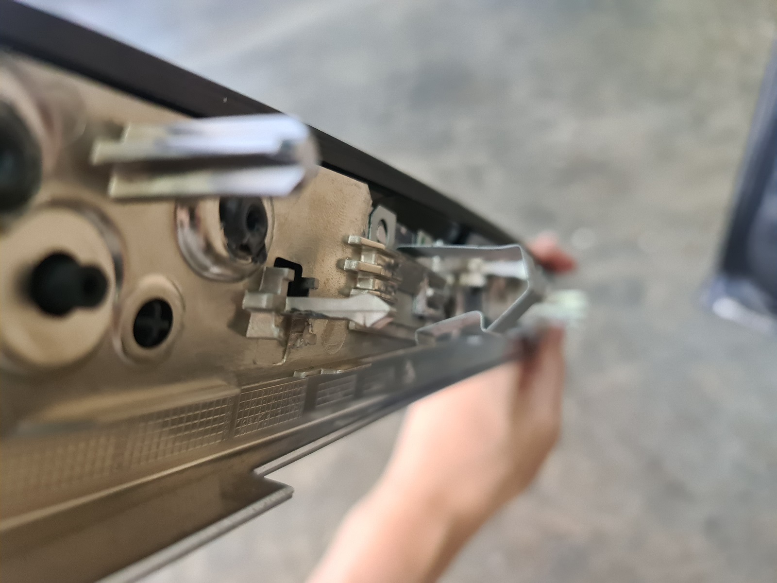

1st up put the wipers into service position. To do that with ignition "OFF' hold the wiper stalk in the topmost position (2 detents up) for 3 seconds. Personally I could only get it to work by cycling the power on then back to off again, only then could I get it into service position. Just go up 2 detents no need to stop in the middle like my video here.
Then remove the wipers like so
Assembling the wipers
Number 1 adapter for the F10
Notice the number 1 on the adapter
After removing the wiper put a nice thick cloth under the wiper and put it back down while working. Tension is VERY strong and if it snaps back onto the windscreen it will crack the glass !
And then just reverse the process ! Tada wiper change under $35

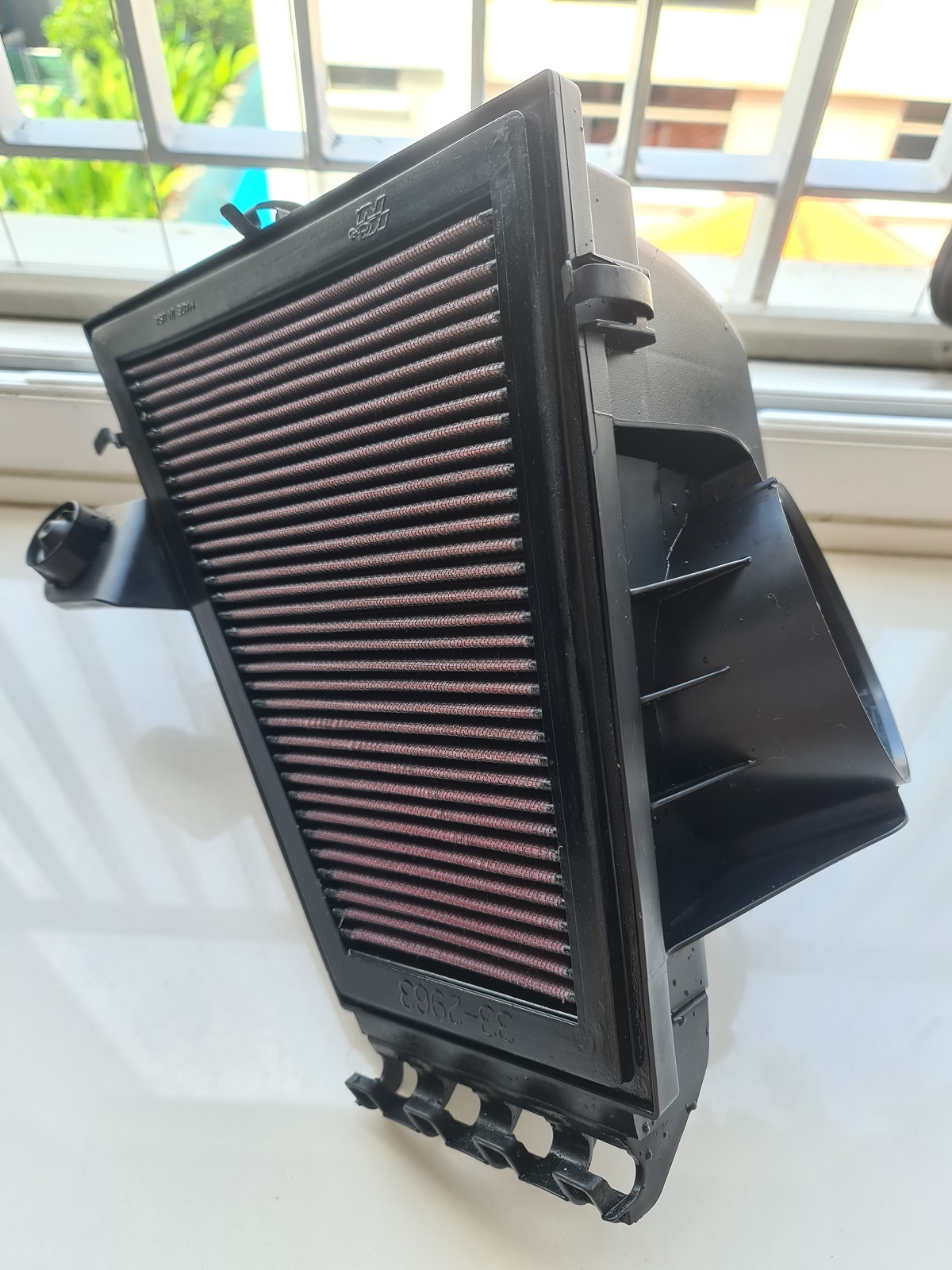

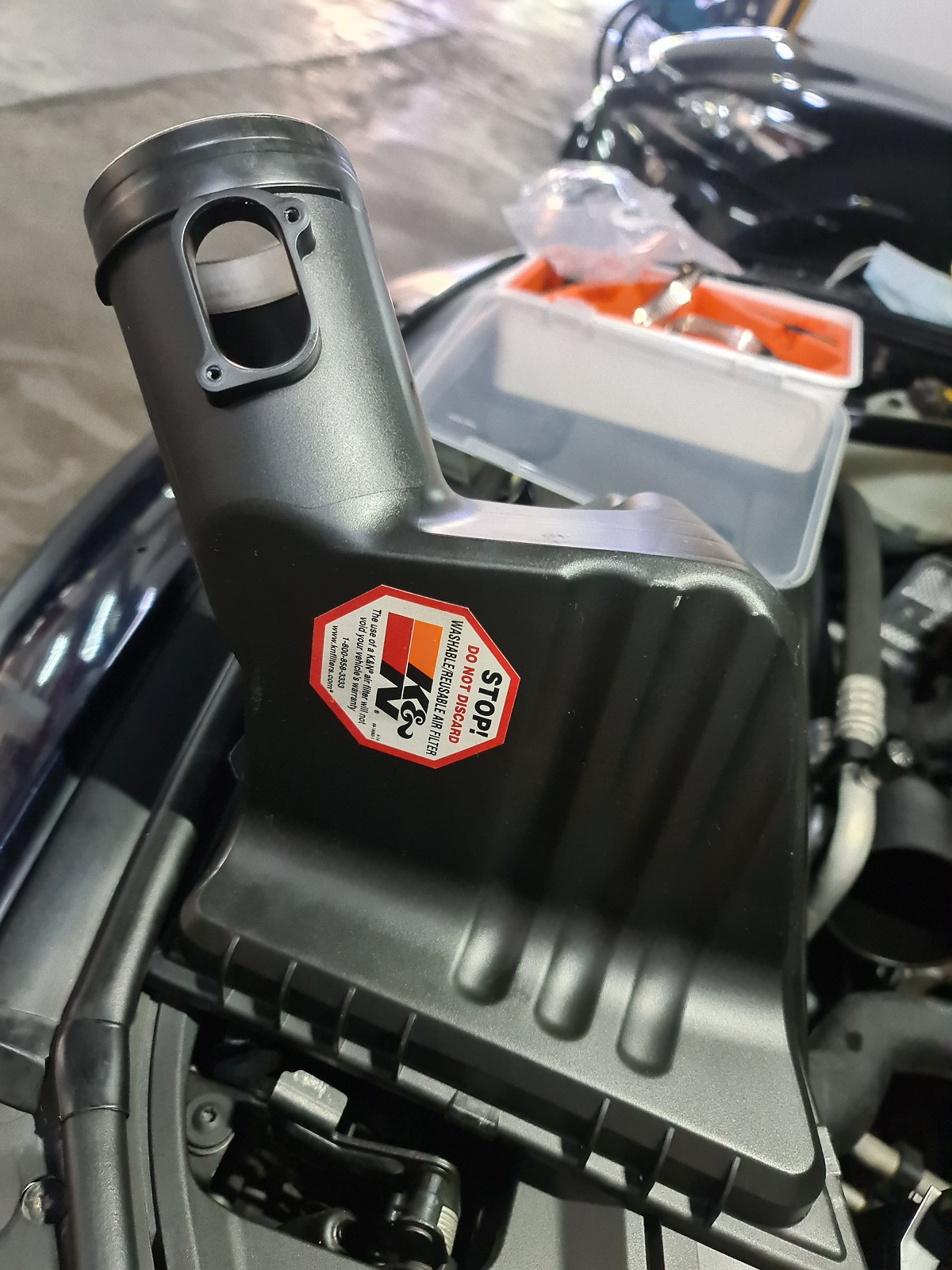

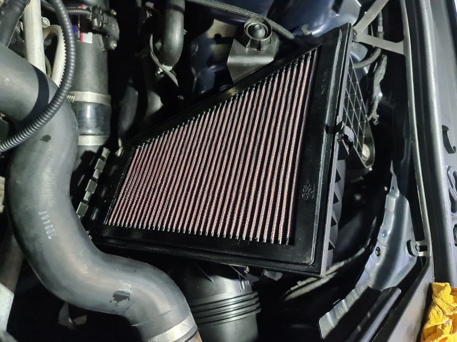

So the latest addition is the DV+ from GFB and a drop in K&N airfilter, i've had this in my previous cars and its not failed me yet. The details are below in the link. Order direct from them and ship to sg and install at your fav workshop.
https://gfb.com.au/products/blow-of...lus/dv-t9357-various-bmw-applications-detail/
https://www.knfilters.com/air-filters/bmw/528i/2.0l/2015
Hi, May I know if there’s any improvement to the car after installing the GFB blow off valve?
No there is little to NO performance gains with the GFB DIVERTER valve. There is NO GFB F10 specific blow off valve that i know off.
https://gfb.com.au/products/blow-off-and-diverter-valves/dv-plus/t9357-various-bmw-applications/
https://gfb.com.au/performance-parts-that-fit/998000265/bmw-5-520i/528i-f10/f11/f07-n20-engine/
This is preventative maintenance as the DV by BMW is a craptastic piece of plastic prone to cracking and breaking under higher boost levels that I'm running with a stage 2 tune.
ANYONE that tells you this boosts performance just wants to sell you stuff with little to 0 product knowledge walk away from them and do you're own research .

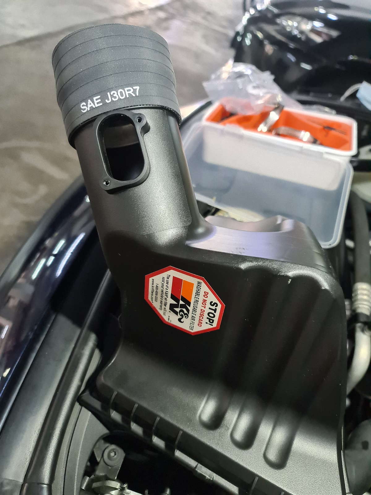

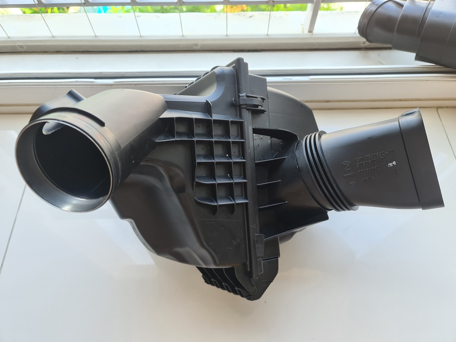

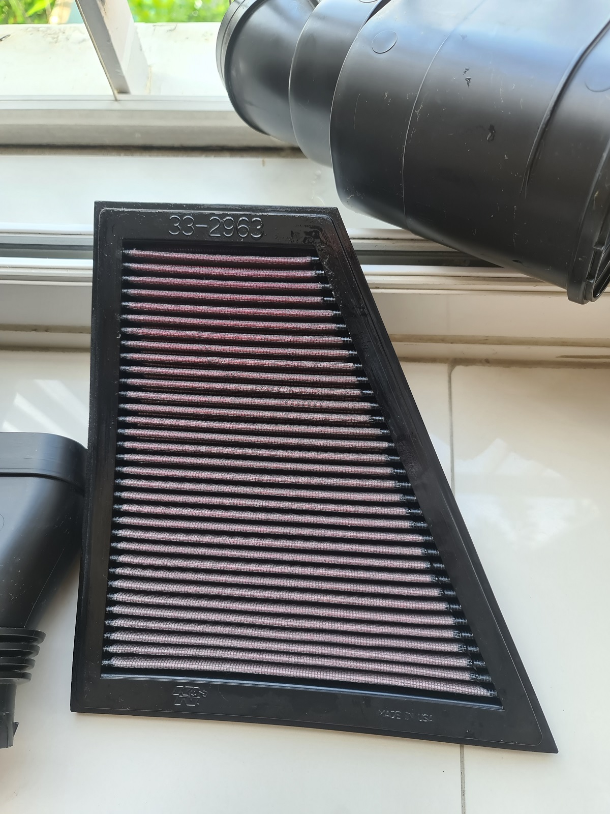

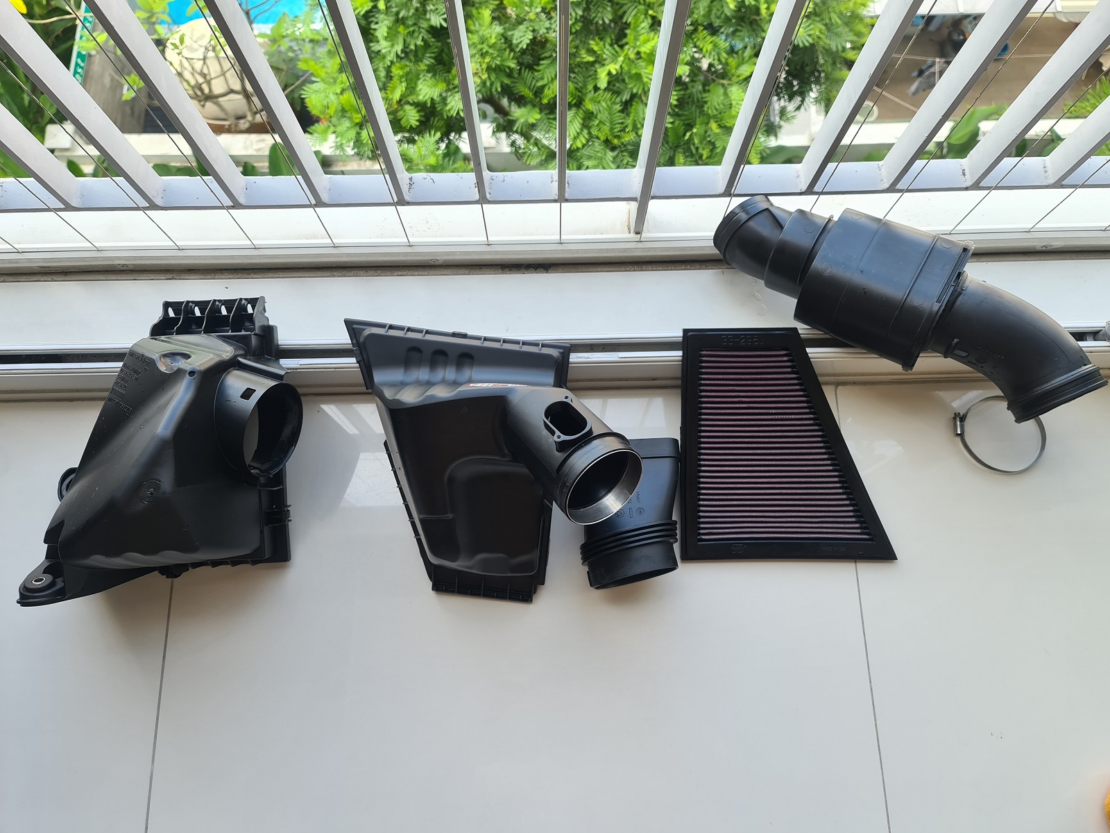

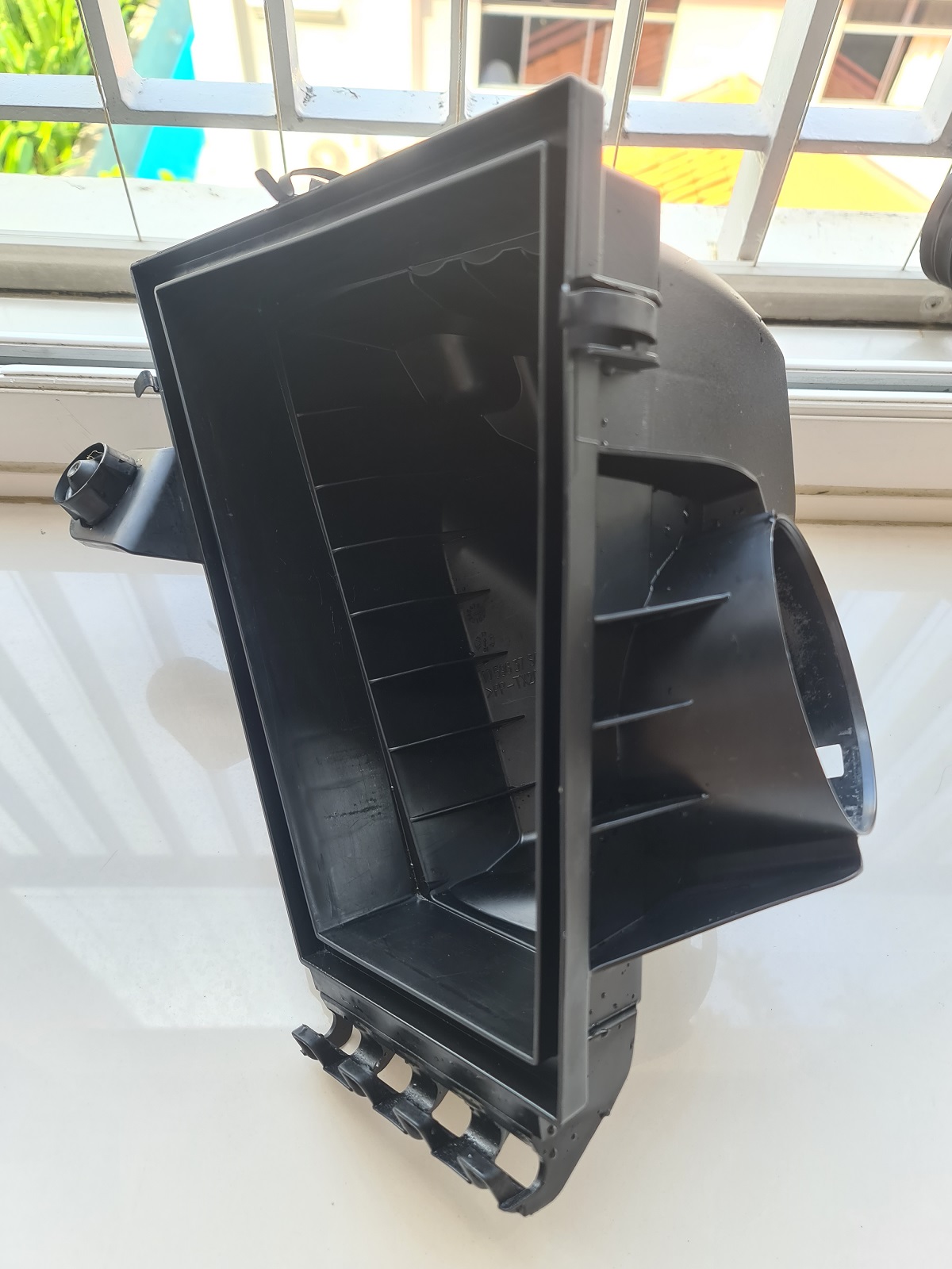

Missed a few steps in my hurry to take everything out but i'll try and do the best i can to list the steps.
1. Open bonnet & remove the massive bolt on the bottom right of the strut brace to get at the airbox clamps all secured with alligator clips and loosen up everything.
2. Disconnect MAF sensor ( I used MAF cleaner to give it a bit of a clean but you can use any contact cleaner as well)

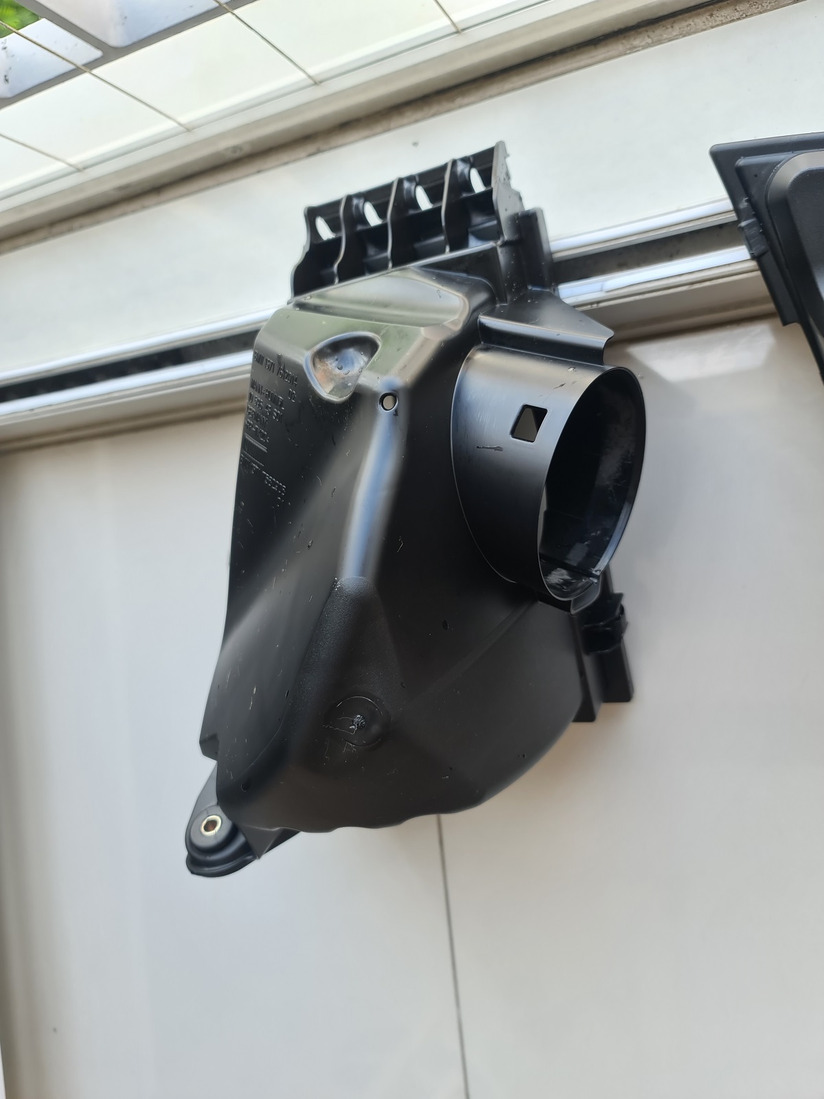

3. Remove the 3 spring clips at the side of the airbox holding the 2 halves together and associated hoses and etc.
4. Remove airfilter and 2nd 1/2 of the airbox via the bolt in the top of the airbox to access the snorkel/cold air induction pipe. You can just pull the airbox upwards as only 1 bolt was securing it in place.

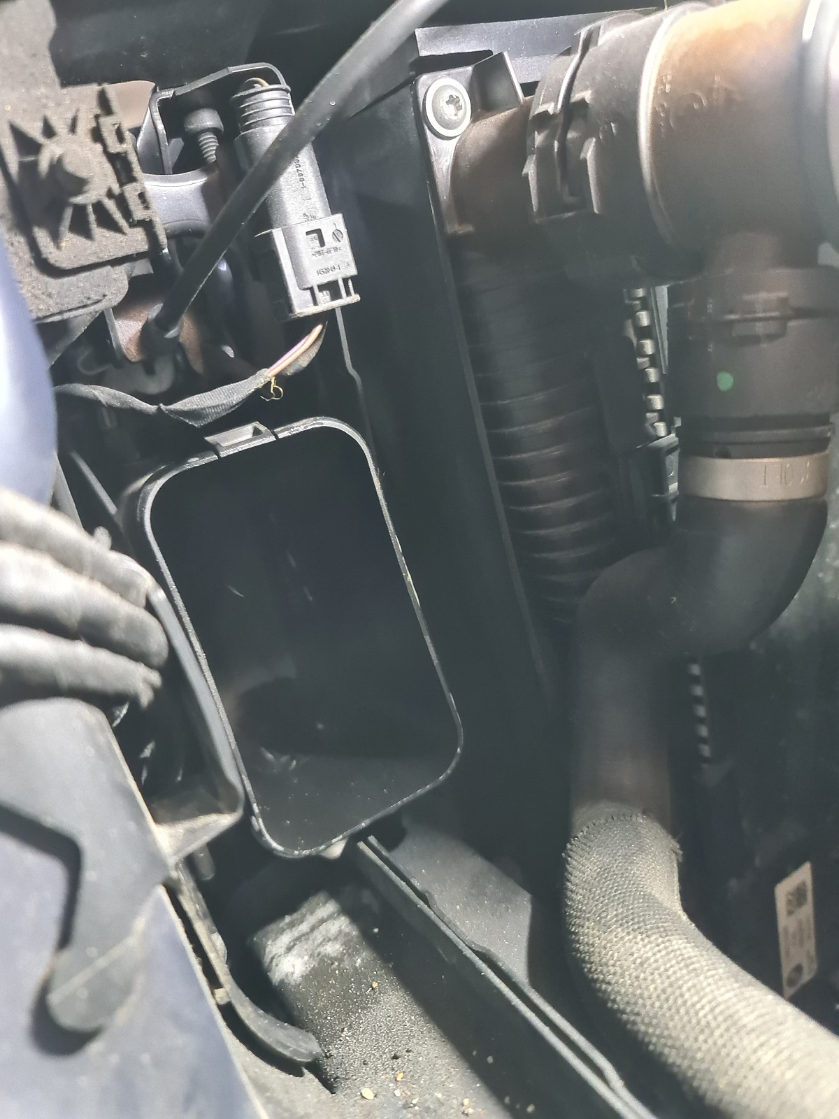

Tada cleaning time !
Bolt shown clearly here
5. Snorkel
6. Cold air intake
7. Airbox with MAF sensor removed
8. Please note stuff a big cloth or something to block the intake part whilst cleaning. Don't want or need foreign objects going into your turbo and screwing it up !

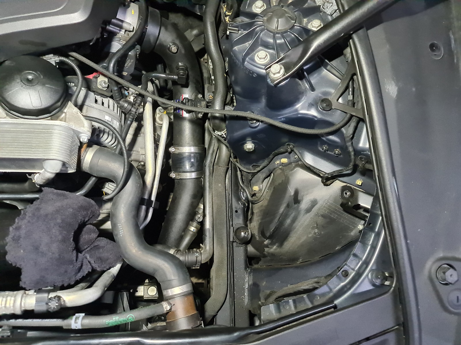

Final assembly time. Its not difficult just a bit fiddly to get the silicon connectors onto the piping.
1. Cloth is removed and new intake pipe is attached.
2. Attach connectors to the airbox loosly.
It was a bit tight but easy to work just needed to twist the piping into position and connect it all up in the reverse order. Don't forget to reinstall the MAF sensor !
Clamp everything together, make sure the 3 spring clips snap together to hold both sides of the airbox tightly.
Swing the strut bar back down and bolt it up. Double check all clamps are tight go for a drive and enjoy !
All done !
Very sweaty and need a beer. Check the clamps again after a few days just to make sure everything's still in place. If you start having a rough idle and erattic rpm fluctuations at idle (when you didnt have them before) it means there's a air leak somewhere go back and check and tighten again !

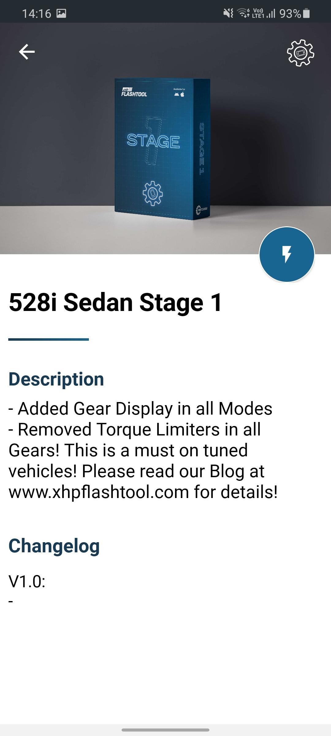

Next step XHP flash for the 8 Speed trans ! YES you can DiY this as well ! Black friday sales at 15% off
https://www.xhpflashtool.com/
xHP Map Pack8-Speed 1 x €149.99
xHP Flash License6-Speed 1 x €149.99
Price Subtotal €299.98
Discount BLACK FRIDAY - €44.99
€44.99 off total order price
Total €254.99 = 408.29 SGD

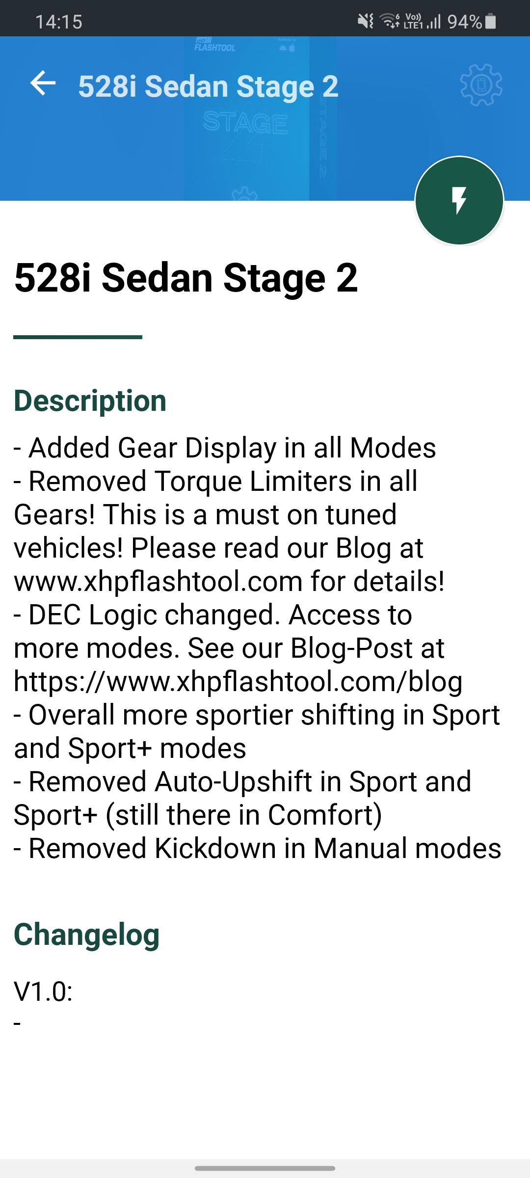

Went stage 2 out of the box, shifts are faster but I kept the option for softer shifts in as a customized option. Flash flash flash ..... total time taken was 1m07s.
