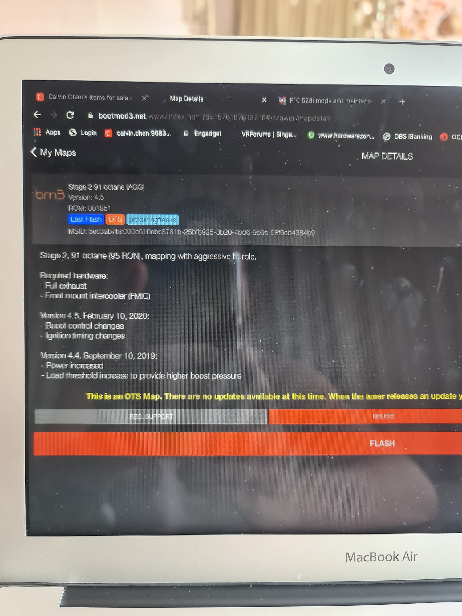

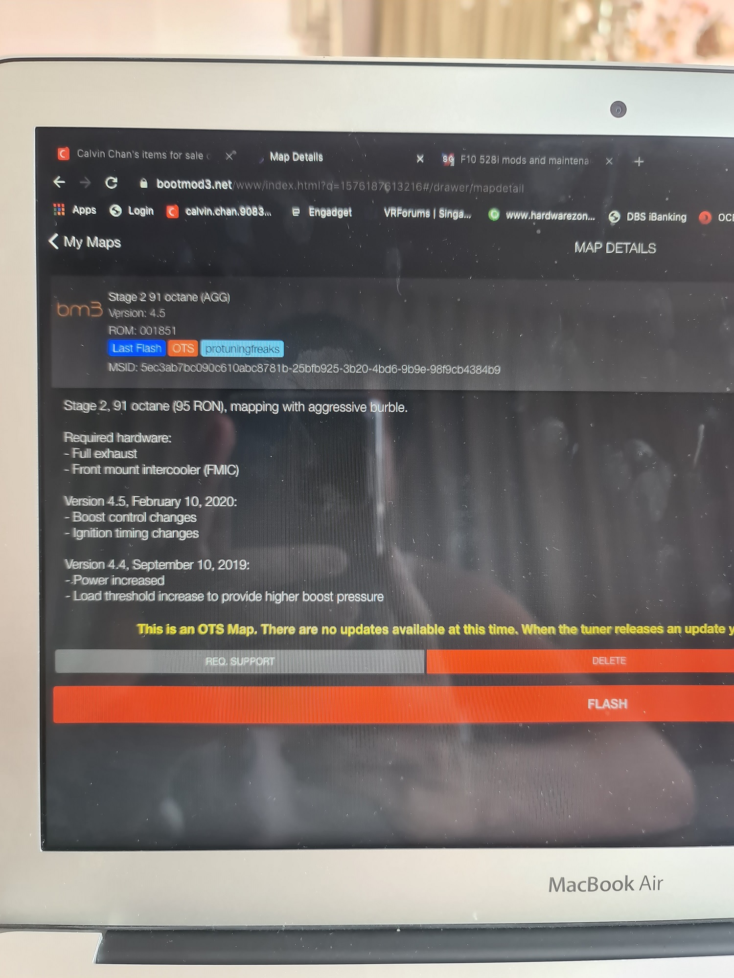

Hi Rssid, May I know how loud is the aggressive burble tune on your stock exhaust with the high flow catted DP?
Dont hear it in the cabin when the doors are closed. its soft not intrusive. Ive got a stock exhaust muffler still on. Car is not supposed to attract undue attention
Hi Rssid are you running on stock brakes too? If yes, what are your opinions on stage 2 tune with stock brakes?
