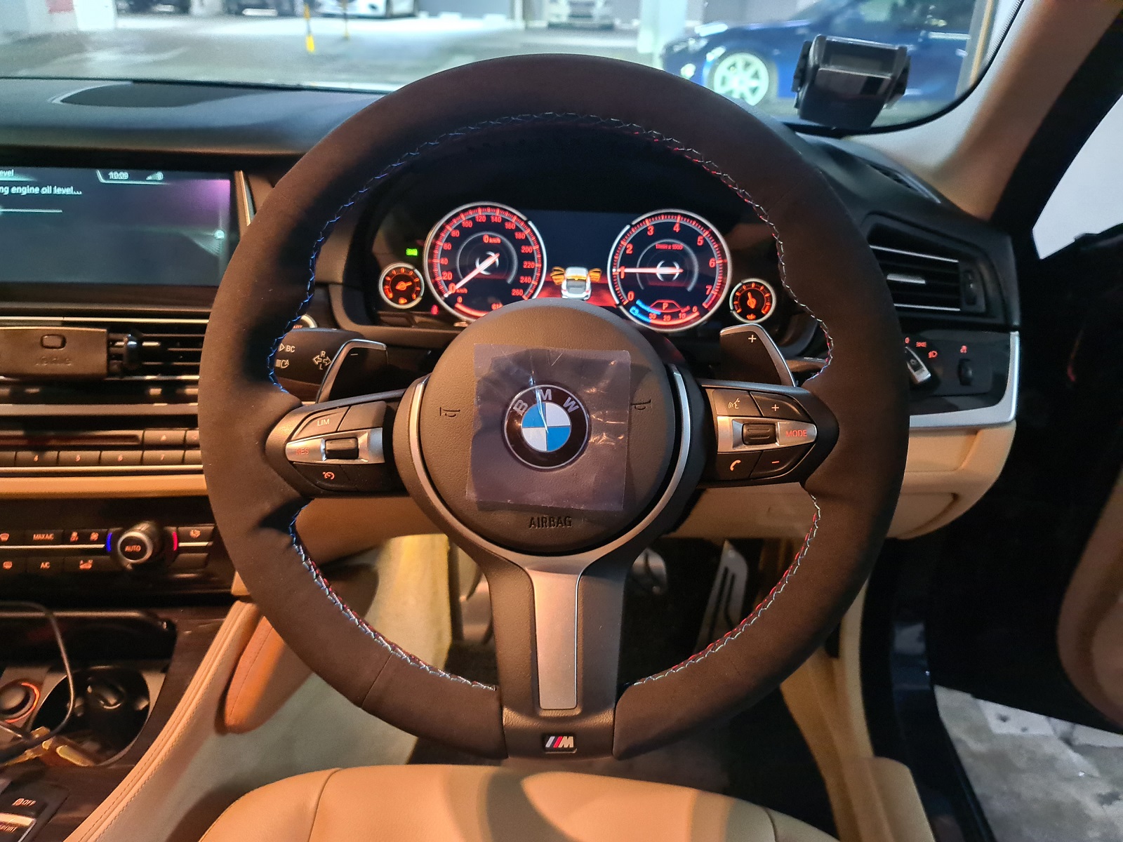

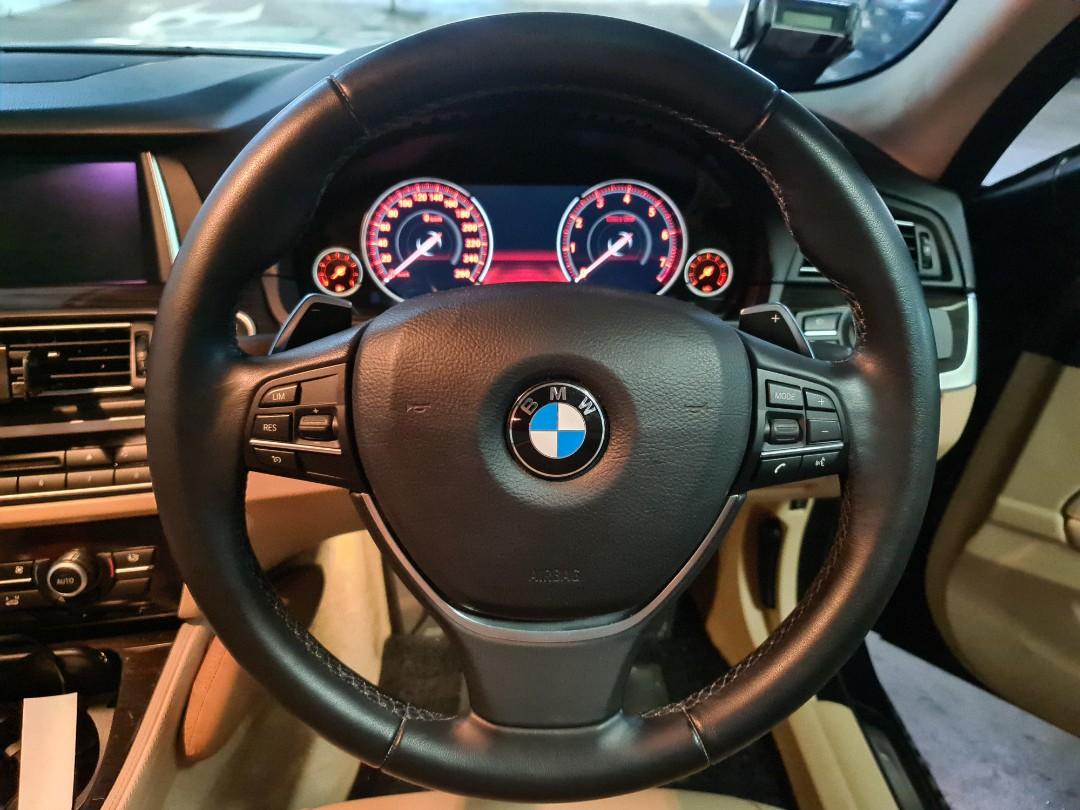

Step by step how to remove airbag / steering wheel
1. Empty boot
Flip up cover to reveal 2 plastic screws (White) size 10 socket required
Remove both screws and remove boot cover
Battery for me is located here for some F10s its located in the right side near the fuse box
Size 10 socket again to remove the Negative battery connector
In the drivers seat locate the small hole at the bottom of the steering wheel. Sometimes its 2 on either side of the steering wheel but for me its at the bottom.
Slide a Flat heat screw driver into it your feeling around for a springy metal piece to push up against. The airbag is spring loaded to pop out but it takes some effort to get it going.
Airbag pops out
Remove various electrical connectors
And you get to the main bolt holding the steering wheel in. Size 15 socket and HUGE muscles required to get this out.
Once out the steering wheel simply slides out. Notice the notch on the steering wheel , you can't put it in wrong.
Slide the new Steering wheel on
Put the bolt back in and reconnect various electrical connectors
Pop in the airbag reconnect the battery and test !

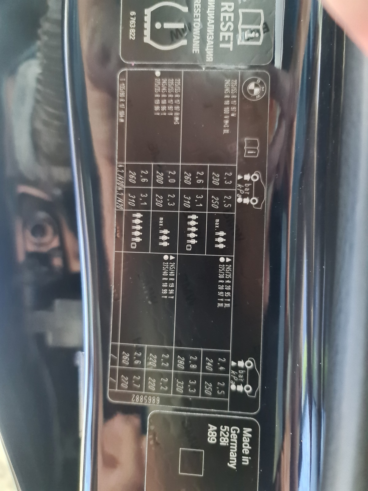

Hi buddy the PSi requirements are on the door sil next to the tyre profile. If in doubt go to a tyre shop and check with them.
DO NOT ask random people on the forum even "experts" have no idea what rim size and profile you are running so any advice is crap.
Thanks man, thanks for the sound advice
