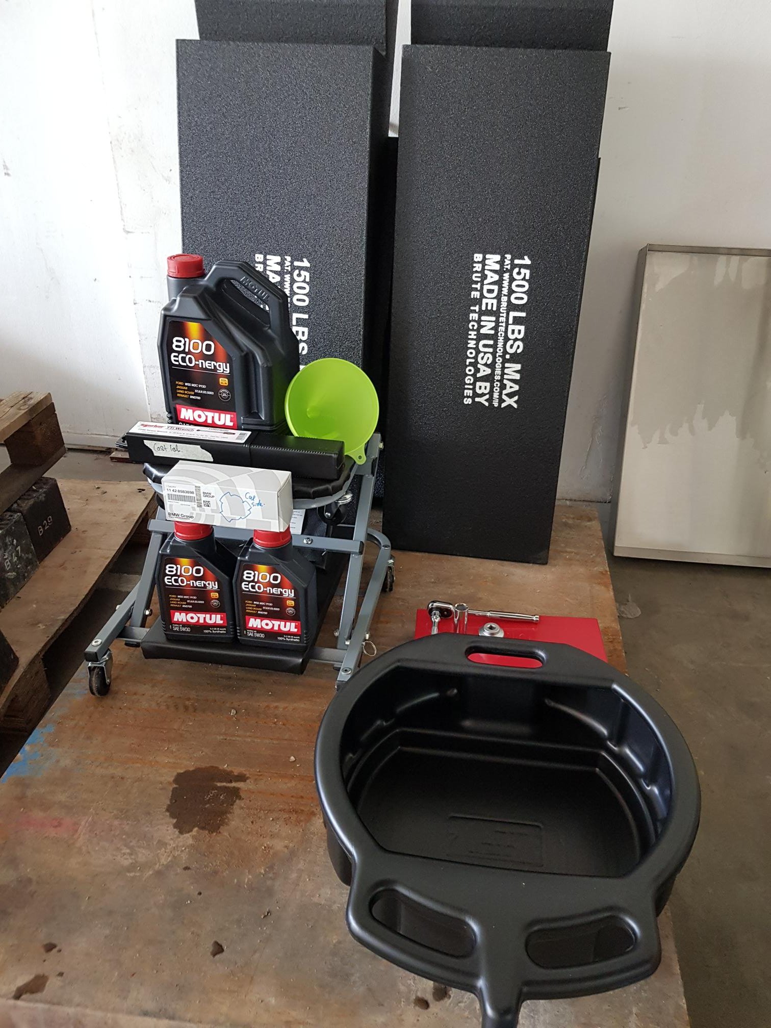

Purchase list
Car ramps (From US)
Oil drain pan (From US)
3/8 drive socket with 32 mm (for oil filter) (From US)
Creeper seat ) (From US)
3/8 drive Socket wrench set (for drain plug), actually i needed only 17mm but i bought the whole set anyway (Local)
3/8 drive socket wrench extension 150mm (to access the oil filter cap as it was in a difficult position)(Local)
3/8 drive Norbar 8-50Nm Torque wrench(Local)
Motul 8100 oil (used 6.5L)(Local)
Oil filter(Local)
Here are the tools/equipment

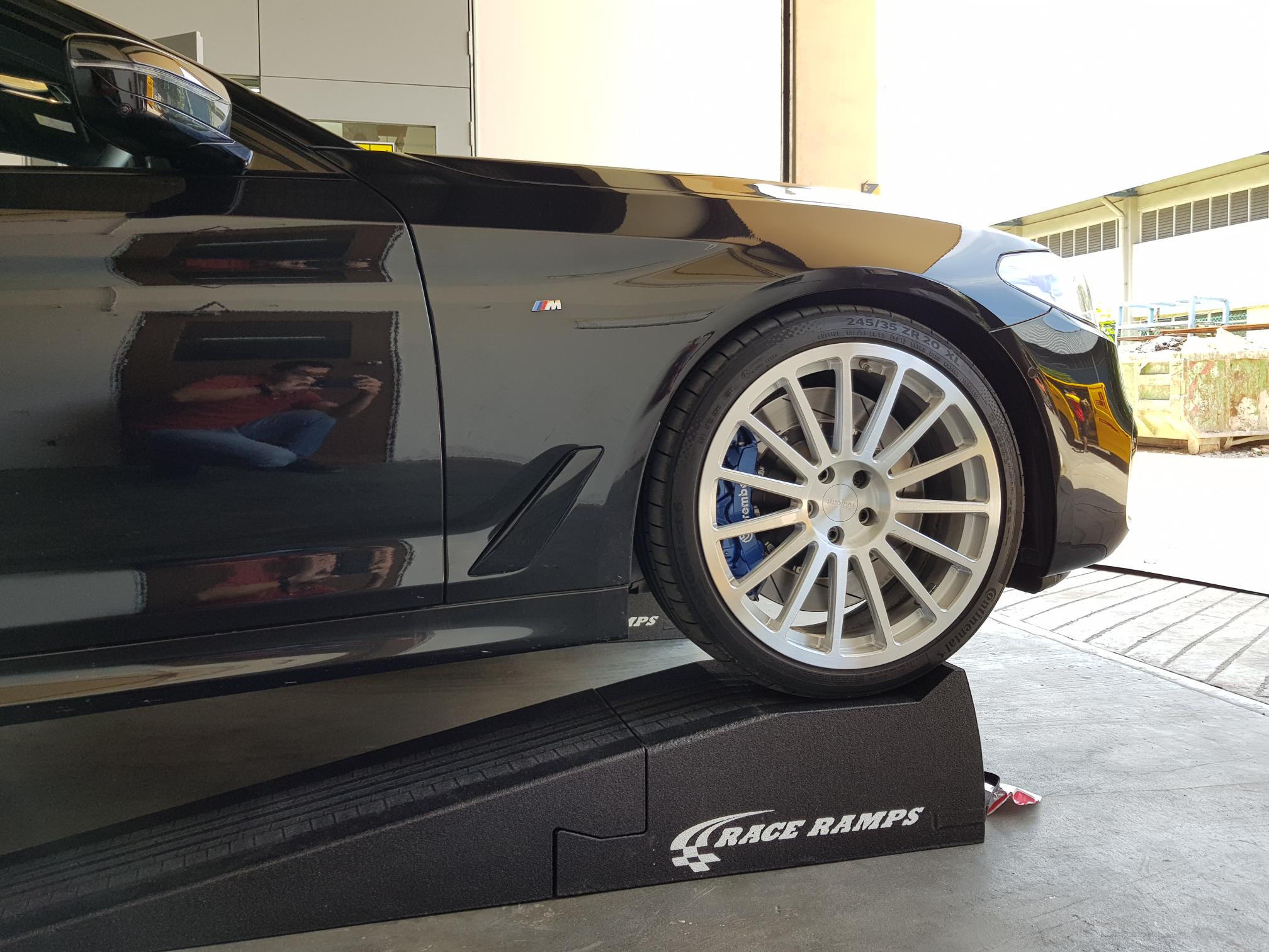

First and foremost, the car had to be raised so i could access the drain plug, the work was to be done during lunch time at work. There's a chemical section within the company which disposes of chemical waste, so the used oil would be passed to them for disposal
The ramp comes in 2 parts, once the car was safely up, i applied the handbrake and used the 2nd half of the ramp as a wedge just in case. Note that i did not have a back up in the event the ramps failed. Some people use jack stands or bricks. The ramp height is 10 inches or around 250mm. Clearance was ok with my car with lowering springs. ACS Springs
Prior to going up the ramp, i warmed up the engine for around 5mins as understand that warm oil flows easier. Once up the ramp, the next step was to open the drain plug. I used the creeper seat to access the bottom and located the drain plug.

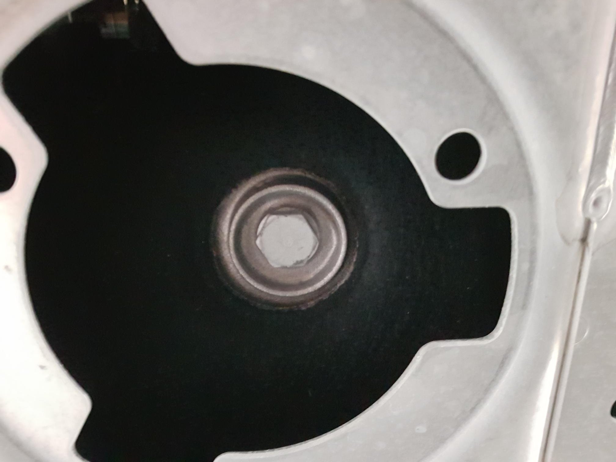

I used a 17mm socket wrench to open the bolt. Note that there is a copper washer that you have to replace when ever the drain plug is opened. The copper washer came with the oil filter.
Its advisable to open the drain plug a little to ensure that the liquid coming out is oil and not tranny fluid. After the drain plug was open.....

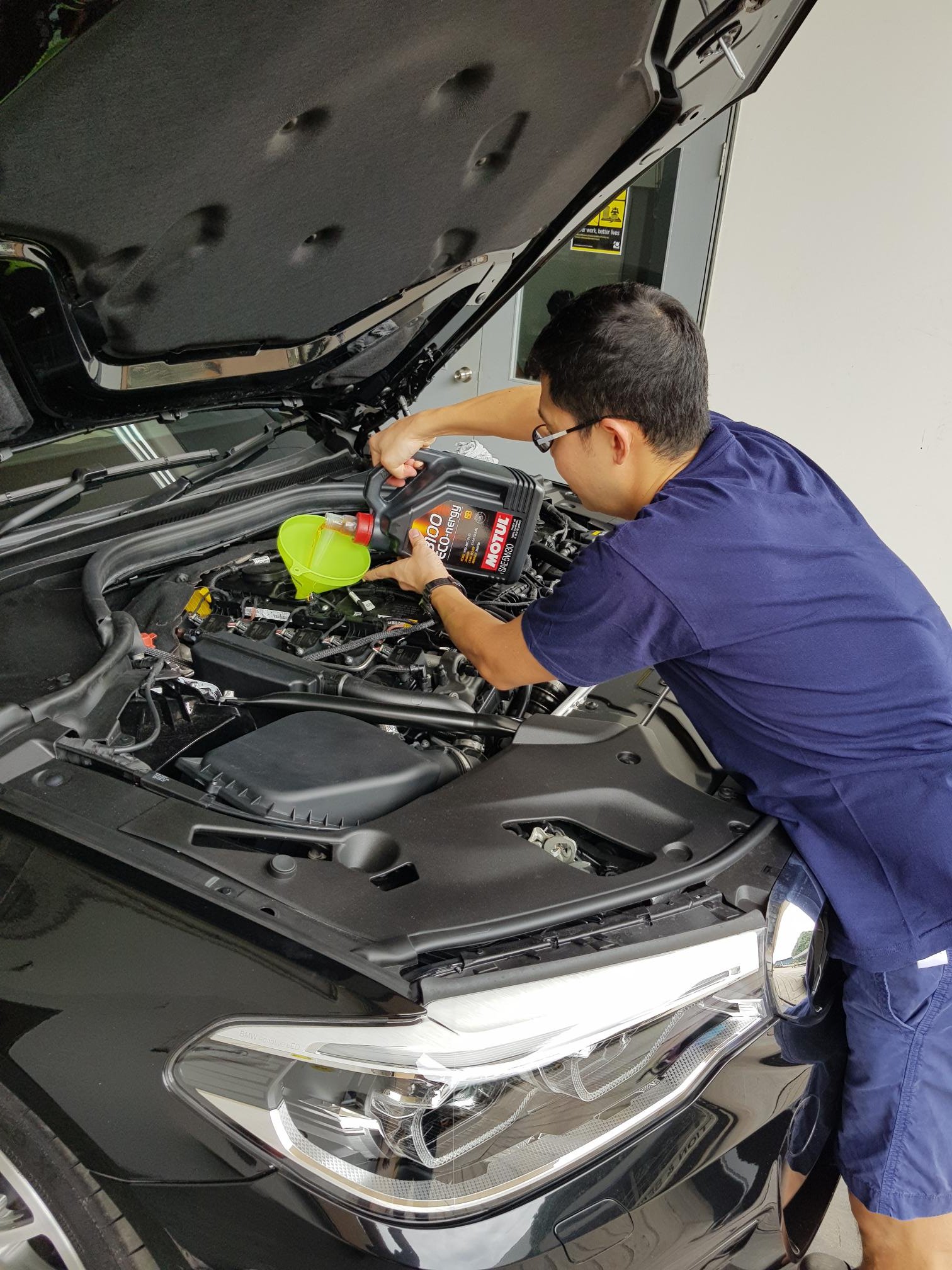

Remember to fit the new rubber gasket onto the plastic oil cap. Screw it back using the same wrench. i was not able to find the torque values for this but noticed a considerable amount of turning torque at a certain point and stopped there. The drain plug was also screwed back after a while. A new copper washer was also used. The torque value i used was 20ft lbs or 27Nm for the drain plug. Kindly update me if i am a mistake on this and i will amend it in case others make the same mistake as me and cause some catastrophic failure on their engines! i will know in a few days :lol2:
After the drain plug and oil filter was fitted back came the best part! filling up the engine oil...., i filled up 6L of oil and had to start the engine and drive the car of the ramps and filled another 0.5L to 0.6L. I did this as the car was not flat on the ground while on the ramps. The car has an electronic brake and i don't know how to roll the car off the ramps without starting the engine.

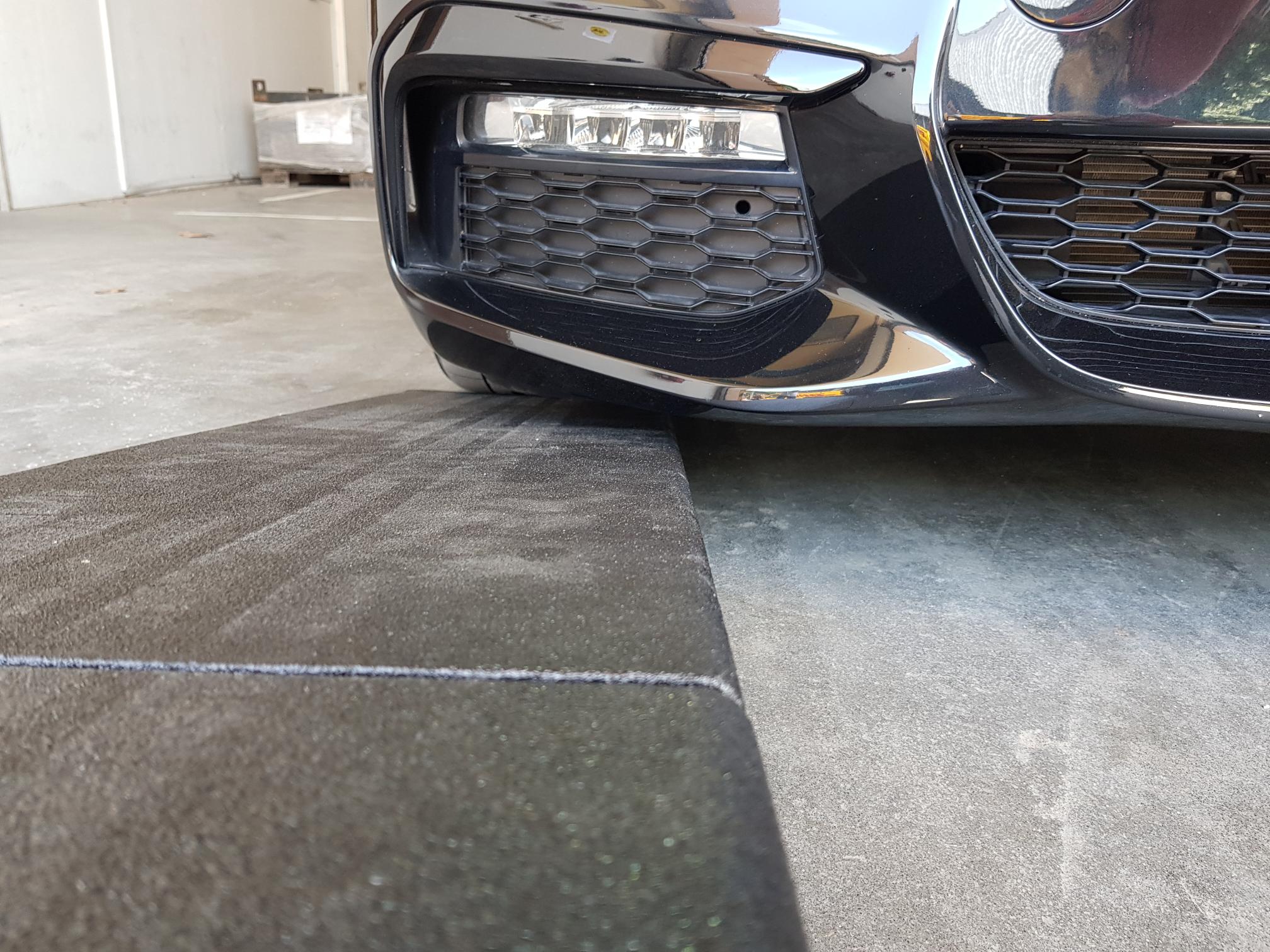

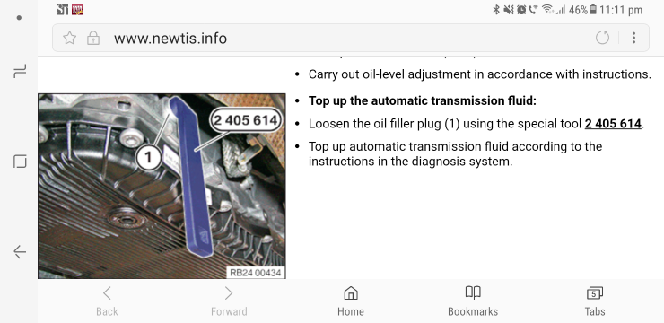

thanks for the nice words..heres a more reliable version...
https://www.newtis.info/tisv2/a/en/...air-manuals/11-engine/11-00-engine/1VnYQ4EP6M
and this is my next project-changing tranny oil....but i do anticipate some problems. may or may do it...
1)measuring temp of oil
2)when to stop topping up(i can use the same amount that has come out to go back in)
3)space constraints as not below a hoist and using ramps. oil has to be pump in through filler plug which is horizontal.
4)locating a bmw tool for opening the drain plug of the tranny(heard normal socket wrenches may be difficult to access the area)
if any experts have done it in their younger days or have moved on to bigger projects but not convenient to share,i will always welcome a PM
https://www.newtis.info/tisv2/a/en/...n/24-11-transmission-case-oil-sump/1VnYxiE5Ub
thanks.

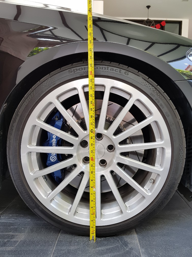

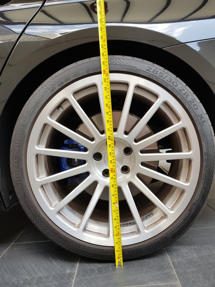

Have been waiting for this day for quite some time. The springs and brakes go on tomolo. The approx measurements on my car,with adaptive suspension are below. The measurements are prior to changing the springs,which i will do tomolo.
FL -715mm
RL -715
FR - 710
RR - 705
i will update the measurements after fitting the springs. Fitting springs may hurt the dampers and shorten damper life and may also affect the handling but i giving it a go,i'll be using AC Schnitzer Springs.
Also going on would be my brakes. They are a 6 pot 405mm set for the front only. They are a GT set which come in black,yellow,red and sliver from the factory. Theres another GTR set which is more expensive and has a chrome like finish but its past my budget besides, i intended to have them sprayed it in blue to match my rear calipers. This may affect resale and cause ppl to judge me for not being original but again,im going ahead with it. Hope the colour is able to last.
Attached are photos of what i took today.
Hi, just to update everyone of the height after my springs were fitted.
FL - 690mm
FR - 680mm
RL - 700mm
RR - 690mm
So far,i have not scratched the car yet except for 1 time when i was at Sim Lim but that was a very light scratch and i was going a little faster than normal. The car now does not seem to have a difference between sport or comfort modes which may not be a good thing to some.
Personally i feel its still comfortable.
@Xiaochew,hope this info is able to help u and look forward to seeing your end result after lowering.

When I free I go measure mine[emoji28].
These are front and back right
RR 700
RF 690
All sides are 10mm higher than yours[emoji24]...hope this make you happy.
